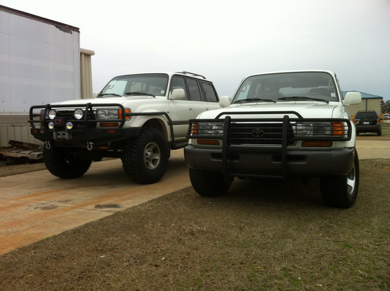

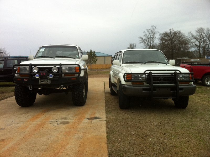

I just got these on today.
My setup:
1997 Collectors Edition
OME Heavy Front with Metal Tech 2" spacers
OME Medium Rear with 30 mm urethane spacers
OME caster correction
Standard OME shocks
Here it is sitting next to a stock Collectors Edition
Do you have 2 1997 CE's?!?!?!?!? :clap: If so, that is awesome. Brother and sister.
