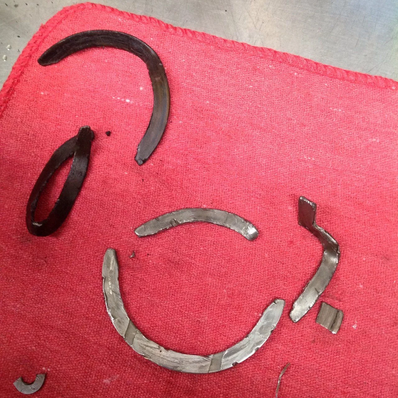

The thrust washers were in the bottom of the pan and one side had obviously been spinning for quite some time. Some wear on both the block and the crank where the washer was spinning. Number 2 main bearing was showing considerable wear, other main bearings weren't in too bad of shape! Crank looked good. I installed new thrust washers and main bearings, all clearances were within specs. Putting it back in now, let's see if it will go another quarter million miles!
Wow, those are pretty nasty looking. Interesting that everything else was in pretty good shape. Be interested to see how it runs after you get things all back together.
It's running great! Of course, it was running great before without the thrust washers! It will be interesting to see how long it will last, it already has over 240,000 miles. I figured I would spend $50 on it to see, either way, a complete rebuild will cost the same now or later.
