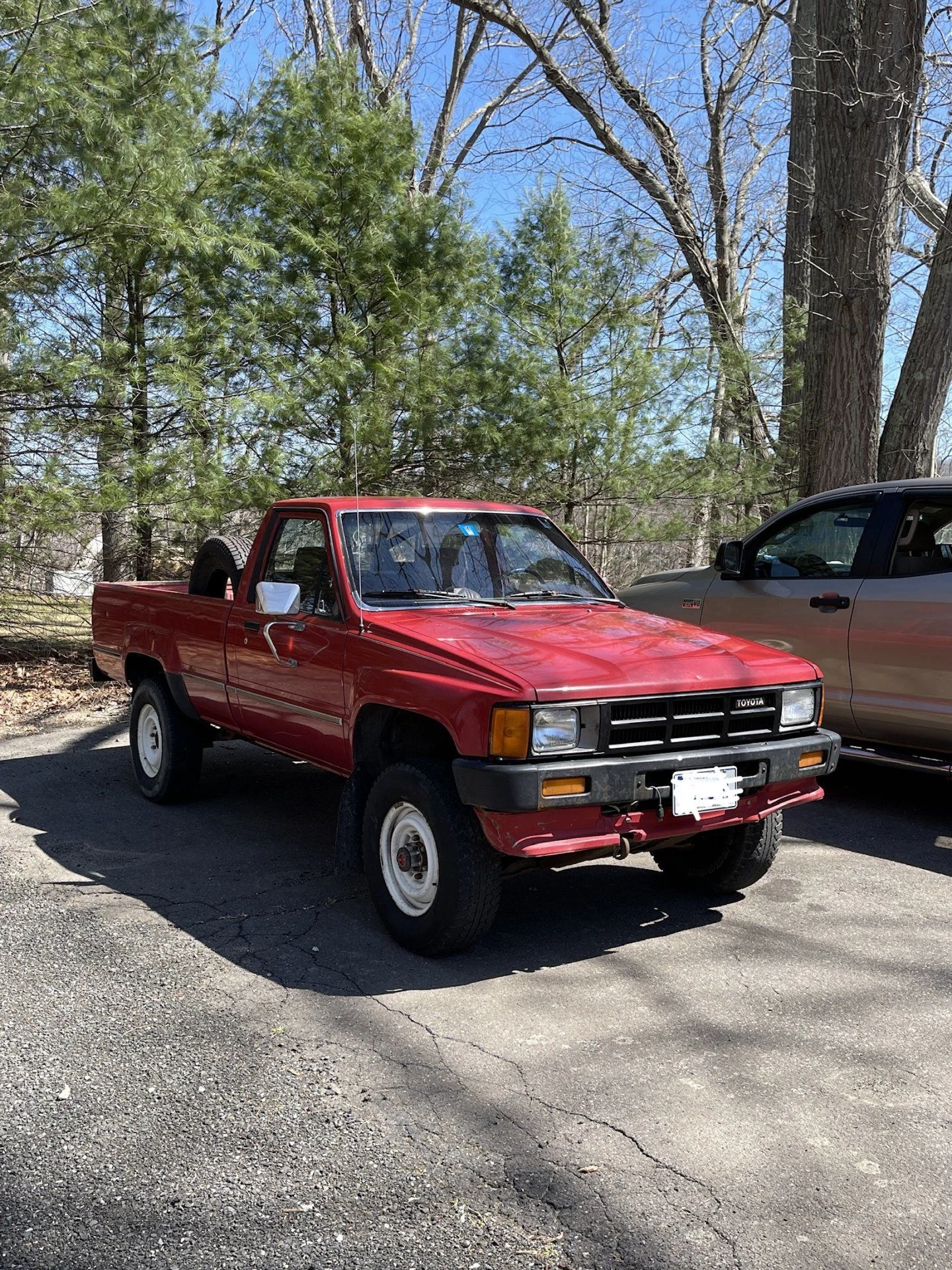

Hi all,
Recently started going through a new purchase. 1986 toyota pickup with a 22r.
The truck will only start with the pedal all the way to the floor and then idles rough and takes some foot work to get it to run.
After a few min it purrs like a kitten.
I started having occasional dieseling
Hesitation on initial accelerations in 1st and 2nd.
Today I checked the vacuum lines and tried checking the AAP. The sight glass doesn't look like it is filling properly.
After plugging the AAP it starts and turns off fine. Then I let it sit while I flushed the cooling system and it hard starts again!
From the receipts I see it is a new carb as of last year.
Any input would be helpful!
Trying to fix myself before I cave and bring it to the shop...
