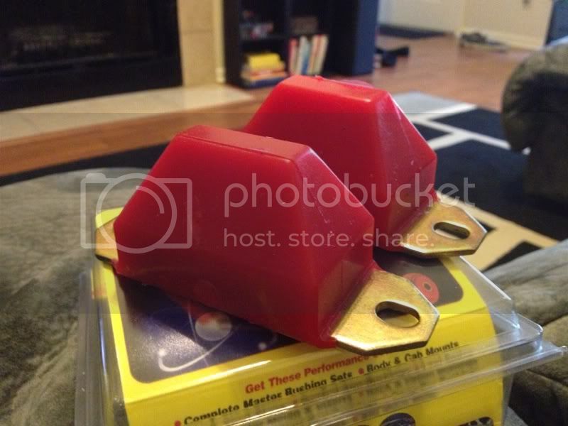

I found out through ls1tech that bump stops from a 1976-1986 Jeep CJ5 work with a little modification. Energy Suspension part number 9.9137R bought from Summit Racing. $22.90 to our door.

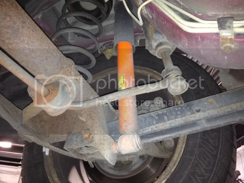

Here are some shots of the rear. You can see one bump stop is alright. The other completely gone.
And the new bump stops

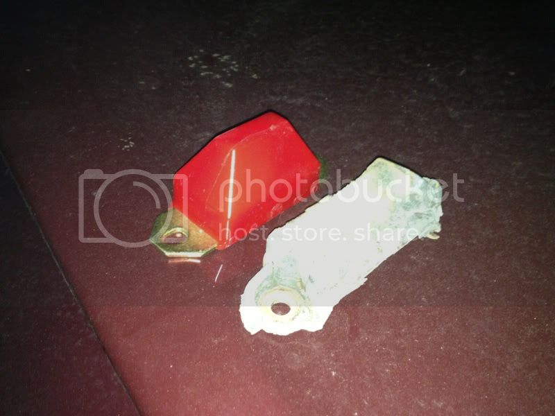

Lovely old bump stop
New vs old picture. Crappy picture but I wanted to show it

And about the modification of the chassis to fit the new bump stops: I just bent out the existing tab of metal to flat rather than at 90 degrees. The bent tab extends past the edge of the bump stop maybe 1/16". Shouldn't cause any issues. The old bump stops didn't have a flat base, but a notch for the tab. So I fixed it :hillbilly:
