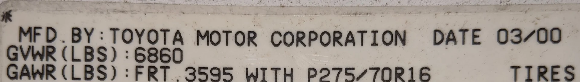

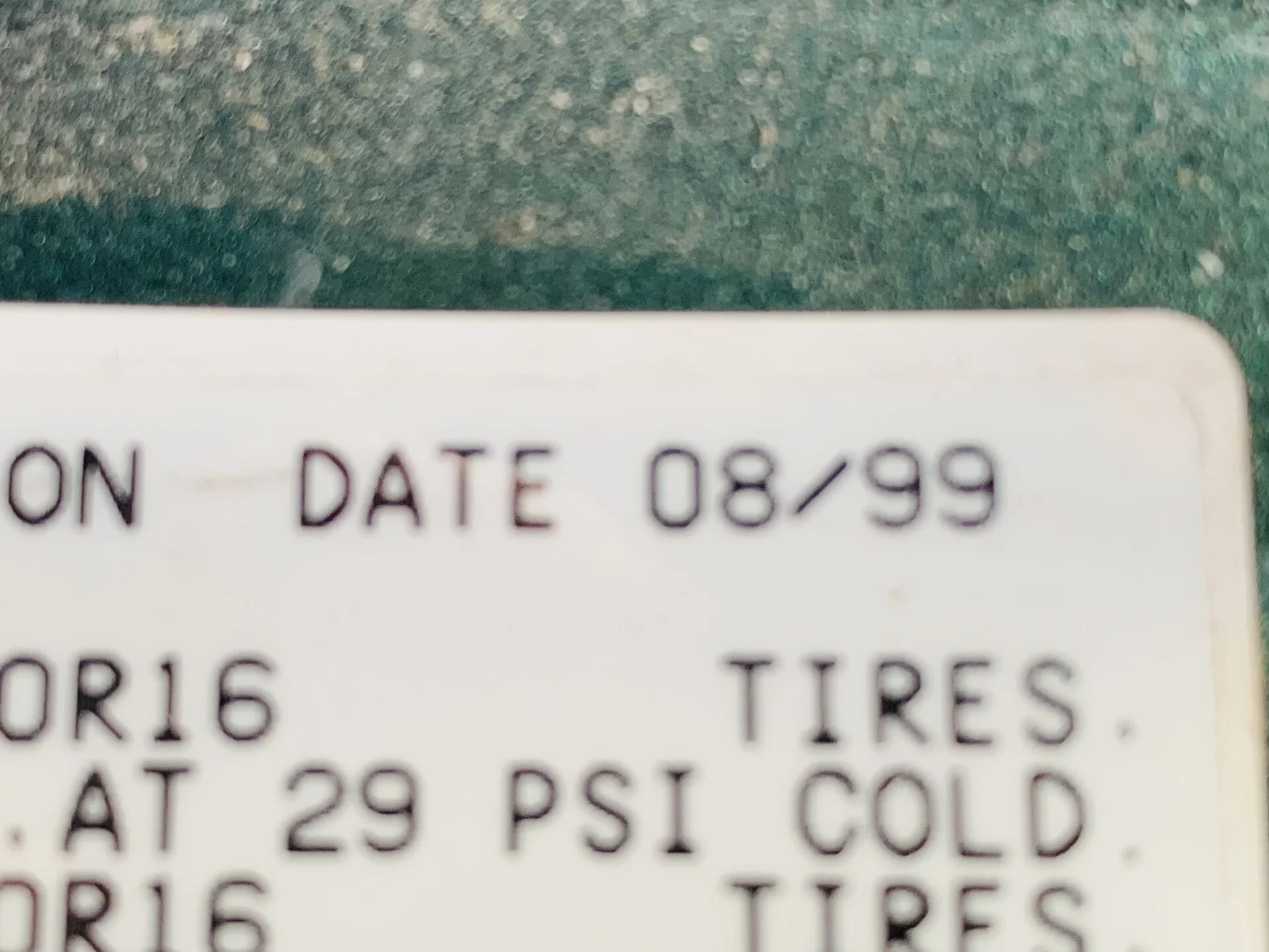

Maybe we can pin the 2000 Transmission issues down to the Month... If you got your VIN sticker pic handy, it will tell you what Month it was built. I have 185k miles on mine and it drives great.. so hopefully mine is NOT the exploded trannys.. I'll go first.
I have a 2000 built in March/00
IIRC Toyota changes production in June-July of the year for next year models so hopefully my March tranny was fixed.. hopefully...

My 418k mile 2000 LX was born 8/99.
