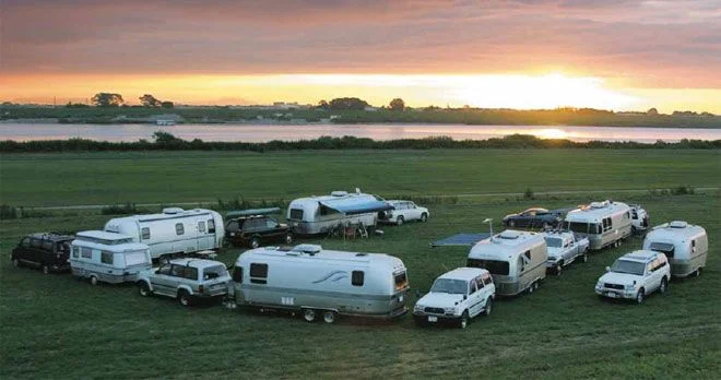

Check out the 80 series in this photo. If it can tow what seems to be about a 25'-27' Airstream, you should be able too as well. This is from the Airstream website. The 80 series is rated about 4500 lbs towing, no idea if this caused any damage to his 80 or if that was a very wobbly drive with an even shorter wheelbase
