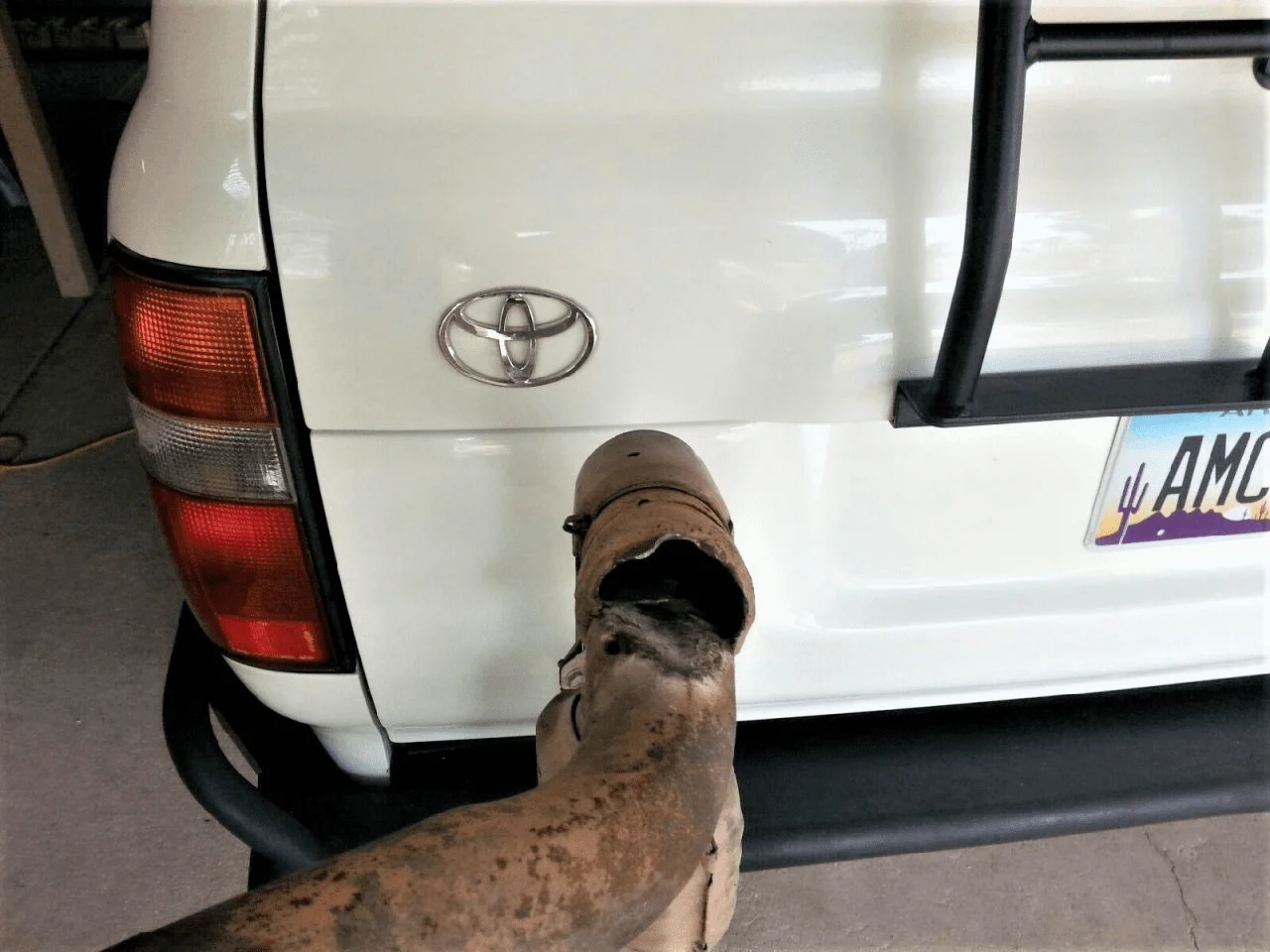

ha!!! I thought I banged it flat running without a back pipe hanger. maybe it's supposed to be flat up there. It's pretty hefty tubing.
If that's factory.... wow. it looks so restricted up there.
That flat area + the rattling muffler is why I was looking into replacing the whole back exhaust.

Do these have the flattened pipe where the exhaust crosses over the frame at the rear diff?
The diesel 80s have the pipe crushed to around half it's normal diameter in a space where there's room for 3" pipe.
Same flat spot on our gasser.
