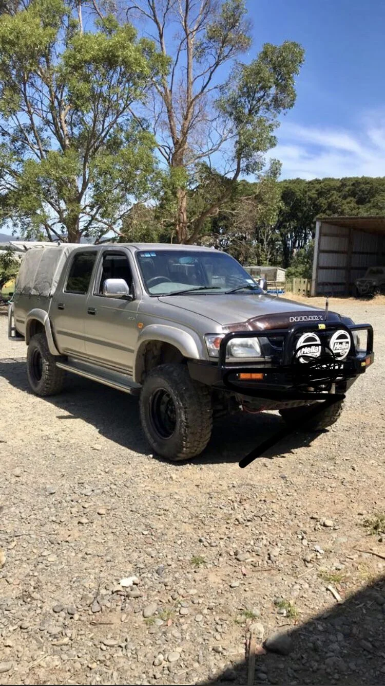

Hi there acouple of days ago I brought a 2004 Toyota Hilux double cab with 31’s and a tjm winch bar and winch. I have given it oil and filters change also new air filter. The problem is I have worked the fuel consumption out to be 16leters- 100km which I think is terriable and this is trying to drive as conservitave as possiable, dose anyone own one of there and please tell me this is not how they are meant to be. Cheers
