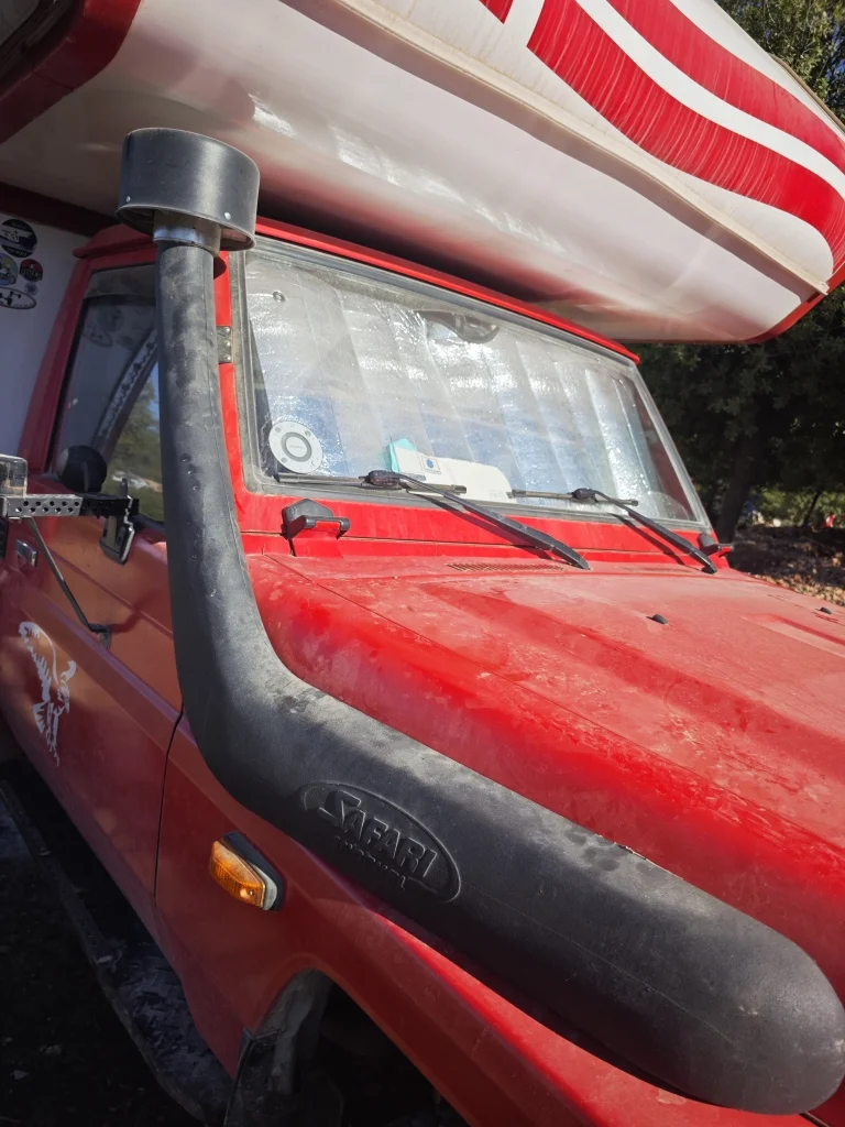

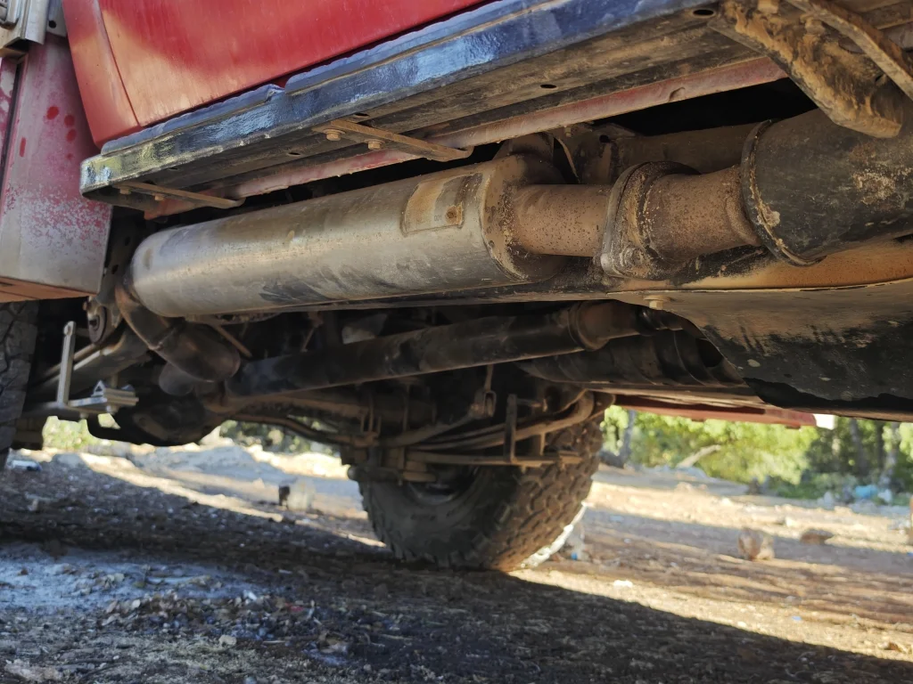

It is a non turbo 1HZ engine. I have replaced the original exhaust with a side muffler from Tourfactory in Germany. (See attached picture)

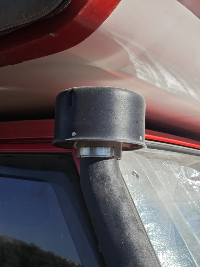

Also installed a Safari Snorkel with a centrifugal prefilter. (see picture)
Otherwise the engine is stock!

You have already posted your problems on this thread, which went cold: 1HZ high altitude smoking and sputtering - https://forum.ih8mud.com/threads/1hz-high-altitude-smoking-and-sputtering.1346197/
As I said in that thread, your engine has a fuel supply problem which manifests at high altitude. White/blue smoke and sputtering/cutting out are not symptoms of high altitude. Did you see other vehicles having this issue?
Air is the limiting factor on a diesel engine in standard tune. There is no adjustment for air density on a 1HZ (no air-flow meter etc.) so when air becomes scarcer, the same amount of diesel goes in and you get incomplete combustion leading to black smoke. Look at the trucks labouring up the passes around you.
Blue smoke or white smoke indicate completely unburned fuel, which together with your engine cutting out, indicate there is a fuel supply problem (i.e. erratic fuel supply). The issue is most likely air getting into the injection pump, or some other problem with the pump.
You talk about adjusting the pump temporarily. What you are referring to is the maximum injection screw. It is an adjustment made on the bench by a technician who knows how to set up these pumps. Given that you think it will adjust fuel mixture (which implies you do not know the fundamentals of a diesel engine and fuel system), I can only say to leave it alone. The maximum injection screw adjusts the maximum fuel injection volume, i.e. when you have the pedal to the floor. It will not do anything for the injected volume when you are off the maximum. So unless you use the accelerator pedal as an on/off switch, it will not help you.
Try running a clear fuel hose from your filter to your pump and watching for bubbles. You can also try removing the air filter to intake manifold hose (i.e. running unfiltered air for a minute) to rule out an air supply problem.
One more thought on the symptoms - when exactly did they start? Were you getting black smoke, then turning to white/blue smoke and lumpy running as the altitude increased? Or did the white/blue smoke and bad running suddenly start?
