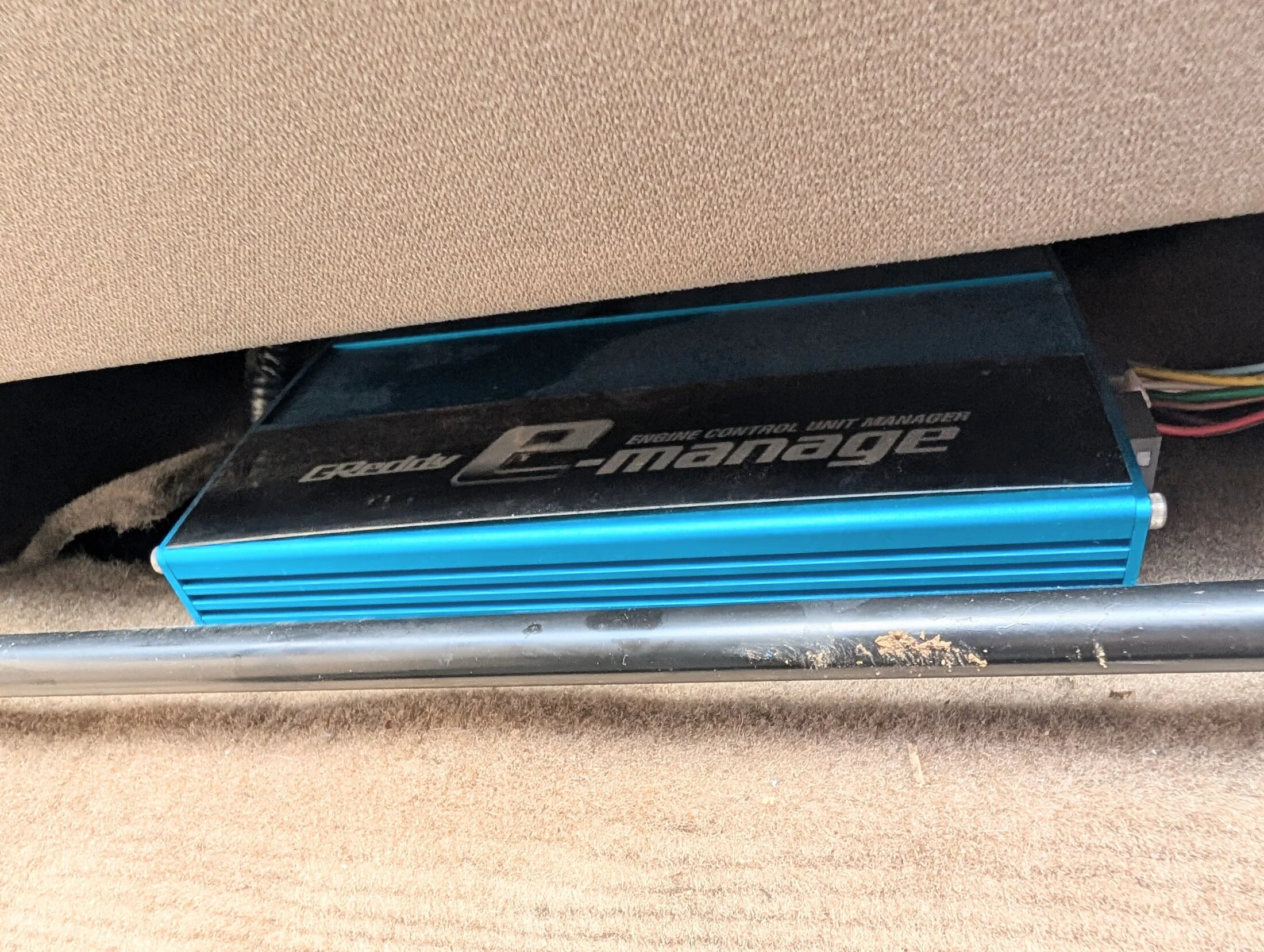

My JDM HDJ101 has an old Greddy Emanage Blue piggyback ECU/chip supporting an ECU remap. It came like this imported from Japan to BC, Canada, and none of the tuner shops in my area will touch it. Since I can't have it looked at, I'd like to remove it and go back to the stock ECU by itself if possible.

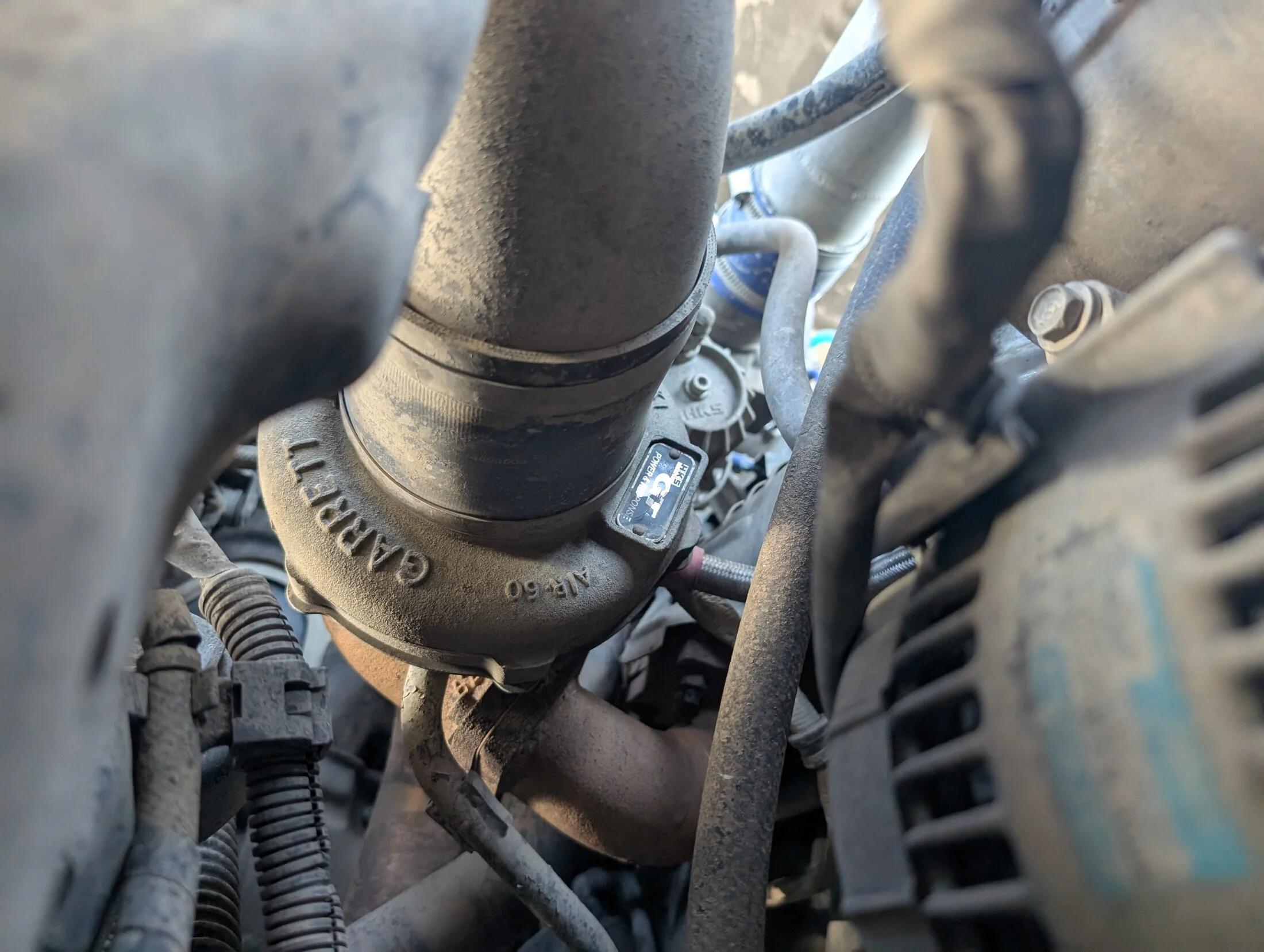

The turbo is an HKS GT Garrett A/R 60.

Whether you can unplug and run or not will depend on how it's been wired. I'm not familiar with the Greddy setup but I assume it is hard-wired like a Unichip etc require a "bridging" plug to run.

I've installed and tuned a few Greddy emanages years ago on gas engines, I think its one of the better piggyback systems and japanese quality but I had no idea it could be set up for diesel / injector pump control. Either way, some ECU wires will be fed parallel into the unit some wires are cut and run from the emanage directly and it will probably have some extra sensors connected to it. So if you remove it you have to make sure you reconnect any cut stock wires and isolate any tap points on the engine harness, unless it was installed with a PnP adapter but people rarely do that.

The injection pumps on those are pretty simple electrically. You've got one solenoid for fuel and another for timing. The piggyback likely just intercepts both of those and takes inputs from throttle and boost too.
If it runs and drives unplugged then you're good. But it might not. In which case you'll need to unsplice the connection wires.

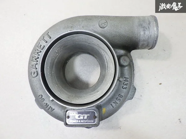

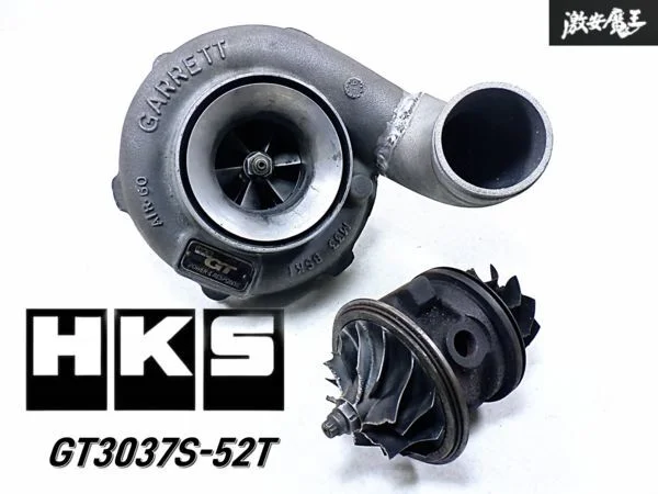

Turbo could be anything. Find the part numbers on it which are either on a tag on the core or a tag/engraved on the compressor cover. I can see HKS on it. The compressor cover looks like T3 style. This one kinda matches:
If so that's gonna suck to drive below about 3000rpm. It's way oversized.
That's definitely it. Makes sense, because when I rev to 3000 this thing is like a rocketship.
