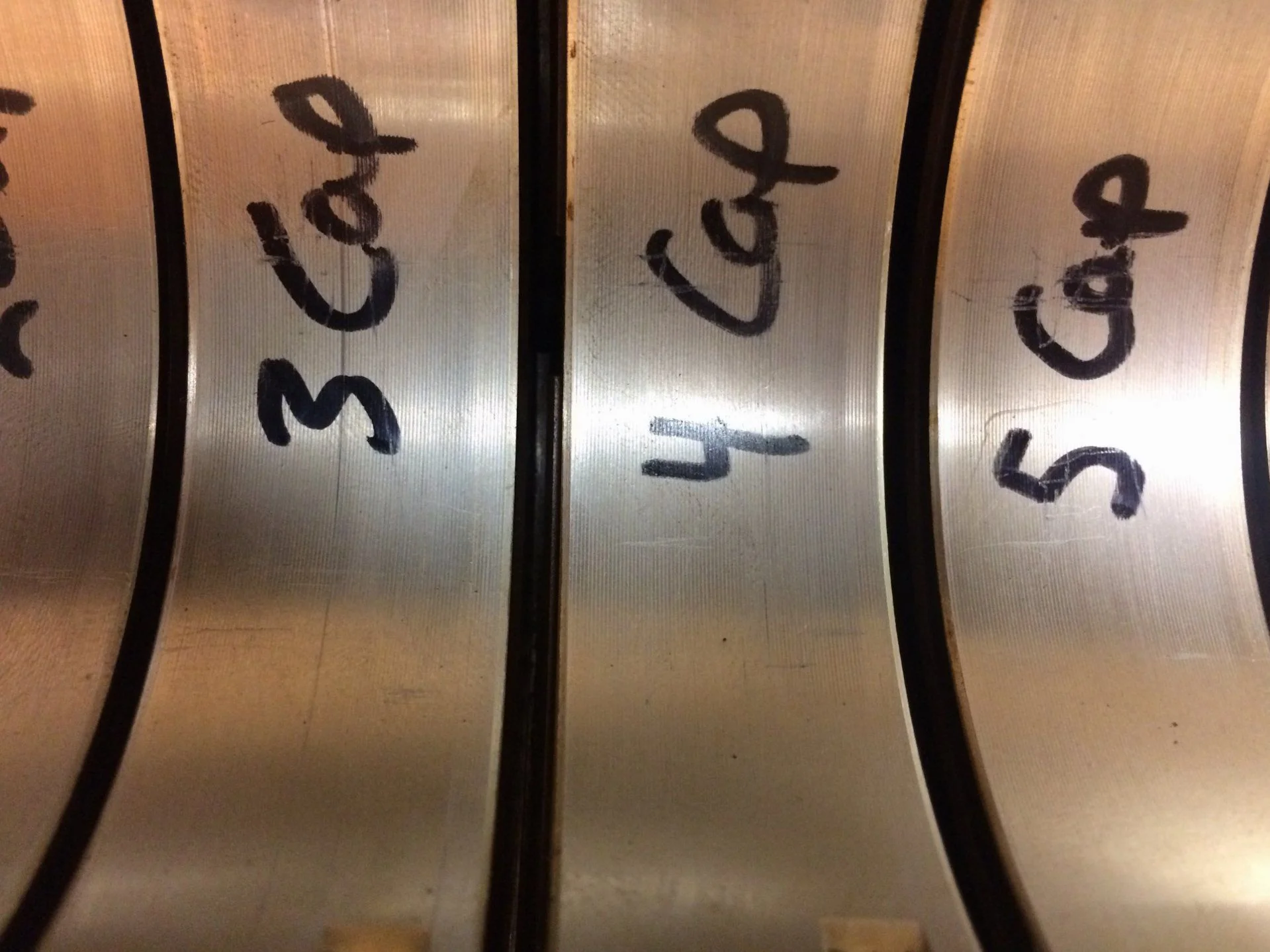

Lots of measurements. Crank is awesome in many ways, lacking in two (discuss later). main bearings are perfect, like new. See pic and all were identical, both cap and bottom. Any scratches are just from me.
Very good reason for this:
Crank was dead straight, I mounted in block on front and rear bearing only as I don't have any V blocks. I tried and tried but I could not get even 1/10,000 of runout on any journal. Exceptional.
Then I measured crank main journals with a micrometer, each one measured on 4 axis, I won't post total results as each one came out identical at 68.97 mm. Also exceptional and is why bearings were perfect. However a crank marked #2 should be a journal of 68.988-68.994 so I must be doing something wrong, micing too tight?
I also bore gauged all the journal holes but I have to recheck as the oil clearance is not making sense. Will calibrate my mic and bore gauge and check again.

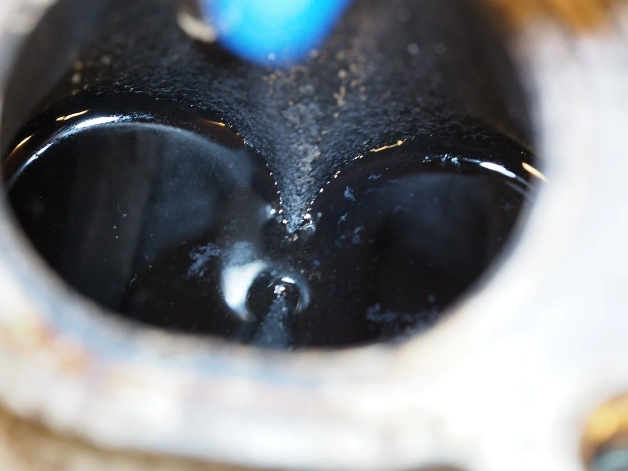

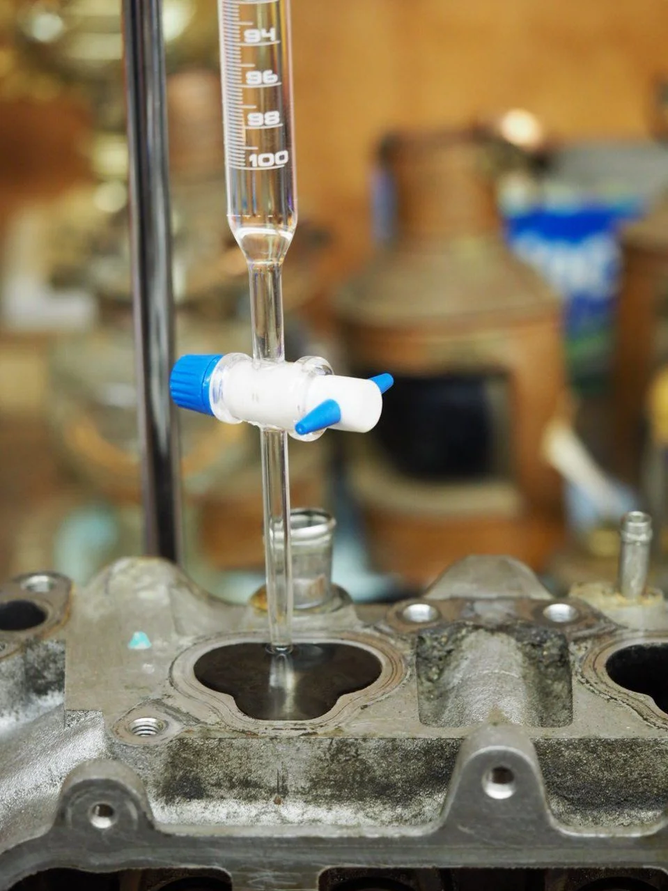

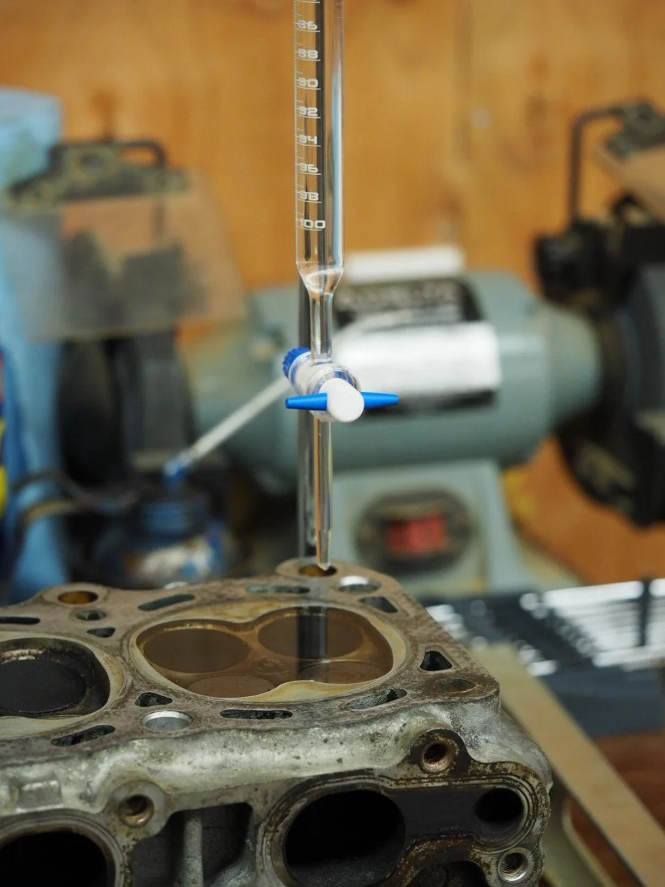

Before I left I cc'ed some volumes, only did one of each as I will do all when matching during build. Might be out a bit as I didn't use a cover, but probably by not more than a cc or so.
Combustion chamber 72 cc
Piston dish 13 cc
Individual intake port from valve to port divider 36 cc each
Intake port above divider (services both valves) 40 cc
Total intake port 112 cc
Individual exhaust port from valve to port divider 22 cc each
Exhaust port above divider (services both valves) 52.5 cc
Total exhaust port 96.5 cc
Interesting stuff, I guess they are after speeding velocity until divider and then improving flow., for better low end. Anyone ever flow tested a stock head? If so send me results please.
With these numbers, and 0.053 gasket at 101mm. and 0.005 below deck piston (an average of all my measurements), I get a static compression ratio of 8.7/1.
If we input stock cam specs ( IVC @ 9 deg ABDC) the dynamic (actual compression ratio) is 8.5/1.
If I use a stage 1 (mildest) aftermarket cam spec (IVC @ 39.5 ABDC)the Dynamic compression of 7.5/1.
Not sure my compression ratio yet but definitely more than this, although I must be able to run 87 octane for Baja so may have to adjust timing with octane rating or have water/meth injection.
View attachment 1478301 View attachment 1478302 View attachment 1478303 View attachment 1478304
Since you're getting picky with your measurements, @scottryana is right about the Lexan. With your method you're overmeasuring due to meniscus.
I will be doing it properly when I get down to the final build. I eyeballed and considered meniscus and I was pretty close to stock as that's all I need at this stage. I will likely be having to remove material from compression chamber so all that will be done after.

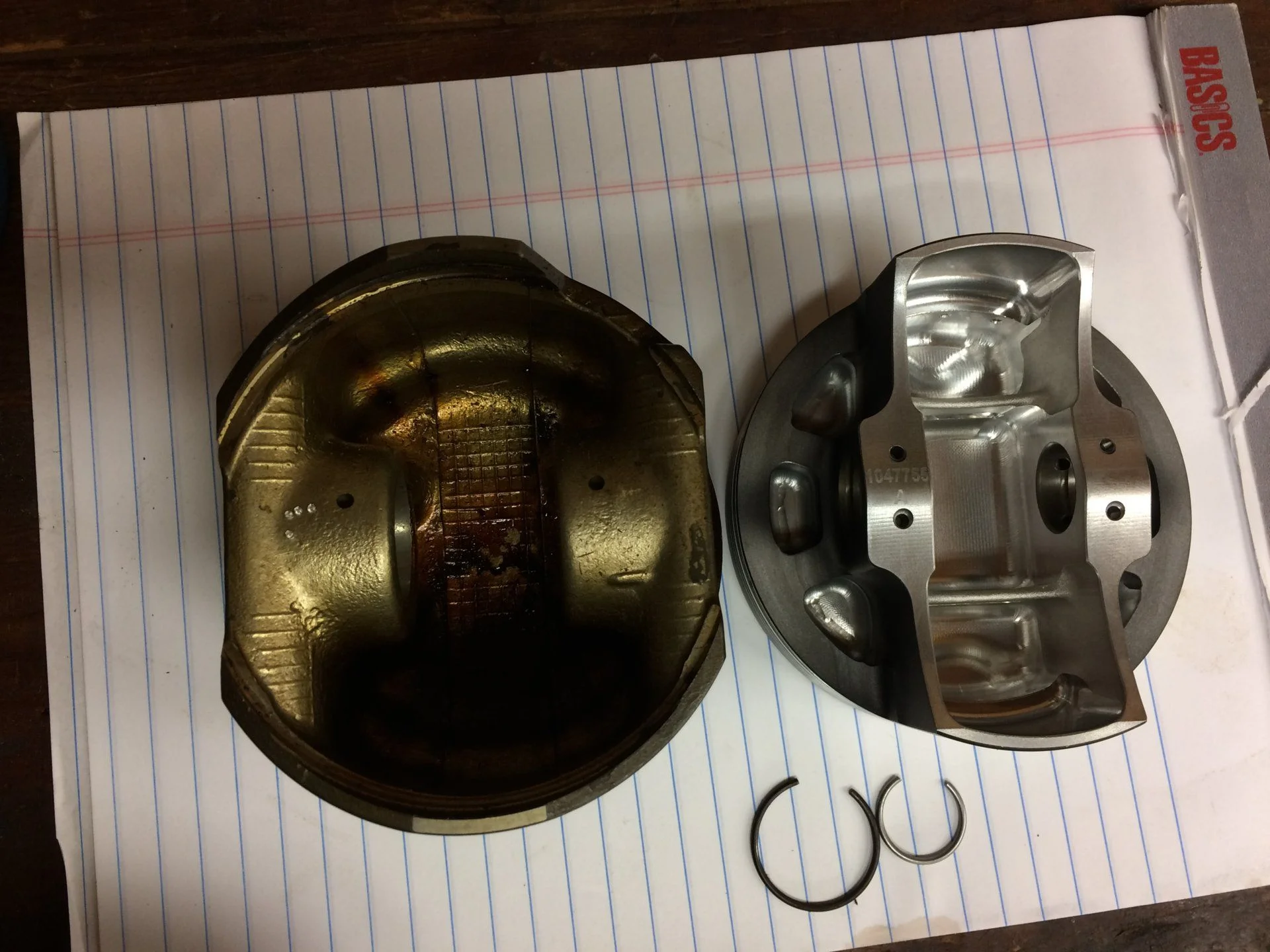

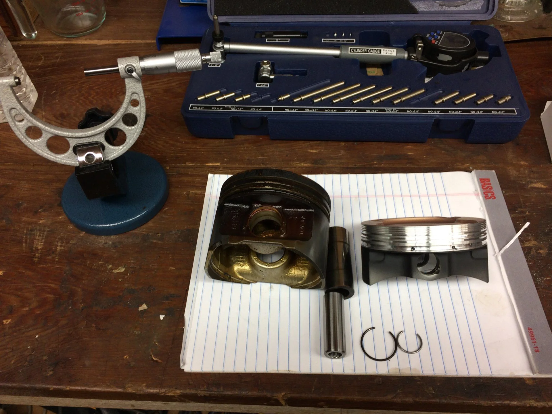

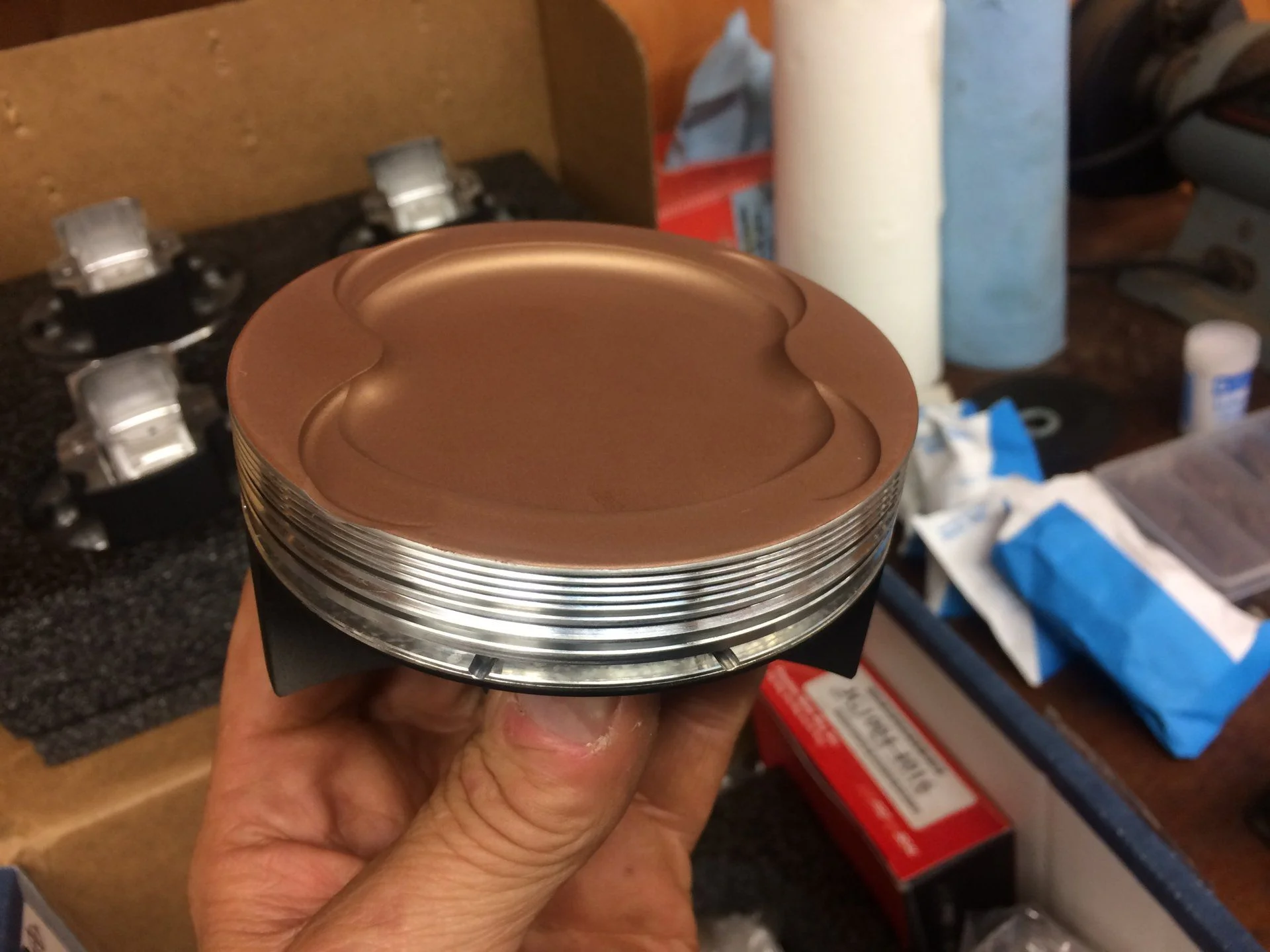

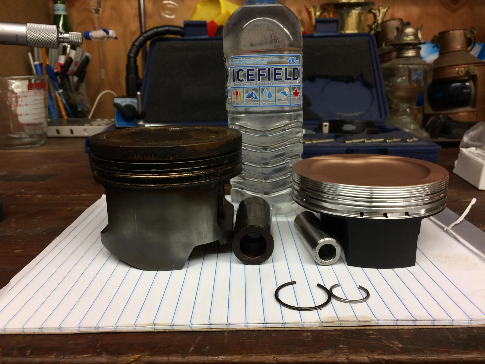

Custom (my design) JE pistons just got here, works of art and cost like art. 102 mm bore by 114 stroke.
Complete with pin, locks and ringset weight is at 456.6 grams as opposed to stock of 776.3. A savings of 319.7 grams per hole. Huge savings but it all looks so fragile compared to stock, hard to imagine it would have the strength and longevity of stock, but we will see.
That's a savings of 4.2 pounds of rotating mass, and titanium rods yet to come! Should be worth something, I hope. Pistons have heat and friction coating, land contact reduction grooves and more. Pins are oiled from oil ring holes, pin boss holes, and a slot from side. Larger dish than stock but haven't measured yet, trying for 10:1. I made skirts just narrow enough to clear oil squirters, JE said it would be plenty of skirt.
Rods and crank are still a few weeks out so won't be able to do much until mid January as I am off to Baja again.
Haha! Yeah that pin looks so ridiculous compared to stock! What size is that? 0.828" I just picked up another set of rods for another project with C350 pins that are only 0.787" and you are absolutely right compared to the 1FZ stuff it looks completely anemic!! Looks great.
