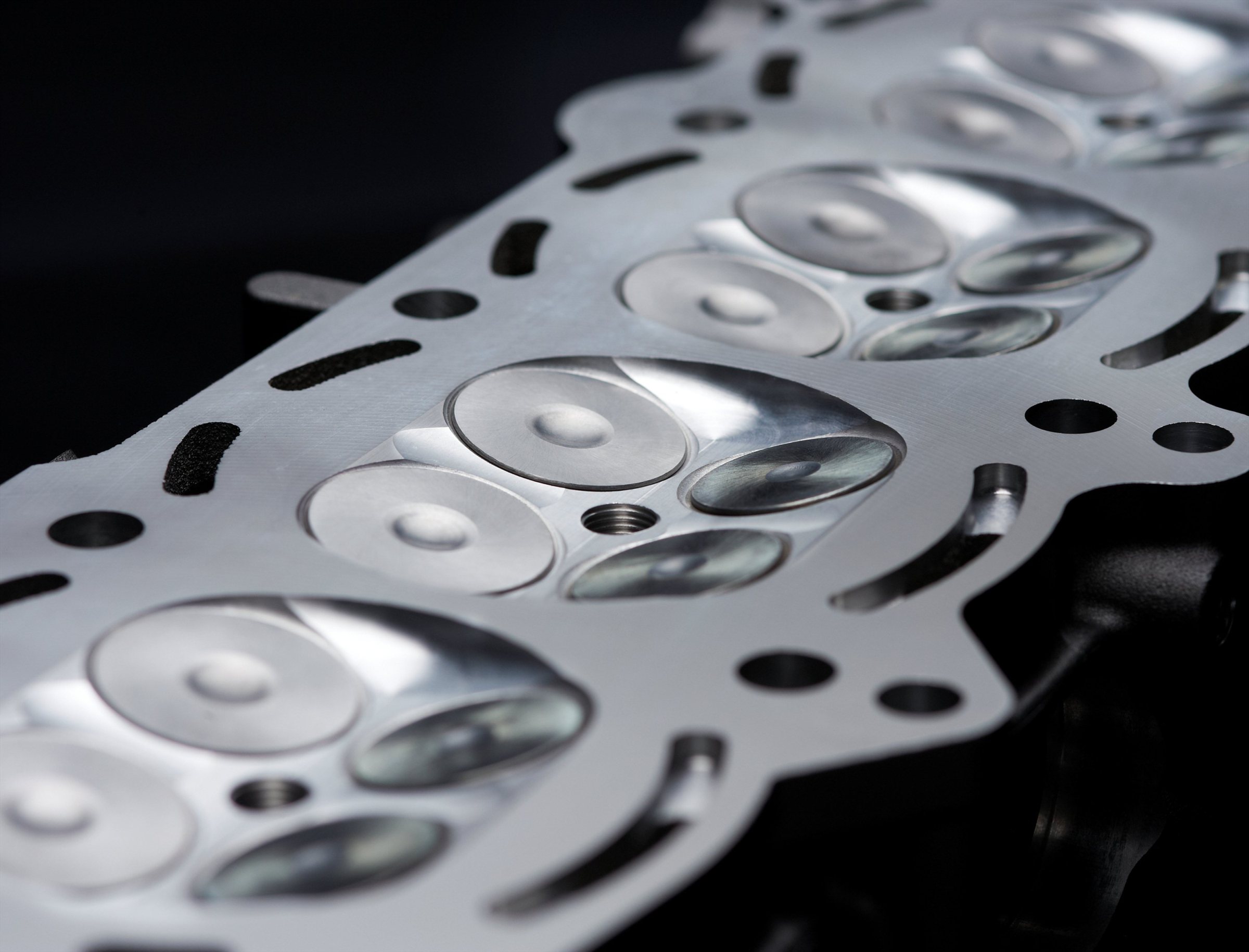

Is that a pick of GEN 2 head? No free drop there, quite a bit on gen 1
Did you get my pm regarding sending you valves?
Wonder what the combustion process would be like comparing flat tops with squish to flat tops or domed with a pent roof that matches bore size? Way too scientific for me to figure, l will do what is easiest and hope it's right
No that isn't a GENII head it was just a pic of a high performance multi valve head I had saved. Haha.
This is a GENII head. Ironically the squish pads are not gone, but they are machined away to allow better flow and no squish. I imagine removing them completely would have dropped compression too much?

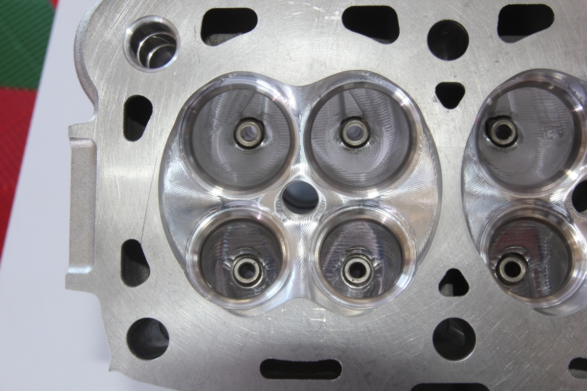

Not sure if you noticed but on stock chambers there is an undercut lip around intake valves. I was pondering this and it looks like it might help create some swirl or tumble. I think they had a reason for this, otherwise why not just cut flush. Think I might try to keep or create this.
Just ordered a nice electric flex cord grinder and can't wait to get started. Need something to do while waiting months for parts!
I did notice, and I am not sure how easy it is to see on a used head but on a new head it appears to just be from the post casting machining, I don't think it was intentional. I tried to get a decent photo showing the machining and you can see the bunch of aluminum missing from the head and then the undercut just appears to be from the valve seat. I didn't go out of my way to get rid of it, but the machine shop will machine quite a bit of it out to fit the larger valves.
Sorry, wasn't looking at area below the seat. I was talking on the chamber wall above the seat.
See photo, you will see the shadowed area. Looks like incoming flow will hit this area and be forced along curve aiming it to centre of chamber, it is very pronounced. Only on intake which makes sense. Looks like definitely on purpose or maybe just to increase squish area?

Oh that's not my head! That's a new Ford Mustang GT350R head. It is fully CNC'd from the factory. But our head has the same general shape, and just opening it up a little will unshroud the valves and keep some of the squish area.
