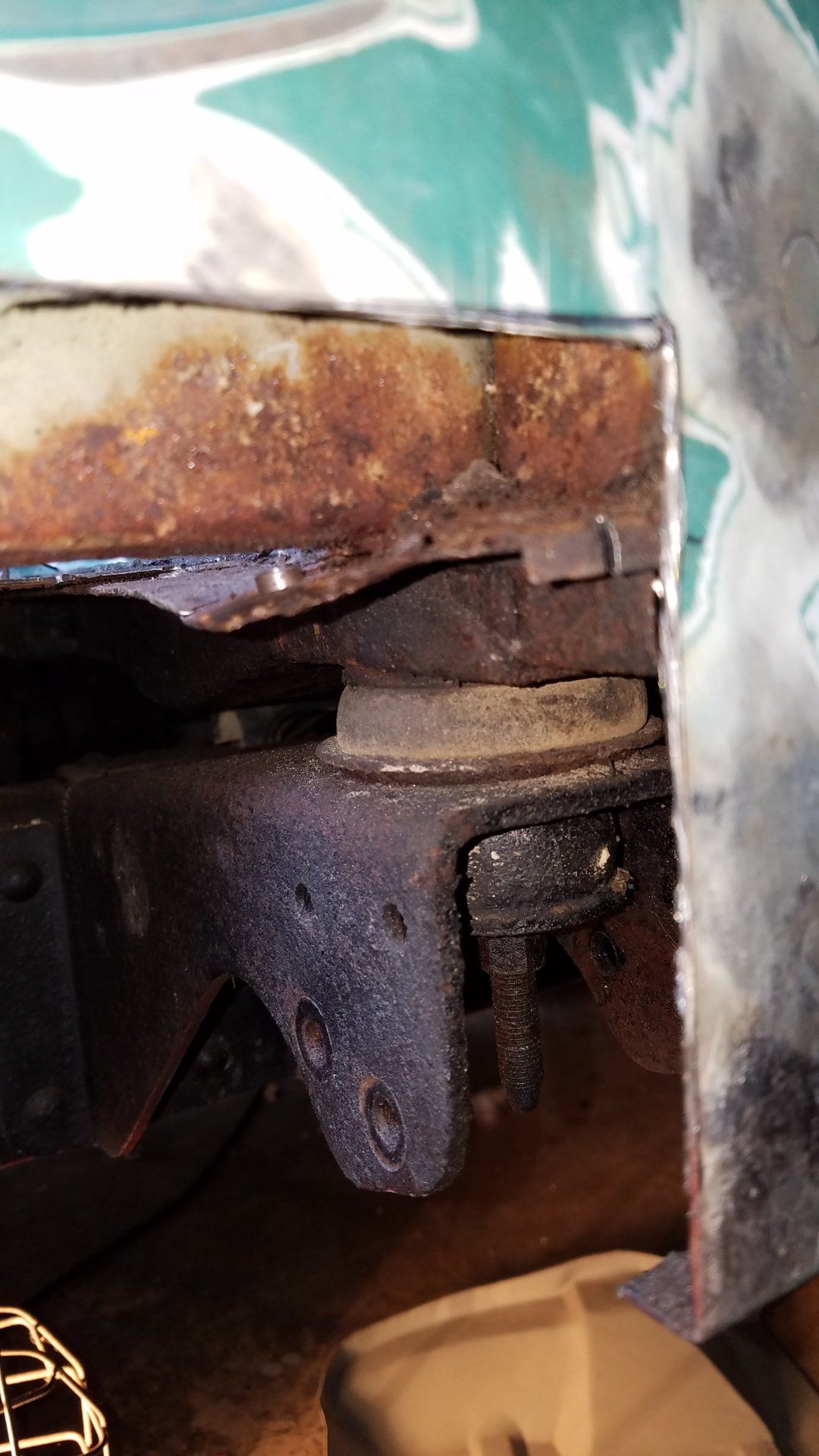

Save this part... floor board mounts on top of this, but under the rocker.
The following a pics from underneath. With my head towards the front .
Because I can't find all of the spot welds... this is as far as I got.
I don't want to start hacking away at it...
I would get shot on site if I tried that in kaliforniastan.
Im thinking along same lines...

Any advice or detailed pictures would be appreciated on my rocker panel / floor board removal.
Mine was bad....
I cut everything out, and that made it a lot easier.
turned out great!
It might be hard to see what I have going on. But I just did one step at a time. Did the floor board piece first, then the inner rocker piece second, and then the outter rocker panel last.
@Couse44 thank you....
Yes, I can see your progression. That's what I needed to see. I think I'm going to have to cut out more than I wanted too, just to be able to do it right. Well as close to right as possible.
I was able to work my way slowly through the spot welds under my inner rocker with a cold chisel and hammer. I then went through and cleaned up the good metal with a flap disk.
