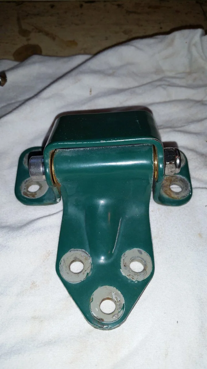

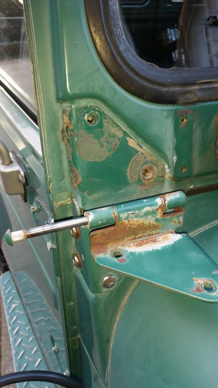

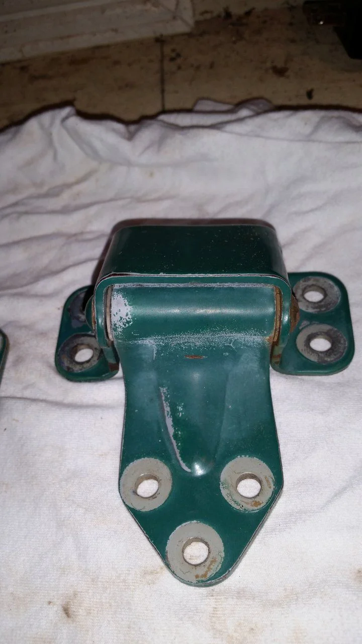

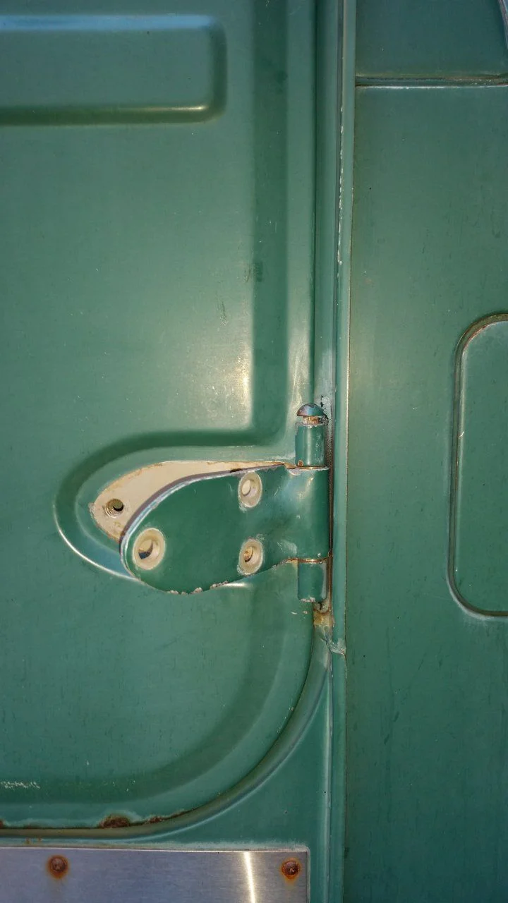

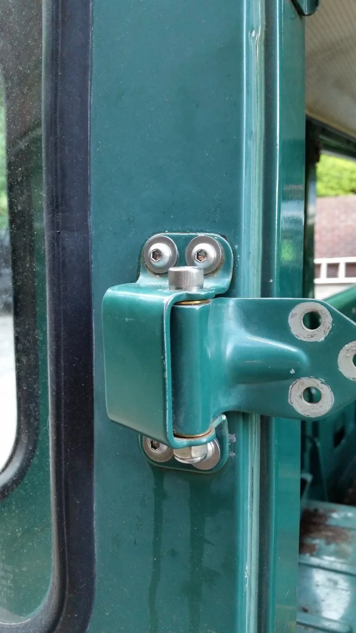

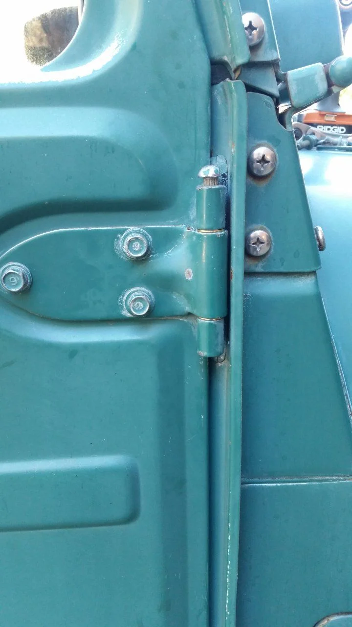

Also ground off half the top of the pins so they would clear the windshield frame
I also changed out the ones on the ambulance doors.

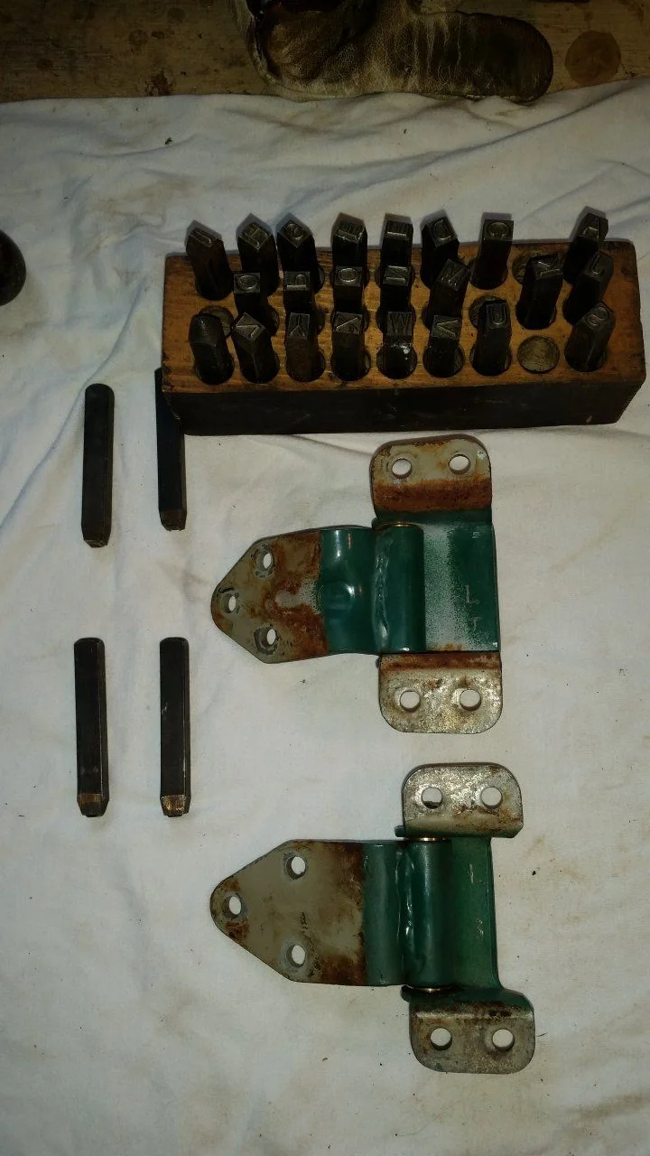

Which required drill out the pin. I was ok with that because I wanted to install a bolt as the pin anyway. My goal was to be able to remove the amby doors without having to take off the hinge bracket from the body. That way when I do take the amby doors off I don't have to realign the doors.
When I disassembled the hinges I stamped them so that I knew left from right and top from bottom..:hillbilly::hillbilly:

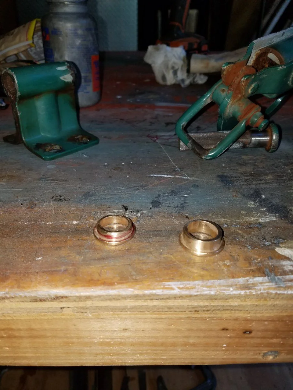

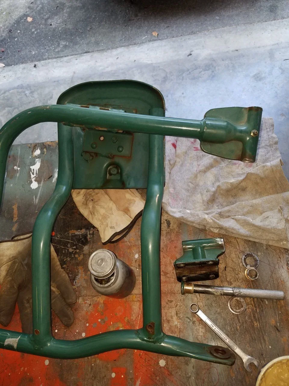

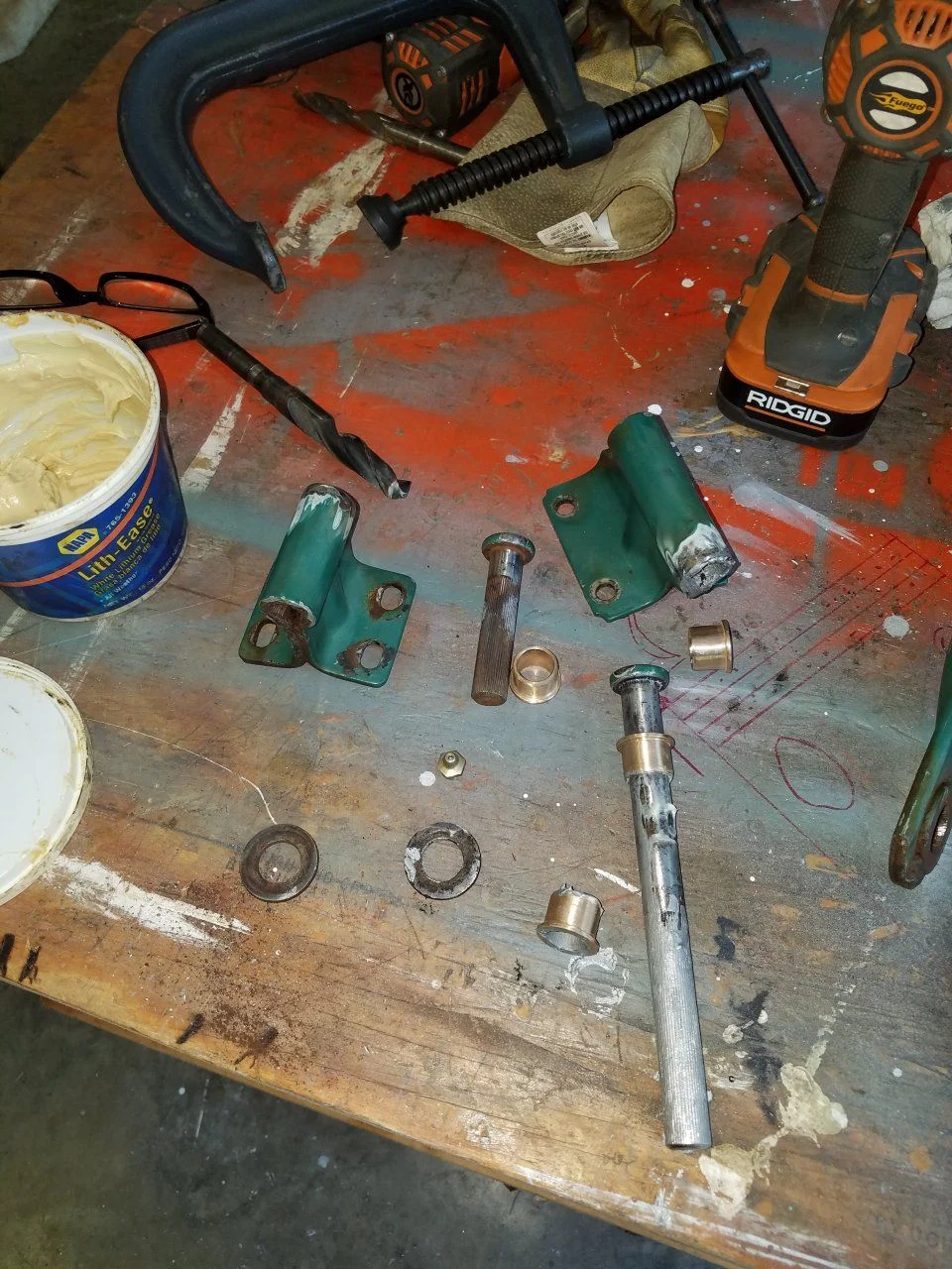

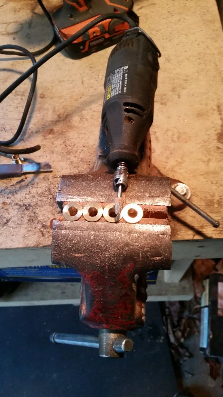

I also changed out the bushing in my spare tire carrier.

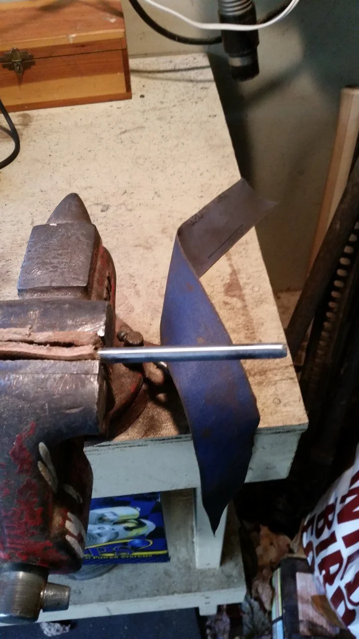

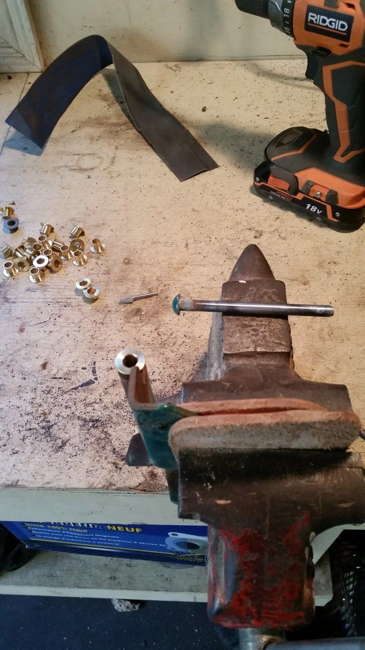

The hardest part of that was driving out the pins... I did not have a BIGGER BFH so I took my carrier to Gene, our mechanic, and he put the ole "air hammer" on it!! That did the trick!!:bounce2:
Note: The "Air Hammer" is the only way to go. ;)
Trying to drive out the pins with a BFH was only gaulding the ends of them, making the process even more difficult. :crybaby:
I also added a grease zerk to the upper hinge.. hopefully it will help keep them new bushing nice and greazzy..:idea:

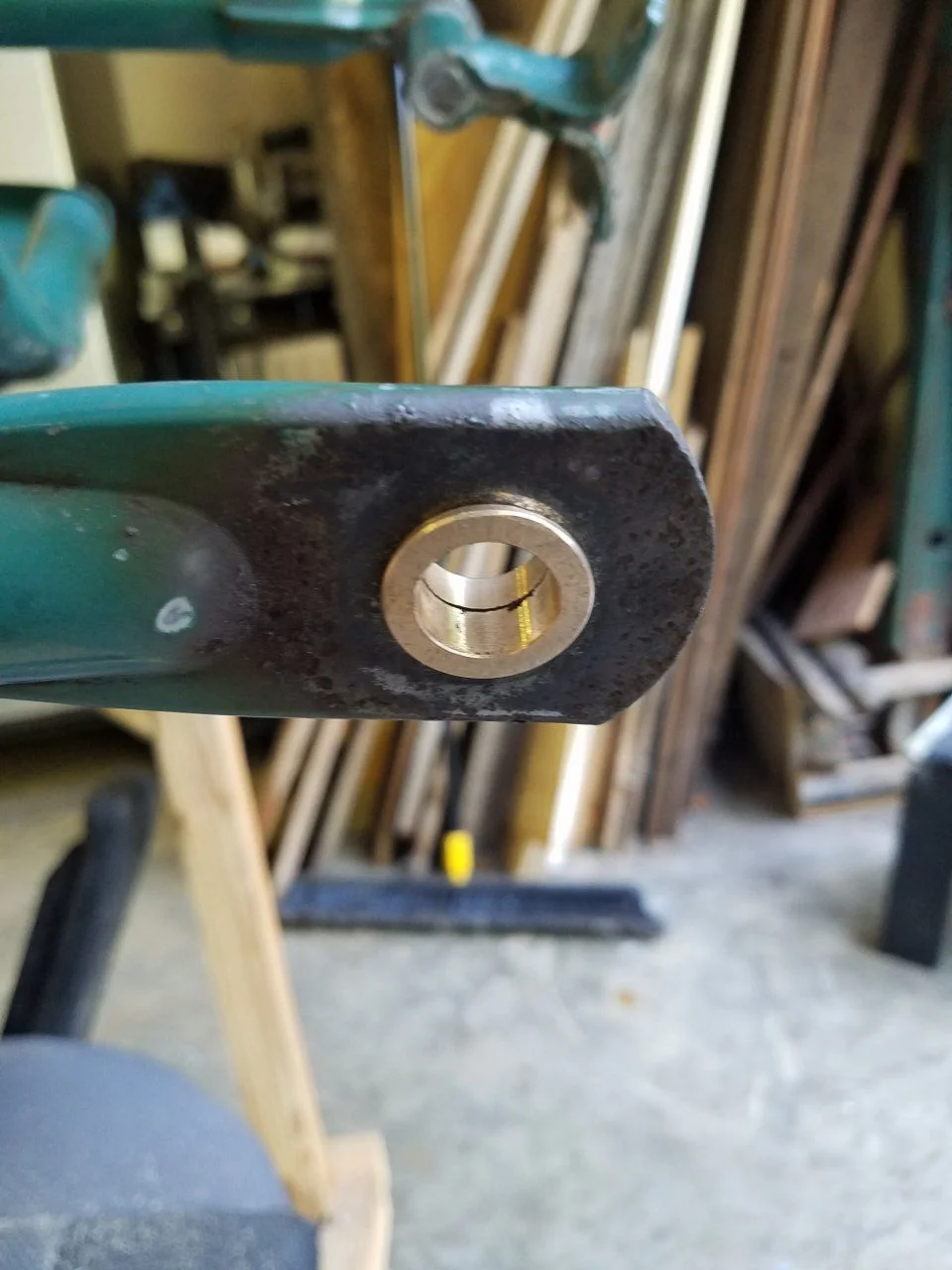

Bronze Bearing ---- McMaster Carr Item # 5448T19 Multipurpose Flanged Sleeve Bearing 16mm shaft dia, 20mmOD
EDIT:
Link to the BRONZ BUSHINGS ----https://www.mcmaster.com/#5448T19
16mm ID x 20mm OD x 16mm length by 2mm thick.
The pins in my carrier are 16mm dia and the hinge is 20mm dia.

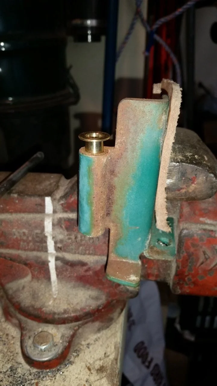

I cleaned everything up good and used my vice to press everything back together.
The bushings only go into the tube part of the hinge, they will not fit in the part that mounts to the truck.

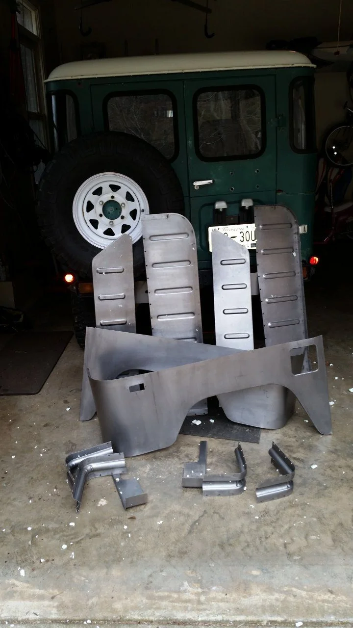

So here is my order of steel.
REAL STEEL
2 - full quarters panels
2 - inner fenders top and side
4 - fender braces
2 - side pieces for the back, 79' and up
CCOT
1 - Rear Sill
MUD MEMBER
1 - Bed Pan
2 - Rockers Inner and outer
2 - Front Floor Pans
