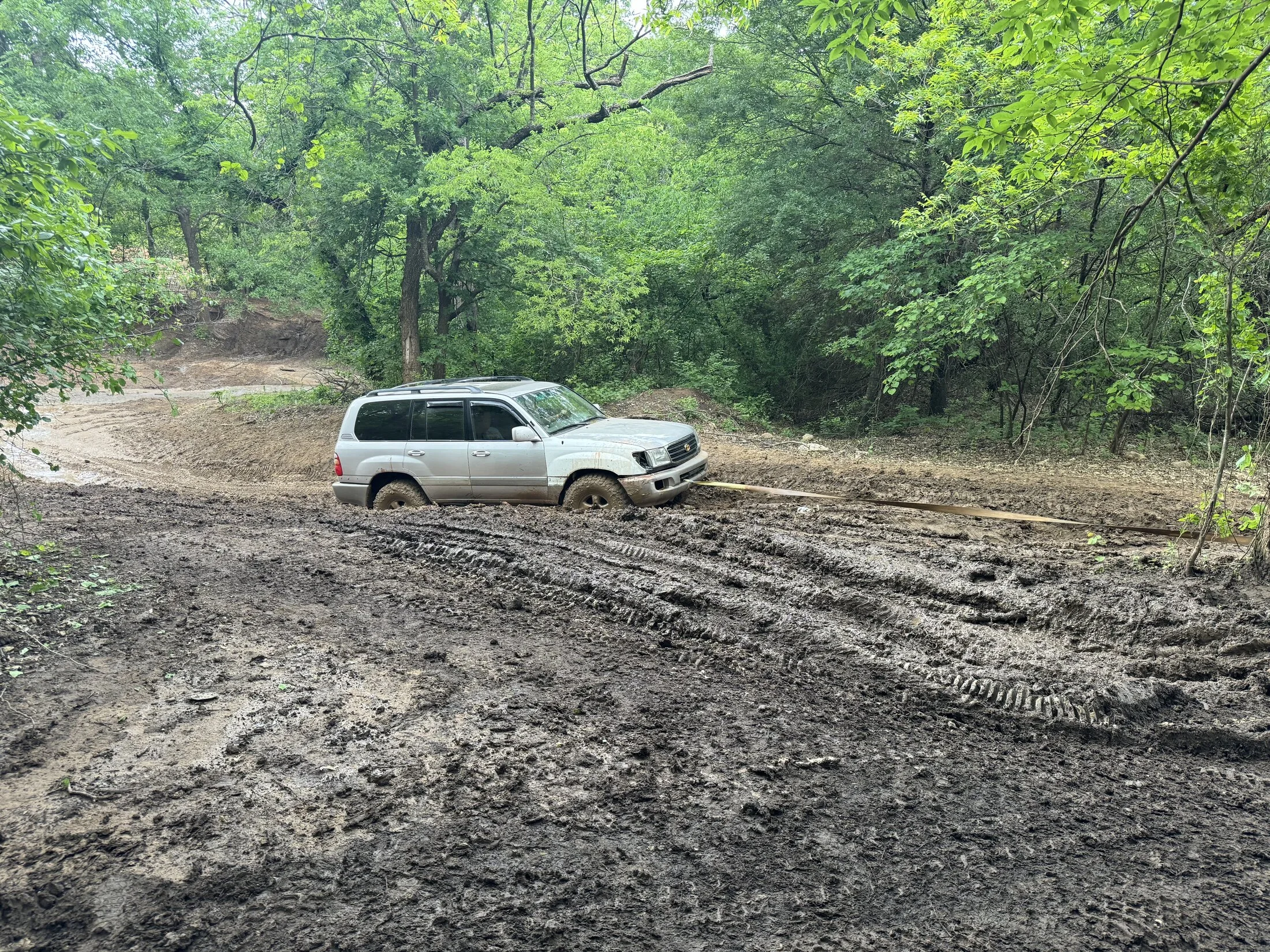

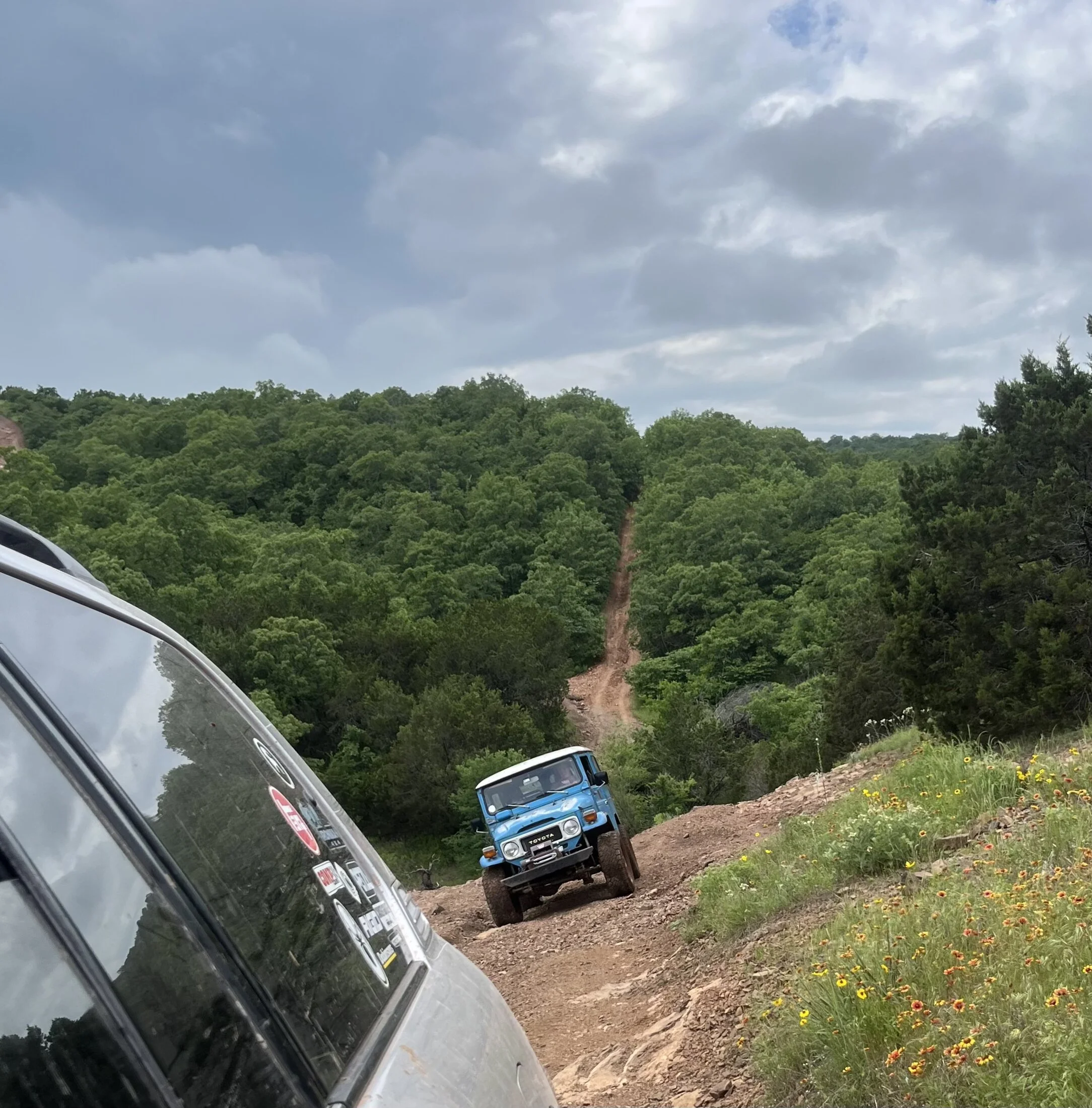

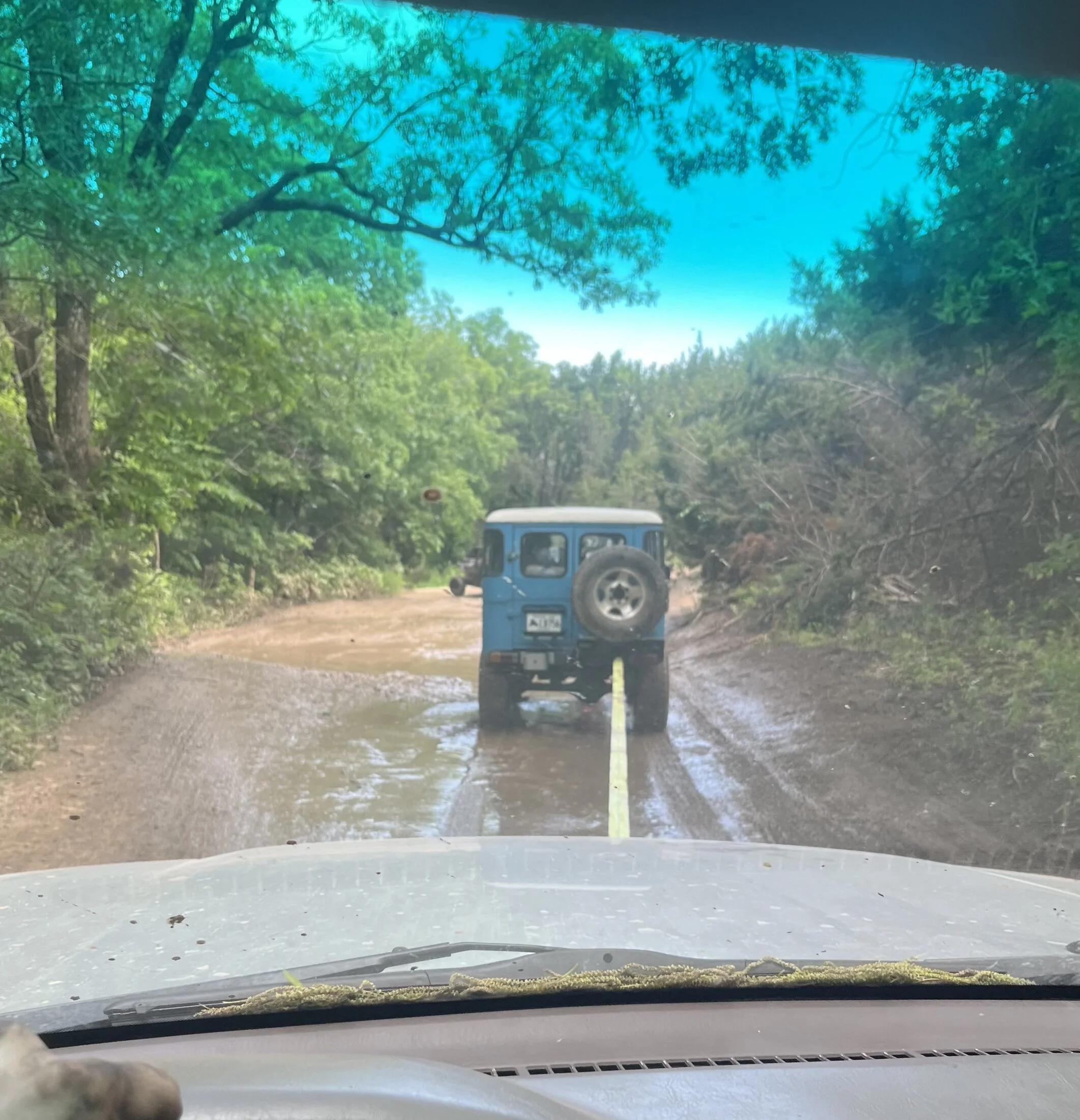

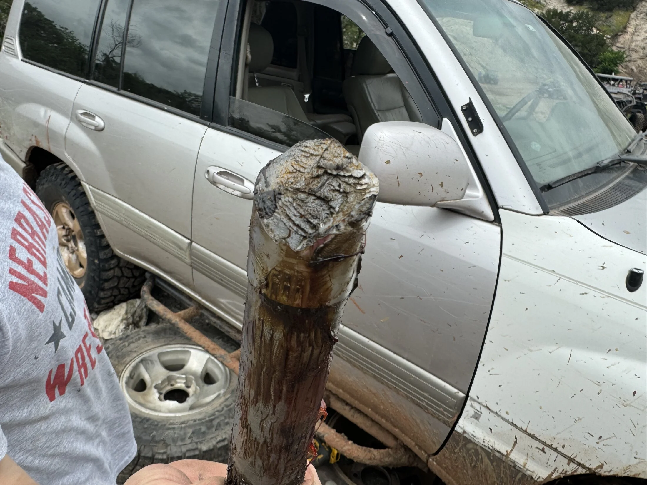

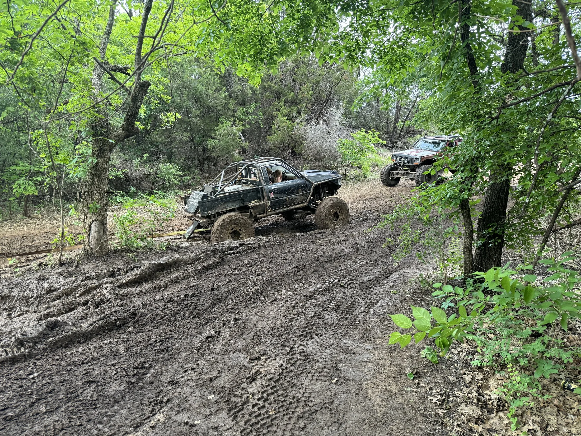

My buddy grenaded his cv shaft and transfer case on his 100 series. I had to pull him about 4-5 miles through the off road park with my 40. Other than getting whiplashed a few times when he caught on a rock the 40 did great!
This 1st gen Toyota had to pull him through a section that I couldn’t get up and I had to take a 15 min bypass that the 100 wouldn’t fit through while being towed.
Oh and this is the moment he broke his CV, transfer and almost rolled the 100 series.

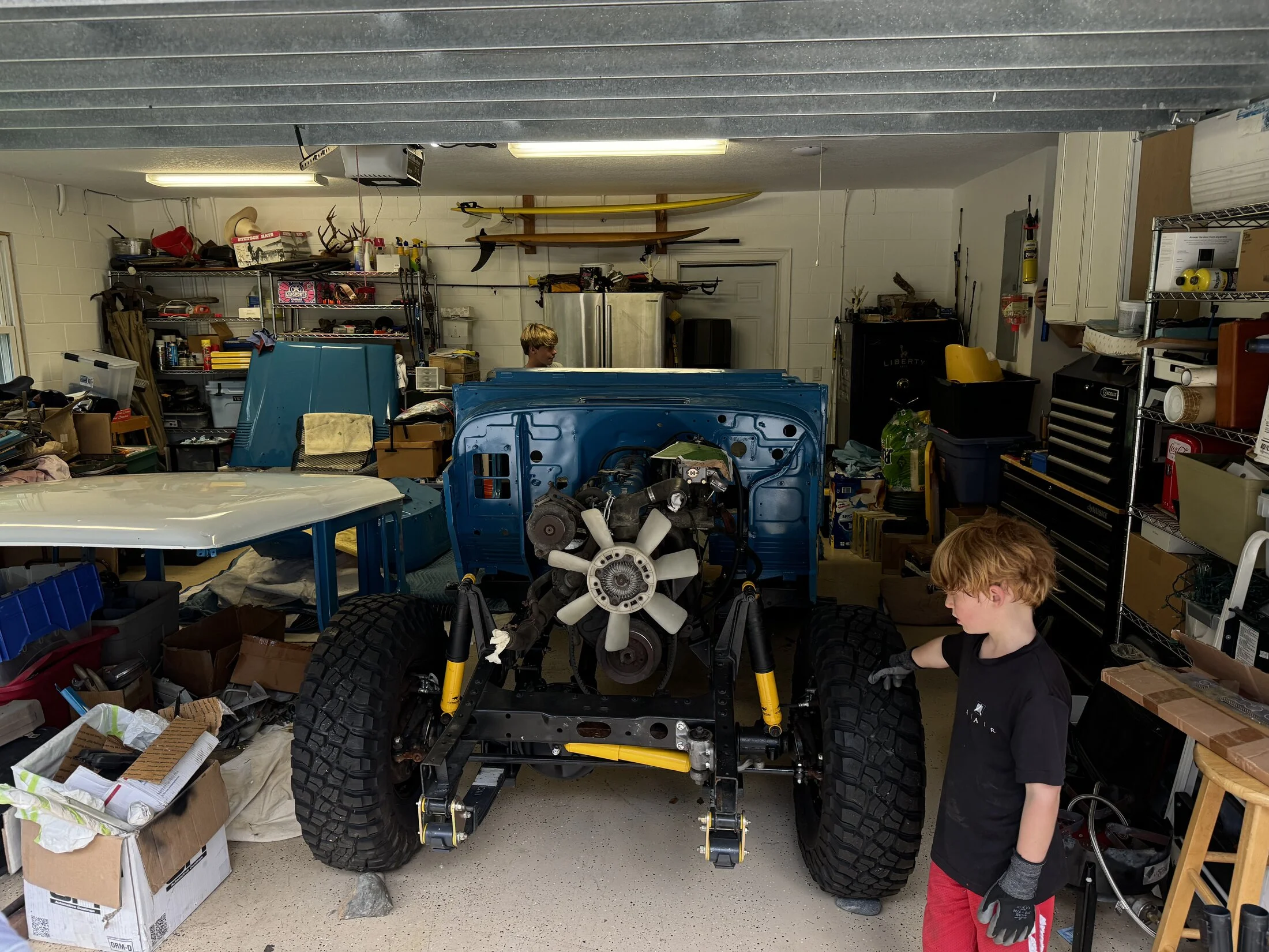

Last weekend I flew to Florida to help an old friend start to reassemble his 1973 40. It’s been disassembled for 10 years and for the last four the painted body has just sat in his garage.

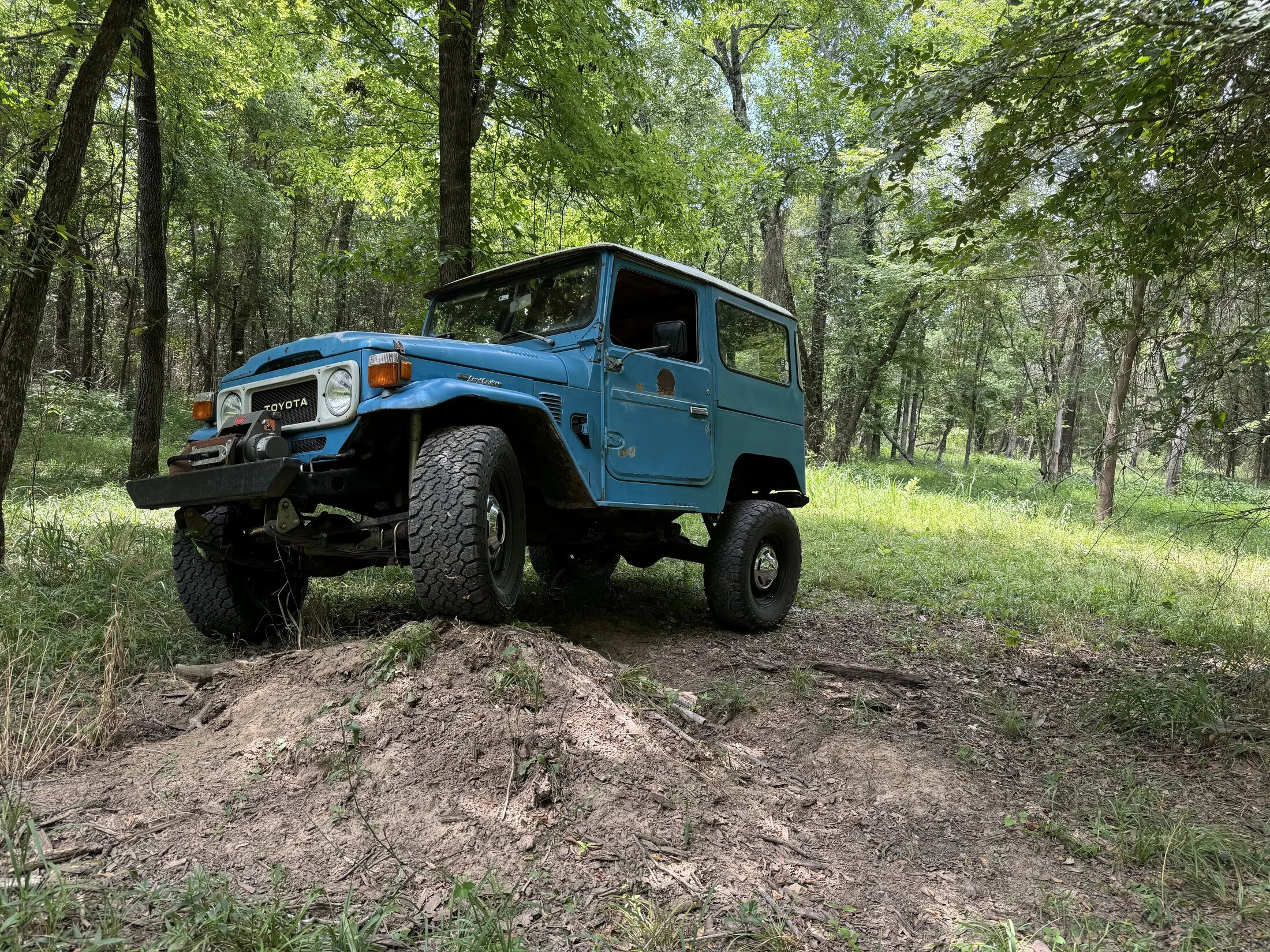

This weekend, I took the family down to a small town in SE Oklahoma for some fishing and exploring. We trailered the 40 there and it did well as the fishing rig.

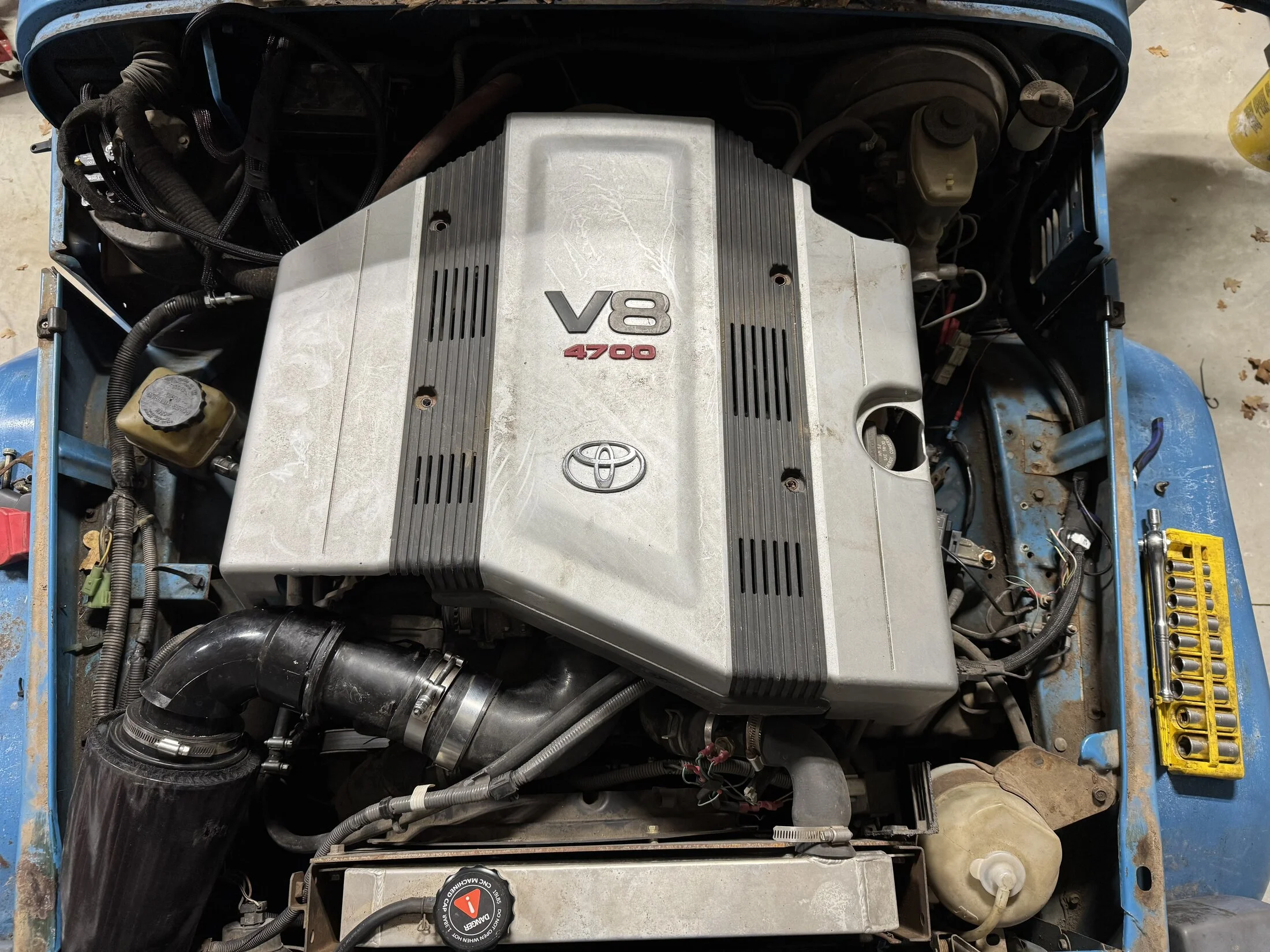

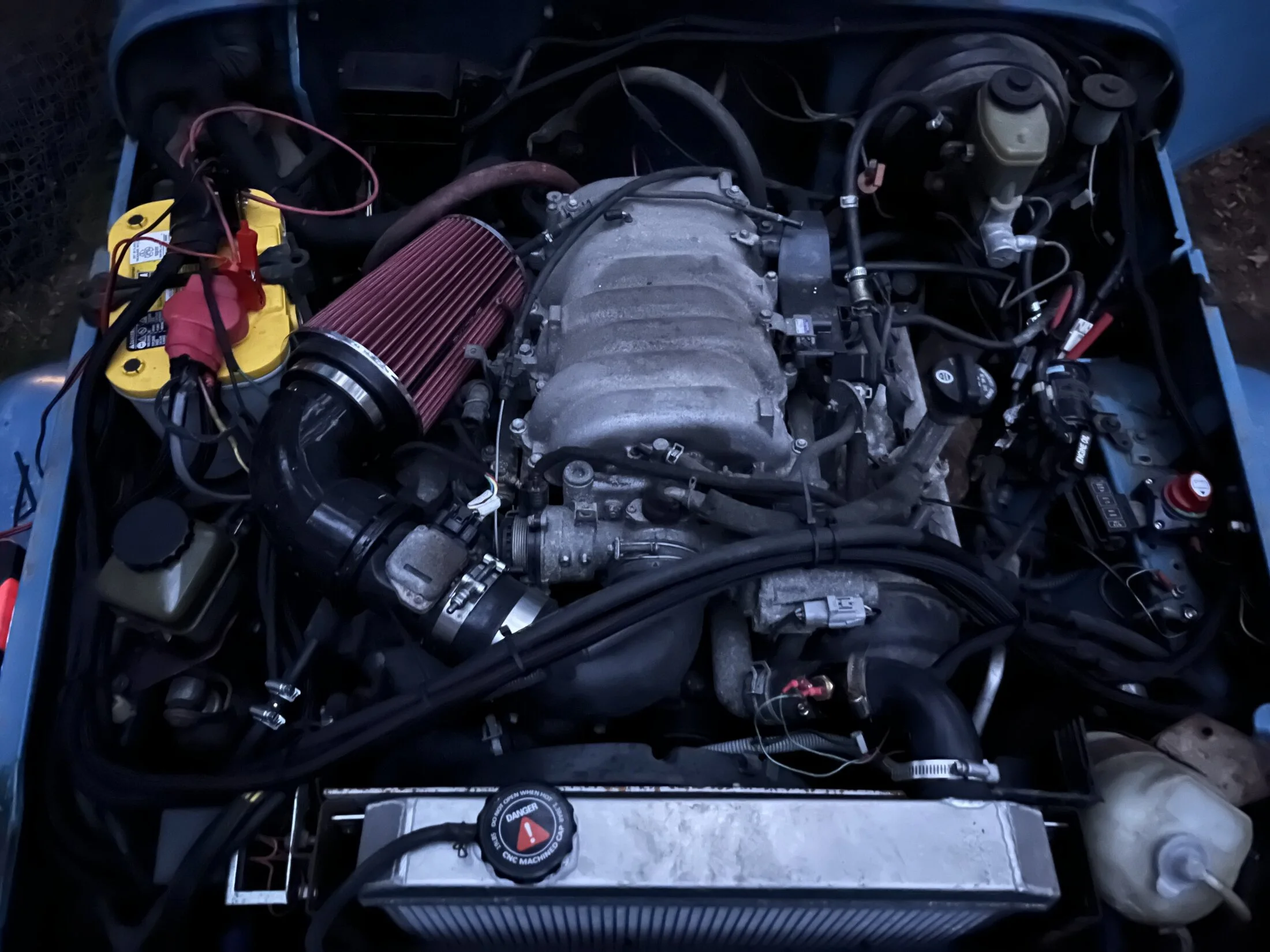

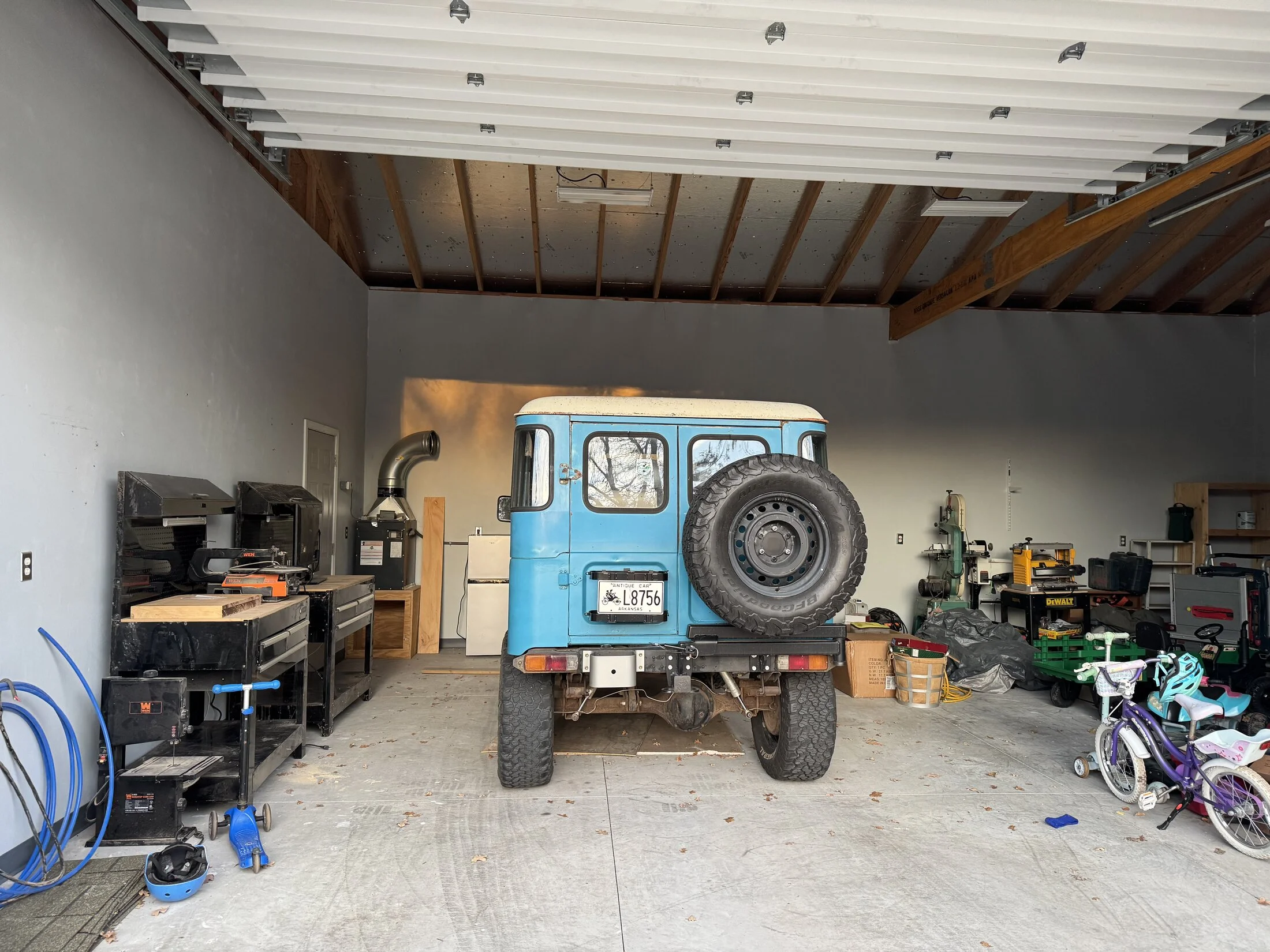

We’re at a point now that the house is finally getting settled. I slipped out to the garage for a bit to start reworking the wiring. I’m either going to mount the battery on the driver side or relocate it under the driver floor. It’s a 79 so there’s a good amount of space unused under the body there.
The main reasons to relocate the battery were
1) clean up my wiring mess
2) install an 80 series air cleaner.
I don’t think the 80 air cleaner will fit without a bunch of modifications to the fenders. I may go with a 2uz 4Runner intake.
This is from a few years ago:
This is from tonight:
Looks like if I want to put the 80 filter in I will need to remove the stock cabin fan.

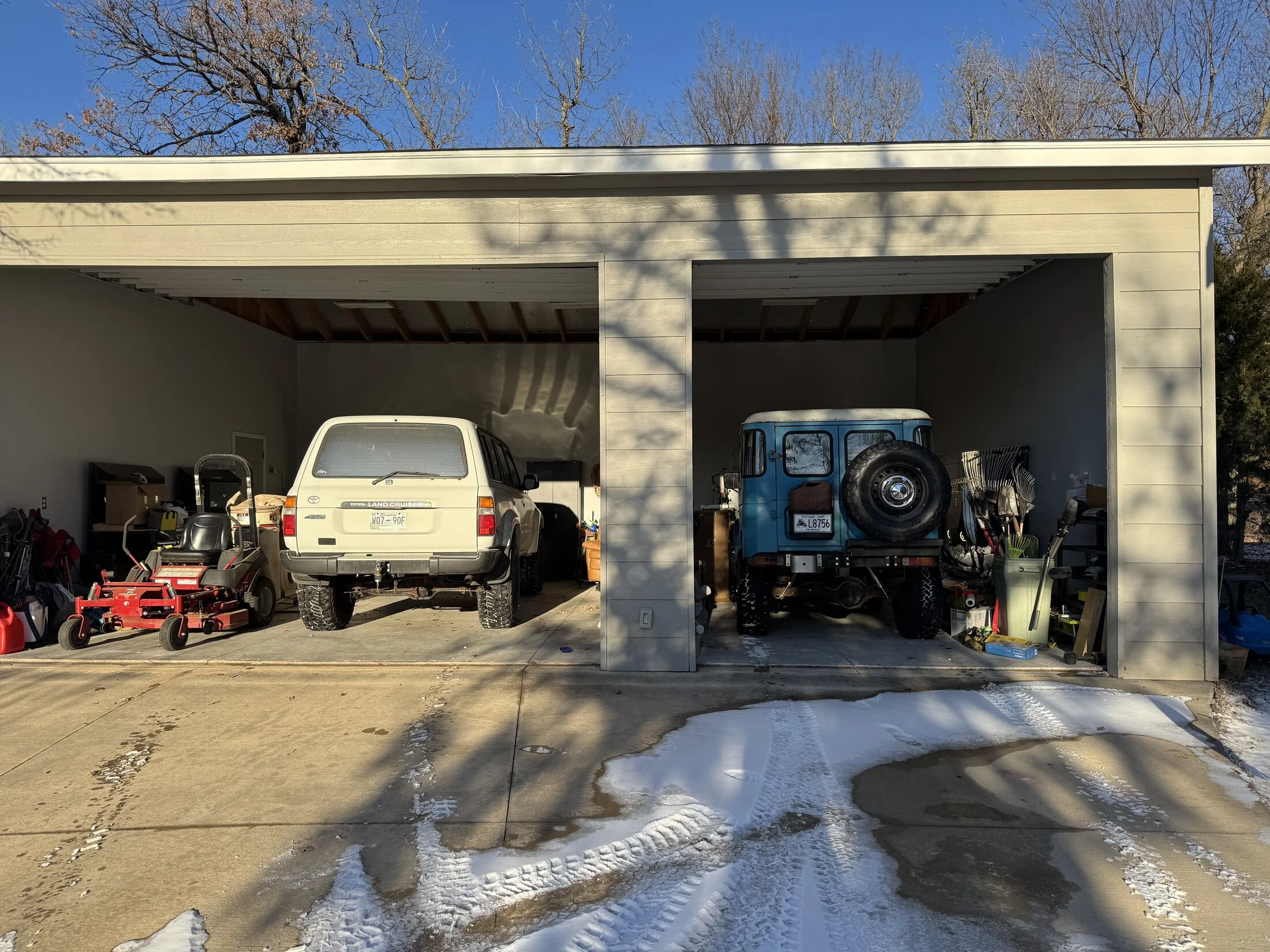

I took the 40 out in the snow and ice today. I wish I had a video of this, but while driving in 2wd I did a nice little 180. Luckily I didn’t hit anyone or anything!

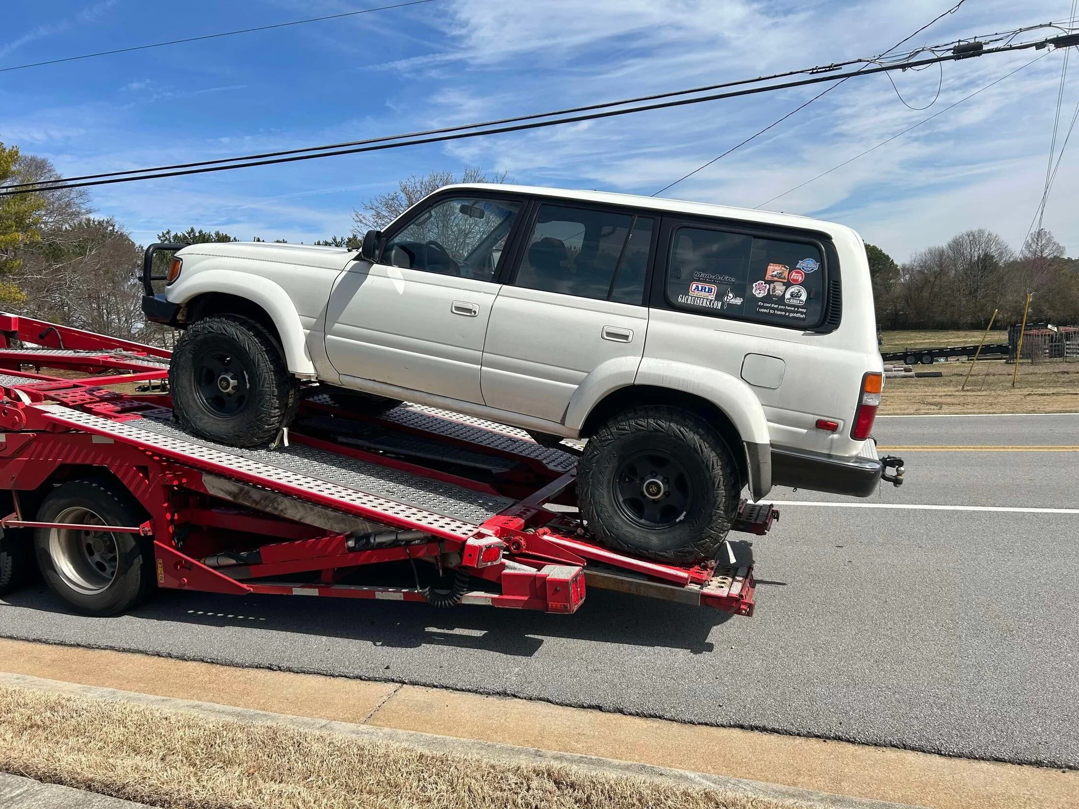

Oh, and this 80 is on the way to join the fleet.
