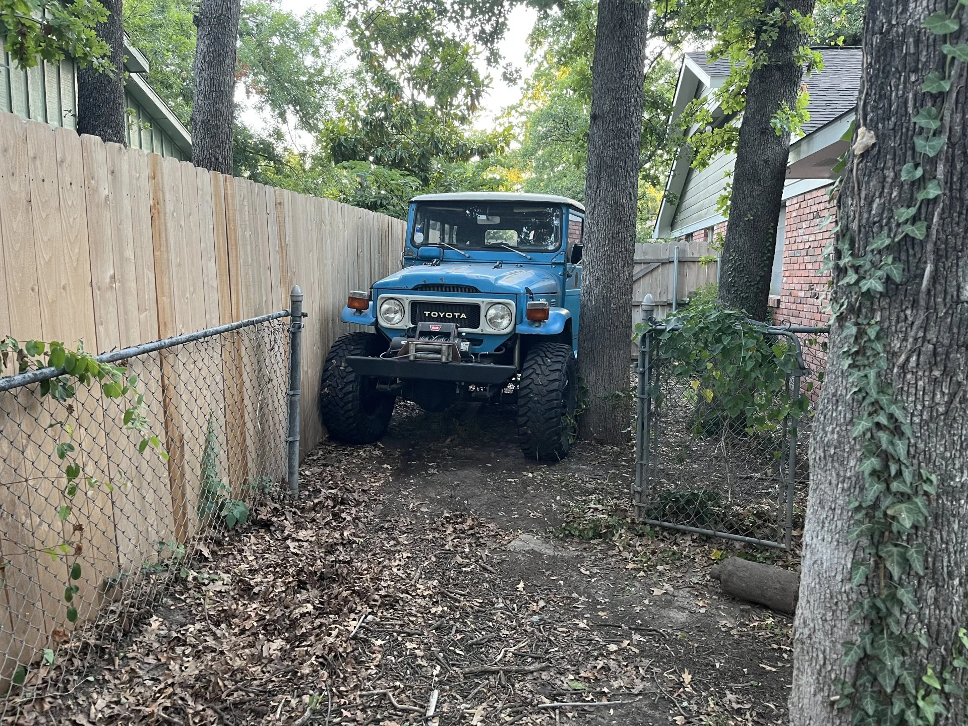

So my son is having his 2nd birthday party this weekend. It’s a “blue truck” party in our backyard. So I had to find a way to get my 40 back there.

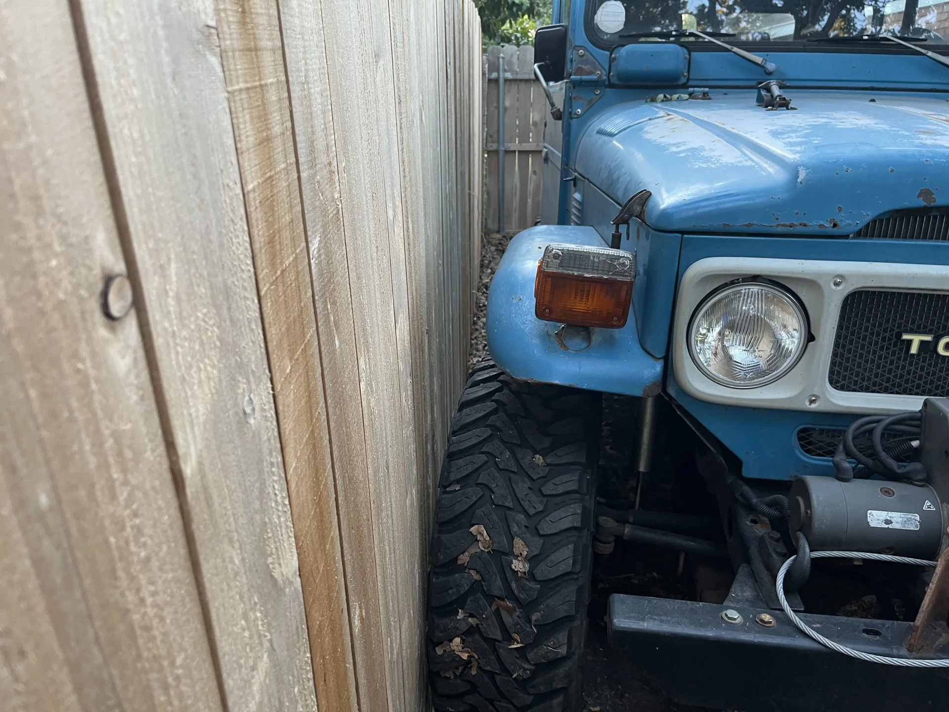

I measured and had a little less than 2” of “wiggle” room…yeah, I didn’t calculate for the angle it would come in at
Whoops! I wanted to take out that chainlink fence anyway, but even doing that I was pinned against a tree and the fence. Luckily, the wider tires pushed me just far enough off that tree!!
Success!! I’ll worry about the extraction after the party

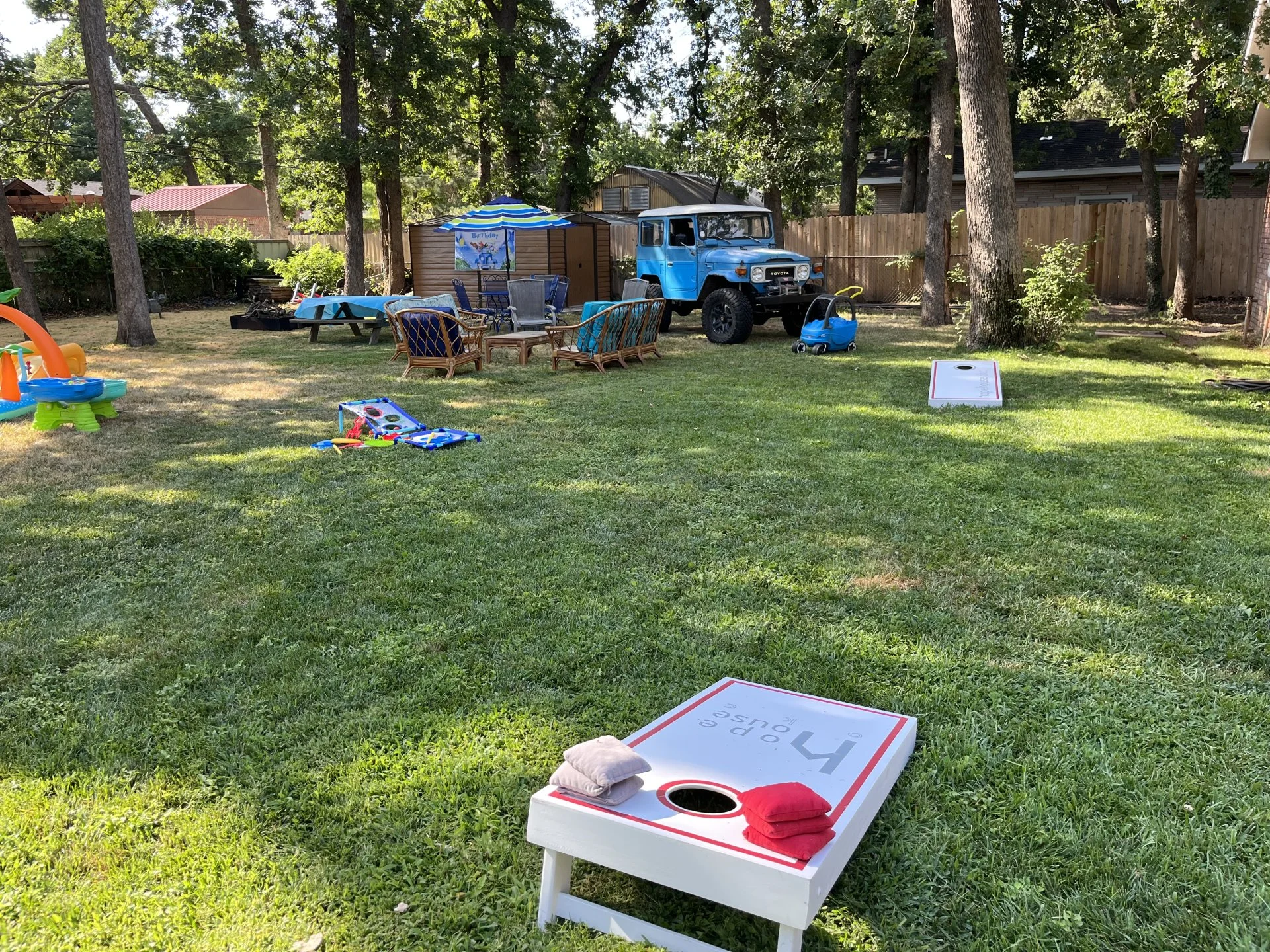

Birthday party was a success! We had a ton of kids crawling in and around the 40. Good times!

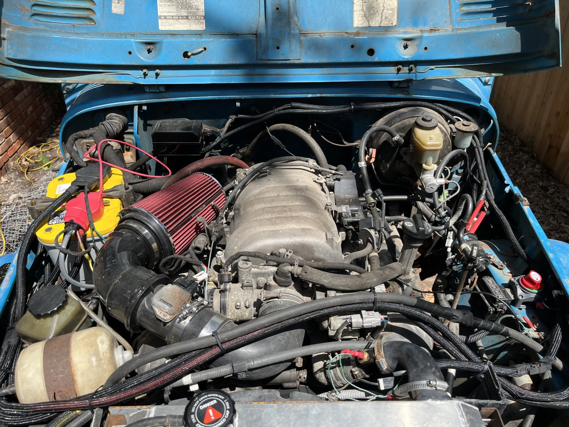

Afterward, I worked on the battery wiring some and threw the engine cover on for grins.
Ignore the temporary radiator overflow tank…

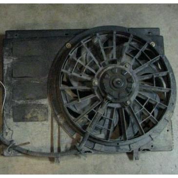

What are you using to supply and control the fan?
Toyota starter relay switched inside the cab so I can kill the fan if going through water. It’s a Volvo fan and relay setup so the Toyota relay only controls the main power to the Volvo relays. Main power comes through the 2uz high amp circuit that’s normally attached at the battery terminal.
Here’s the website I used to assist with the wiring.
I used that same site and basically the same hardware. If only my wiring skill was up to the hardware…
Electric fans are fully functional and the exhaust note sounds great!

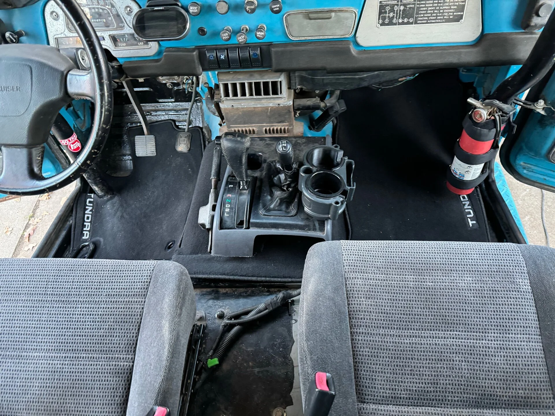

Found a loose connection at the switch for my fuel pump once I got it home. Also, I thought I had the cdl unlocked but it’s definitely still locked.
Edit @9:30pm. I tried a spare center diff lock to see if I could get that to work off the wiring that I have. Still no luck so I disassembled the one on the truck to unlock it manually. It smelled hot so my guess is that something is wrong with the wiring. I swapped in the spare and I’ll leave it unlocked for now.

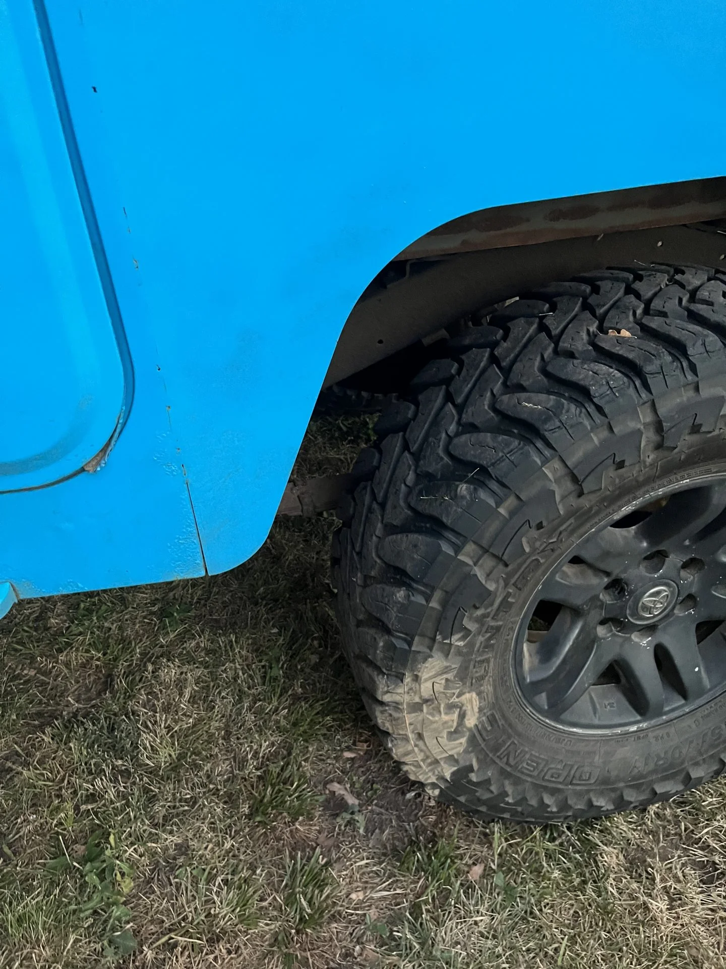

Changed the front back to SUA and left the rear SOA.
Painted the rear section with color matched paint
Installed 37s. Probably going back to 35s since I’m rubbing on the front fenders a TON haha
Bring it by! Definitely looks perfect on 37s
