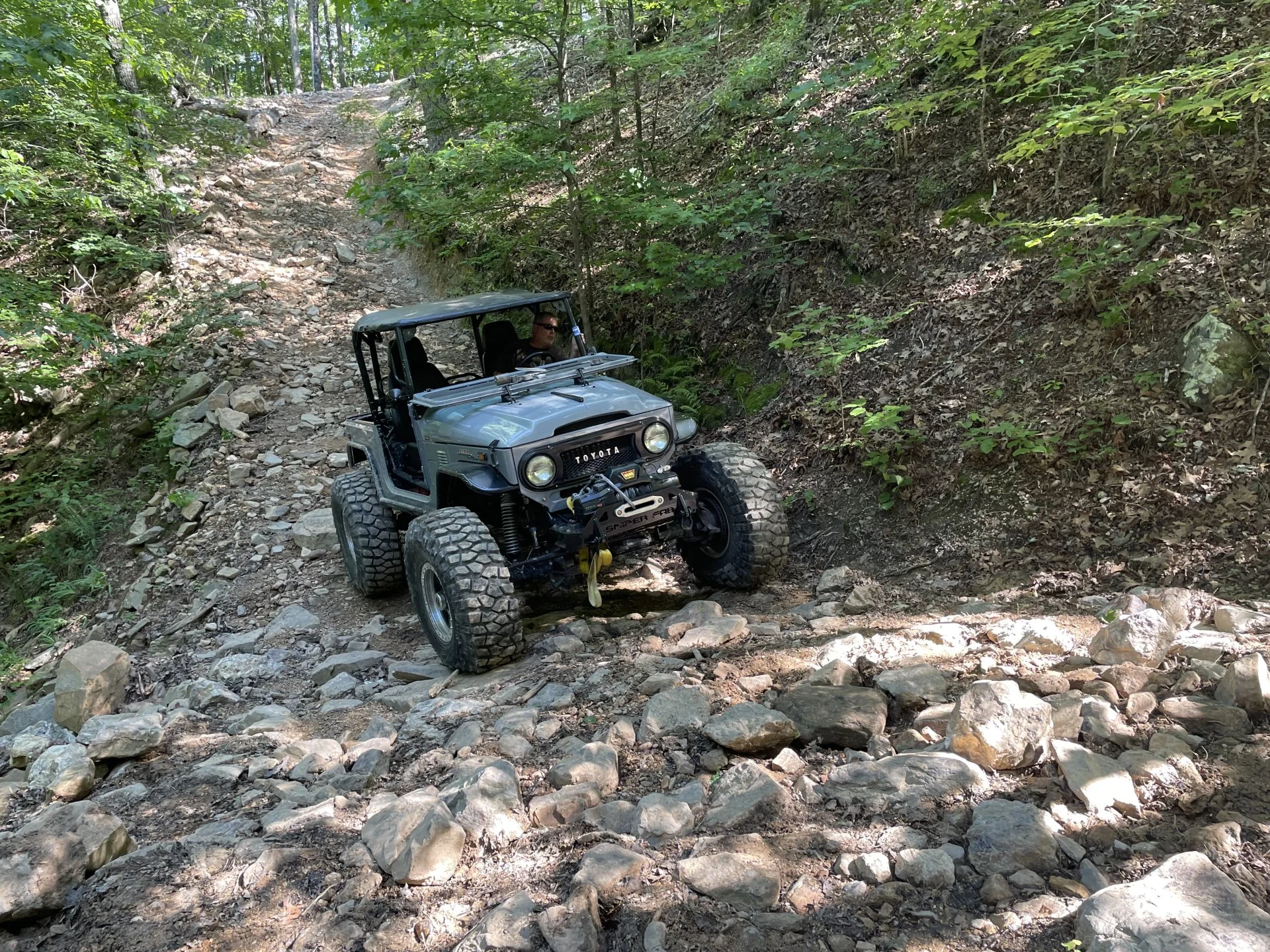

My threshold for taking the 40 to Hot Springs ORV was it had to drive onto the trailer. Unfortunately, I got it to start/run but couldn’t keep it running so I left it and went camping and jumped in with a fewer other cruiserheads while at Razorback Ramble. Great people, cool rigs and good memories!
