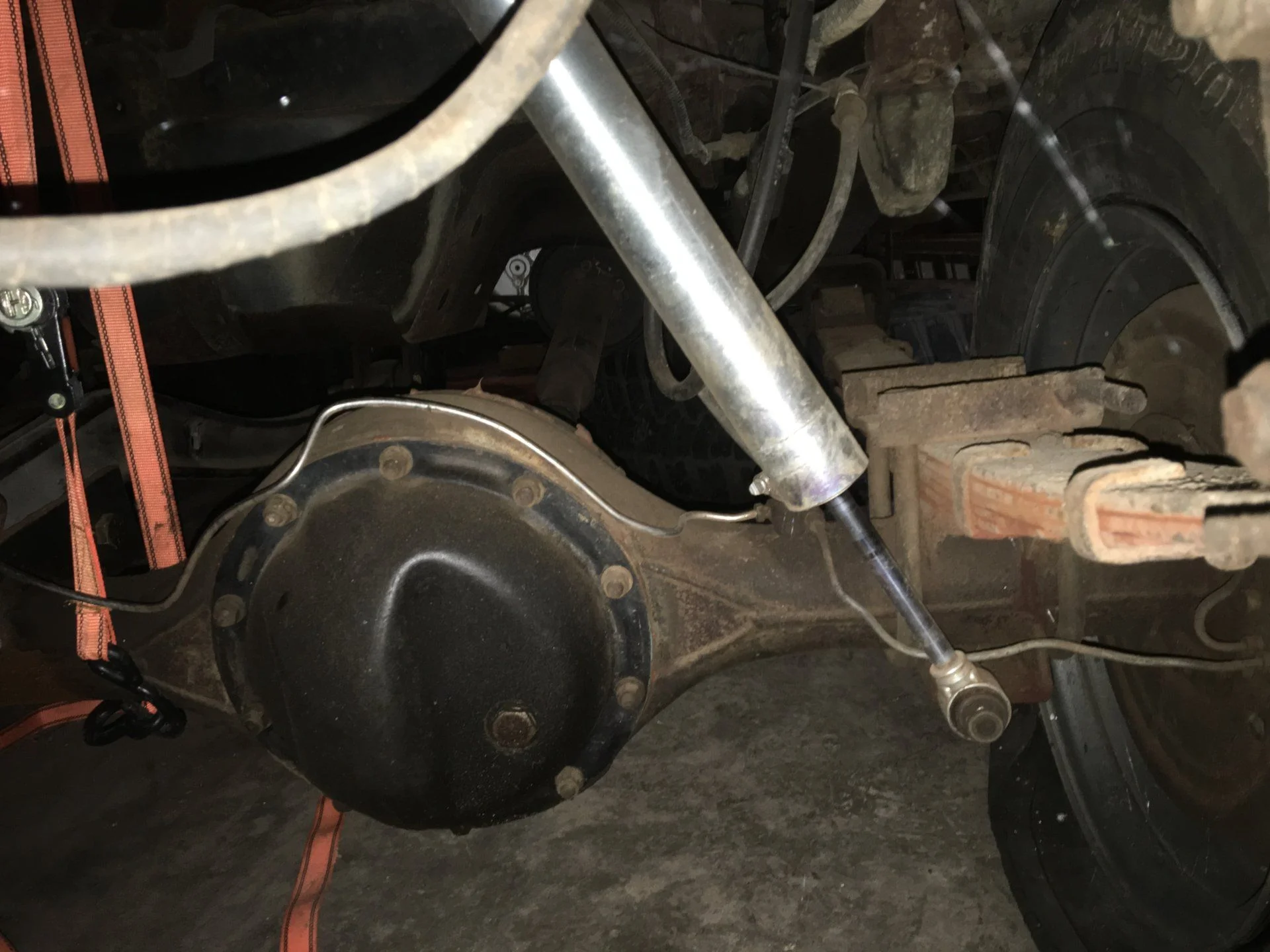

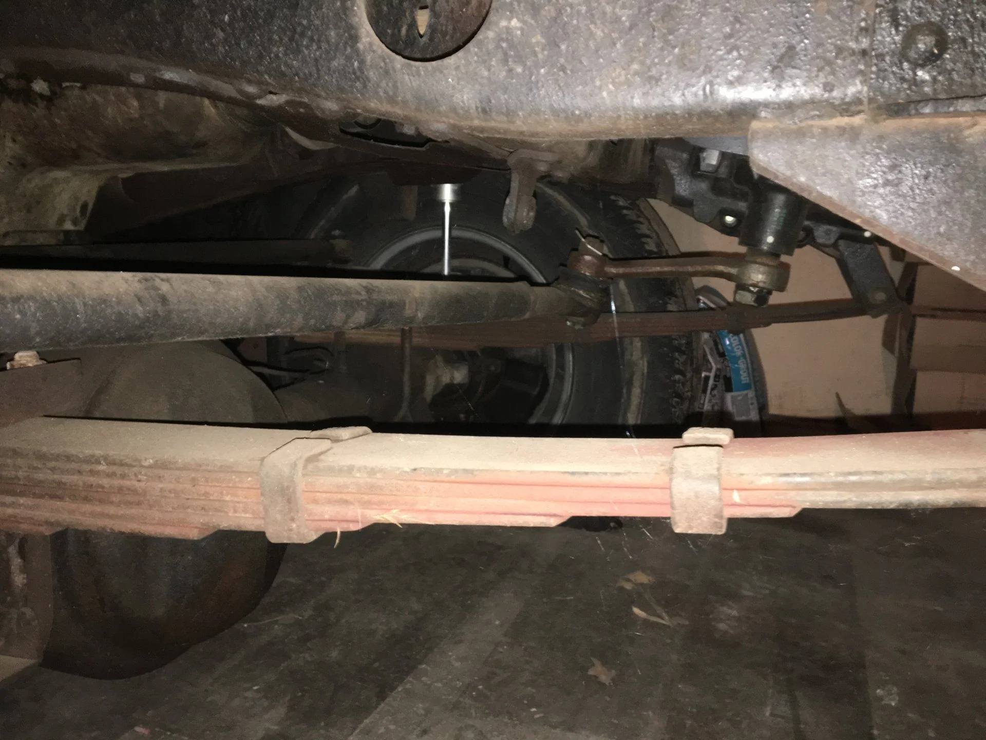

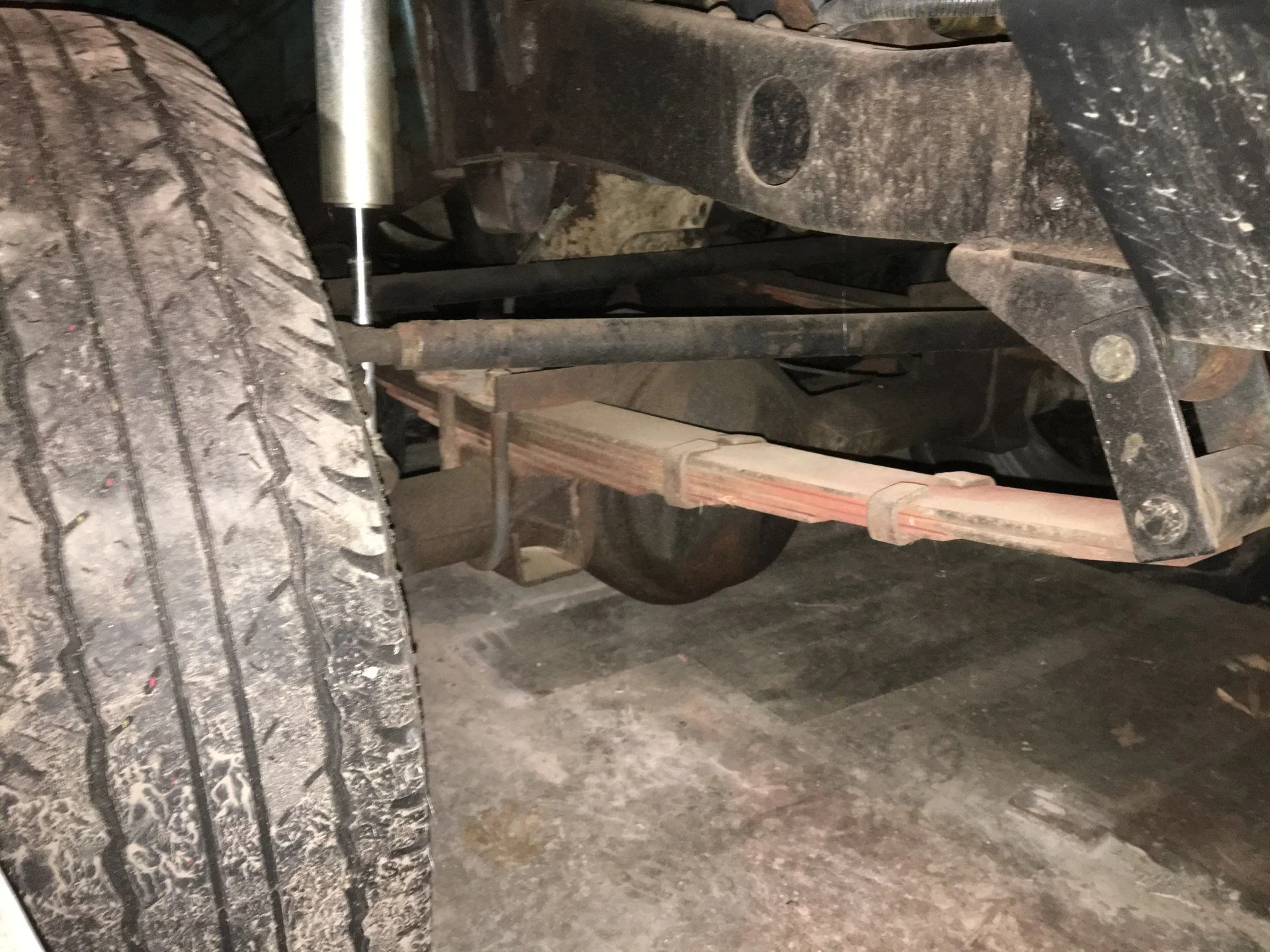

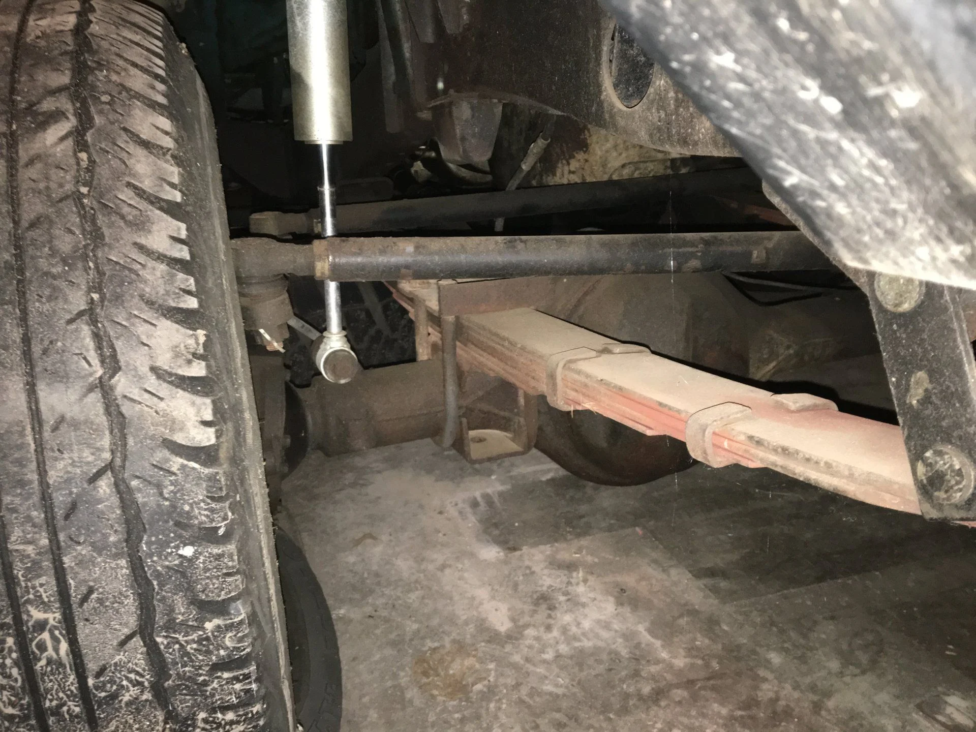

Can u post up some detailed pics of your suspension setup? Should be able to get a sua setup to about 4" or a tad less. 33s may be needed to squeeze in the garage. Personally, I would look closely at garage mods too.
I'll post some pictures later today/tomorrow with the suspension setup. Front springs are flat with Dodge/Mopar spring perches. Rear springs have a slight arch to them but somehow my front still sits higher than the rear. The rear axle has an 80 series front control arm as the traction bar.

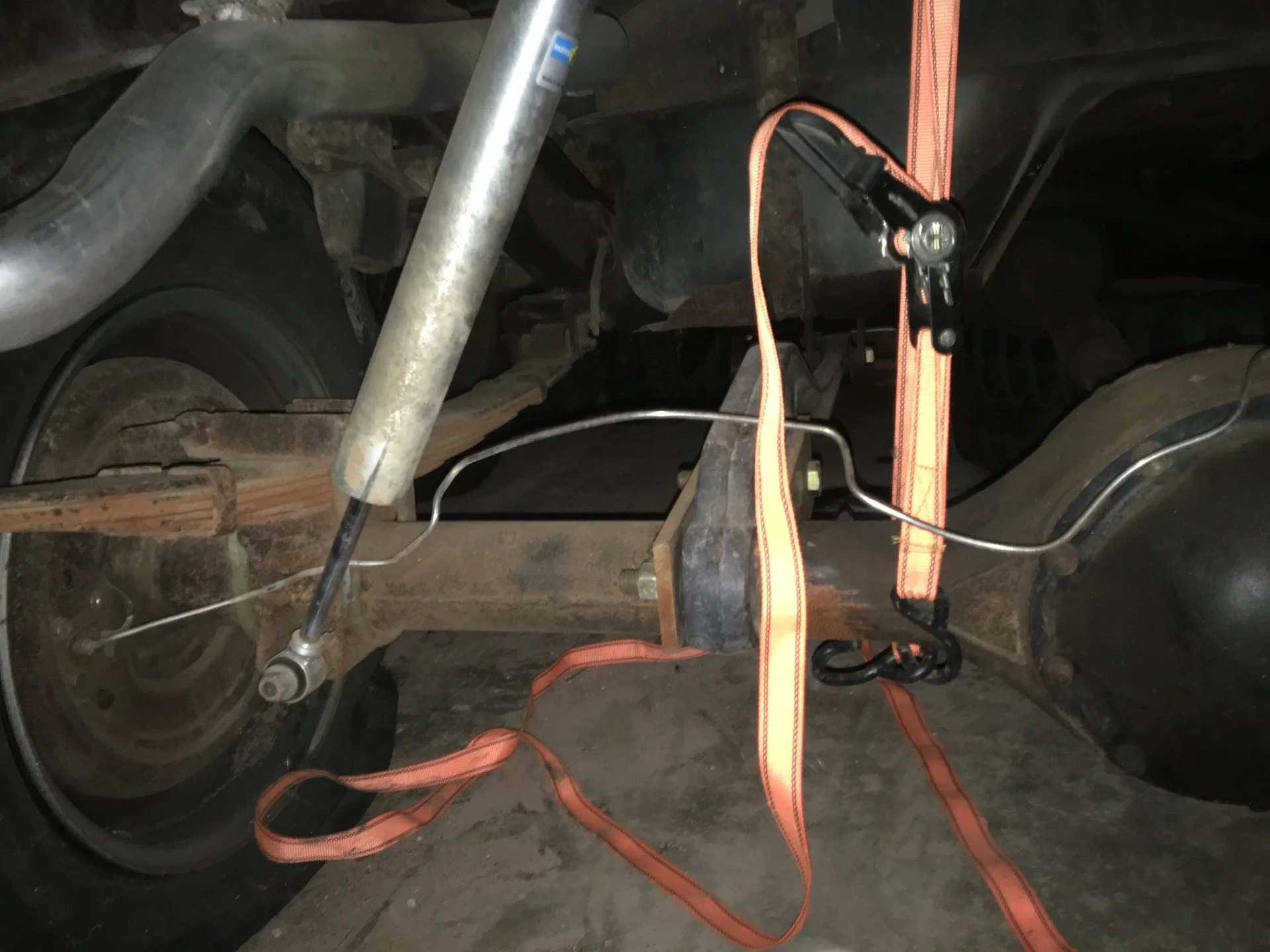

Can u post up some detailed pics of your suspension setup? Should be able to get a sua setup to about 4" or a tad less. 33s may be needed to squeeze in the garage. Personally I would look closely at garage mods too.
Took some quick pictures while working on the house today. I think your suggestion to raise the ceiling and garage door opening is something I’ll incorporate into our remodel within the next 18 months. However, I think that in conjunction with a refresh on the suspension is in order.
And the ratchet strap on the rear acme was only used to suck down the rear when pulling into the garage.
I think about 3" lower is doable depending on how much money and fab you want to do. It would be a fair amount of work. Personally I would raise the garage and leave the suspension alone and fix the rust on the old girl and make the interior more comfortable for daily driving.

Nice. Well this is what I think u could do to go lower. Front shackle reversal through the frame would lower it about 1". Modify/trim the spring perches and notch the housing a bit at the front diff so the front perches are sitting almost level with the axle housing(do this on the rear perches too)that will lower about .5 to. 75". Using either all new spring packs or just getting main leafs that are reverse eye with fj60 eyes should get u another 1.5" lower.
Great advice! Not sure why this isn’t the more standard approach to SOA since it nets a smoother ride and lower ride height over standard SOA.
Mostly because of the effort involved and benefit. Lots of people want the lift. Notching a housing has lots of room for failure
And the benefits of Shackle Reversals are arguable..
