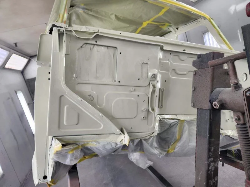

Batpig being taped for final paint
Interior panels that will be seen are being bodyworked. Skim coat of filler. Interior had a bunch of dings and nicks from cargo loaded and unloaded that would have shown bad in paint.
Doors, underside of hood, front fenders, front sheetmetal inner fenders, tailgate, back seat, inside doors, & hinges are the next round.
