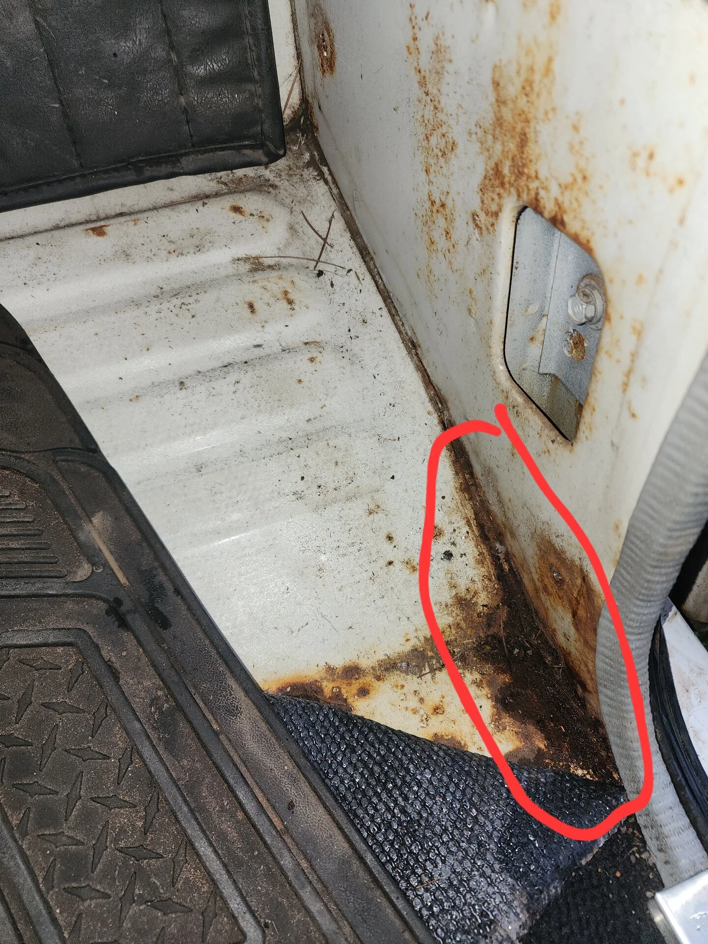

I've got a pretty bad water leak down by the right kick panel. I've replaced the door weatherstripping. I've felt around up above and don't feel anything. Anyone have any ideas?
What is the condition of your seam sealer along the drip rail?I've got a pretty bad water leak down by the right kick panel. I've replaced the door weatherstripping. I've felt around up above and don't feel anything. Anyone have any ideas?
Not bad. I think I'll start with some silicone in that corner of the windshield as suggested. Thank you.What is the condition of your seam sealer along the drip rail?

The A pillar has an open seam that collects water via gravity.I've got a pretty bad water leak down by the right kick panel. I've replaced the door weatherstripping. I've felt around up above and don't feel anything. Anyone have any ideas?
