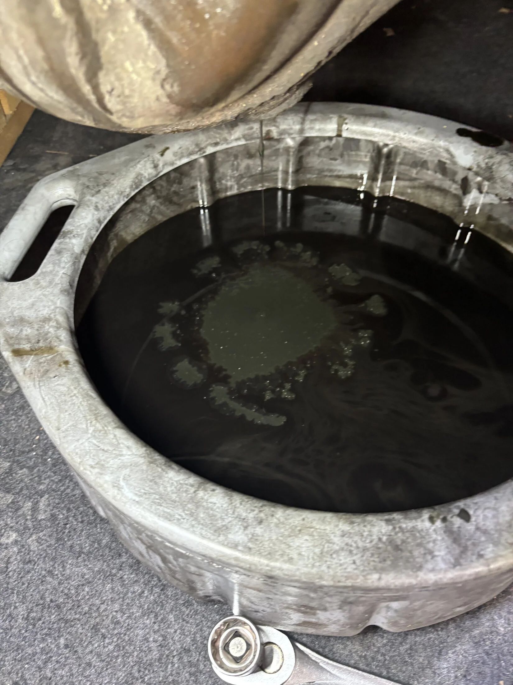

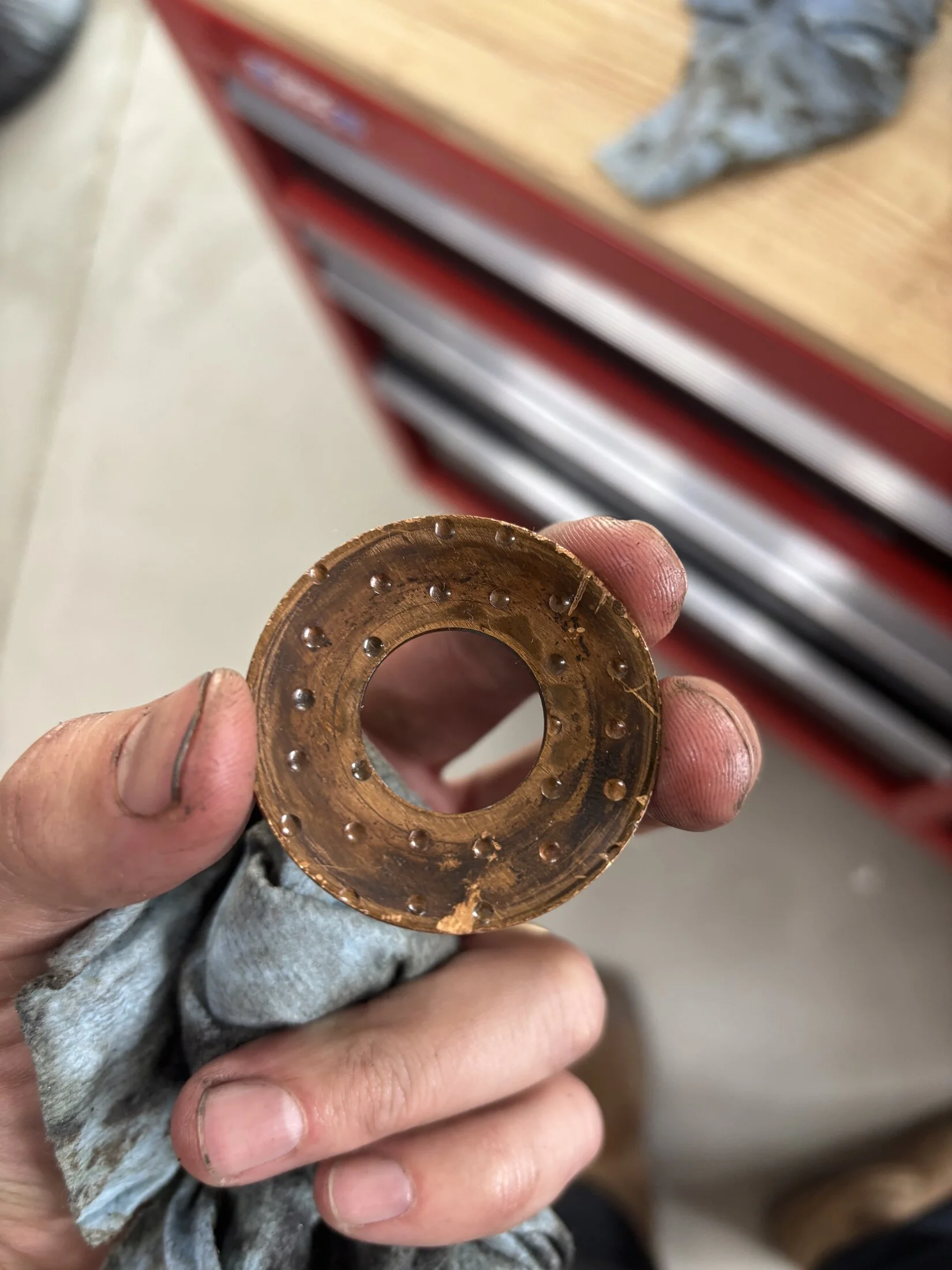

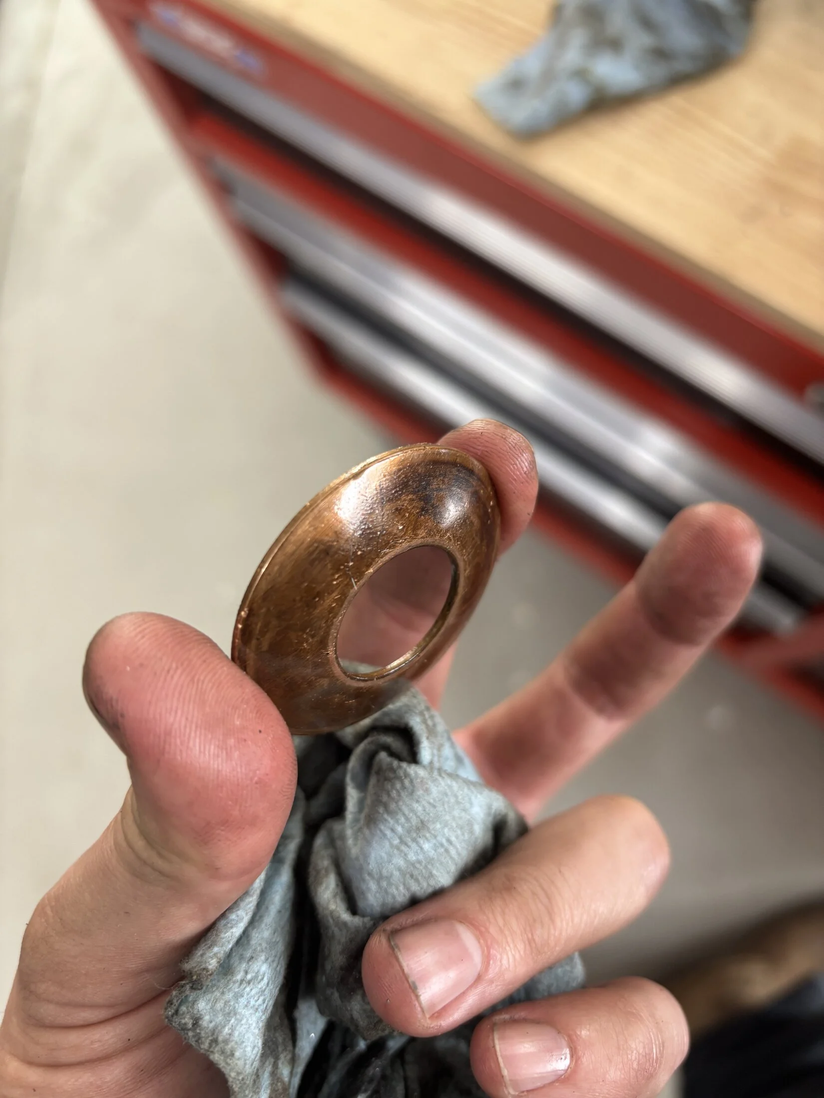

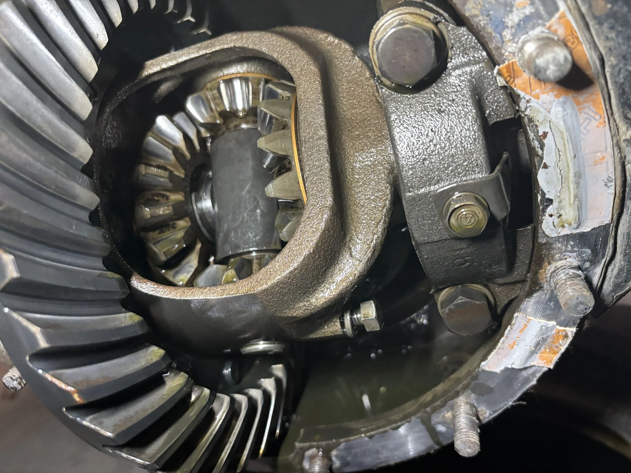

Then I got onto the full drivetrain fluid drain. oh the horrors I found. Starting at the back, the rear diff fluid was pretty nasty. It was black and had quite a bit of sludgy metallic gook in it. Peeking through the hole though, there was a visible 12mm bolt hanging on by its absolute last thread. Then I found some beat up looking large copper washer just sitting in the bottom of the diff. Good grief. So I've pulled the rear diff cover and of course the PO used about 7 tubes of RTV to seal it, so I'm looking at a good half day of gasket scraping at least.
The transmission and t-case were both about the same, black sludge with lots of metal glitter. The front diff though....I've never seen fluid so nasty. It was like fudge. I've seen diffs that had water intrusion, but this was something altogether different. It was like someone put axle grease in with the fluid. Guess I can add two differential rebuilds to the ultimate project list...
The washer is a thrust washer and should go between a spider gear and carrier. You can see the one in your pic,. The small gear that the center shaft goes thru. The loose bolt is a pin that holds the center shaft in place.

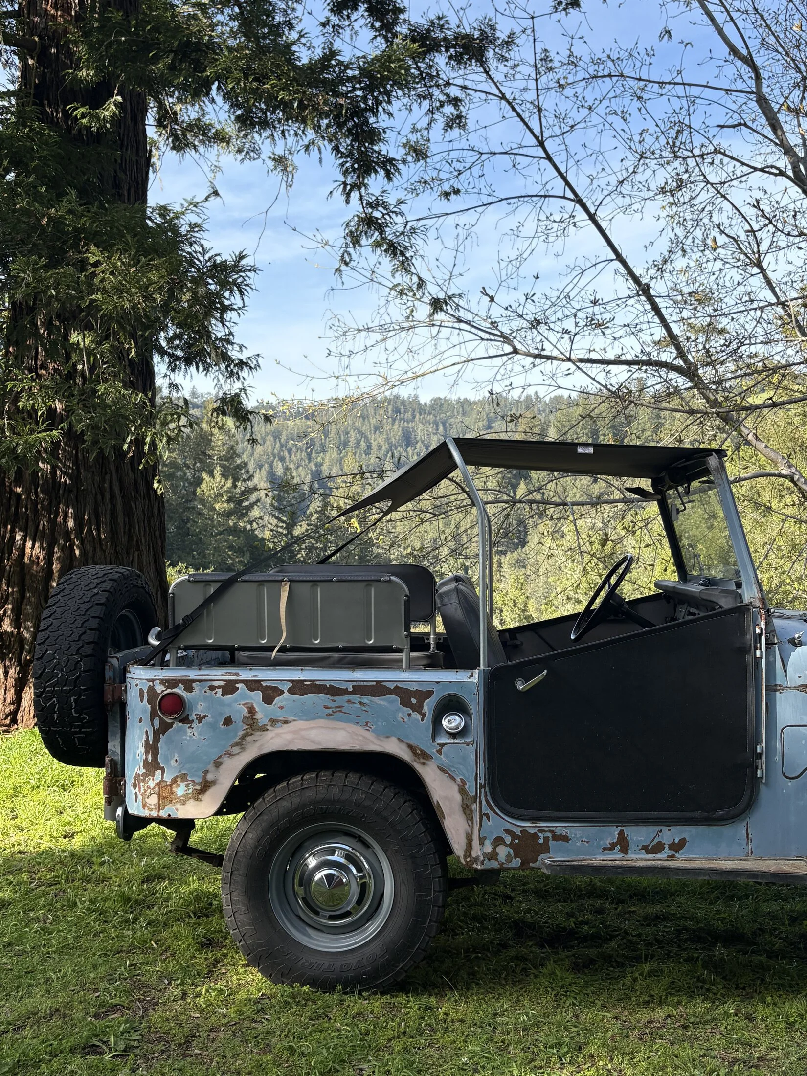

First top off cruise today….ever! Man it’s so awesome. My boys just kept saying “we don’t want to go home yet!” Even though it was about 45 degrees out.
Congrats on the first tank. Don’t worry that experience is never that far away to enjoy over and over again…

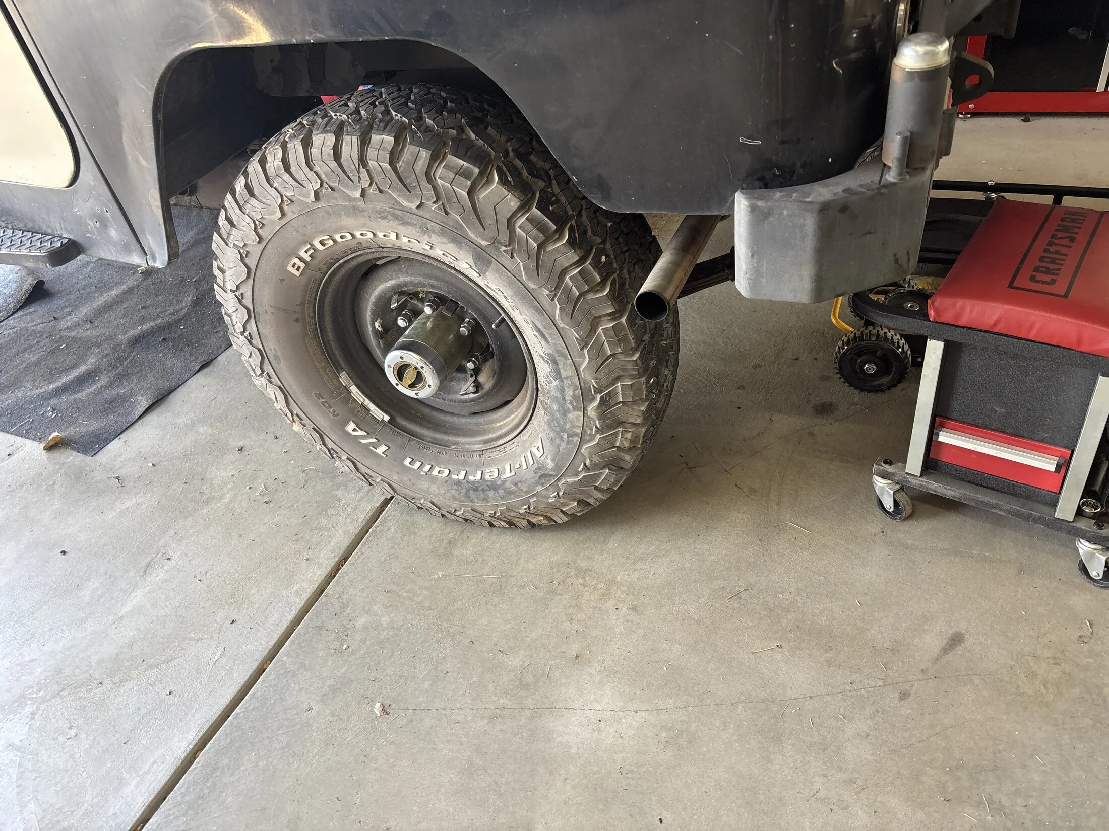

Before you get a cat, where’s your exhaust routed? For topless cruising, the general consensus is to exit just behind the rear tire. Out the back catches the aerodynamics drag and pulls the fumes up to the rear passengers and possibly the front too. Next is any exhaust leaks should be checked. Plenty of 40’s have been driven without catalytic converters and no smell. In fact, even when I was running very rich on my V8 I never smelled the exhaust while driving.
My exhaust actually appears pretty tight. Though I’ll say the header may not be sealing great…

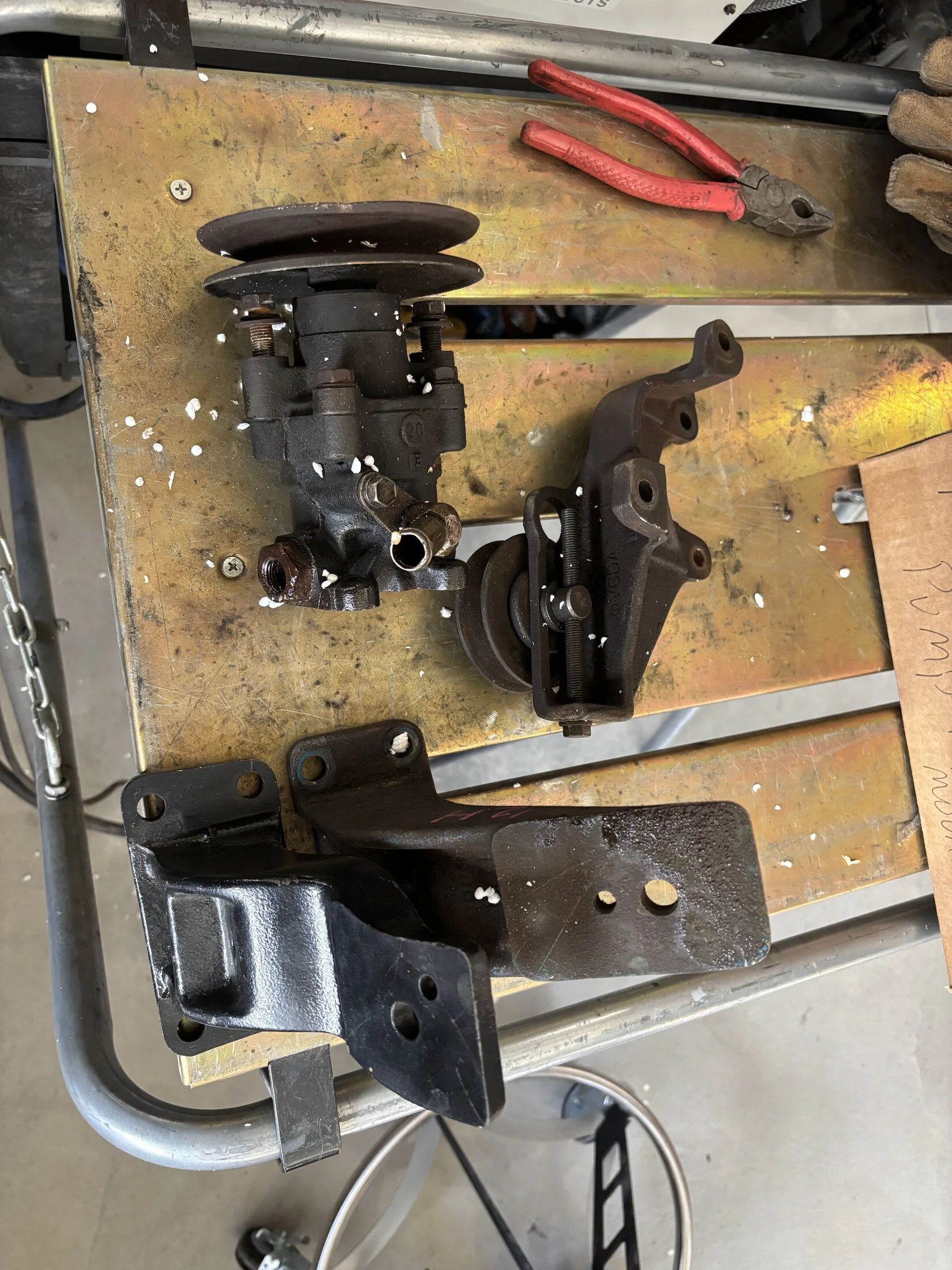

The parts fairy made a stop today. My 12HT power steering pump and mounts showed up. The pump will certainly need a rebuild, or to be swapped for a a rebuilt unit, but it came with the tensioner I need. Came from Pakistan, via UAE. Gotta love the global parts supply these cruisers enjoy. If only this pump could talk, I sure bet it would have some cool stories.
The powder coated/black mount is an HJ47 mount for comparison. I'll use that one for the motor, but the power steering eye will have to be transferred over. Will be a fun fab project.
12H-T in a 40 is gonna be an absolutely boss setup. 💪

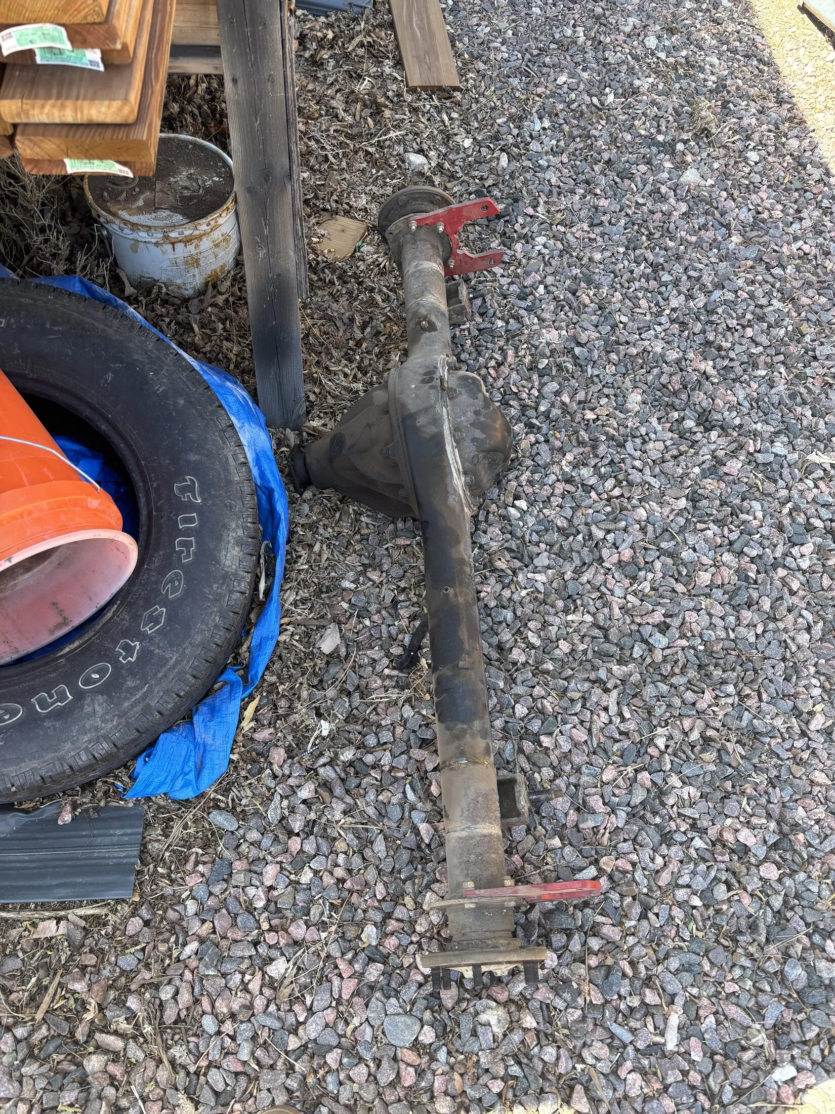

Delivered this full float rear axle with a en 80 e locker and Downey cable conversion. So excited about this one, not just the locker but also the hubs and being able to flat tow this thing that much easier.

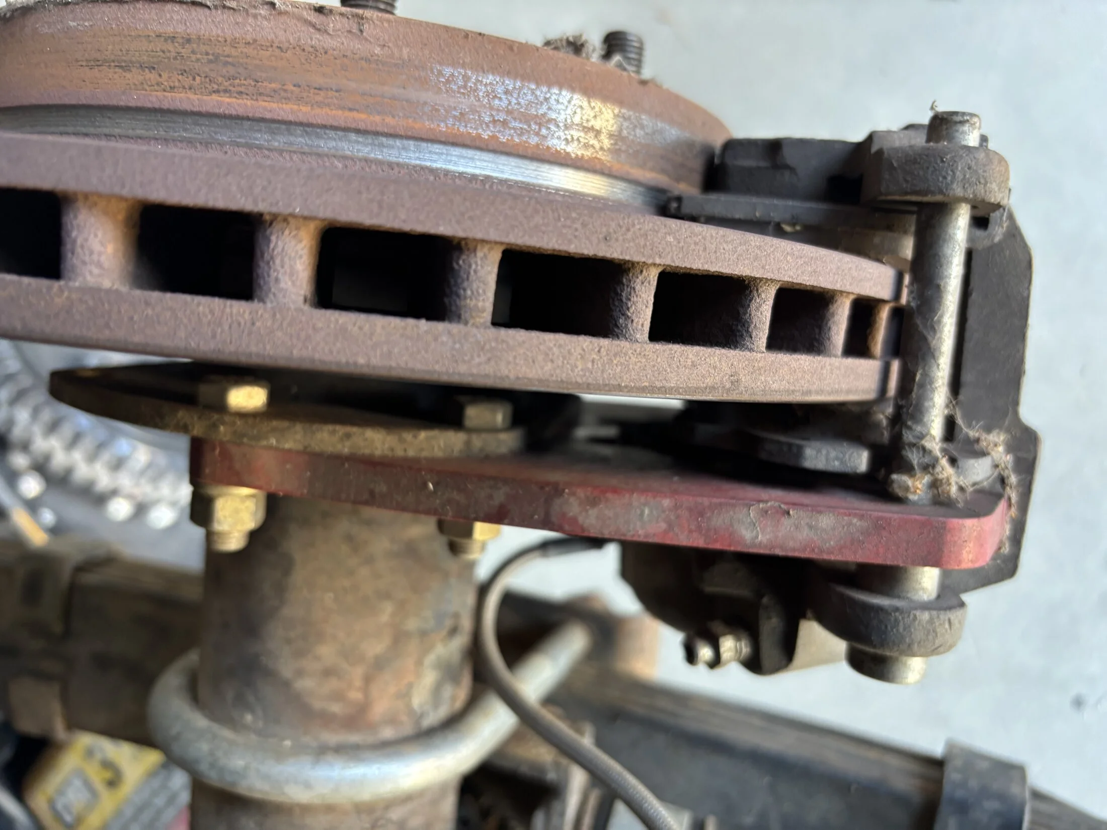

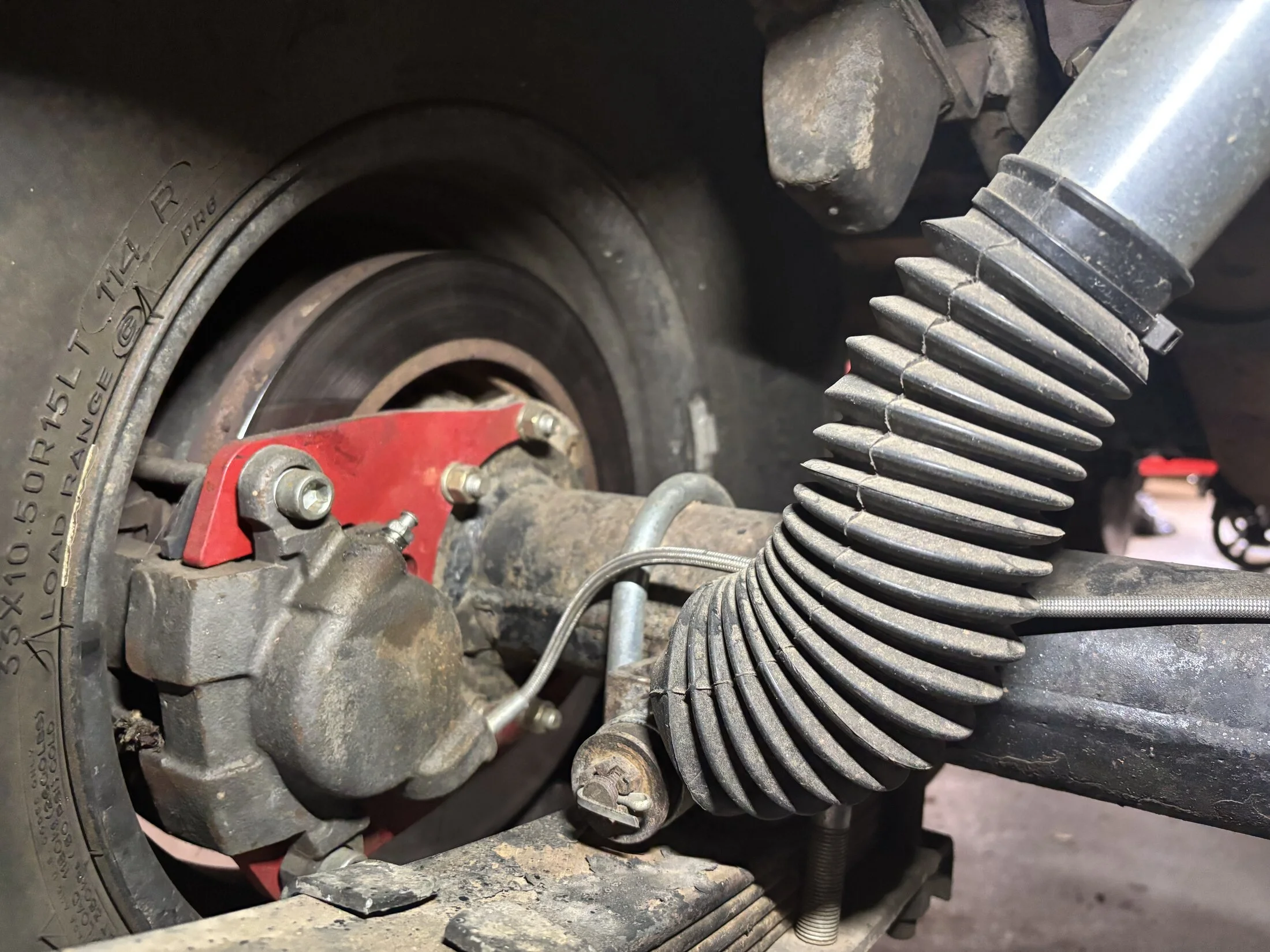

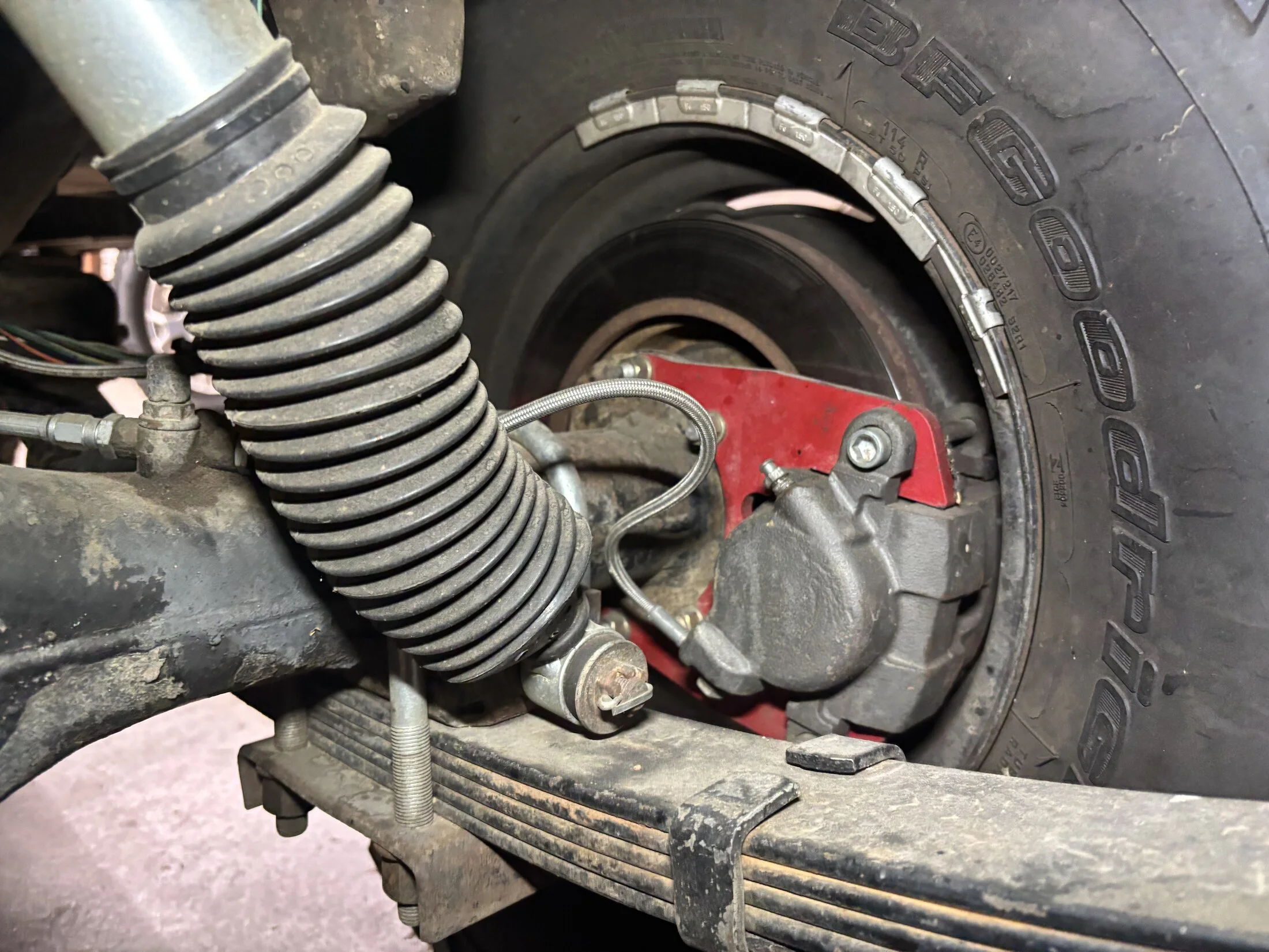

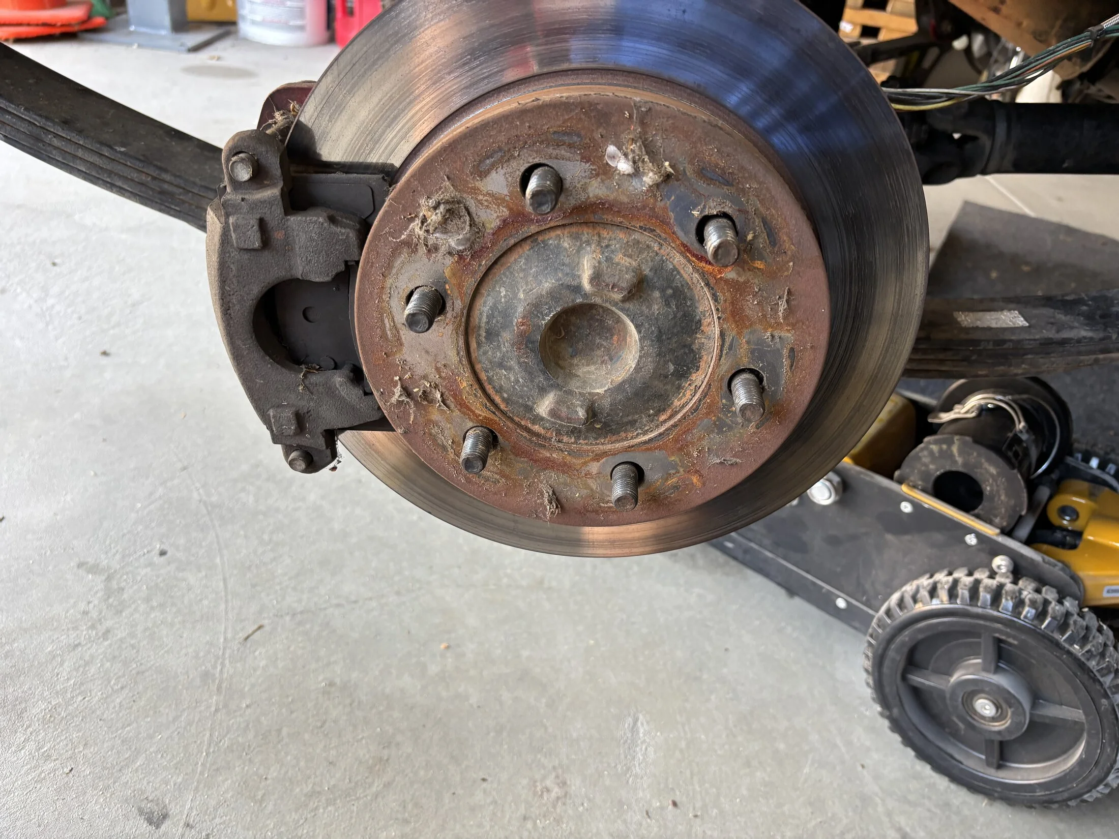

Did some measuring and it looks like my brakes will be a direct swap. That being said, can anyone ID the brakes I have now? Would like to know for future servicing, I don’t see any part numbers:
Looks like Monte Carlo gm metric. Typical standard fj40 conversion set up.

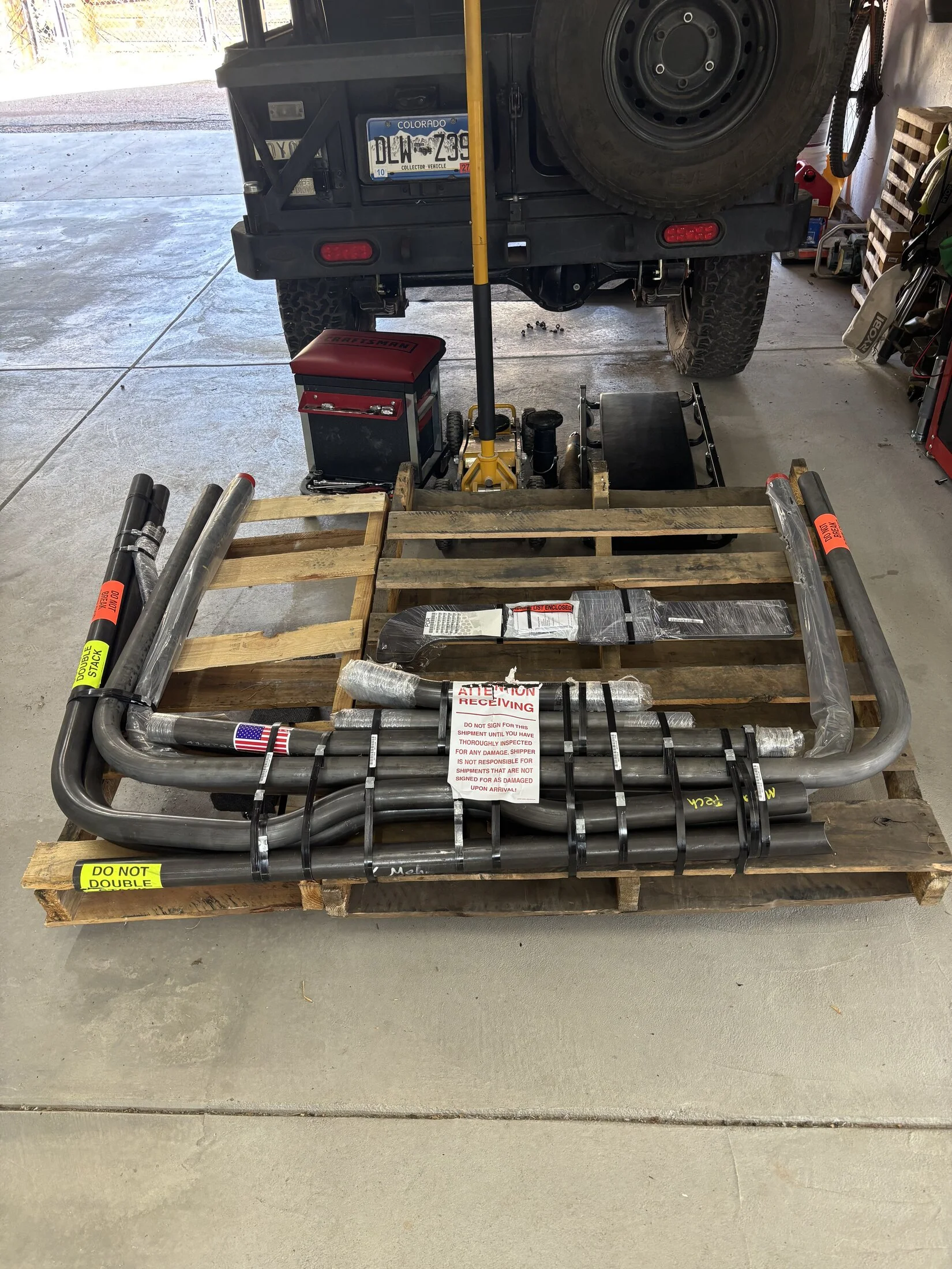

I’ve actually got a metal tech cage and TROA full softtop ordered, very much looking forward to it!

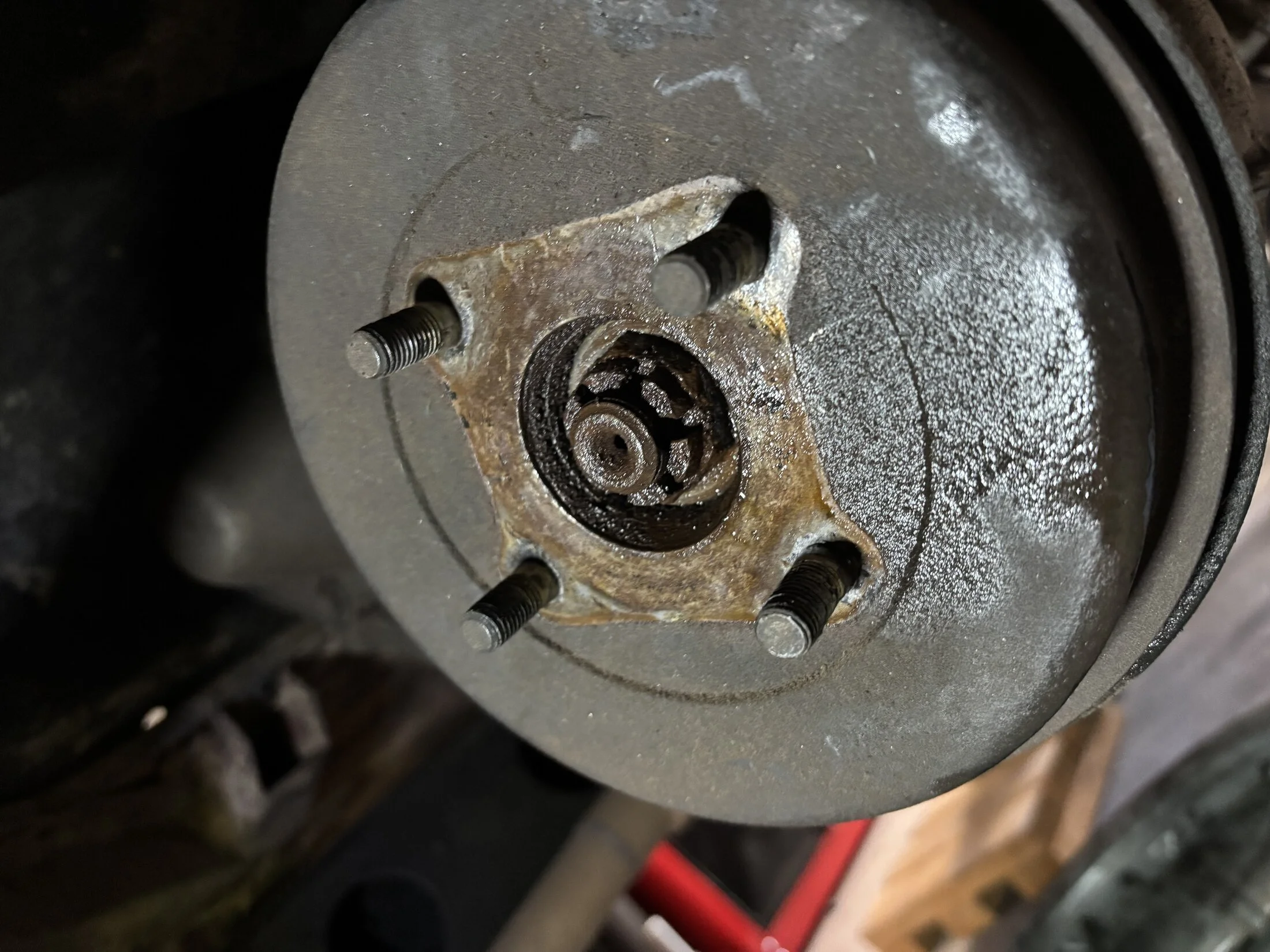

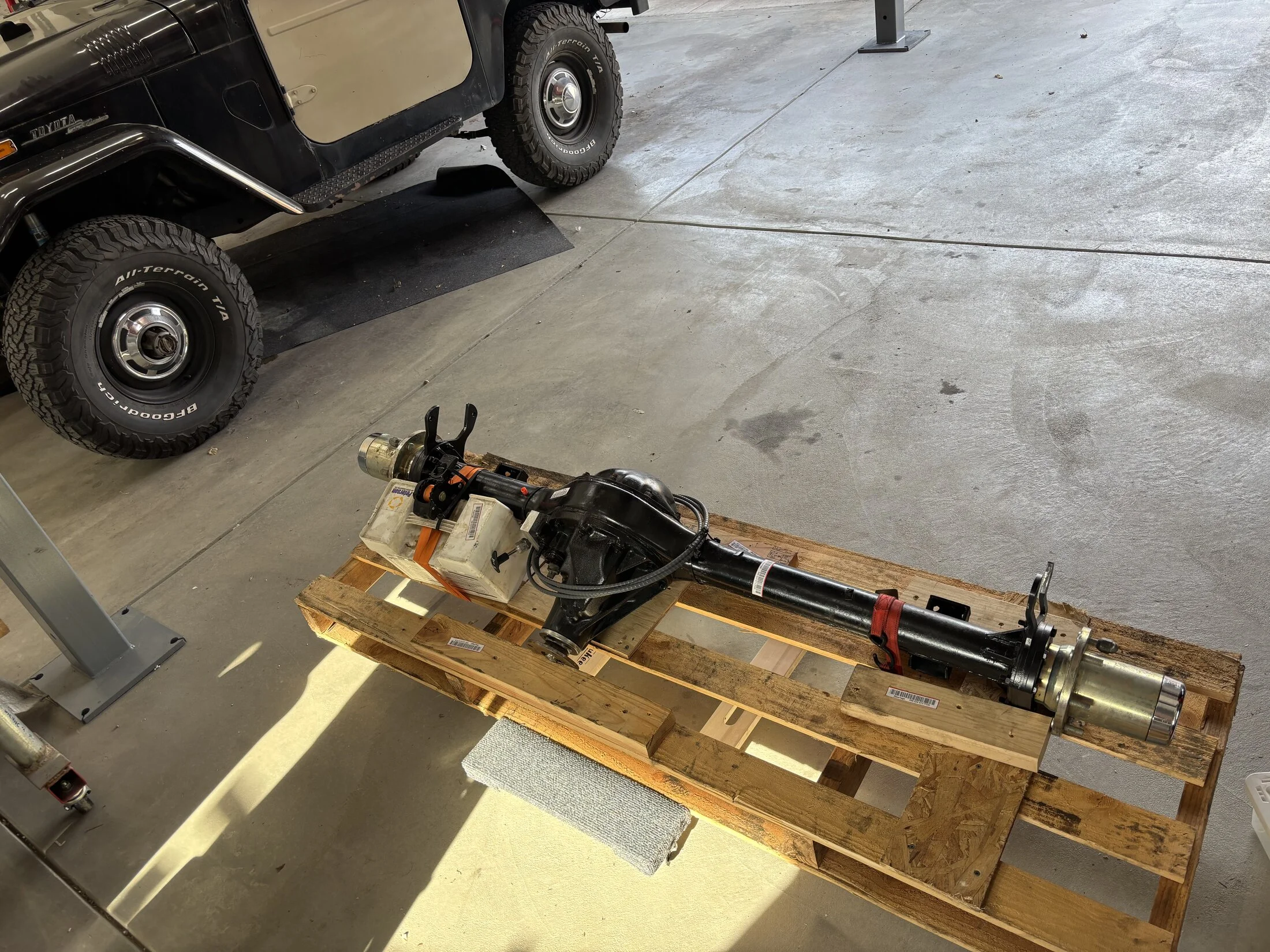

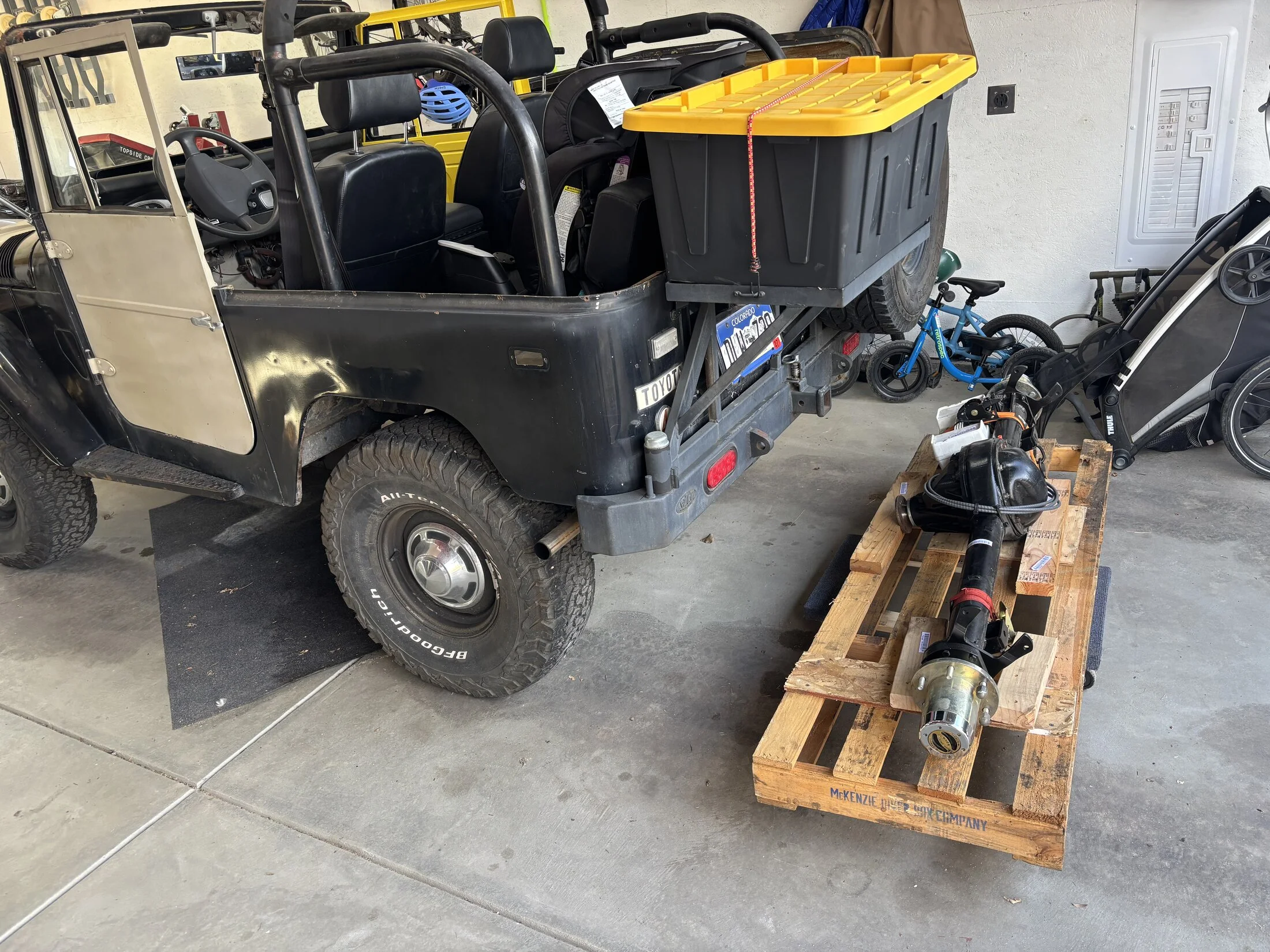

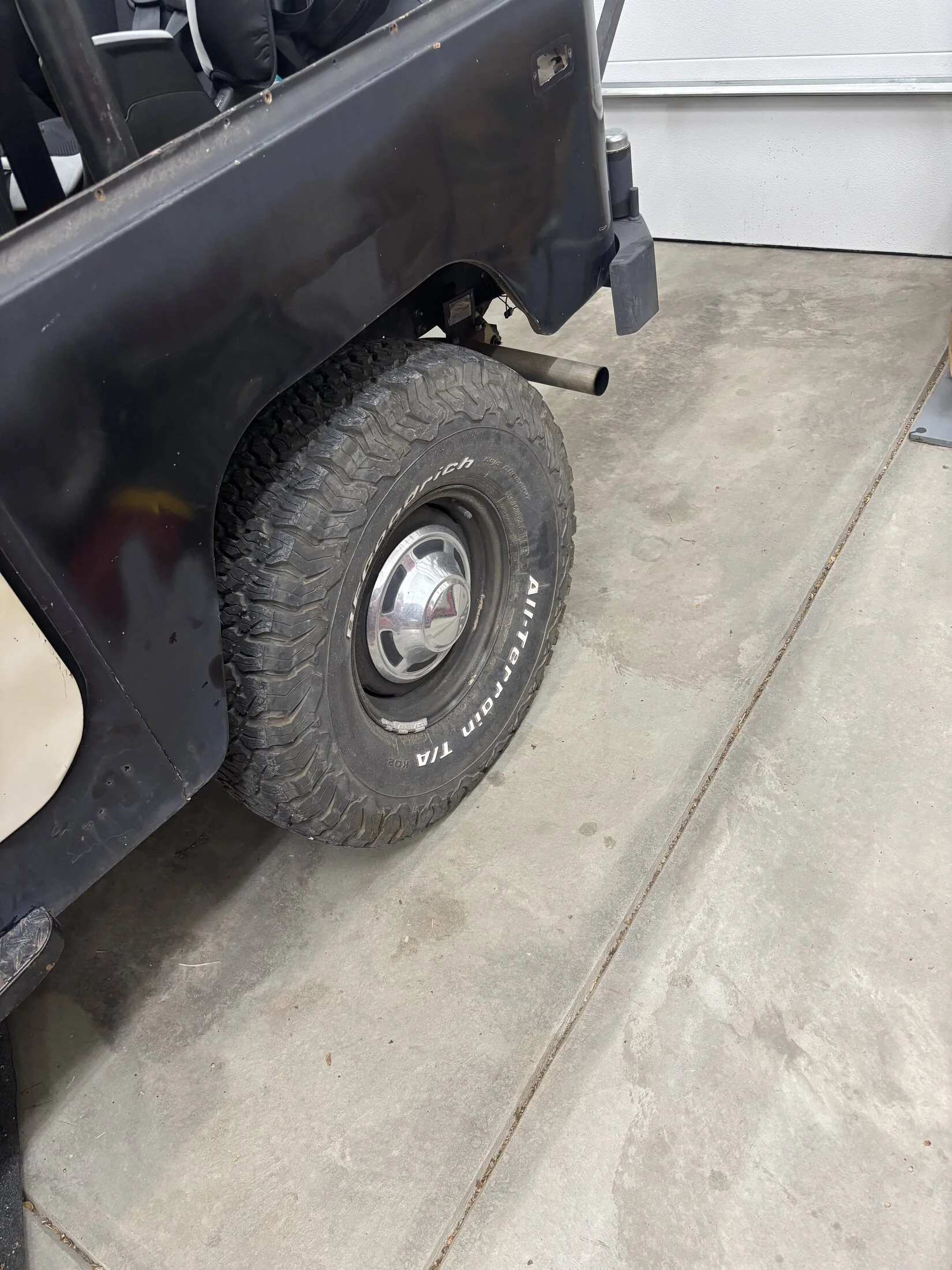

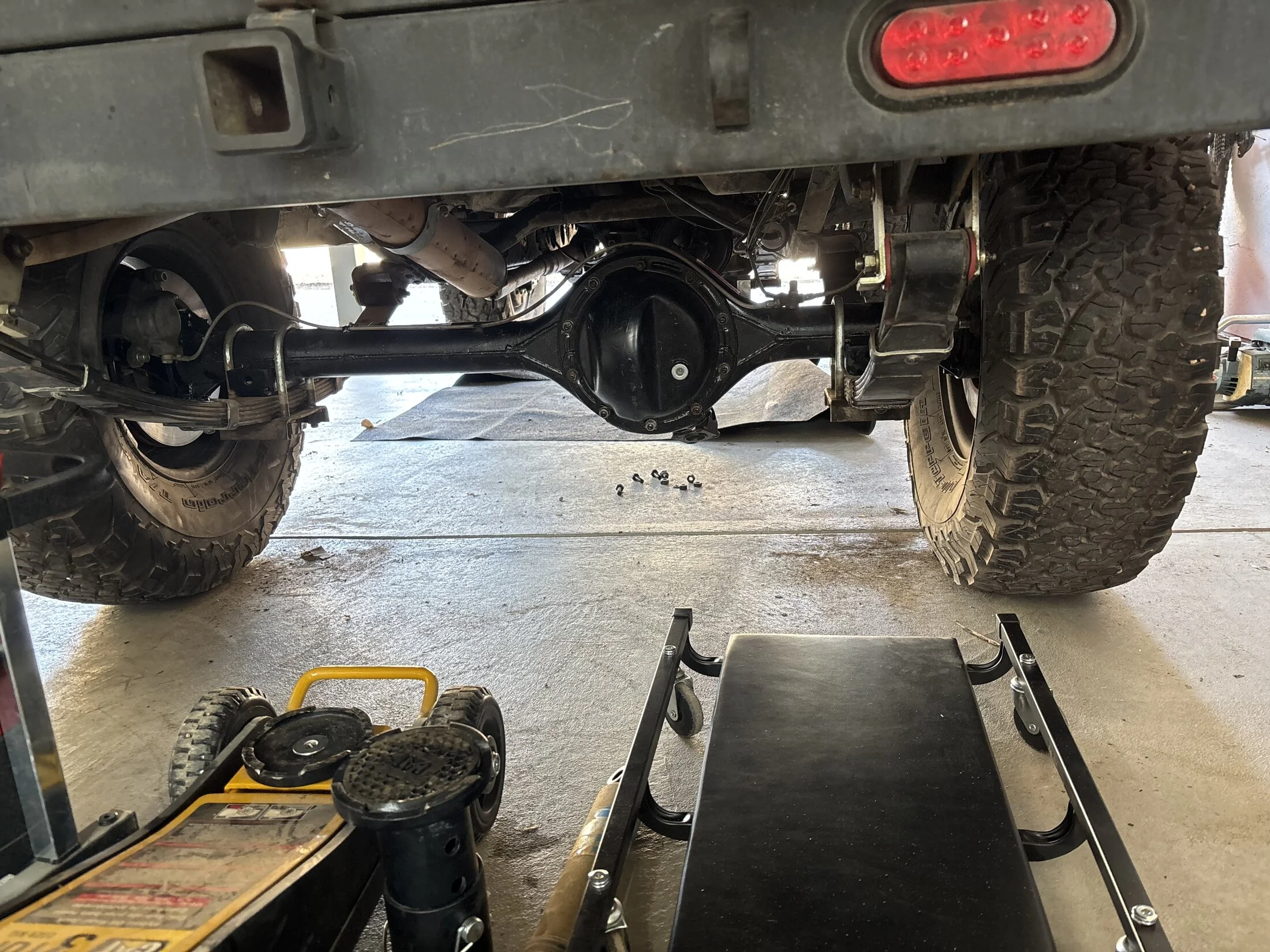

Rear axle is swapped and was nearly plug and play. Two issues have come up- 1) my driveshaft has a square flange on the axle side, and the new axle has a circle flange, 2) I need shock studs for the the new axle housing. Was a bear to get in but it’s there!
