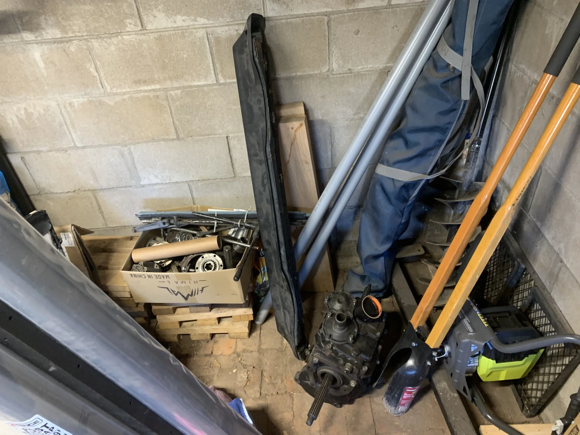

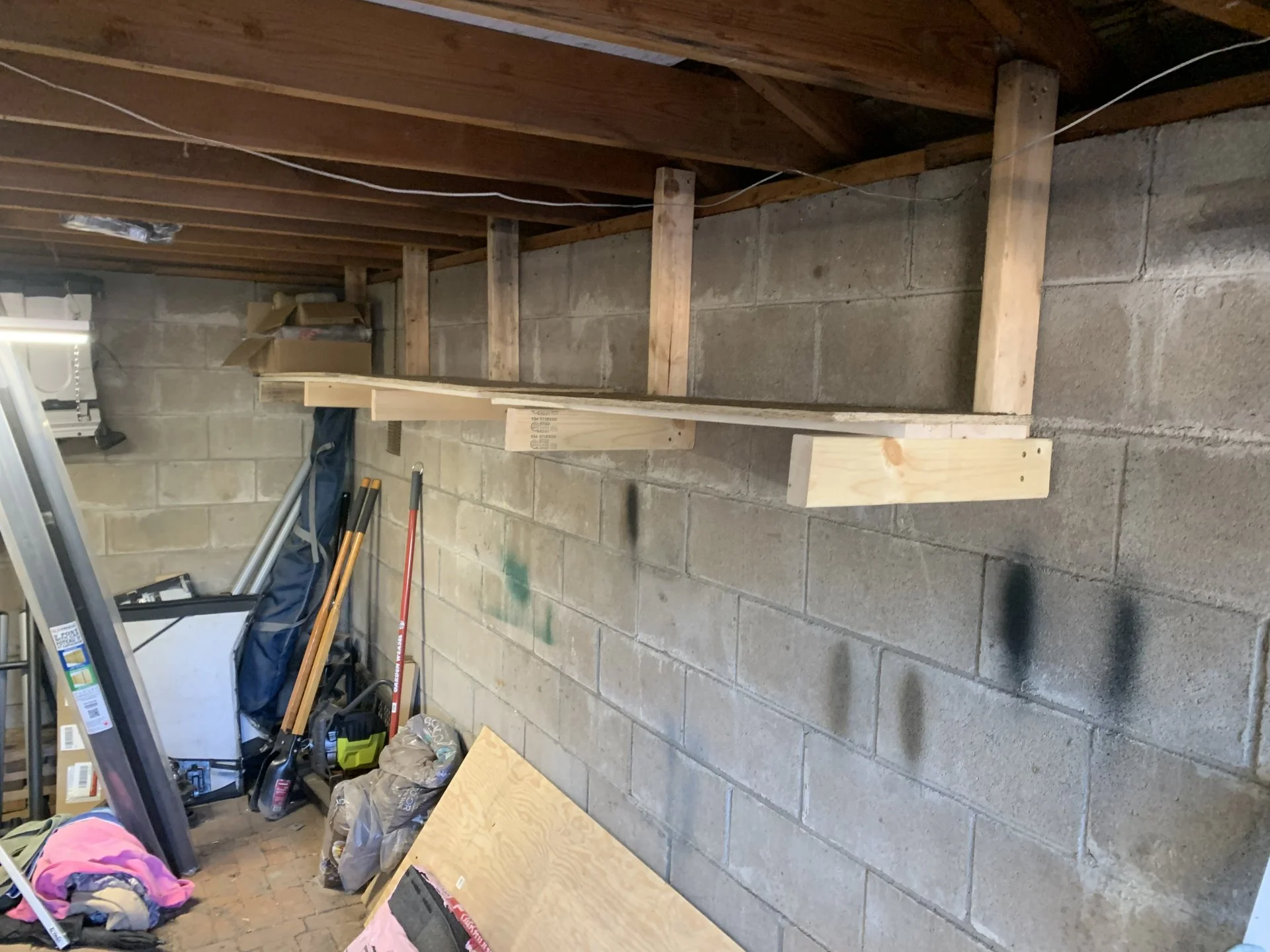

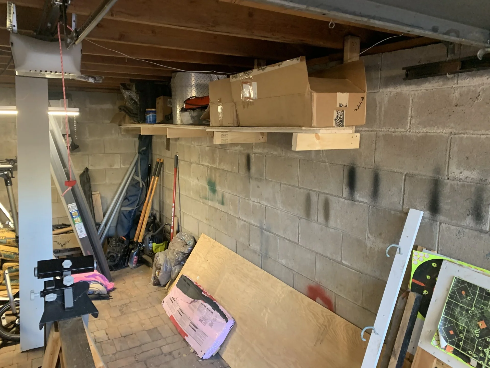

First project in the books. Built a quick scrap wood shelf to put all my spare parts that came with the FJ. Now to find the time to go through and figure out what everything is.

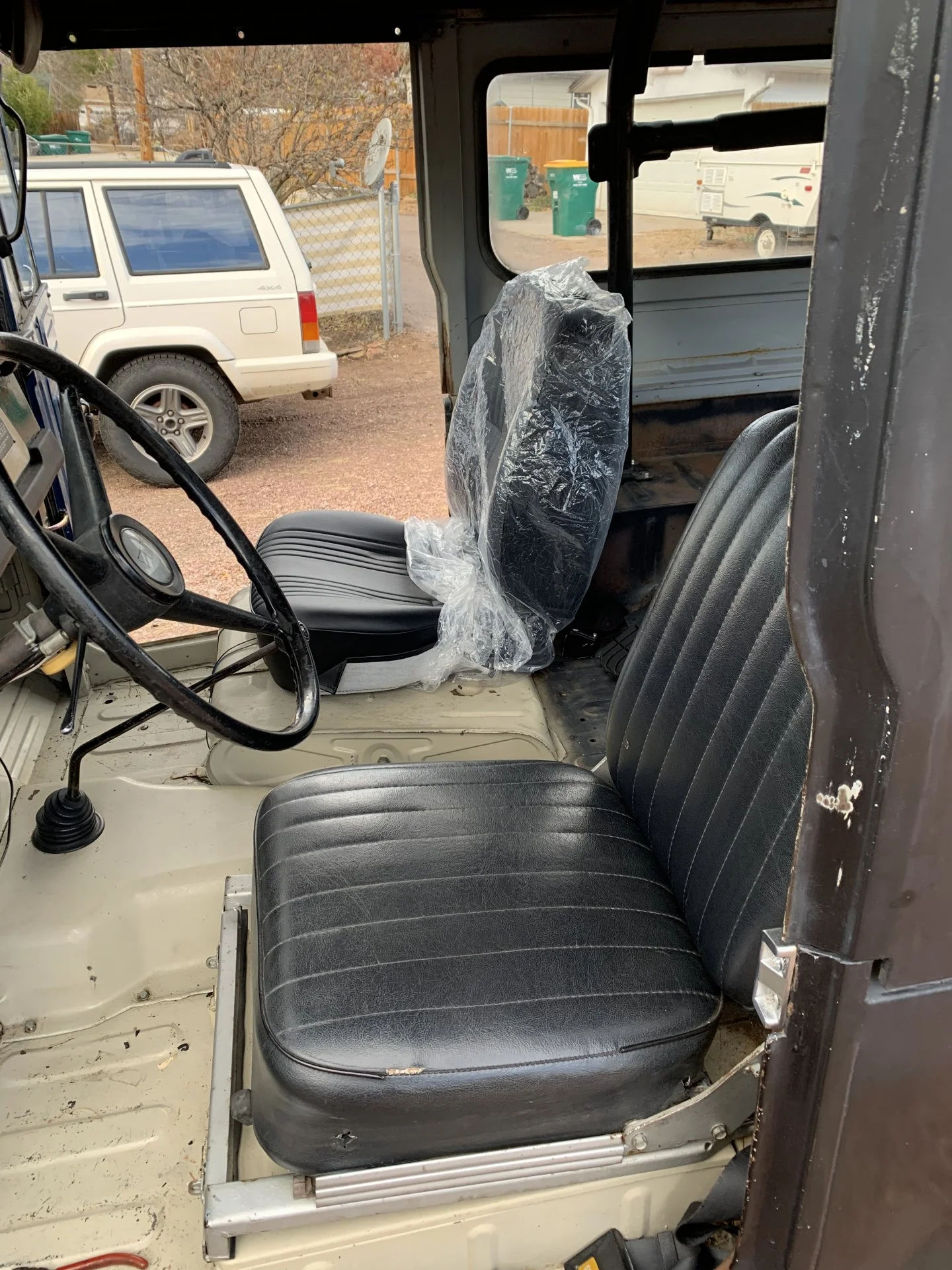

New seats came in. Huge huge improvement over the old bench seat. I definitely don’t think my original bench was original, it really didn’t match up to any factory bolt holes when I removed it. Anyways, I’m going to make a whole new mounting frame for it. Looks really nice just sitting in there:

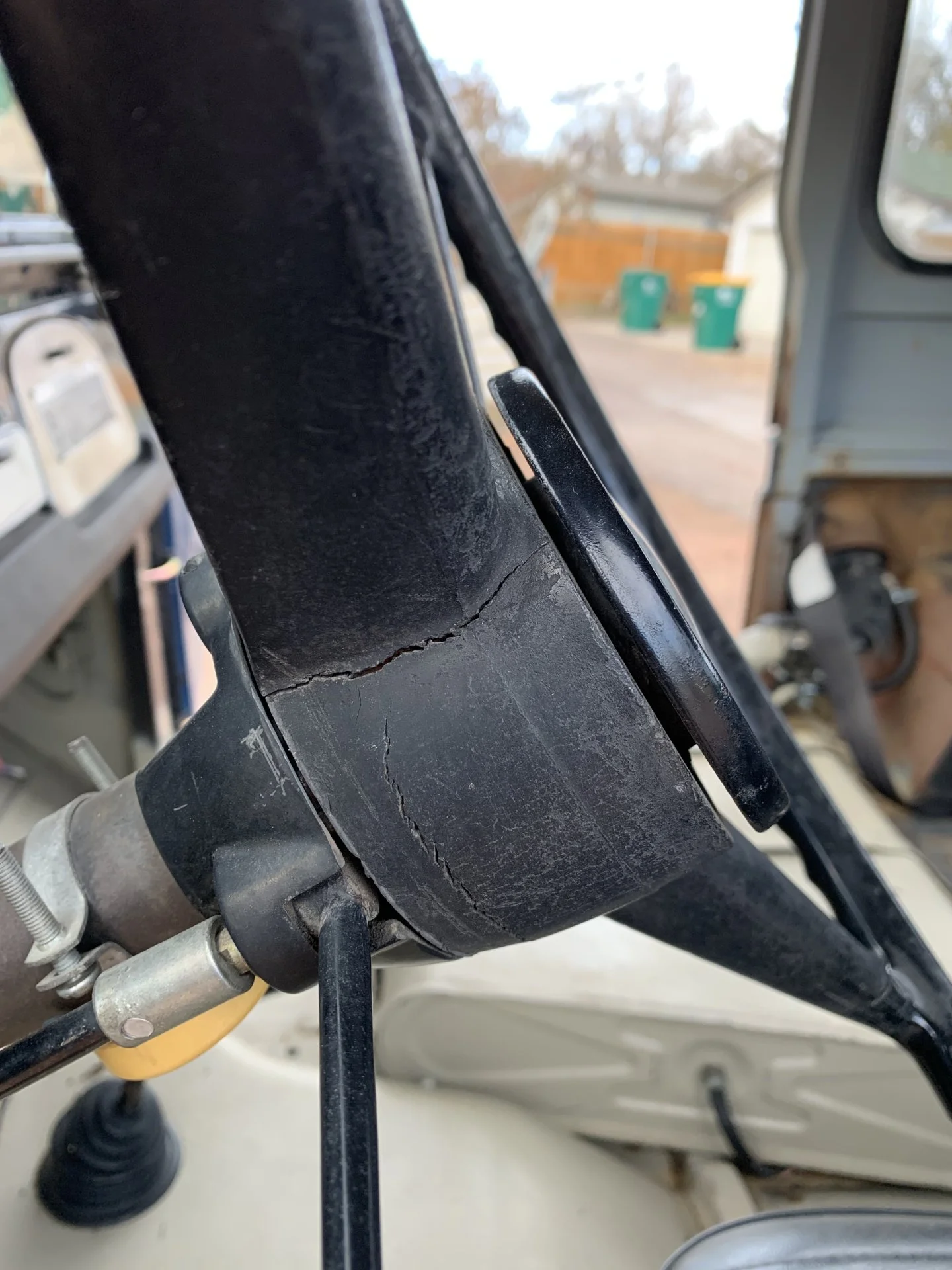

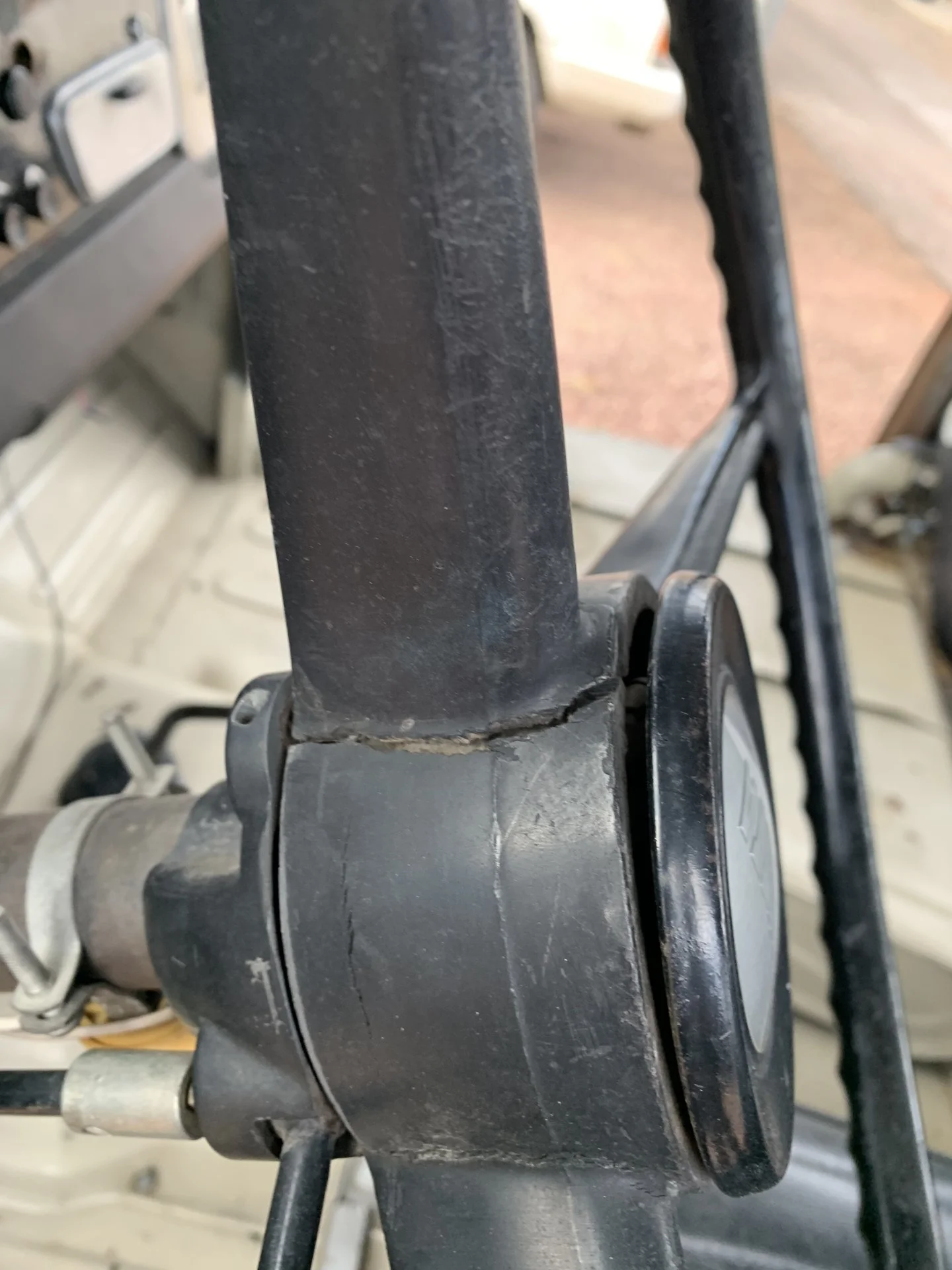

New question- I’m looking at my horribly cracked steering wheel- is there metal inside the plastic, or is this thing as close to snapping off as it looks?!

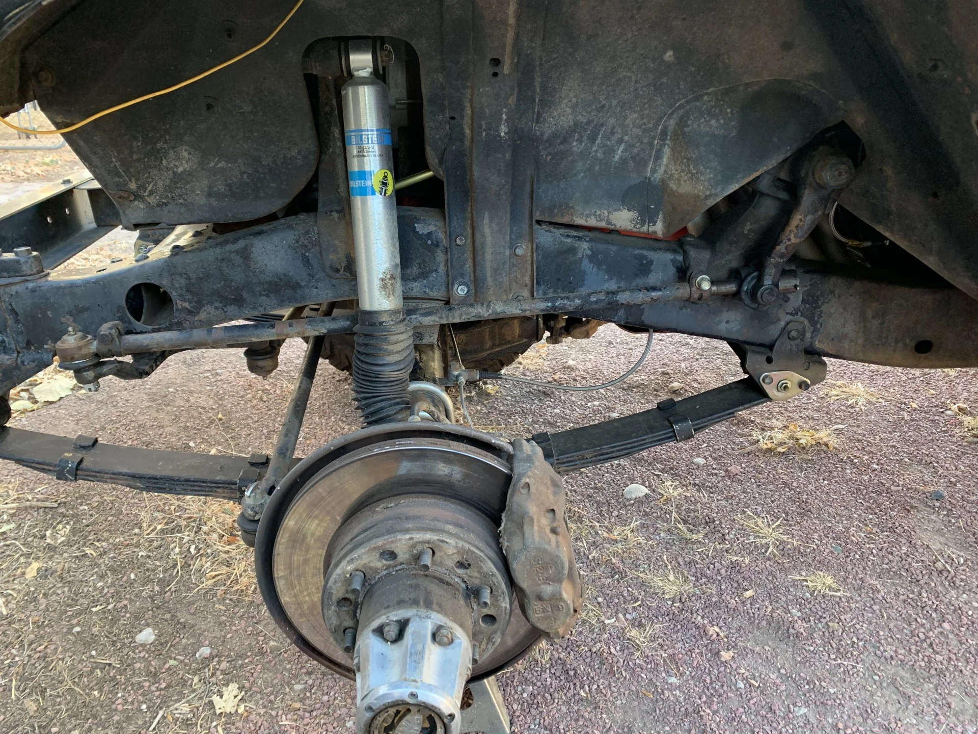

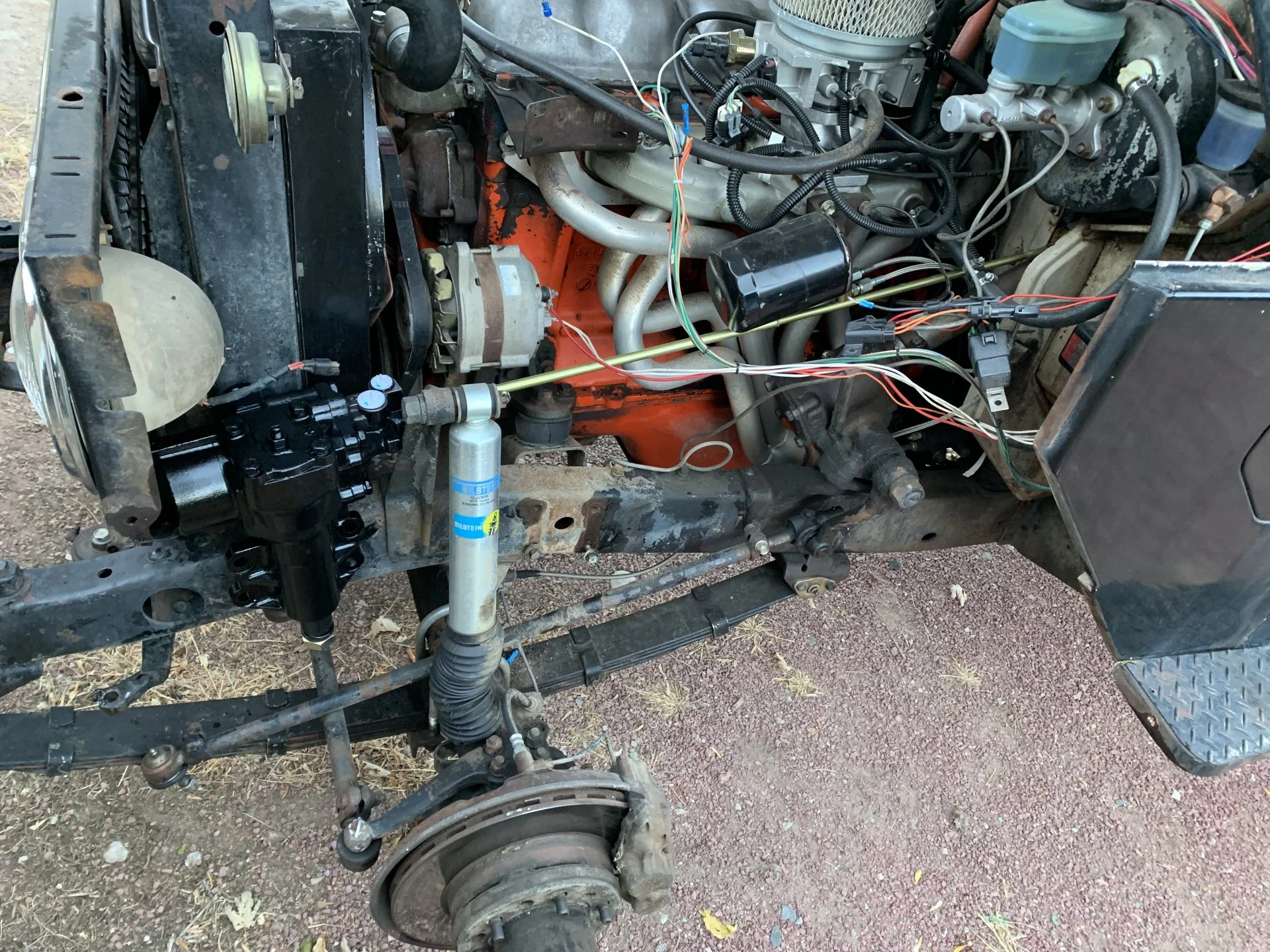

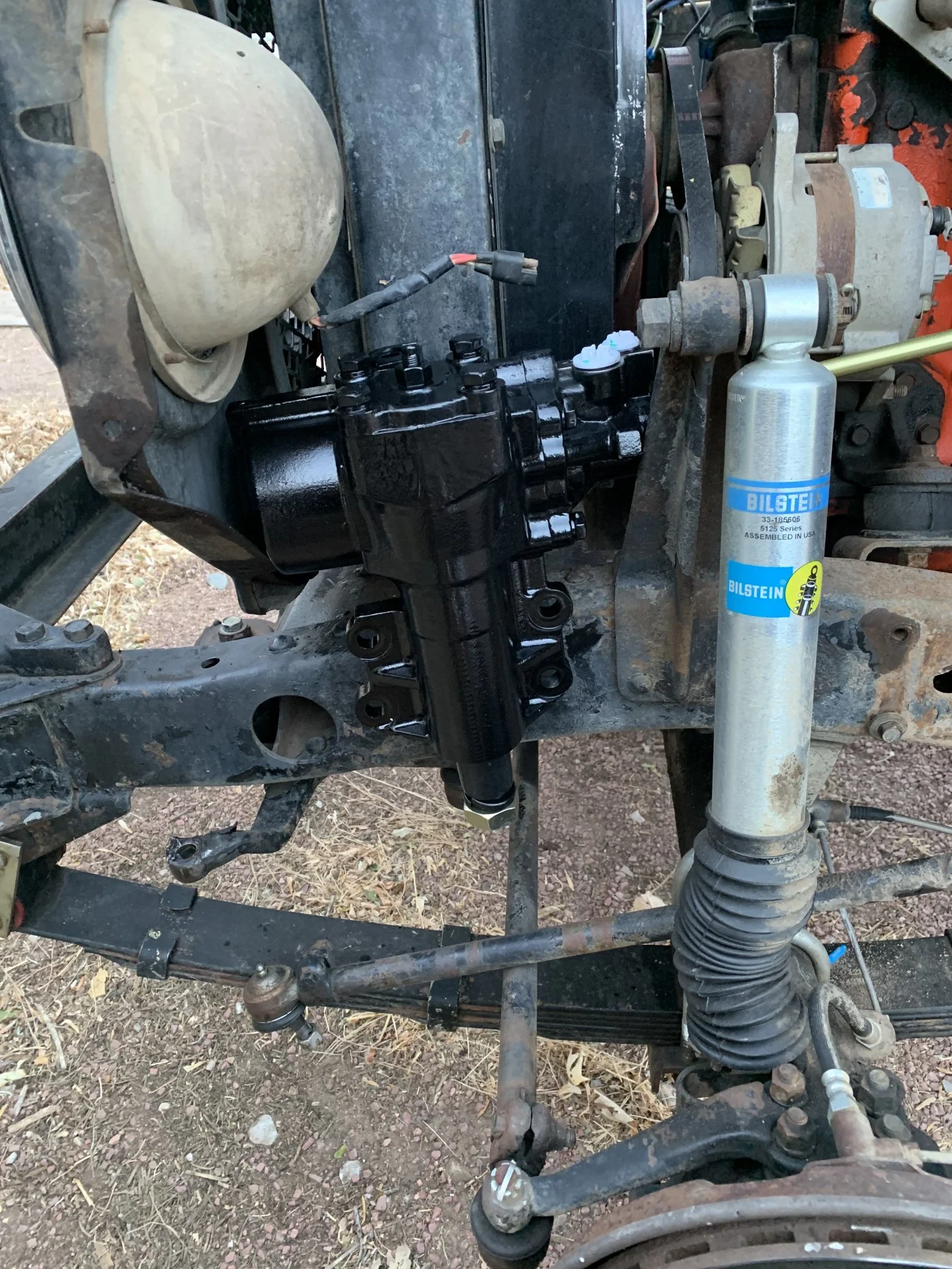

Started the tear down for the power steering. The FJ80 box is huge! Is definitely going to be a huge improvement. The radiator and grill definitely need to come off. Looking at it, the shock tower is the biggest source of interference and basically just flipping the support around to be to the rear of the truck seems to be the best way to get it out of the way.
