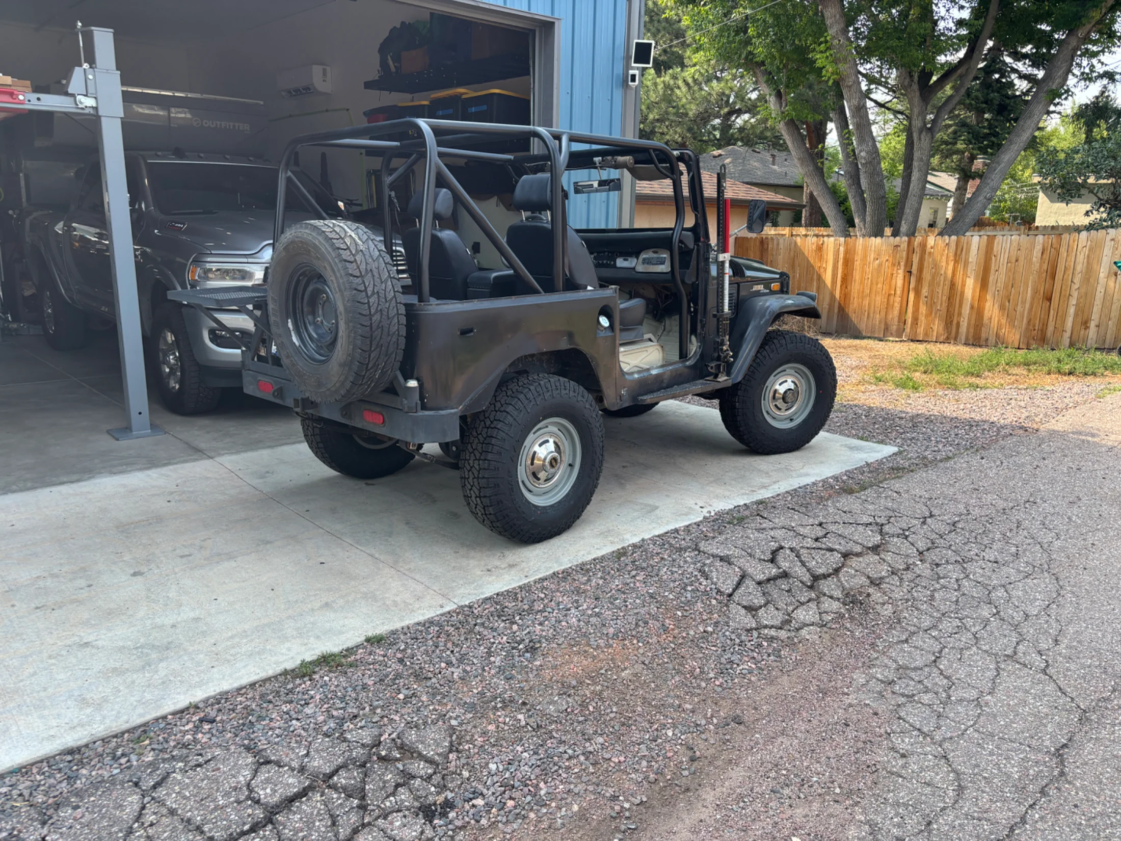

All wheels are mounted with extended lug nuts and they handle noticeably better. I’m thrilled with the look. In fact they’re so much smoother running now I can really feel a driveline vibration above 2k rpm’s in all gears!

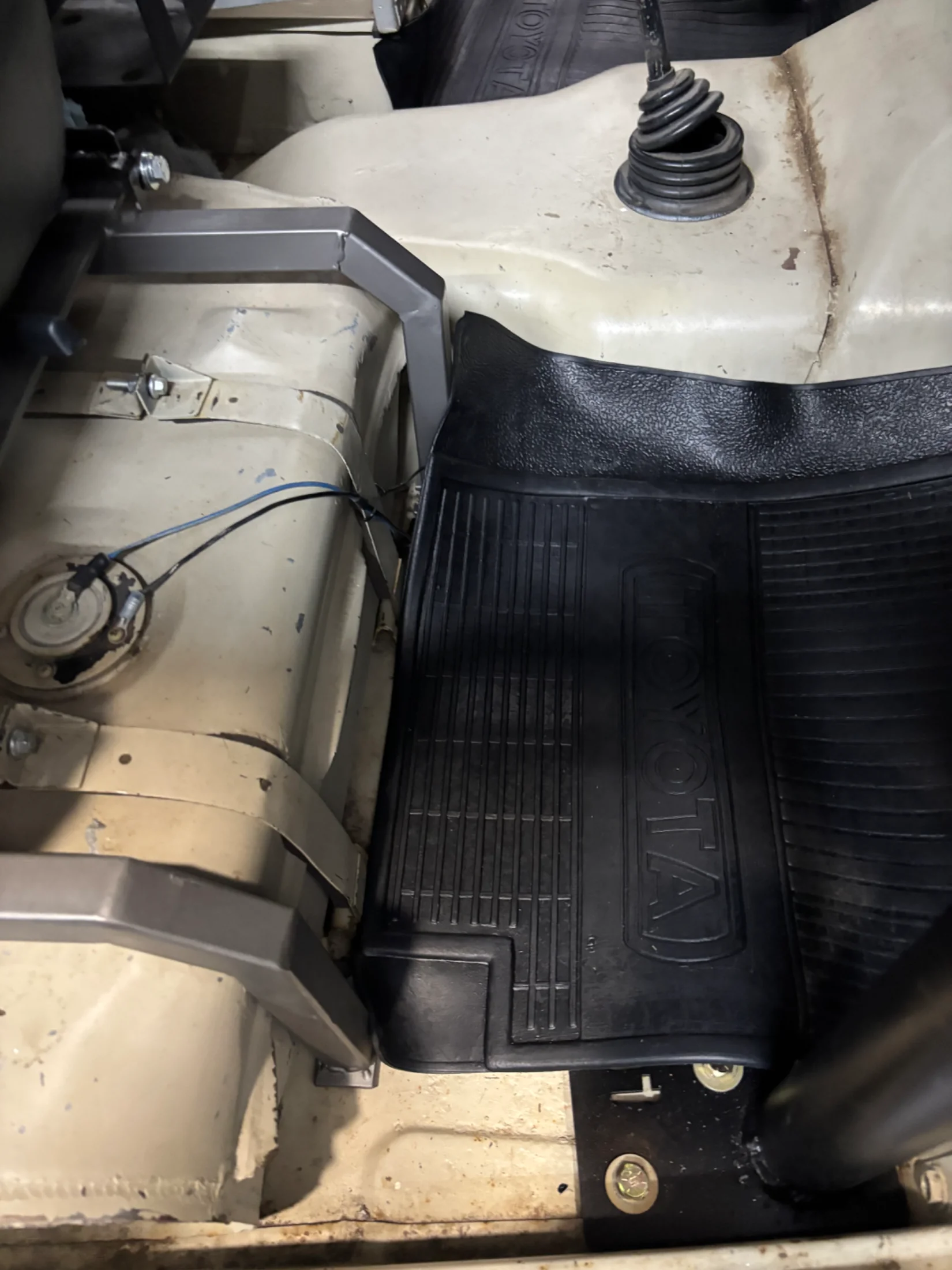

Also had my dad help me get the cage in, I think it looks so awesome and my boys are thrilled to have the 40 back on the road!

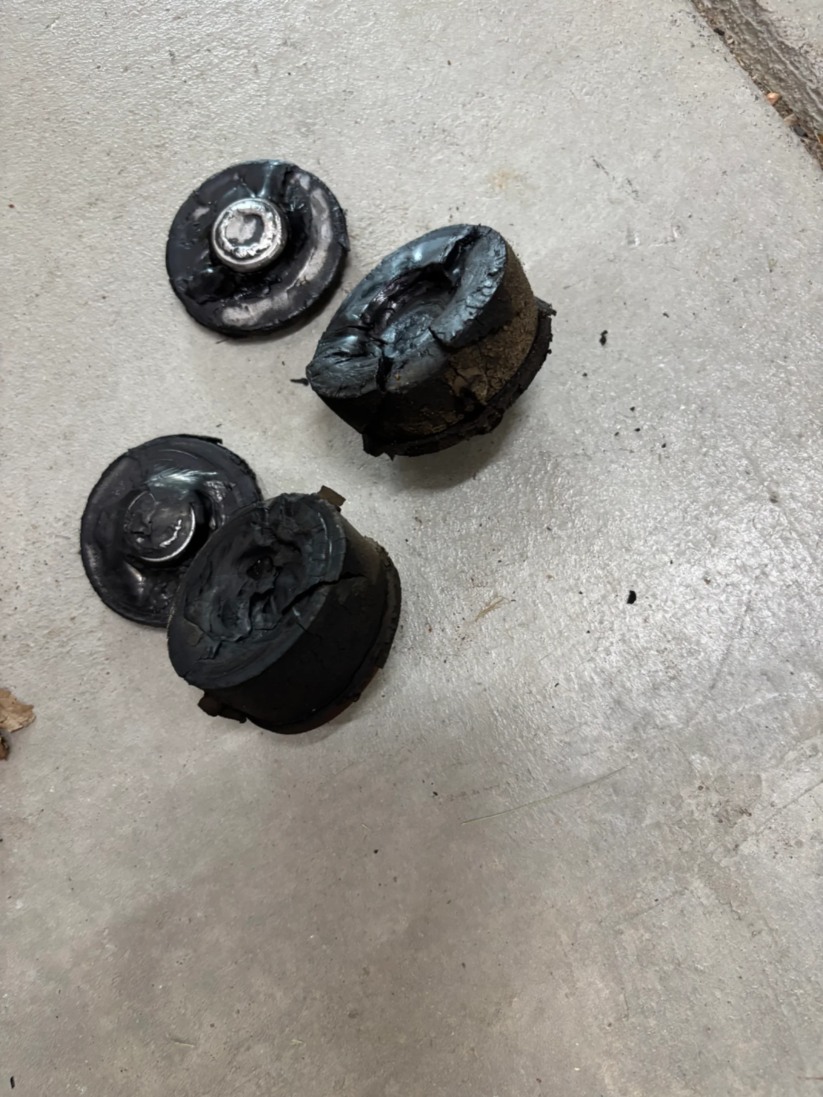

Spent most of the day today replacing the engine and transmission mounts, which were all in terrible shape. Much worse than I initially thought. I’m happy to report that after doing so, the harmonic vibration is…..completely unchanged. Whaaa whaa.
