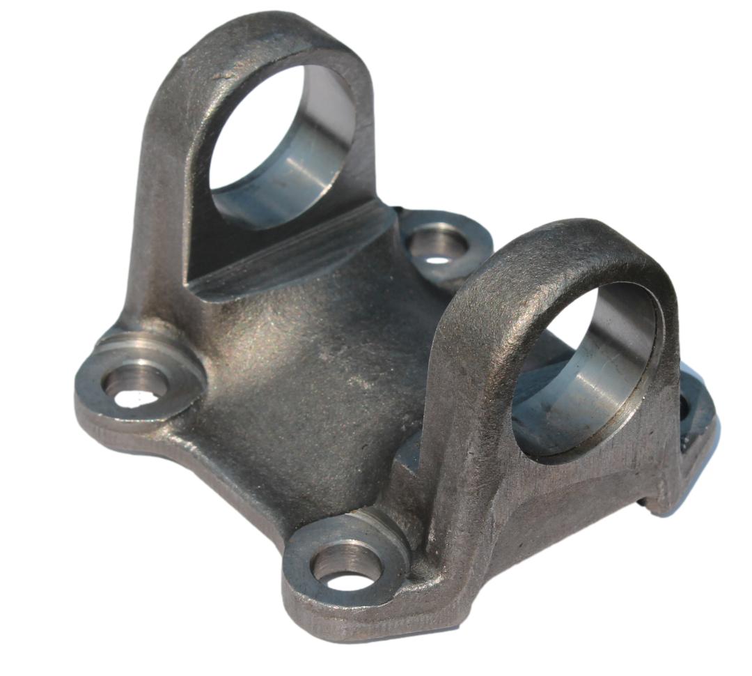

Does anyone know if I can swap the larger pattern flange yoke onto my 3spd driveshaft? I.e. are the joints the same? There is surprisingly little info out here on this!
You can interchange yoke ends because the slip joint splines are the same. You can swap pinion flanges too. They are either coarse or fine spline flanges. Some pinions have crush sleeves, so you need to know what you're desling with. @cruiseroutfit can help you out. You can get a round flange and drill it.
I think the joints are different.
Looks like they changed in 74. Bummer.
My driveshaft tube has a big dent in it, so might just be time. Wanted to wait till I got the new power train in to get a custom driveshaft…
Getting close to having the axle all ready to rip. Ended up just drilling the round pinion flange to match my existing driveshaft. It took forever, but was the free option. Just couldn’t justify a few hundred on a new shaft when the plan is 12HT soonish which will require a new one anyways.
