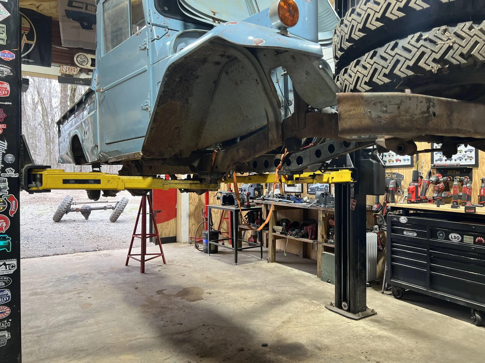

I jumped back and forth from the two 45s today. When I stalled out on the SWB I dove into the LPB.

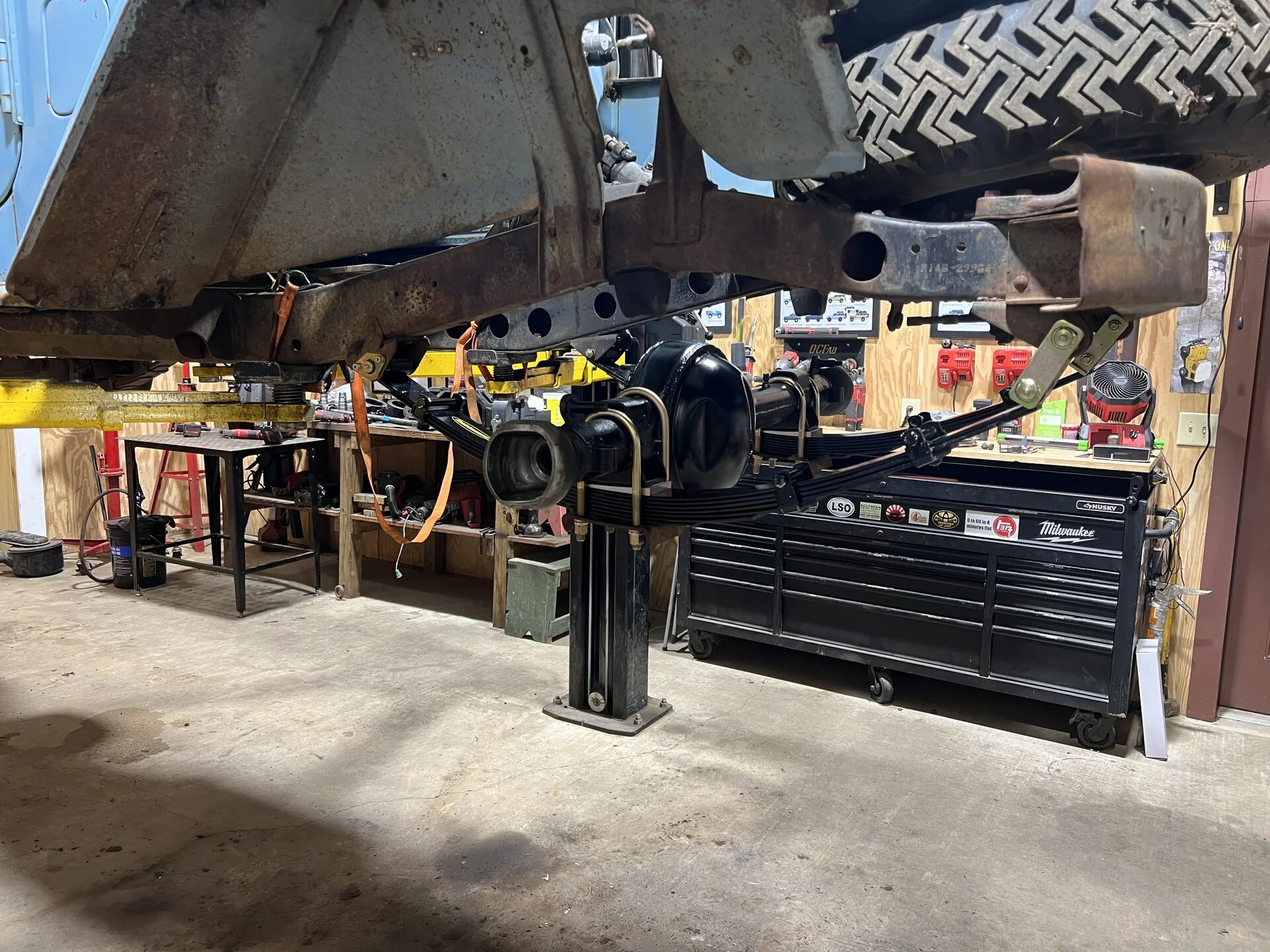

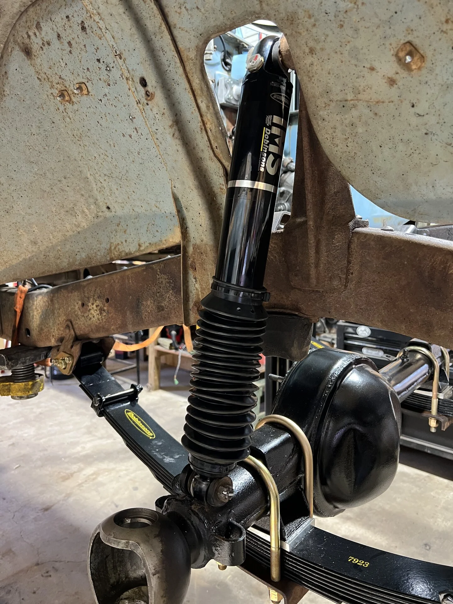

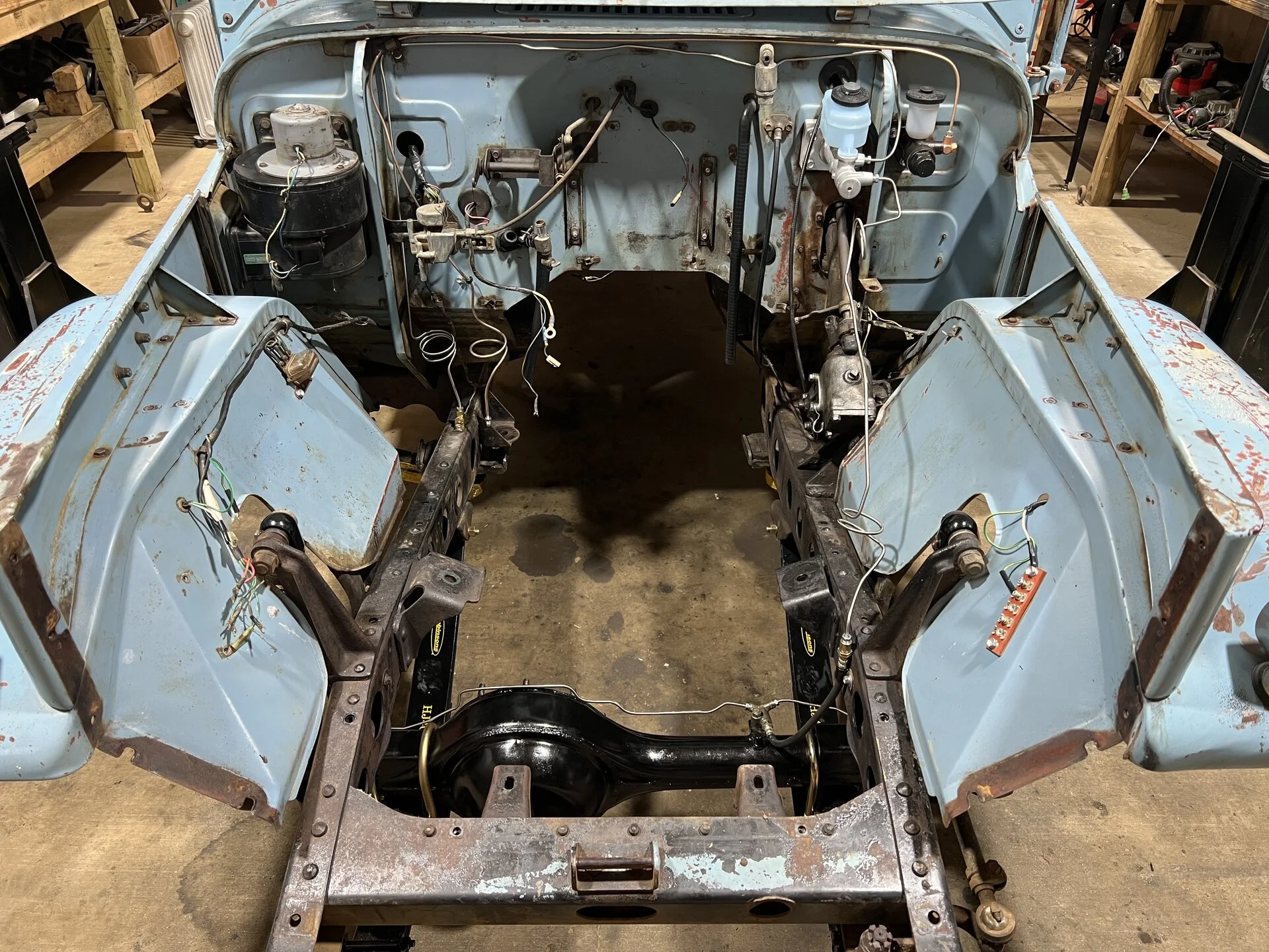

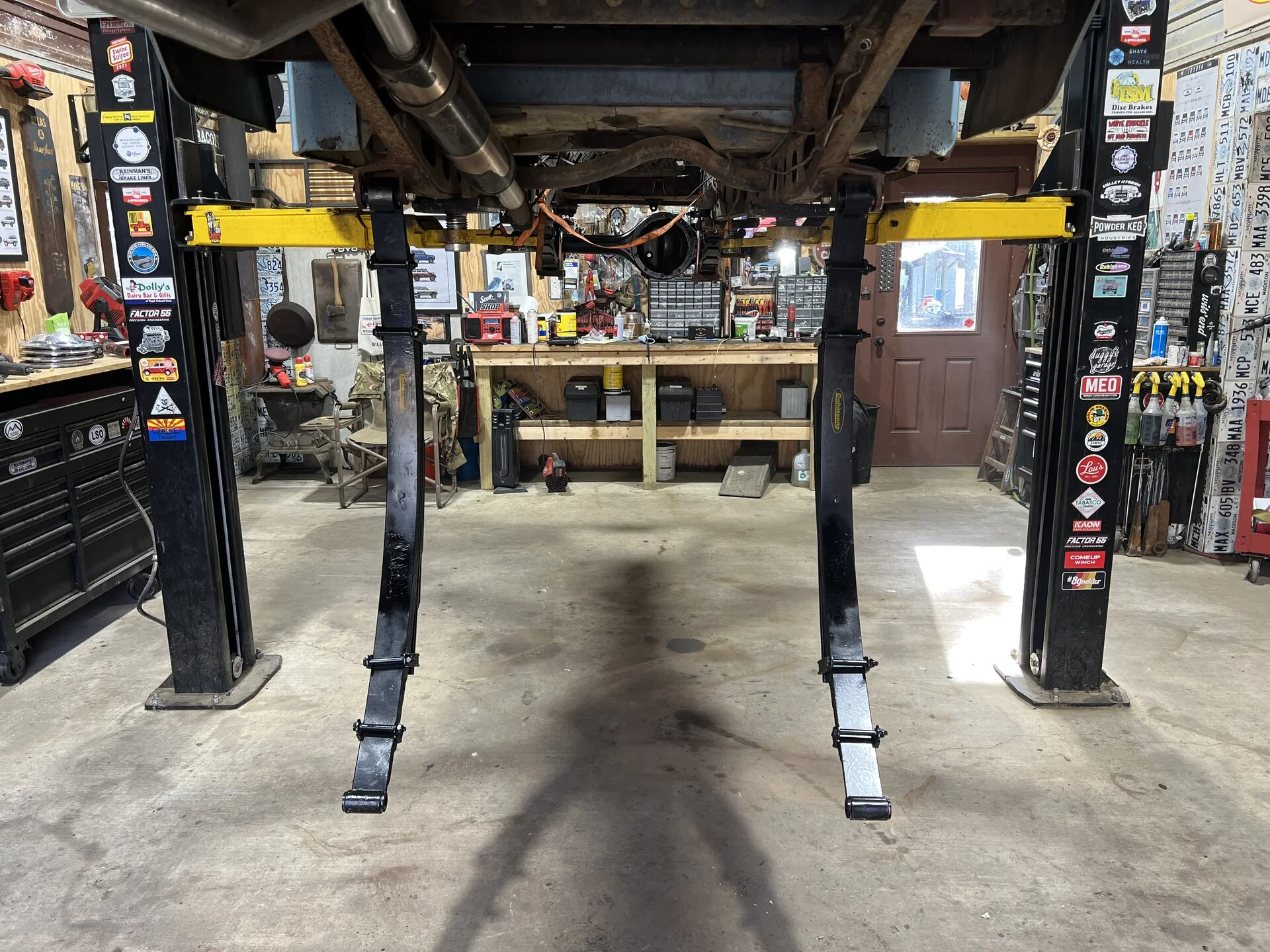

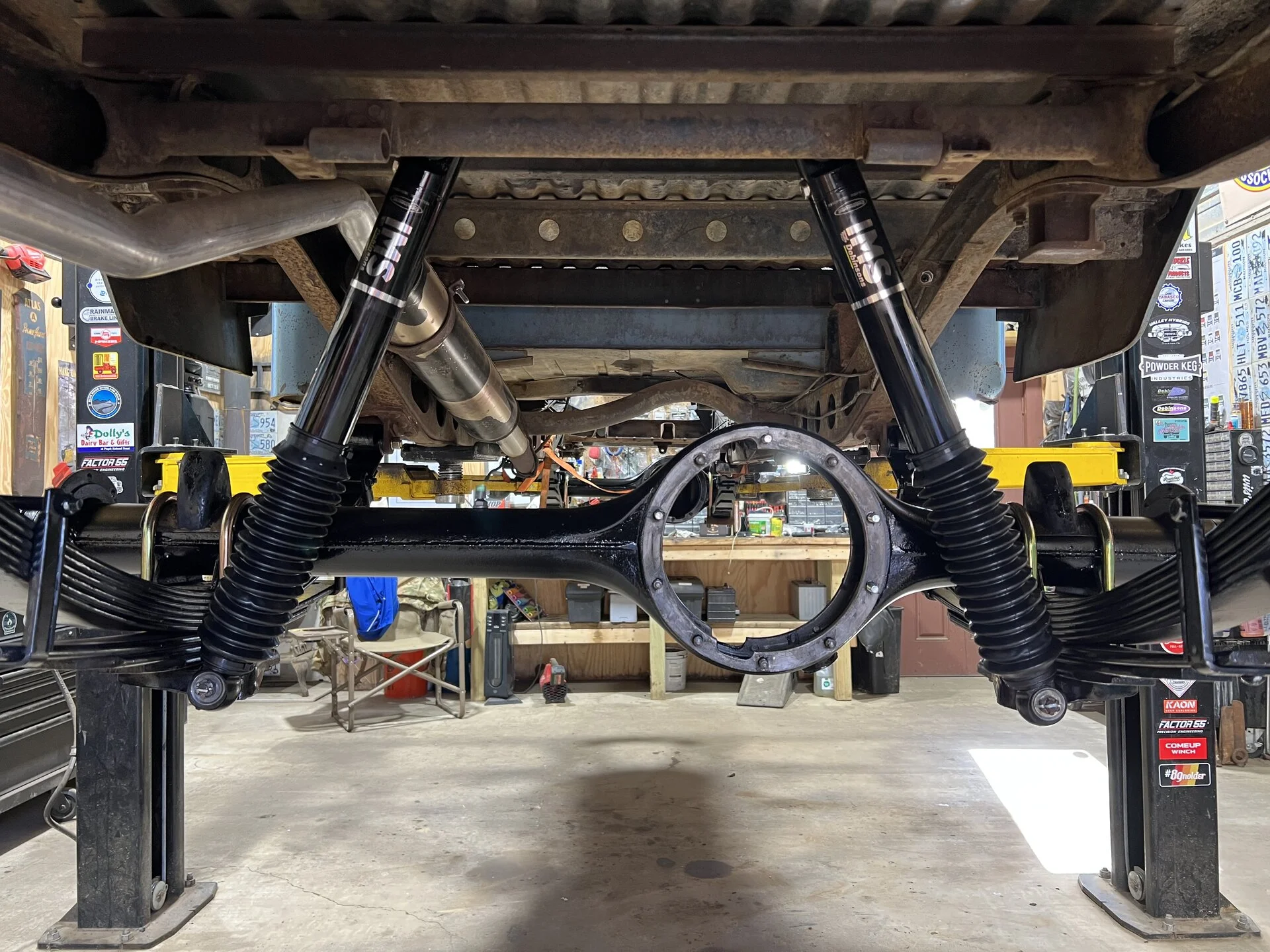

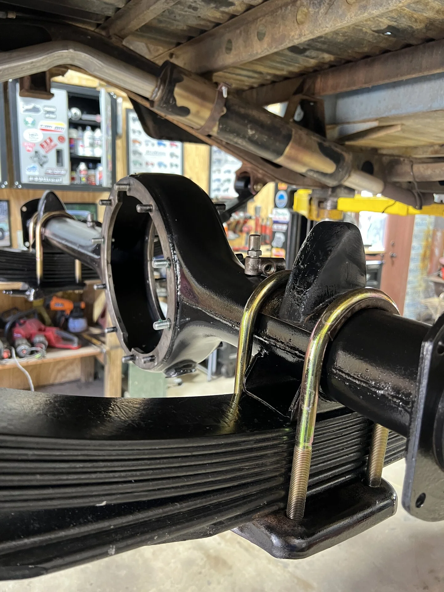

I ripped out the front axle and whipped stock springs and got the Dobinsons and “new” housing in place with some 4* caster shims

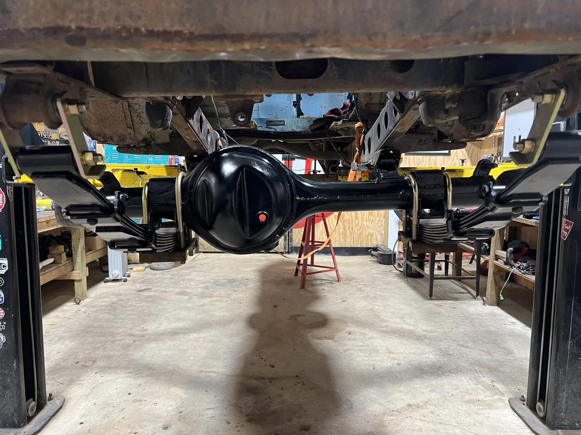

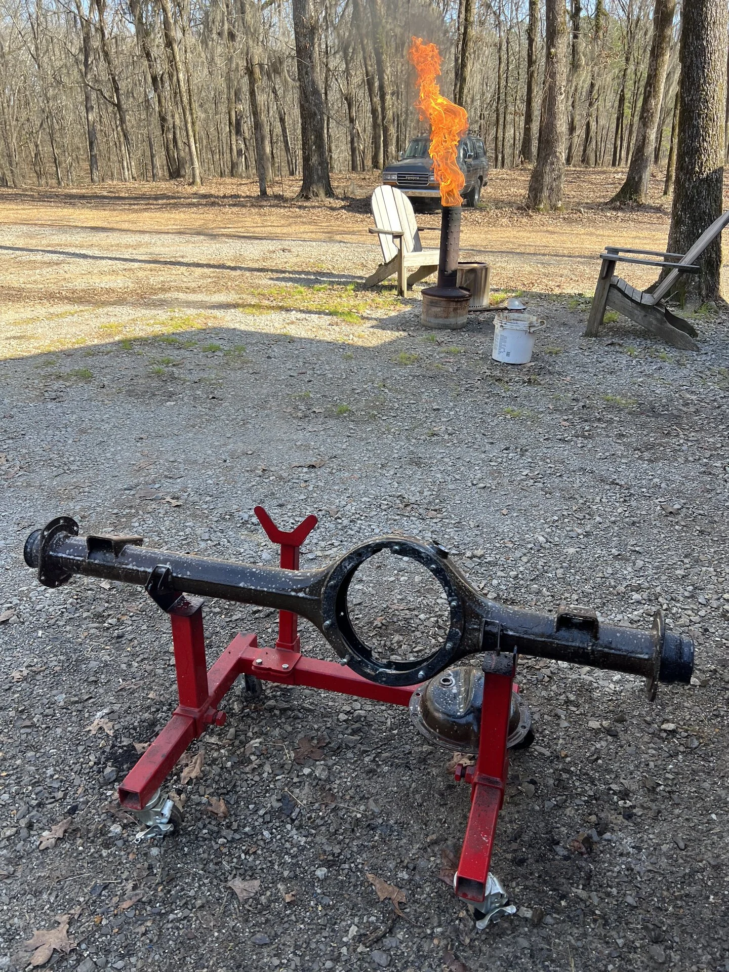

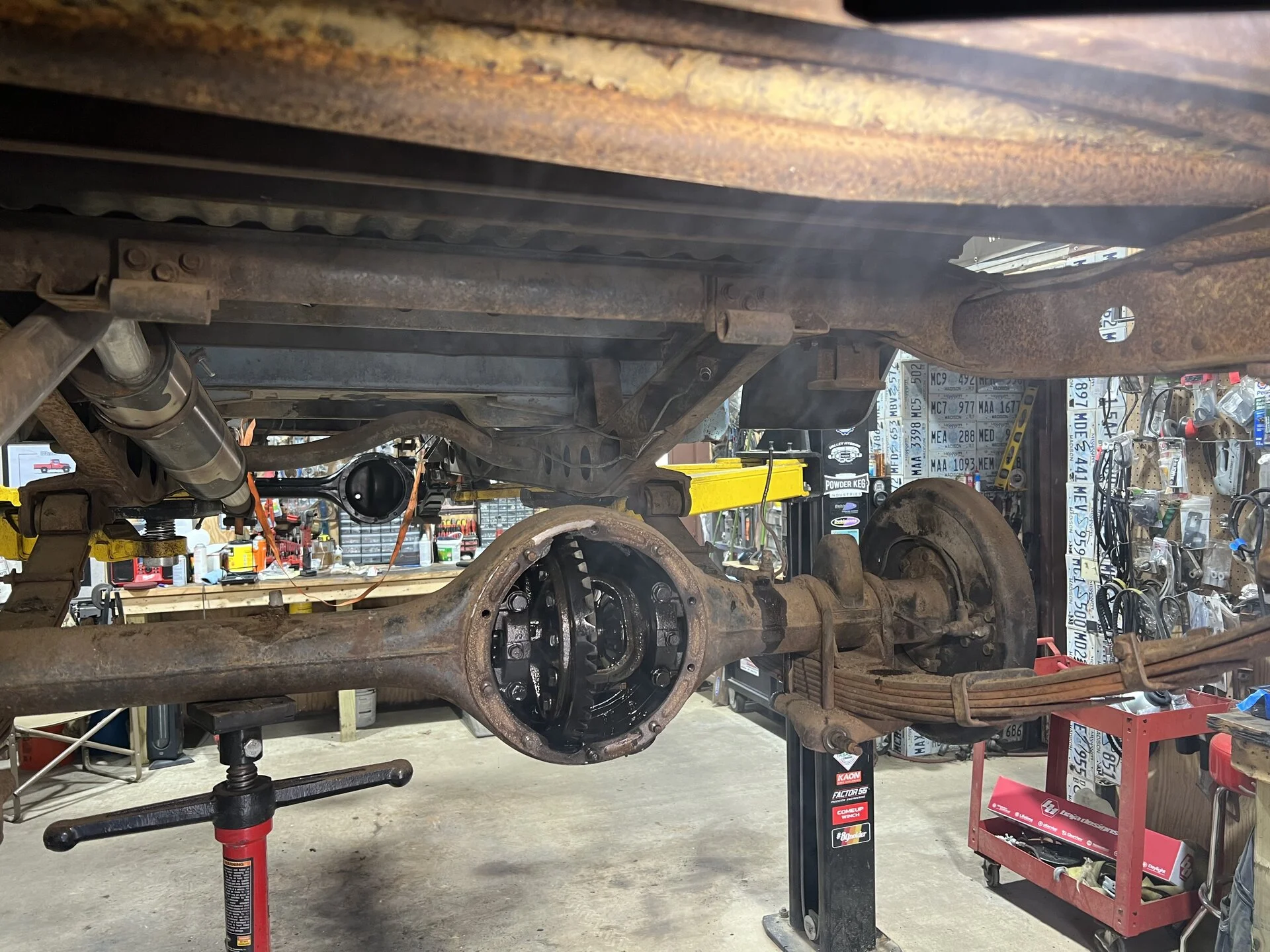

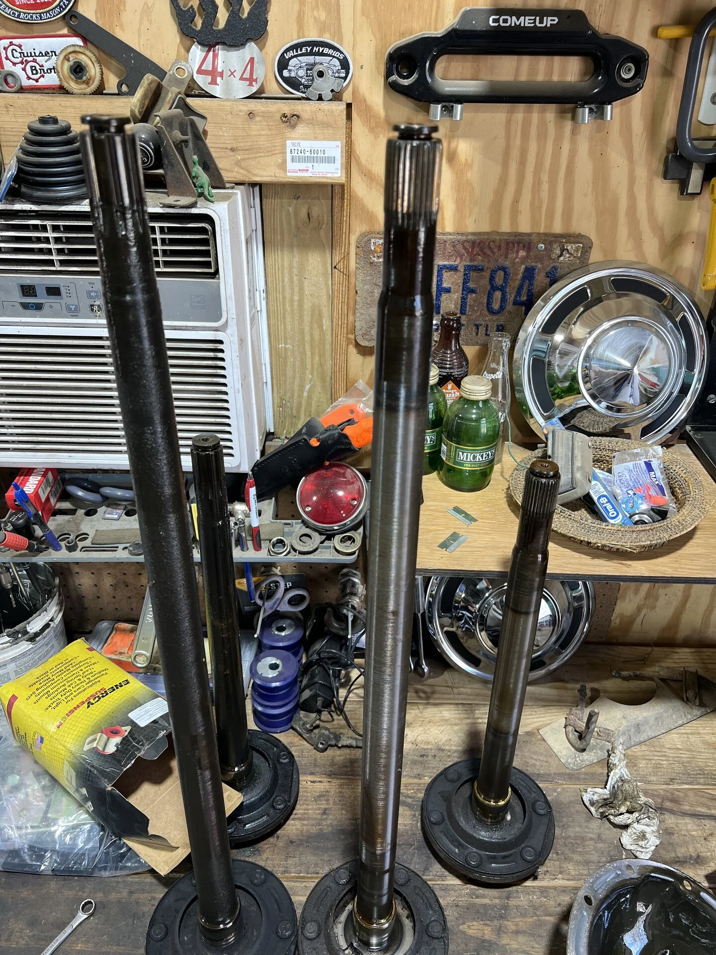

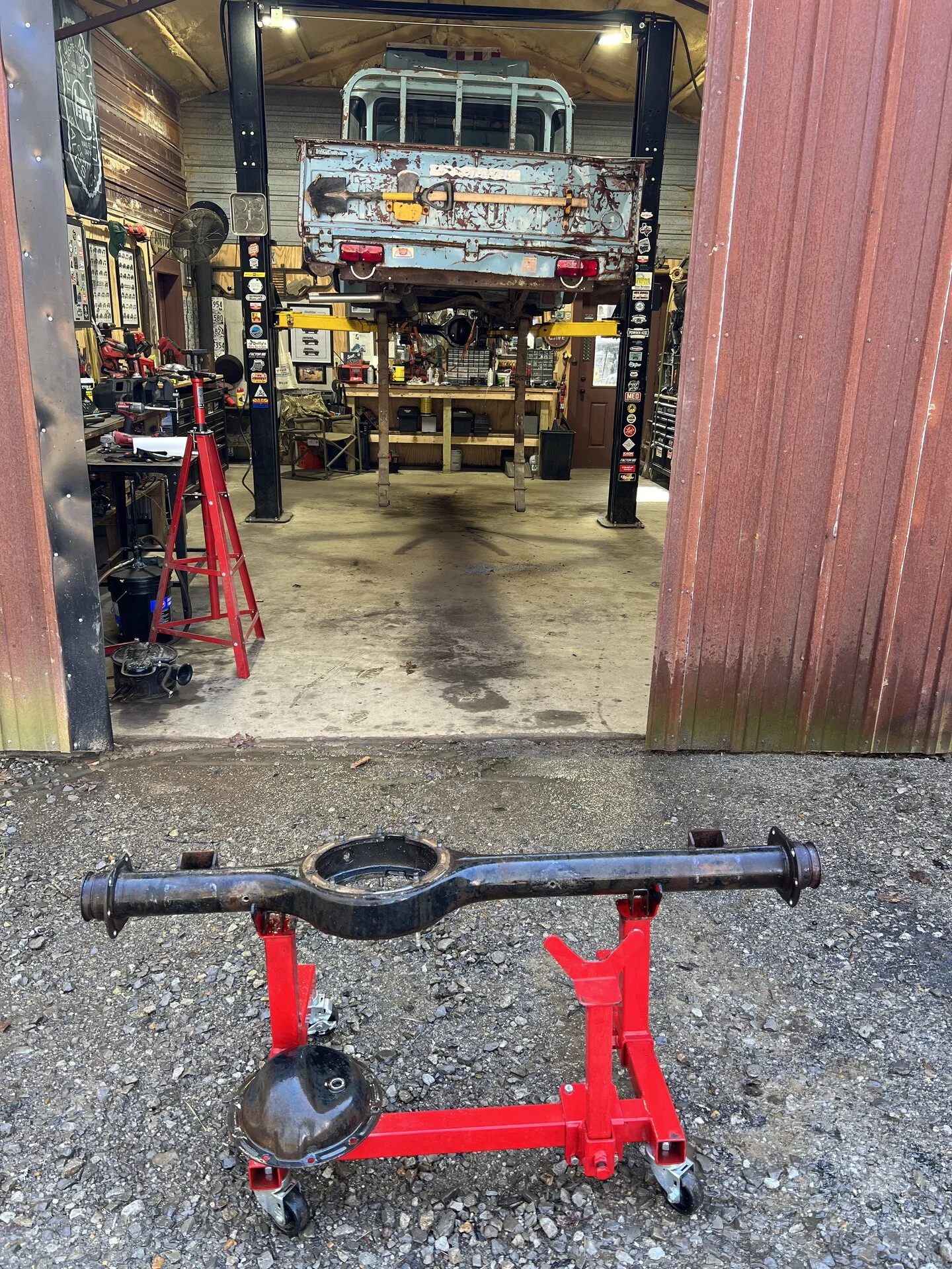

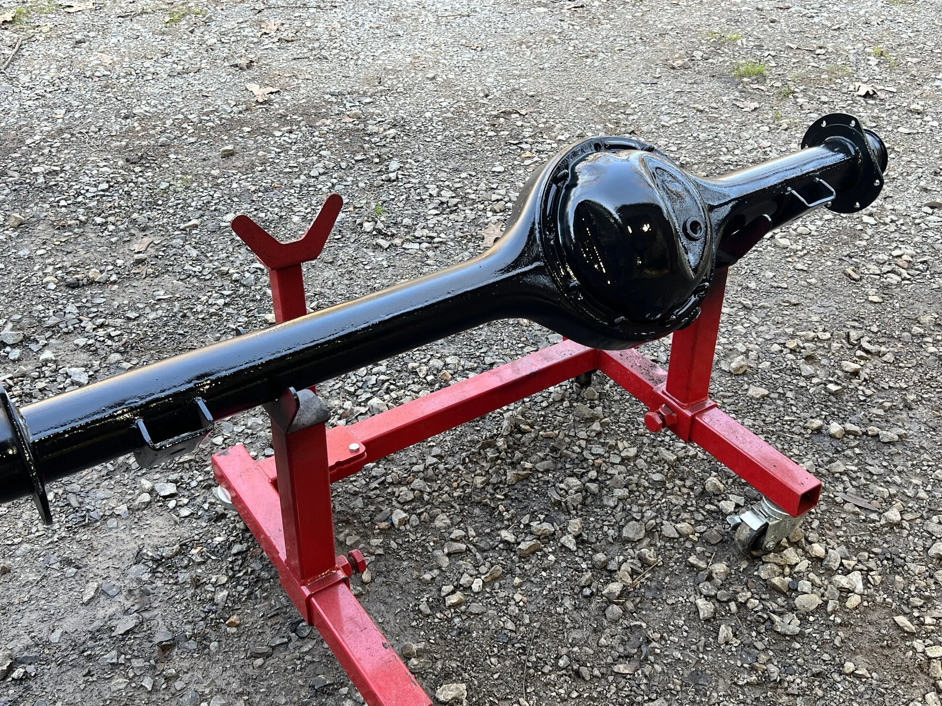

Spent the morning harvesting some rear inner axles since the ones in 1967 were 10 spline and the 3.70s going in are 30

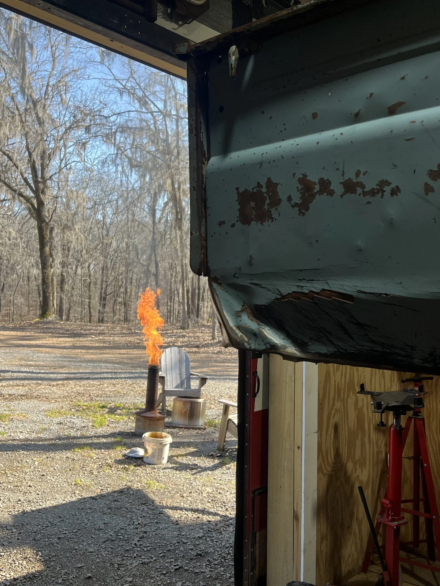

Also burned off some waste CA oil in the CA smudge pot

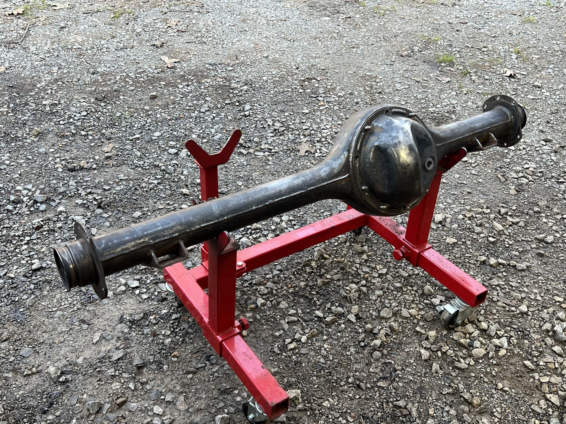

Turns out these semi float rear bearings are different than the ones I have here so the rear is on hold until the correct ones arrive from @cruiseroutfit

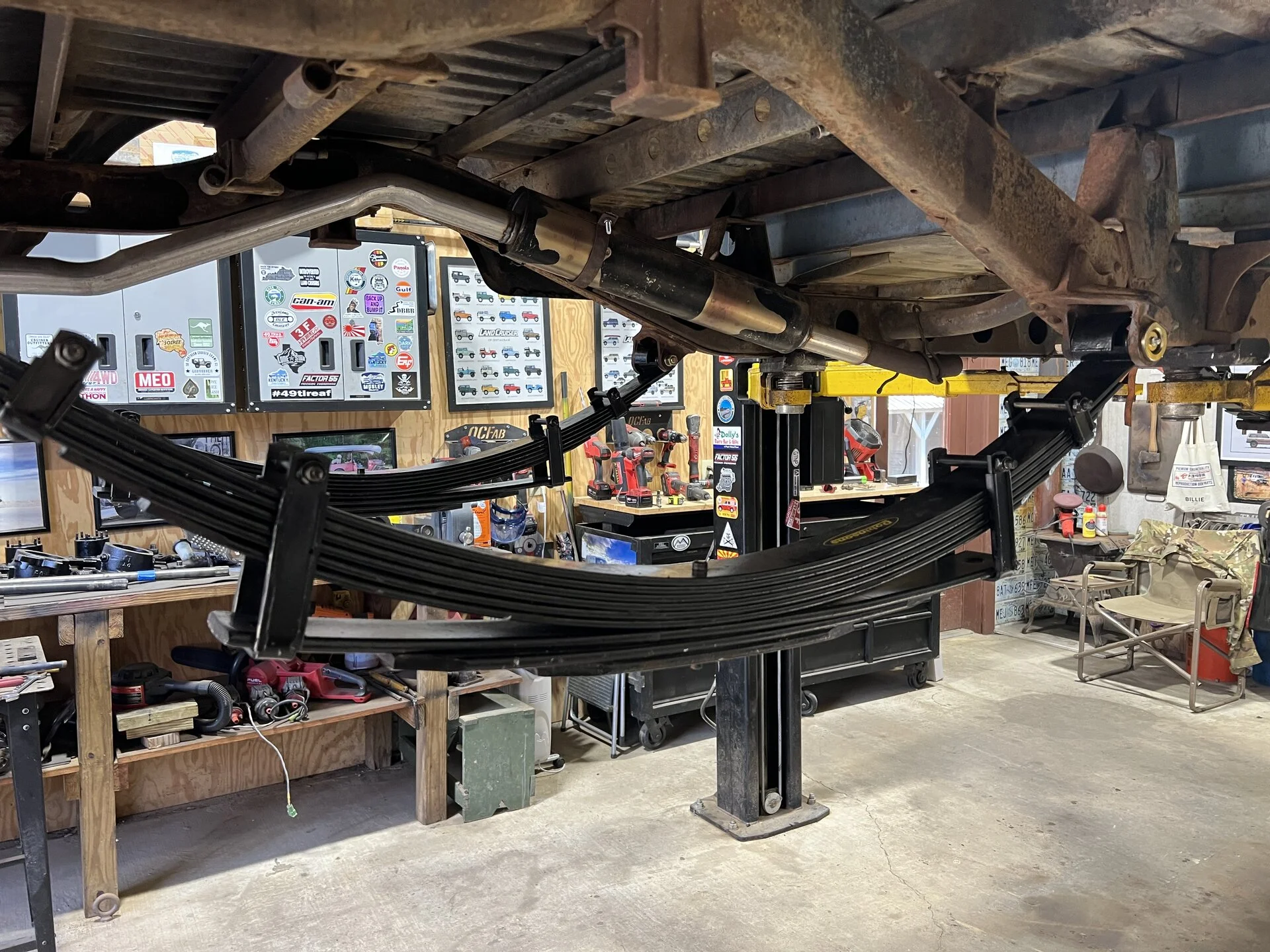

Meanwhile the suspension is in place.

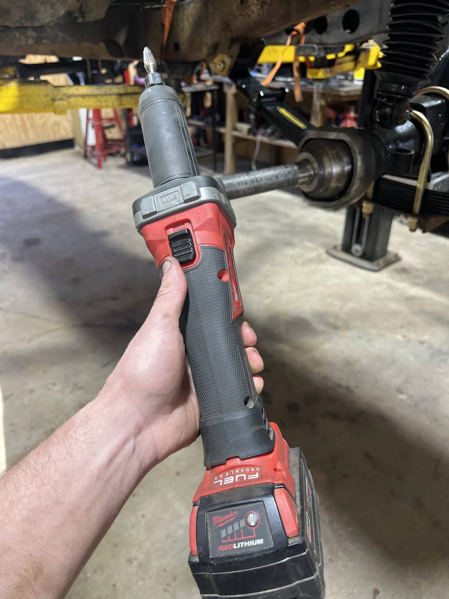

I clearanced the housing for the big Birfs. This tool makes short work of it

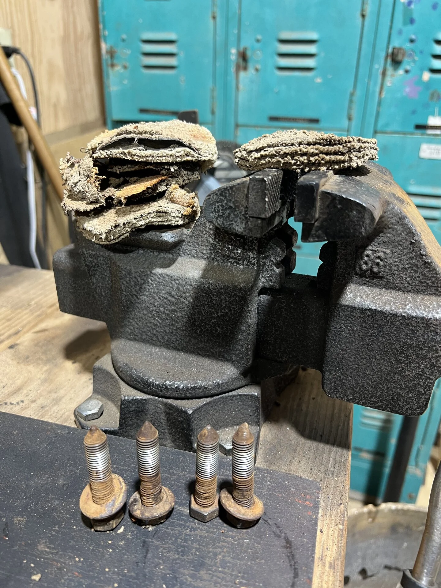

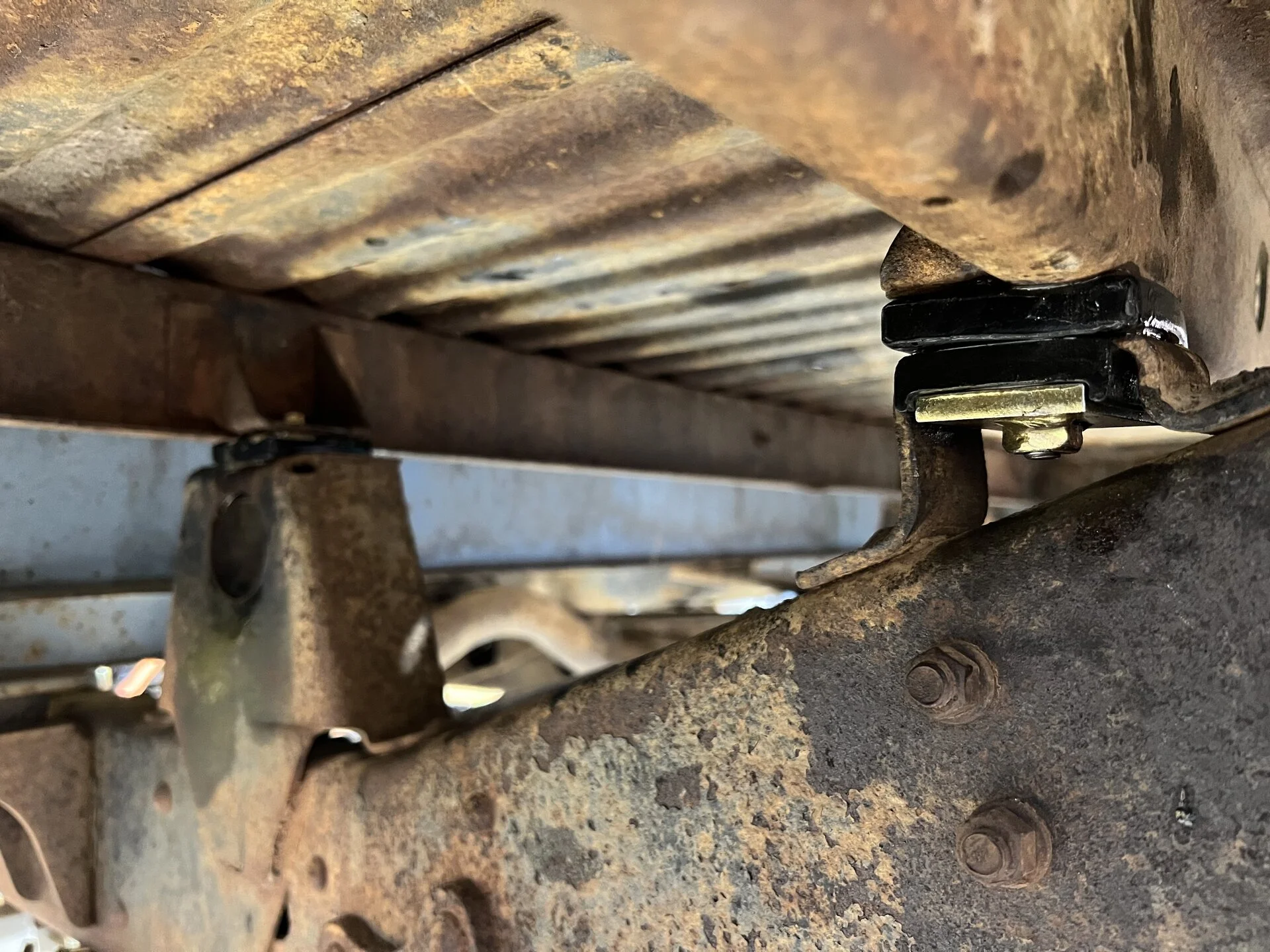

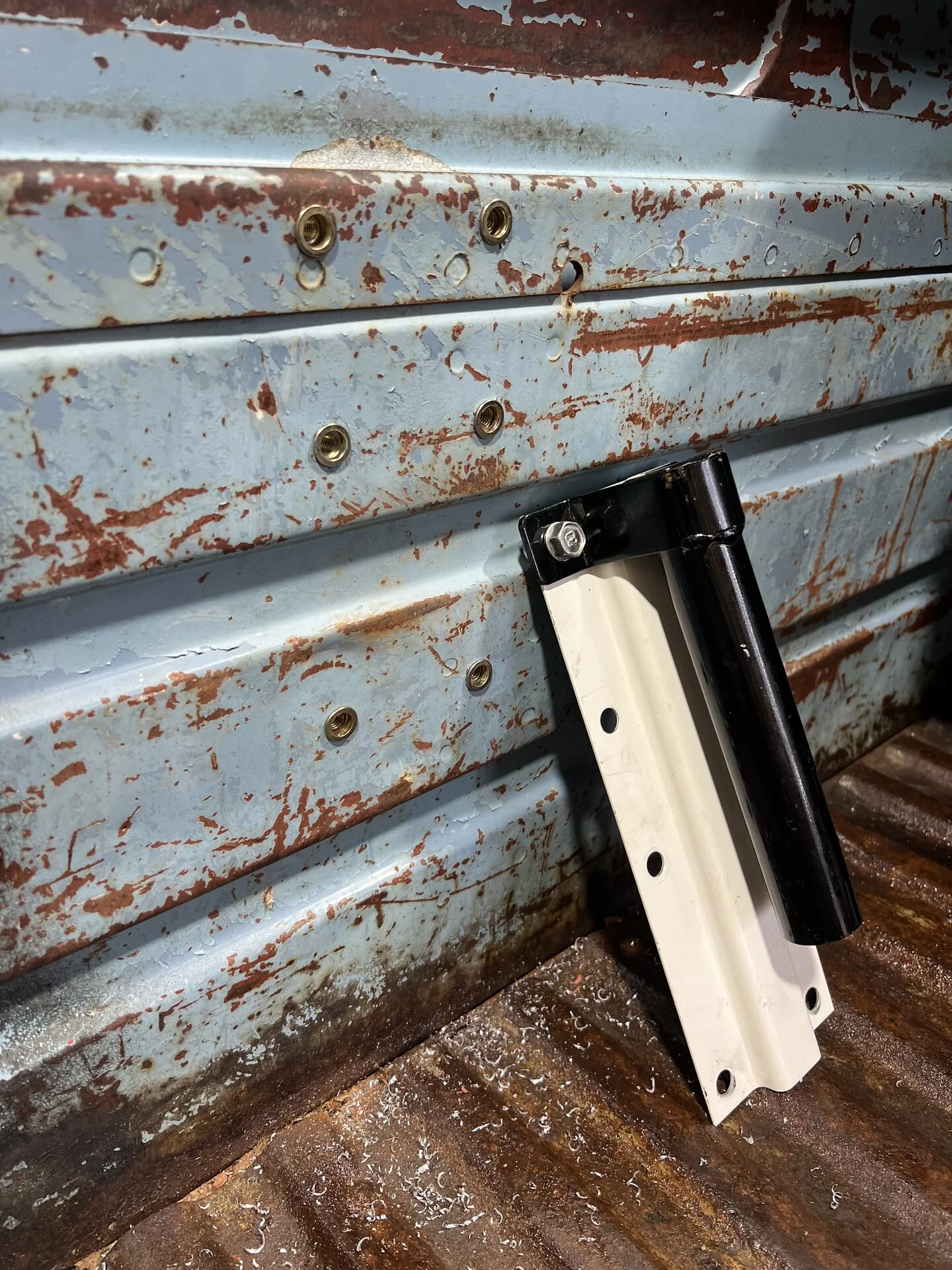

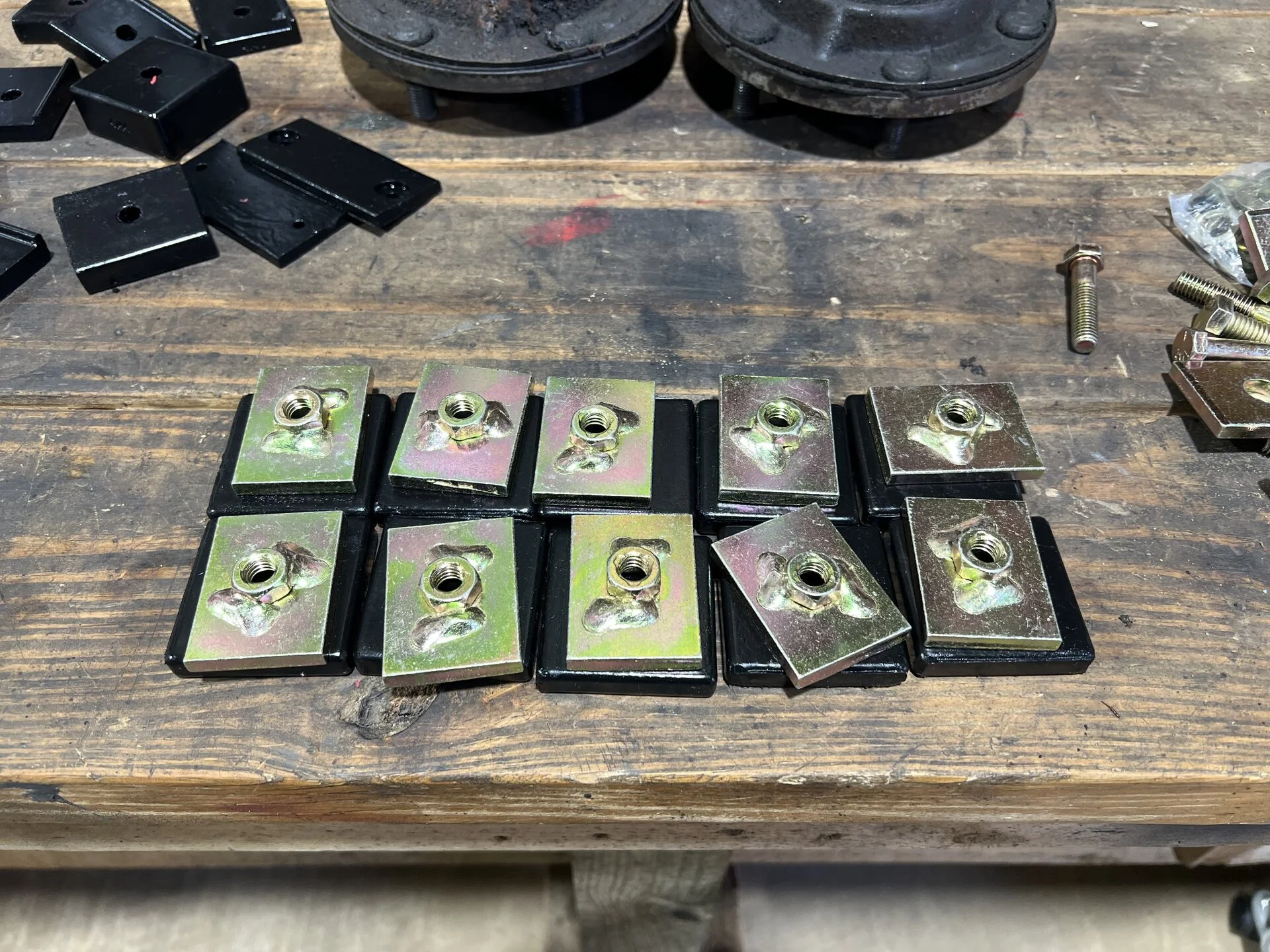

Then I went to work adding new body mounts to the bed. The FJ40 kit has just enough to do the bed. The cab mounts are still solid. This was the same as my LPB. Seems this cloth dies over time.
All set. The bed was basically metal on metal on 6 of the 10

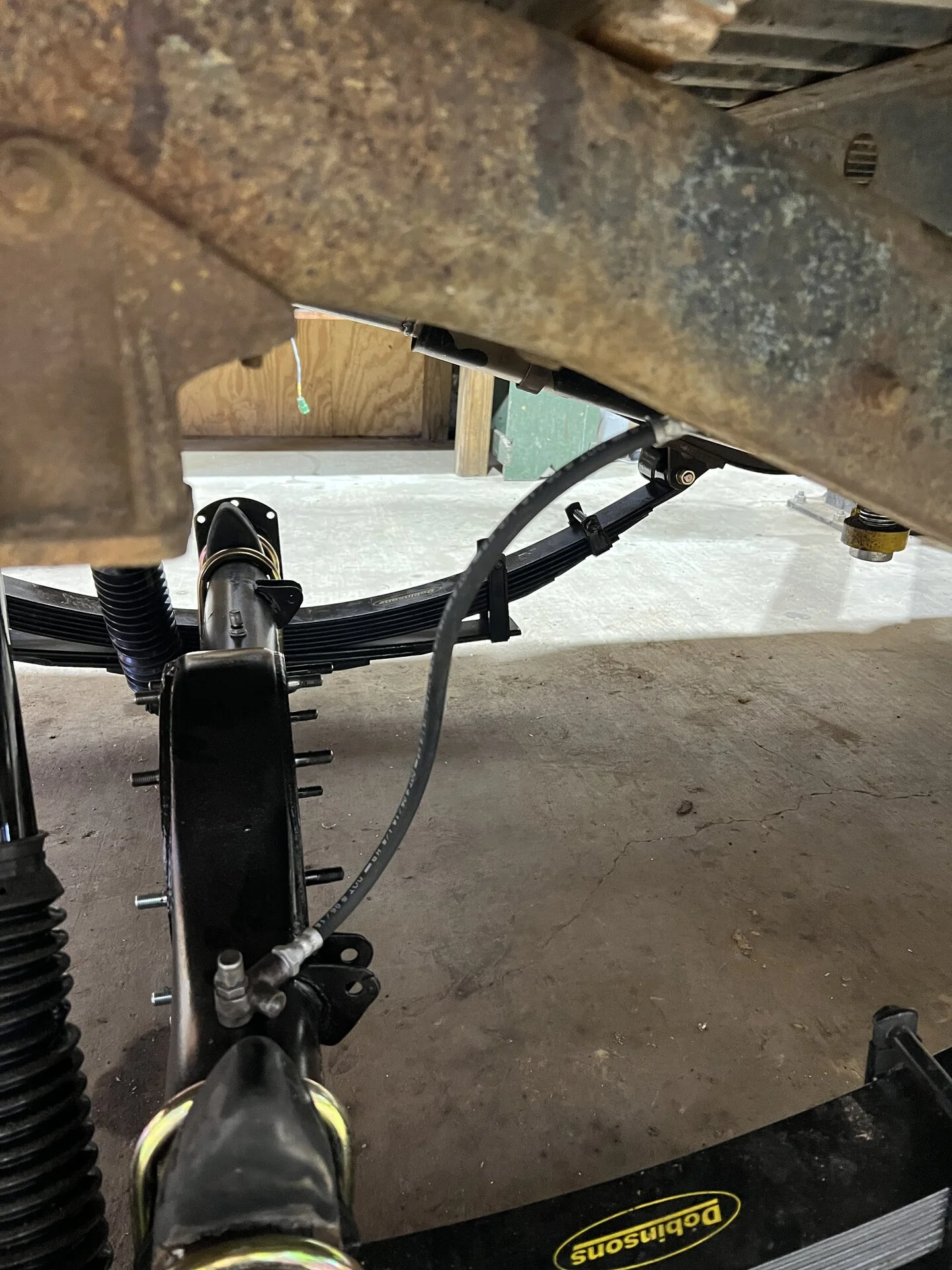

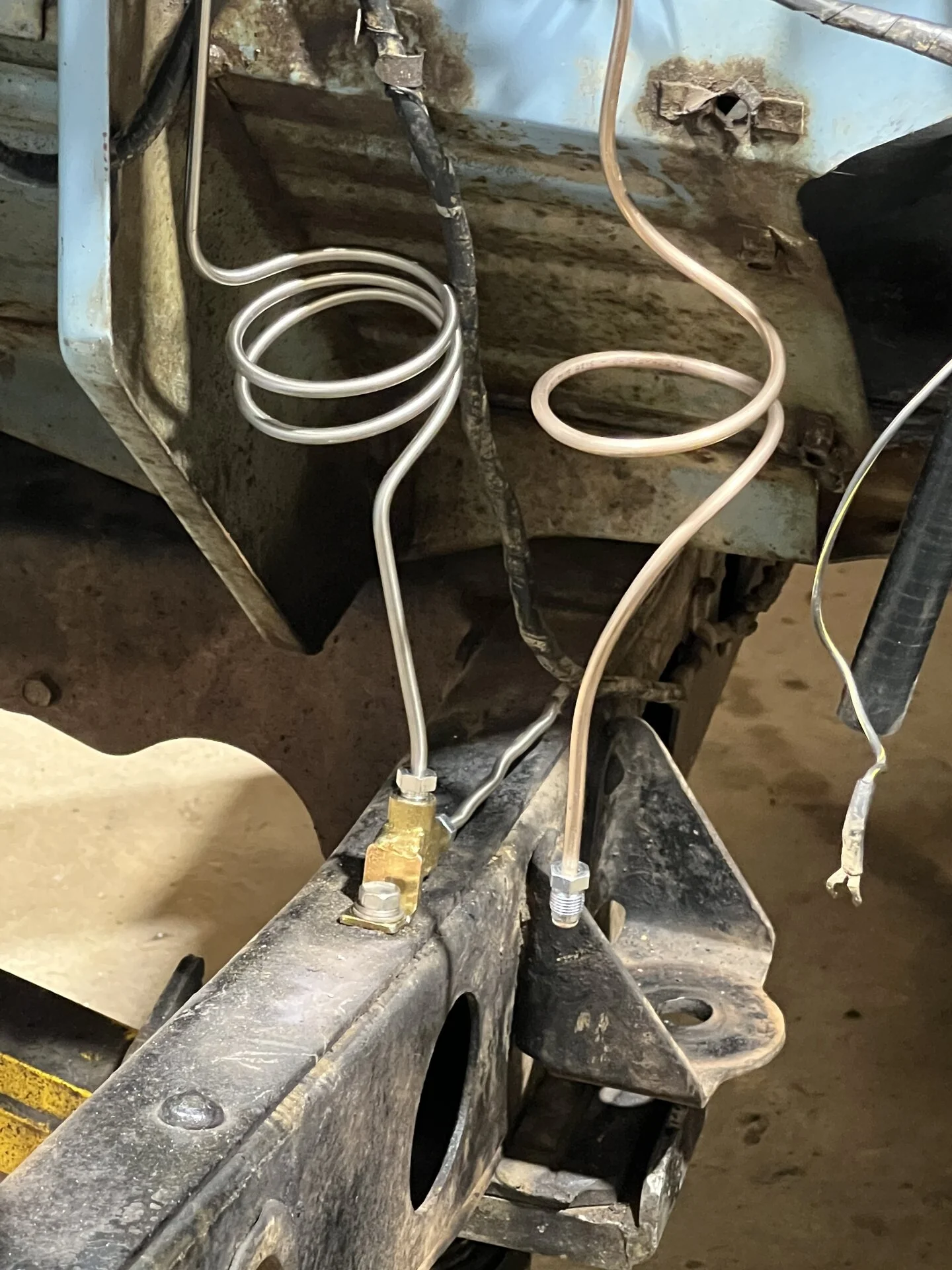

No pallet today so I went ahead and made/mated up new brake and clutch lines.
Nothing very exciting here except all the 9mm/drum brake crap is gone. That’s a win all the way around
Did you save the 9mm fittings and splitters? I would gladly take them if they're getting scrapped. Trying to keep a couple 9mm equiped rigs original (40 and stout).

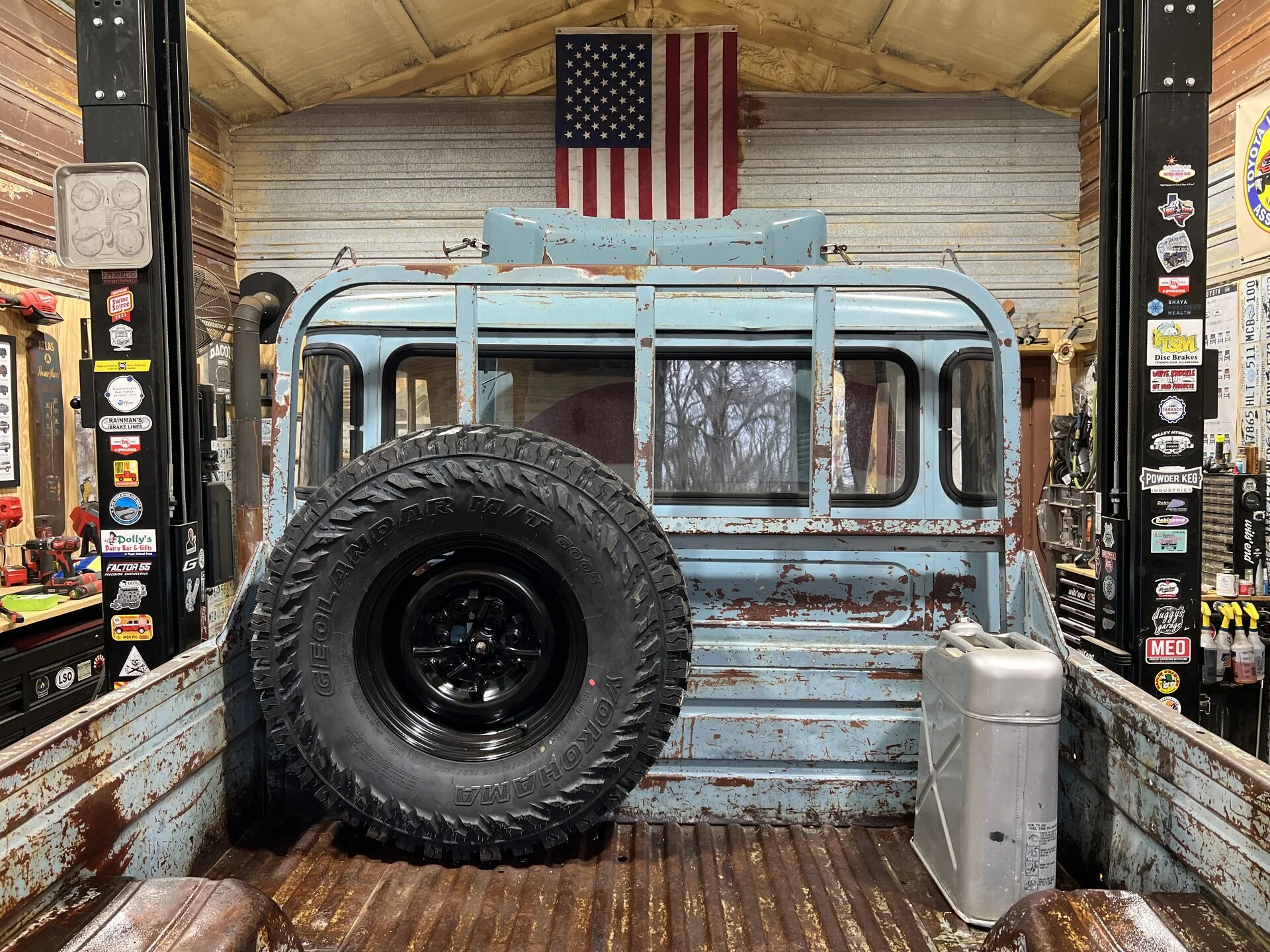

My buddy from Canada Dan Martz hooked me up with a 70 series rear tire mount. I learned my lesson on the Goat to mount these full driver side or all you see when you are backing a trailer is a tire.
