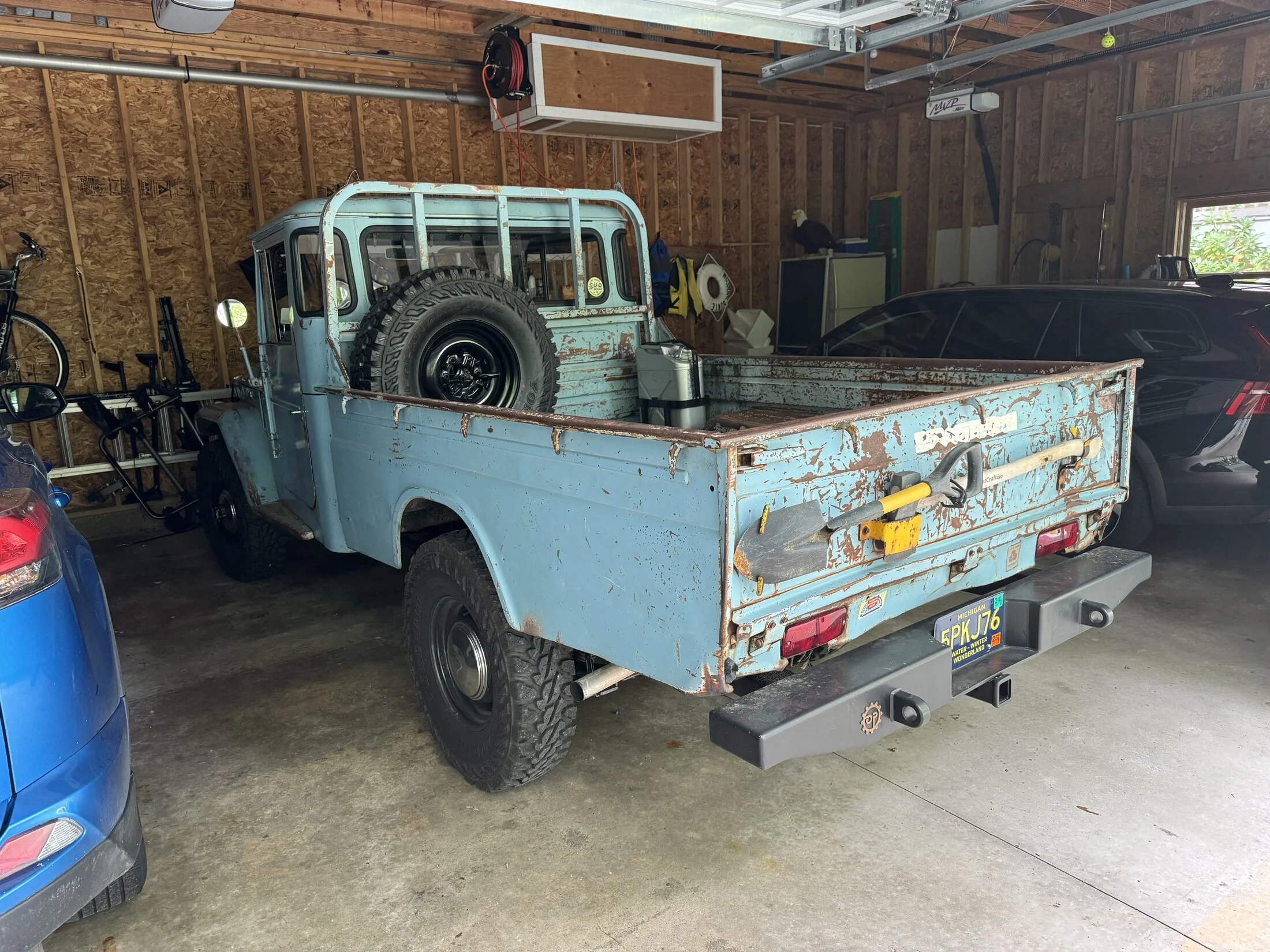

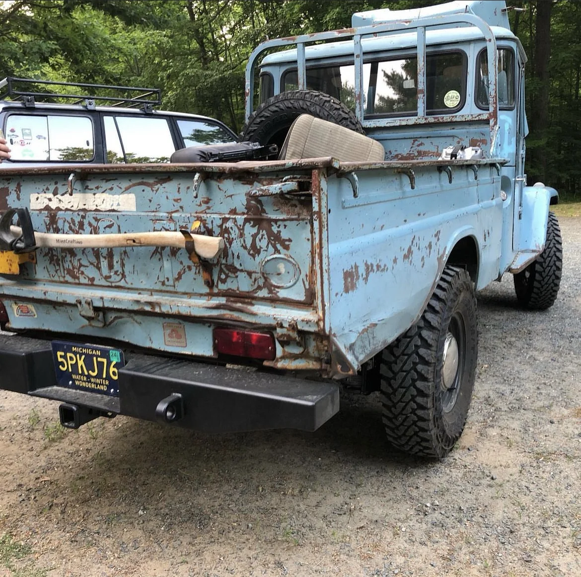

Got to inspect and put about 50 miles on LP Blue today. What an awesome ride in an awesome part of Michigan

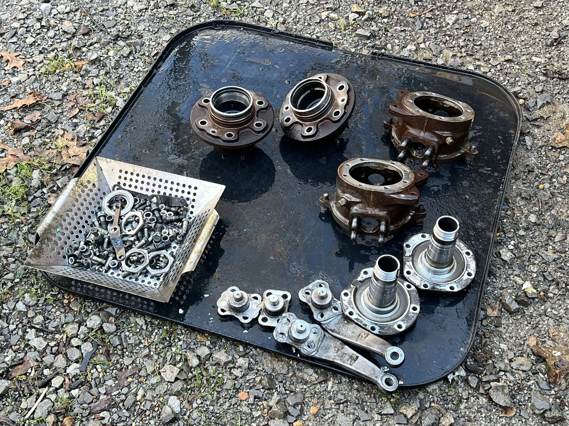

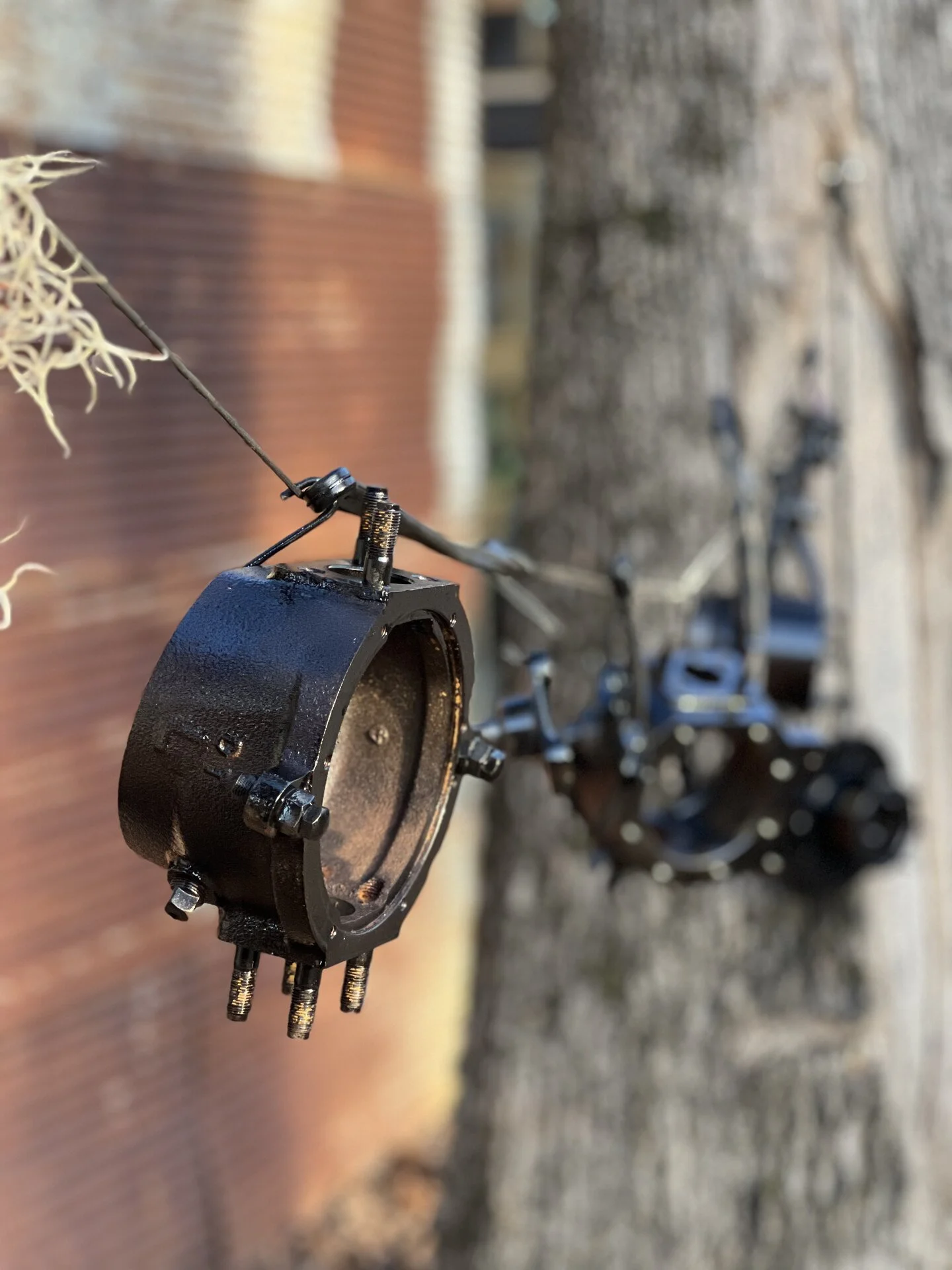

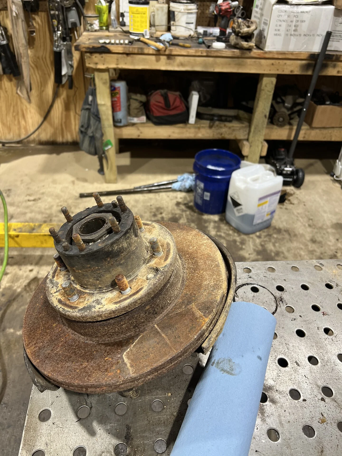

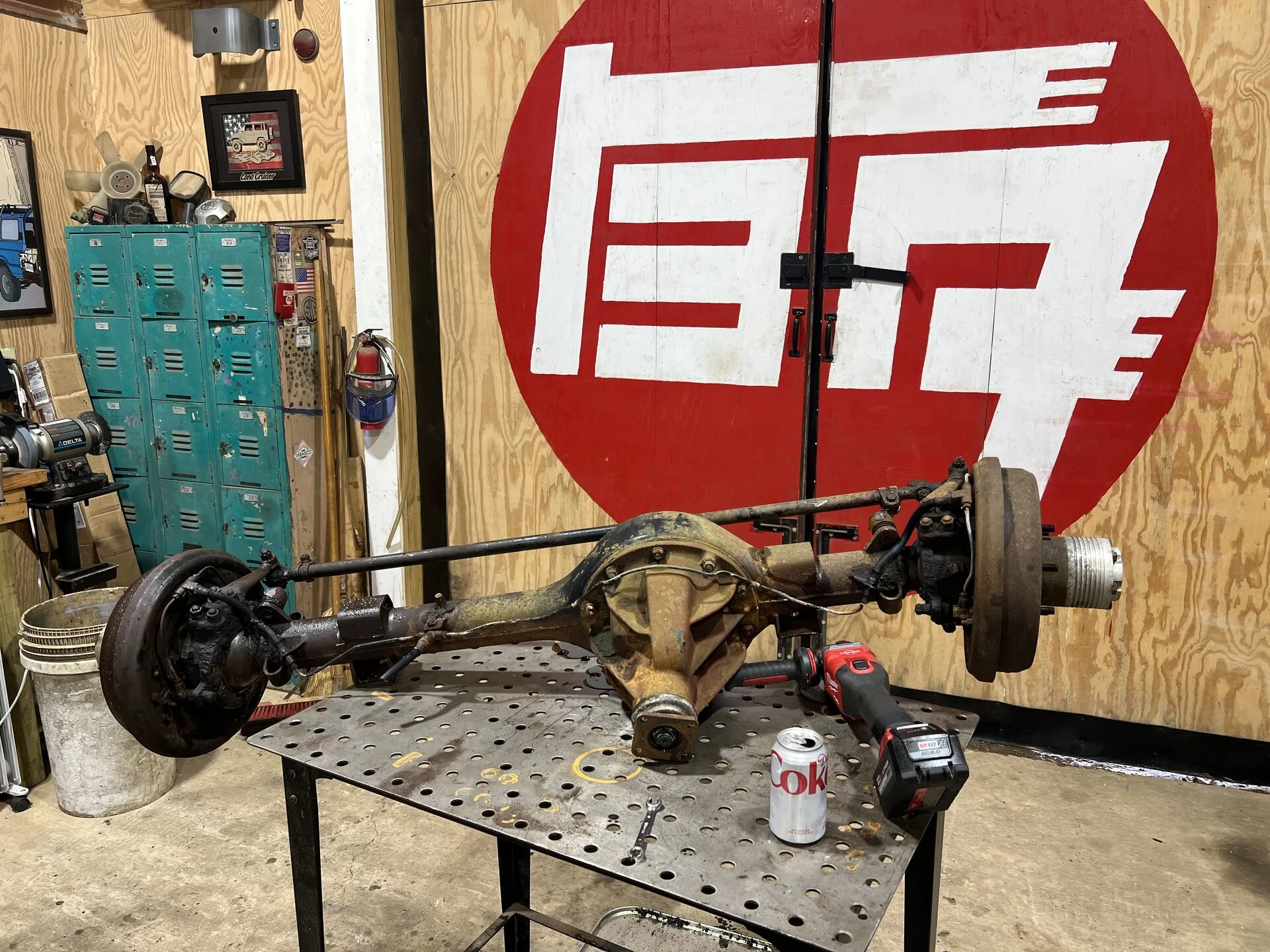

Since this truck has a ball and claw front axle I had to source a 68+ housing and some brakes.
I had a parts pig here I cut the axle out of and a FJ62 axle I bought for the brakes.
This is lot of work and why the super cool pre 68 trucks are so labor intensive to make drivable.

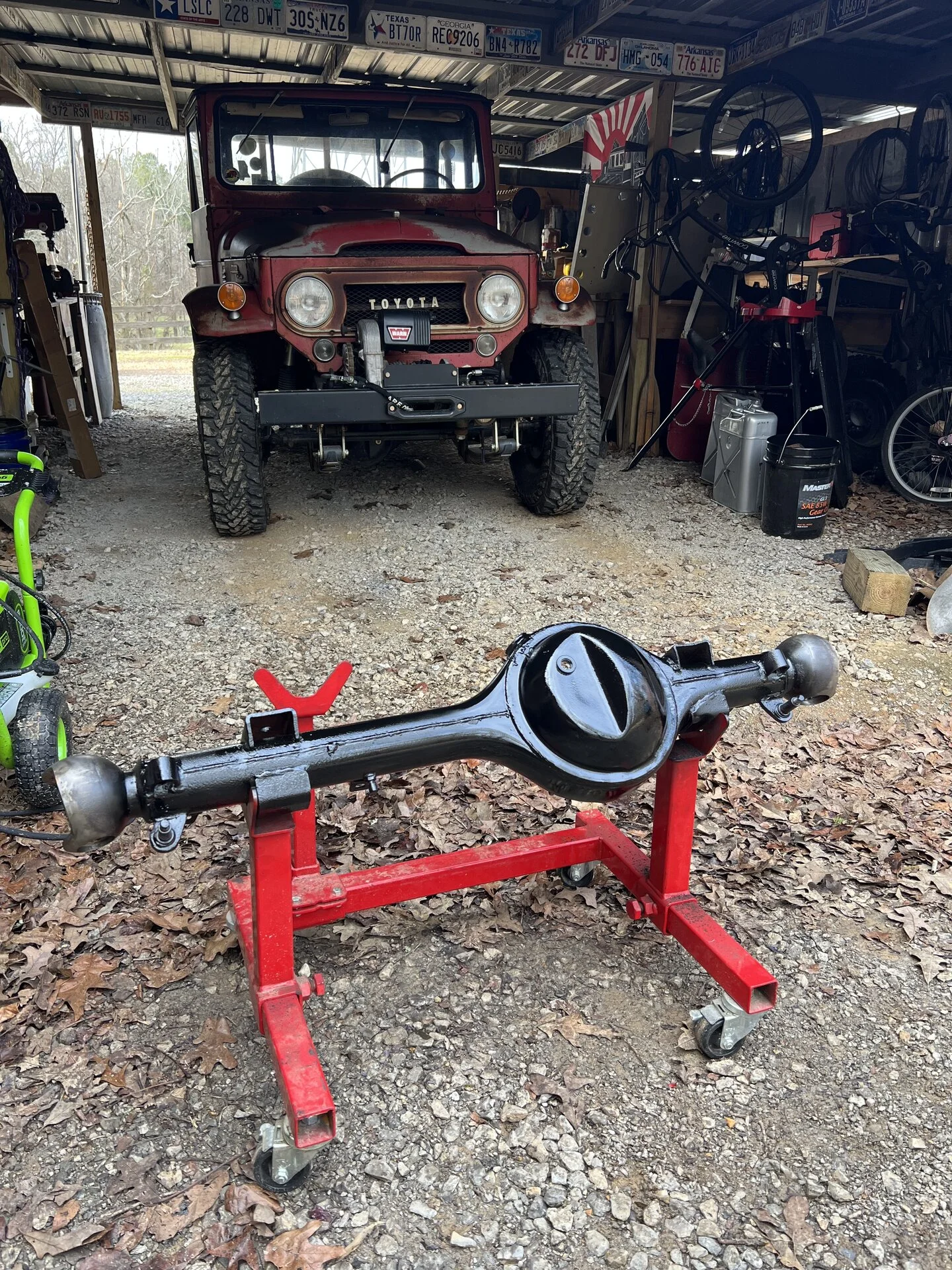

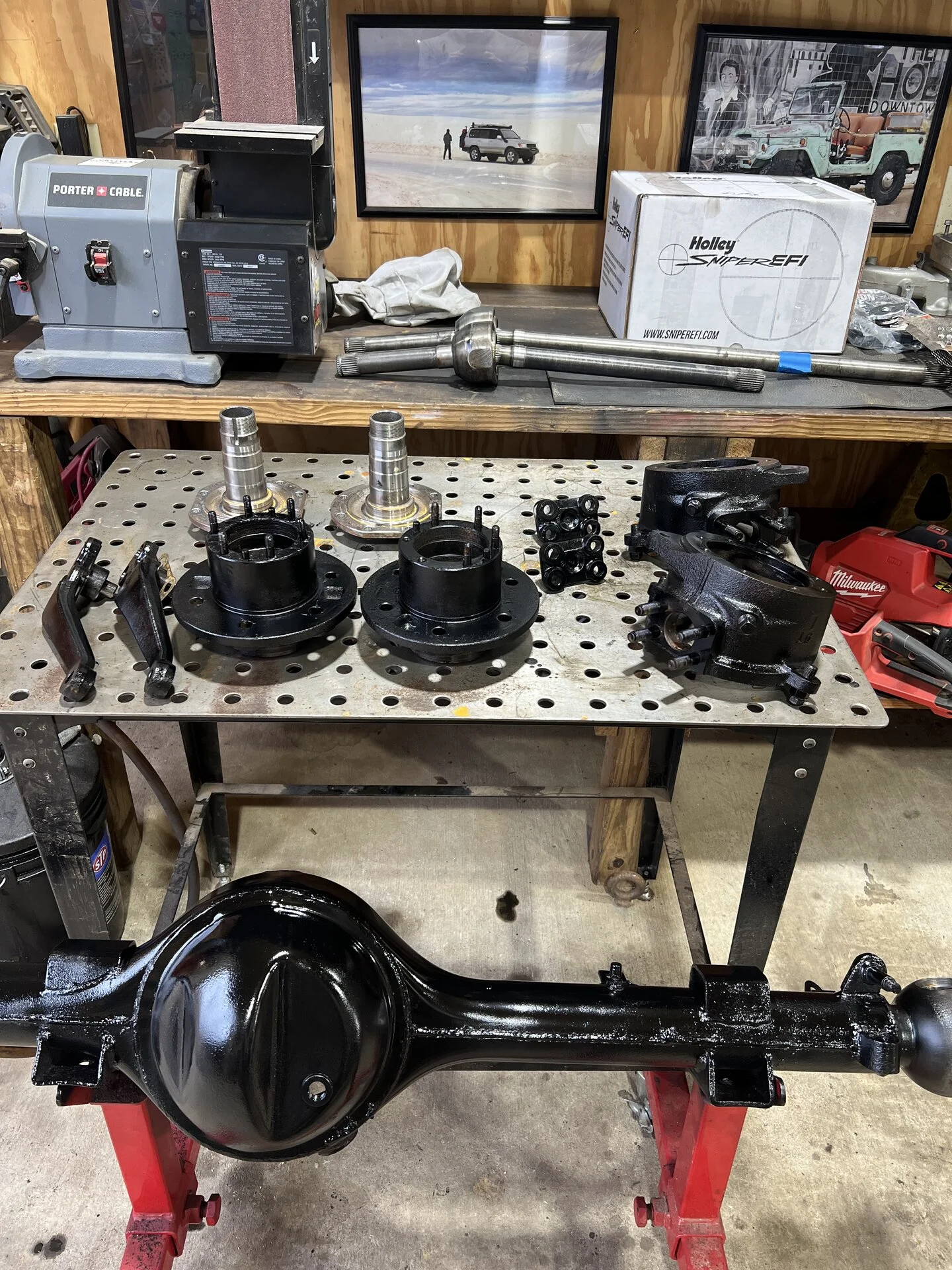

I have the axle ready for assembly. I did not have any 3.70 so Georg is sending them with all the brake stuff and 4 speed stuff.
Yesterday I picked up the Dobinsons……
It’s all coming together

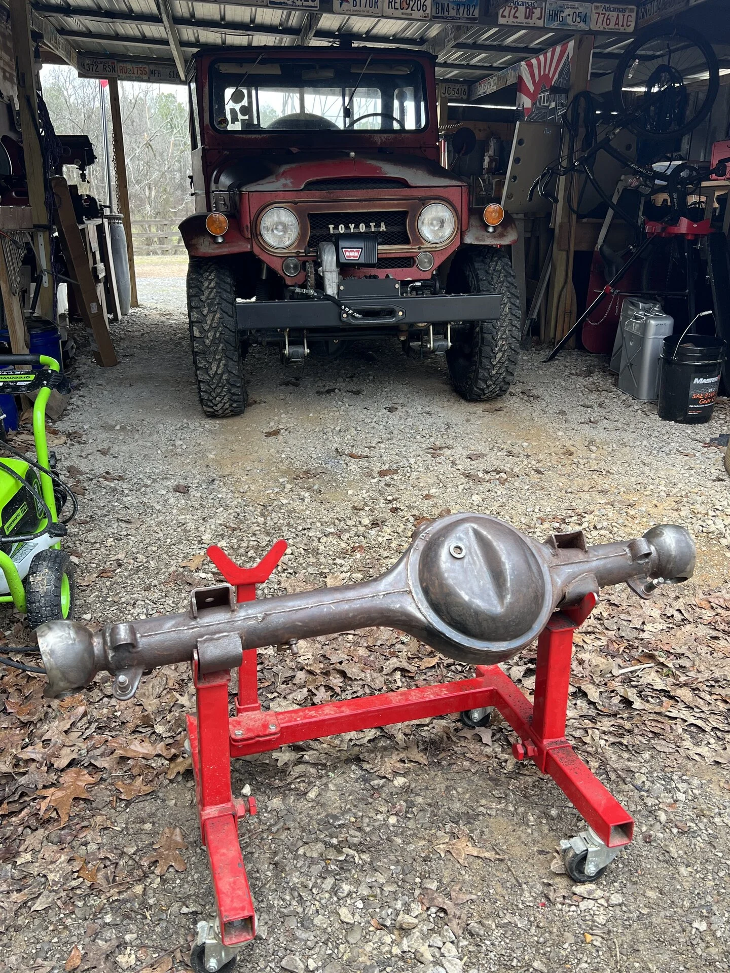

Do you know what year that axle housing is from?
Not sure. Why? It just needs to be 68 and up. To add the larger birfields from a 60 series you just have to grind a bit.
