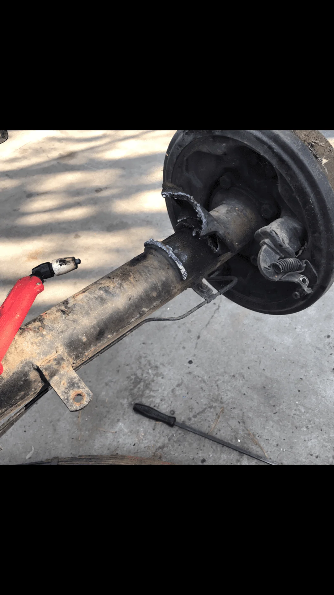

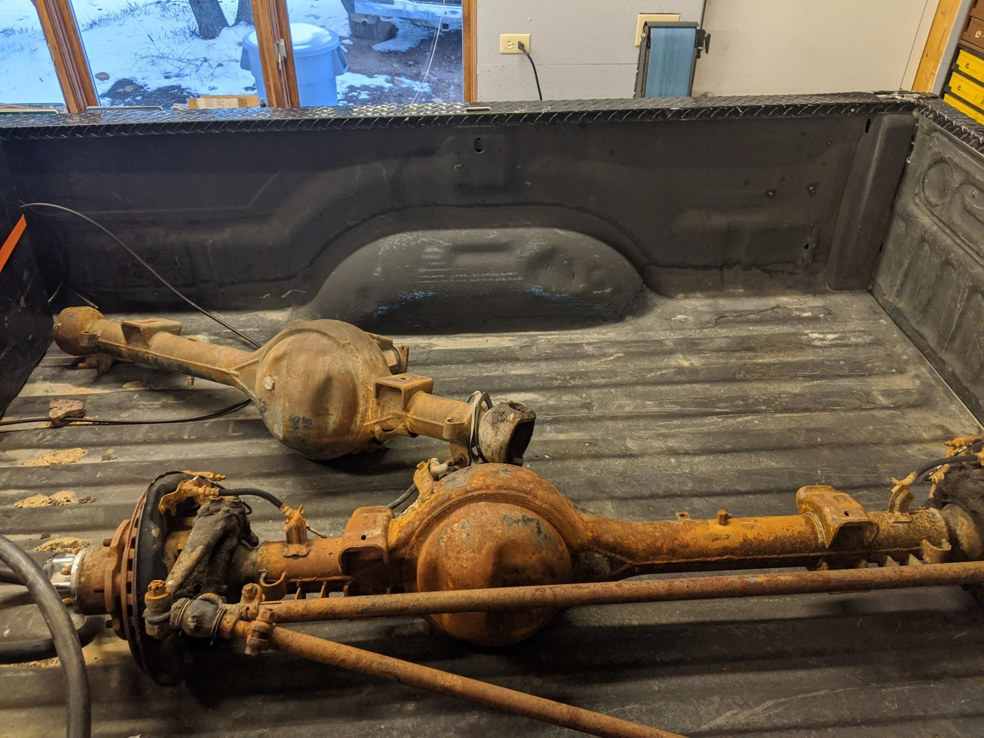

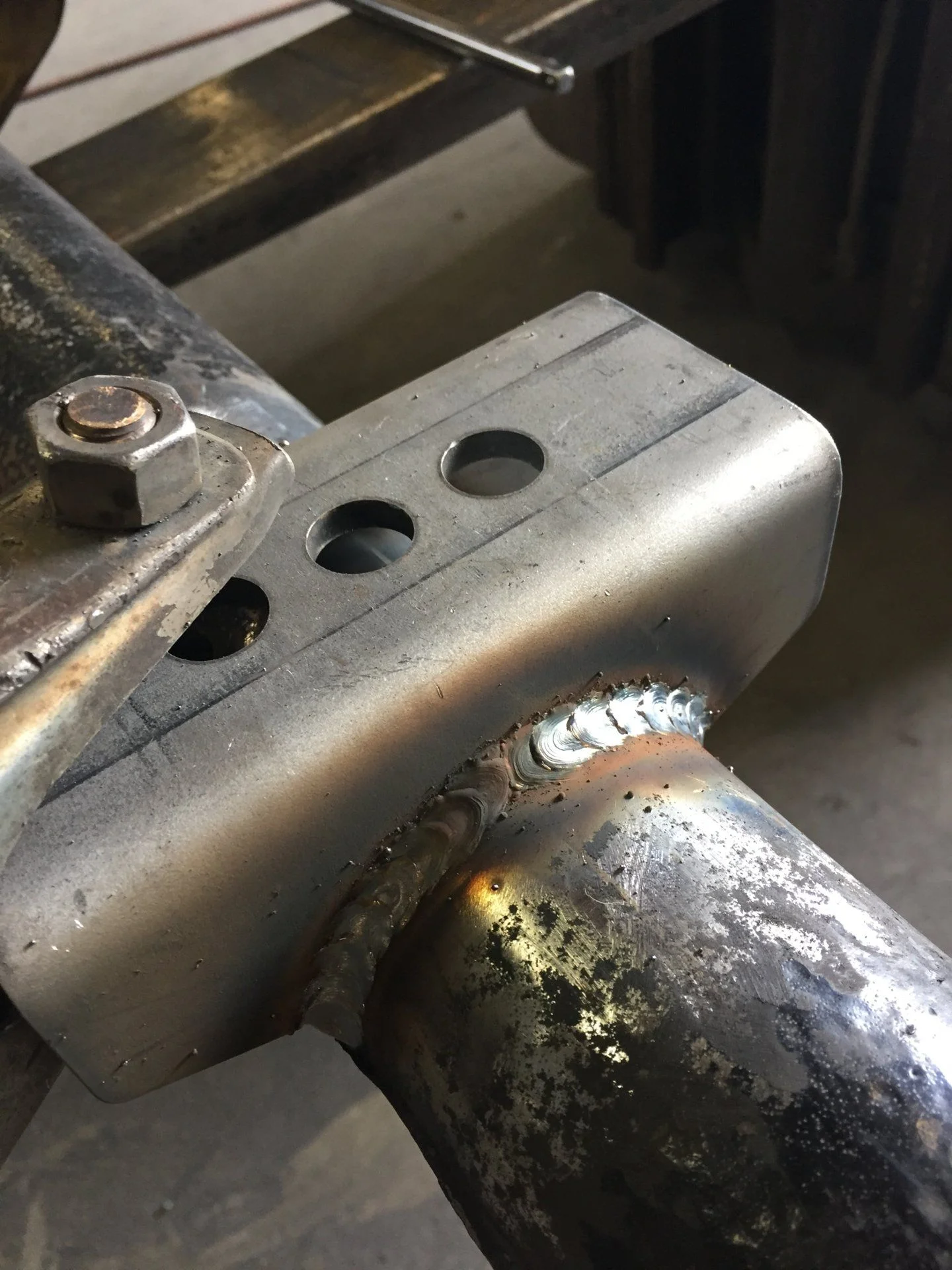

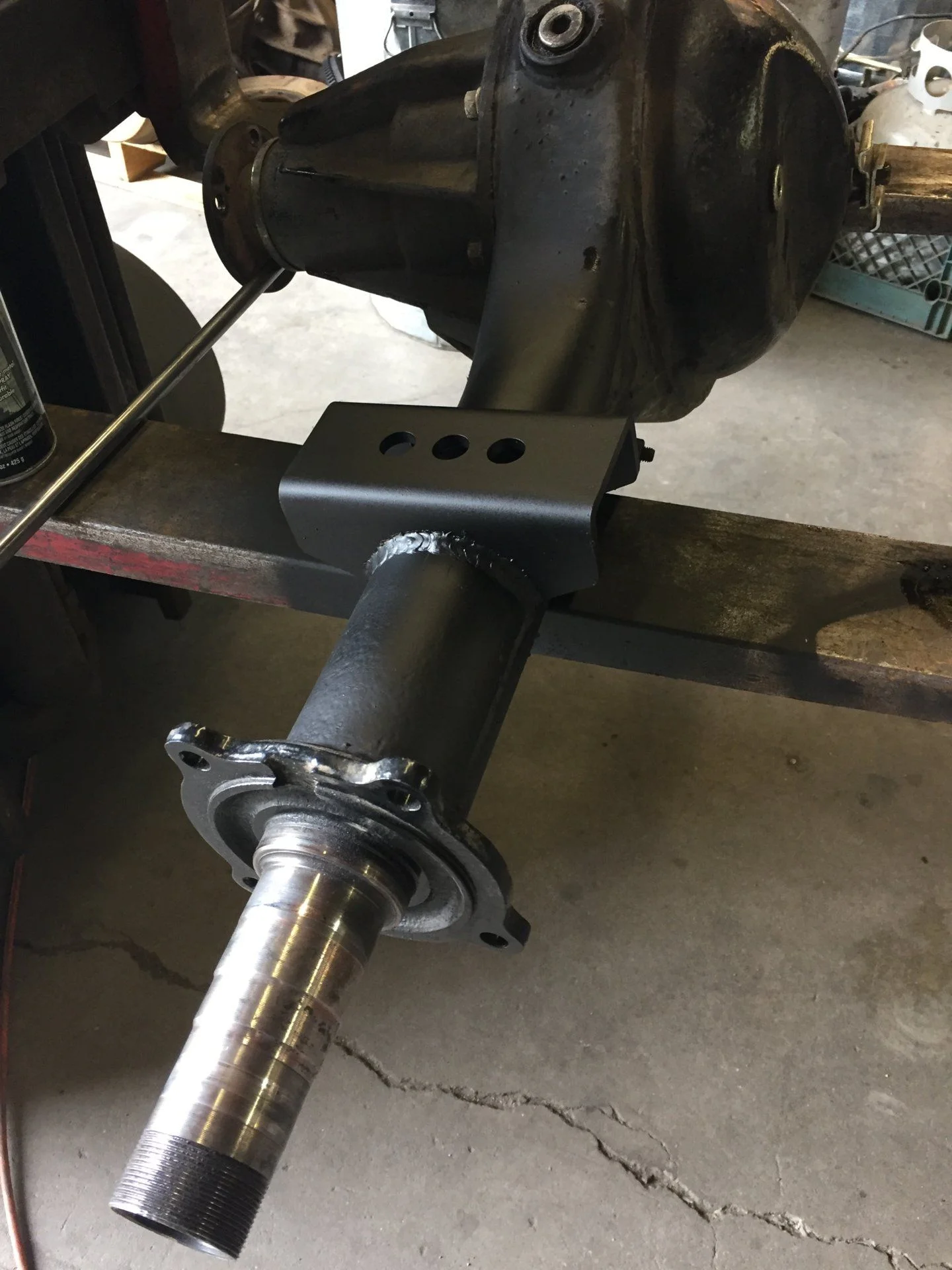

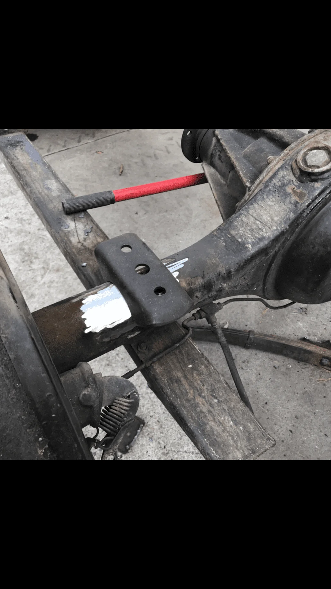

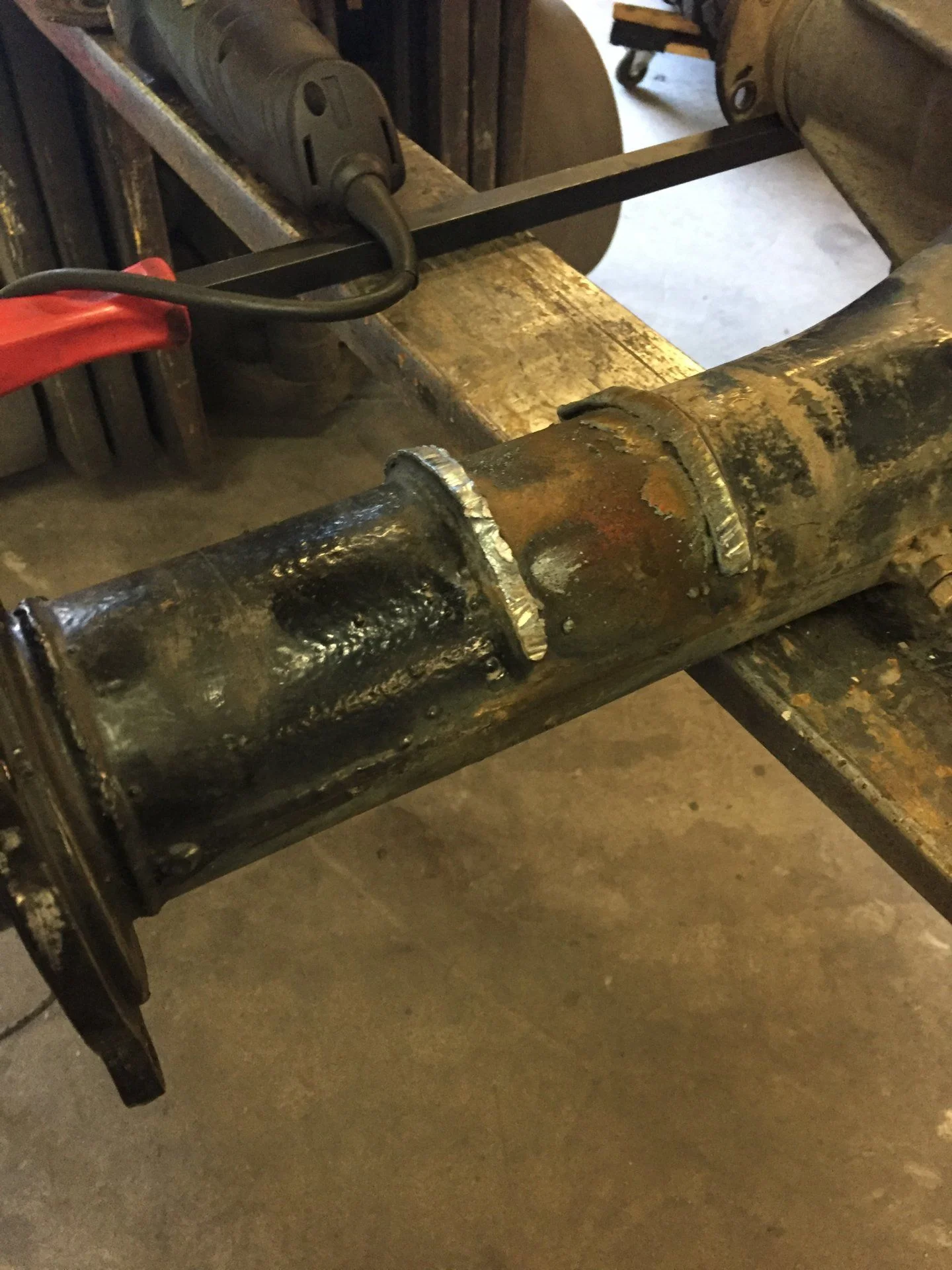

Perches need to be moved about 3/4 of an inch.
Correct. I had to do this on mine when going from SF to FF. Cut perches off. I used some pre-fab perches from RuffStuff Specialties.
Dominic burned them on for me when I was visiting Georg at VH. Gotta obviously measure for pinion angle too. That way no shims needed.

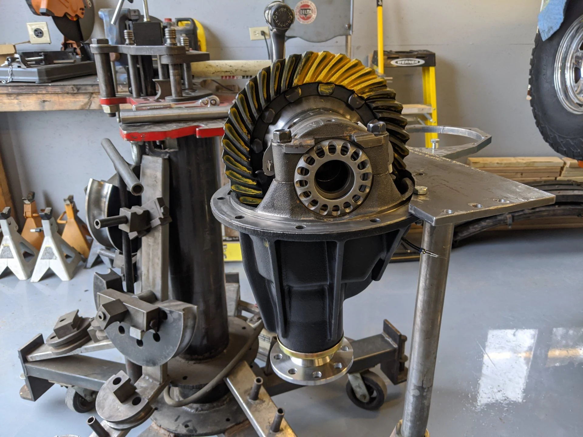

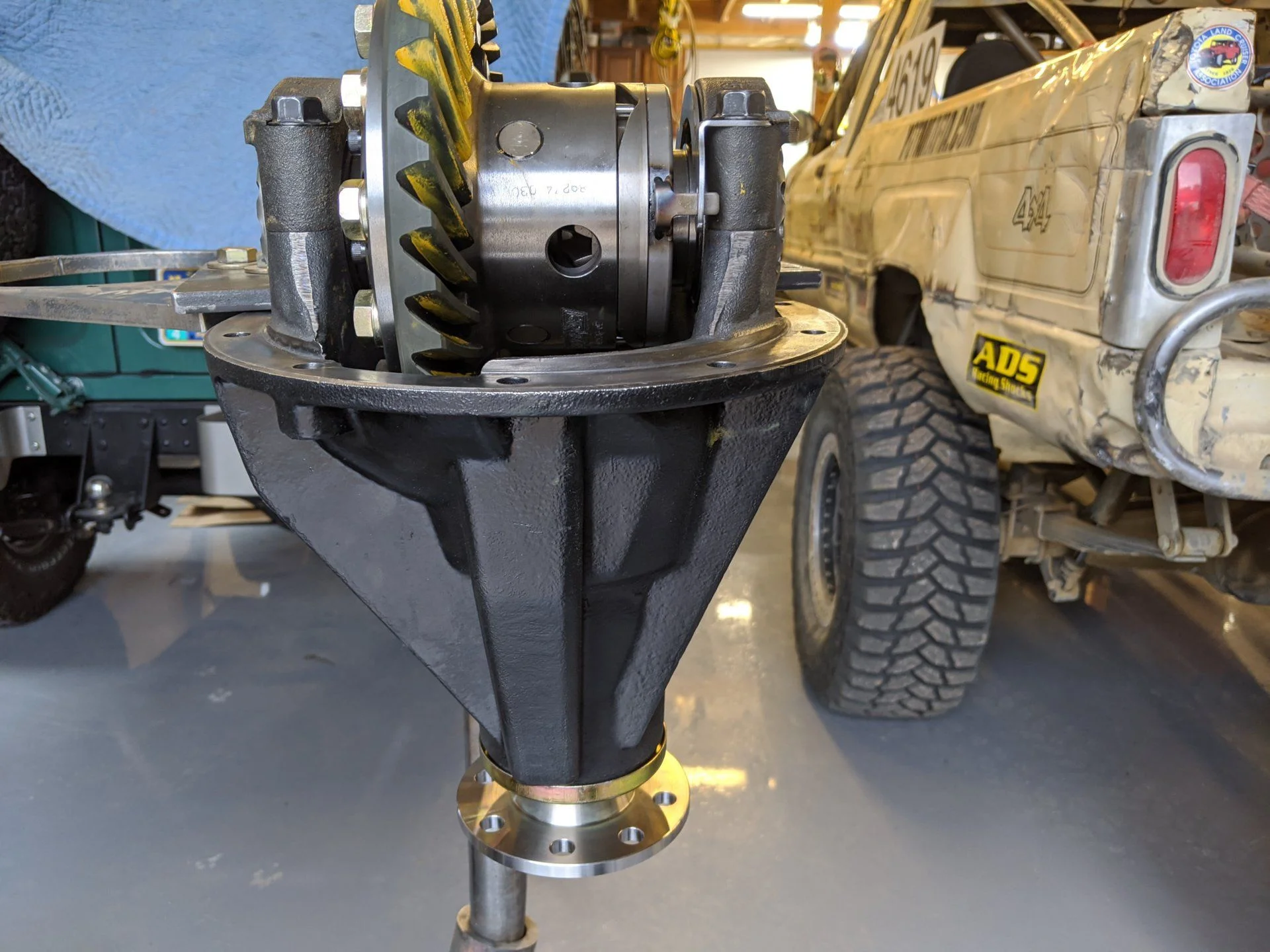

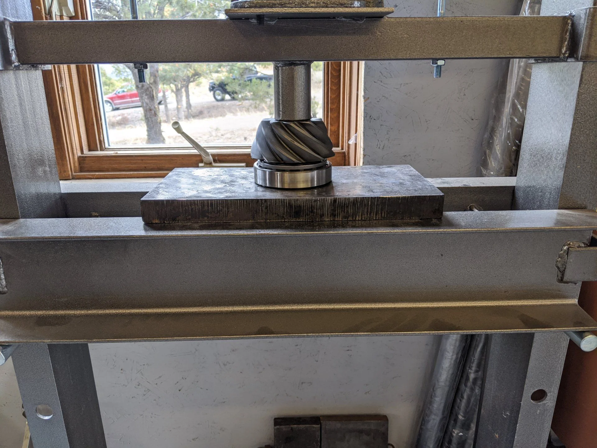

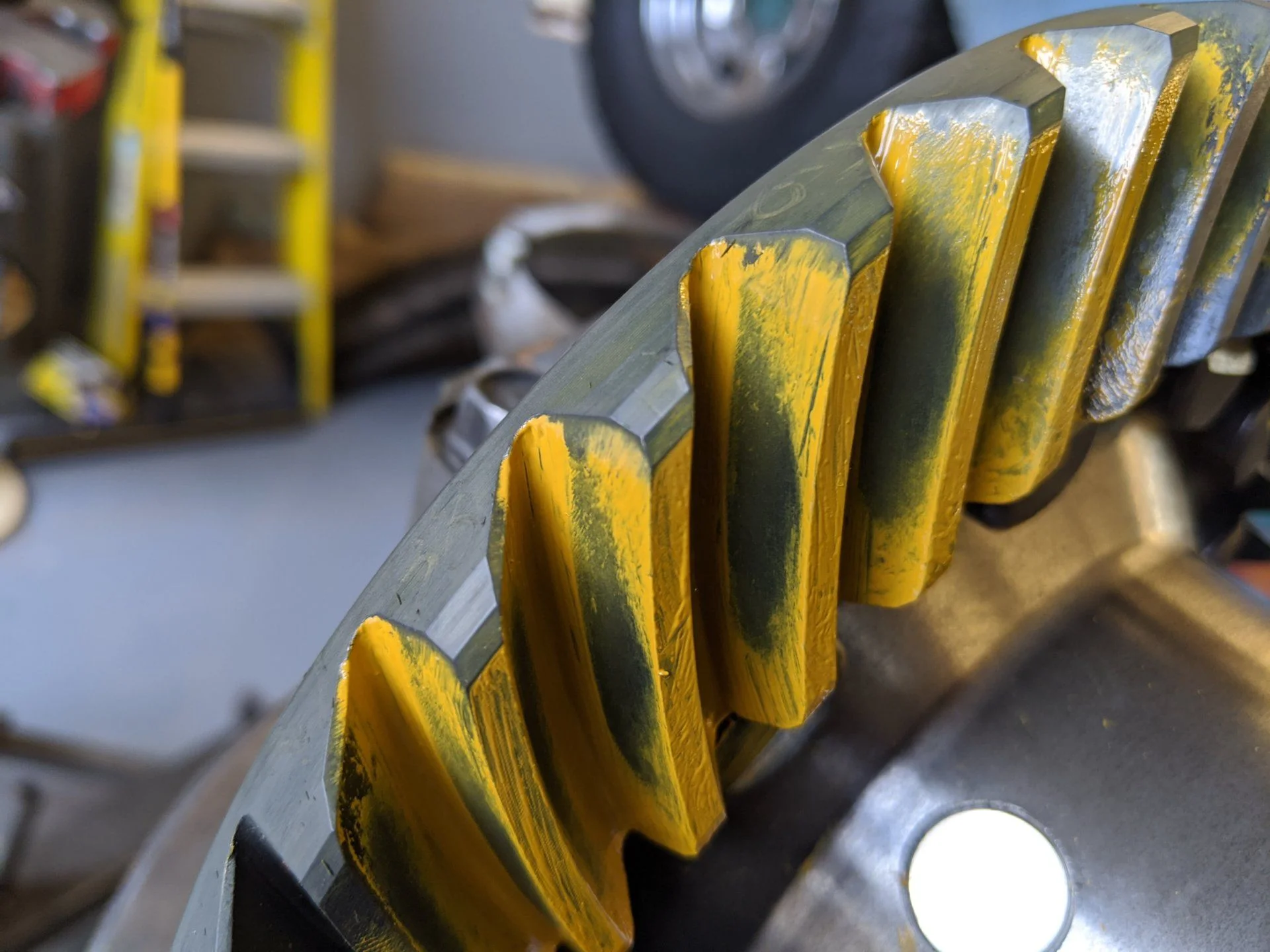

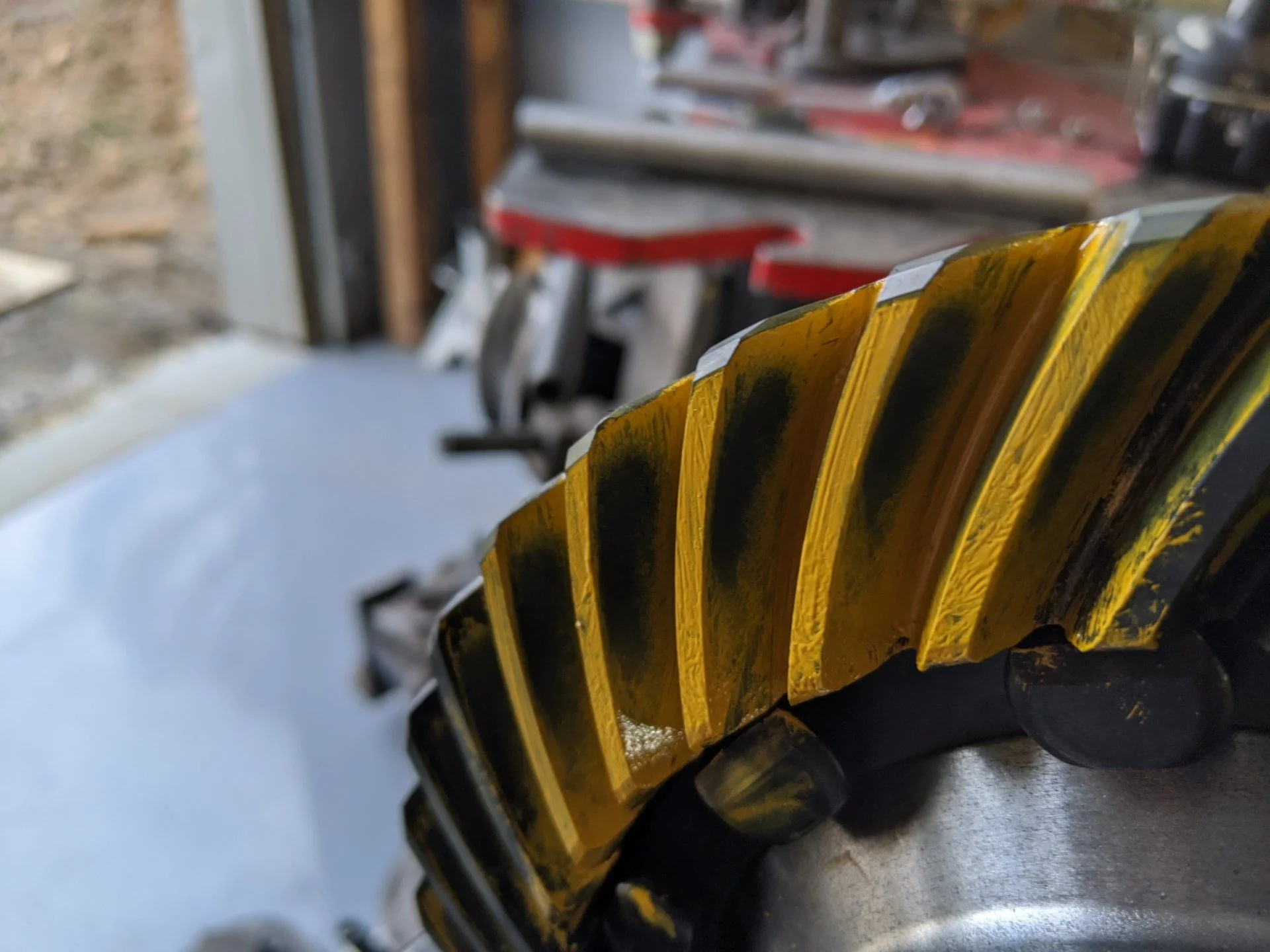

Got the first 3rd done this morning. Took me 3 tries to get the pattern correct. I can usually take an educated guess and get in 1 or 2 tries. None the less it set up very well.
-3.70 gear set
-Harrop
-multi pattern flange

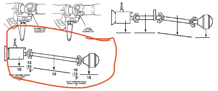

Yeah, that is correct with non-CV driveshafts.
With a CV at the Tcase you point the rear pinion at the tcase.
With a non-CV you want the joints to be within 3* of each other. Horizontal on both if possible.
I’m on a conf call and double tasking but this is what is correct.

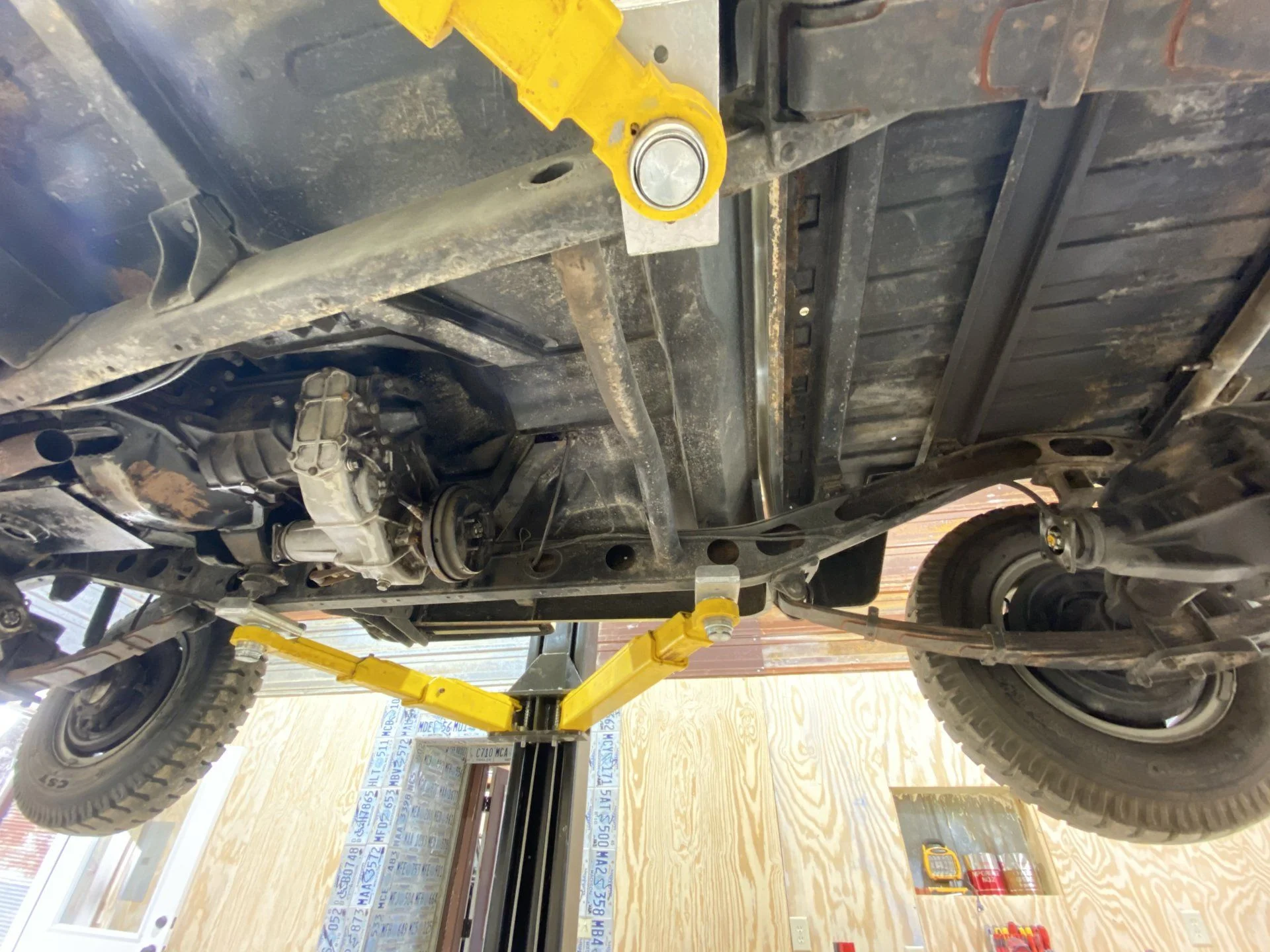

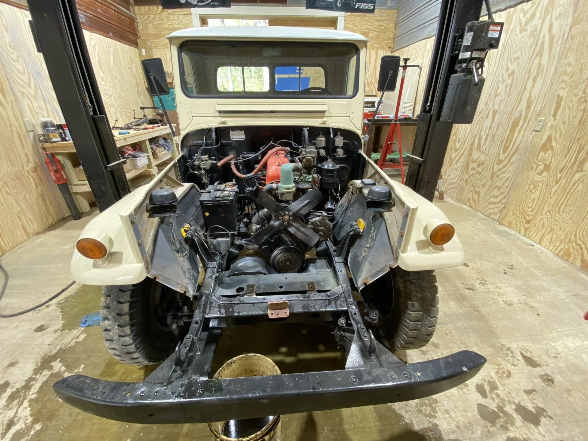

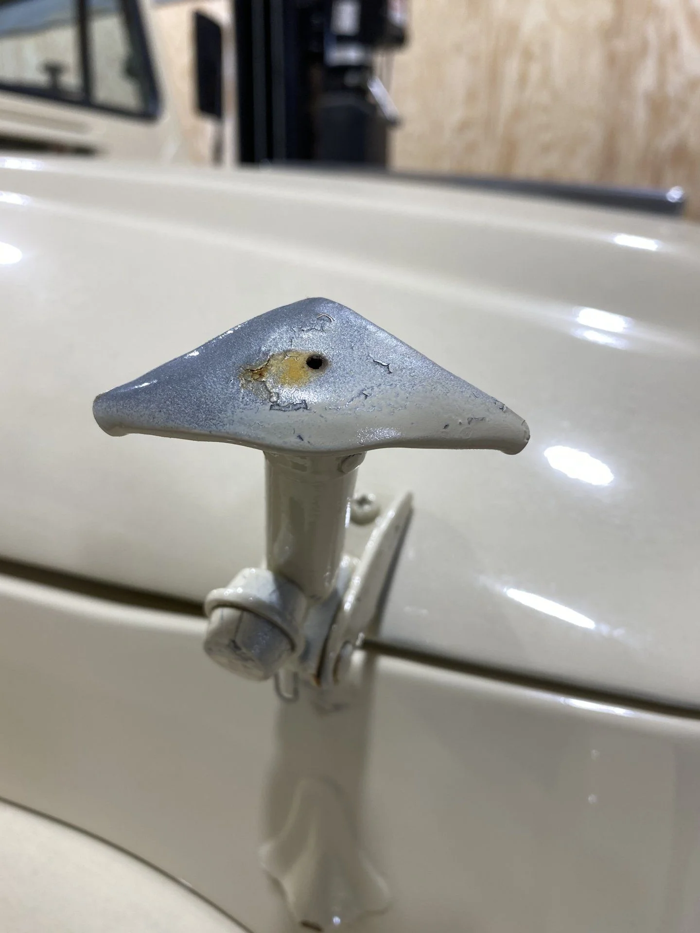

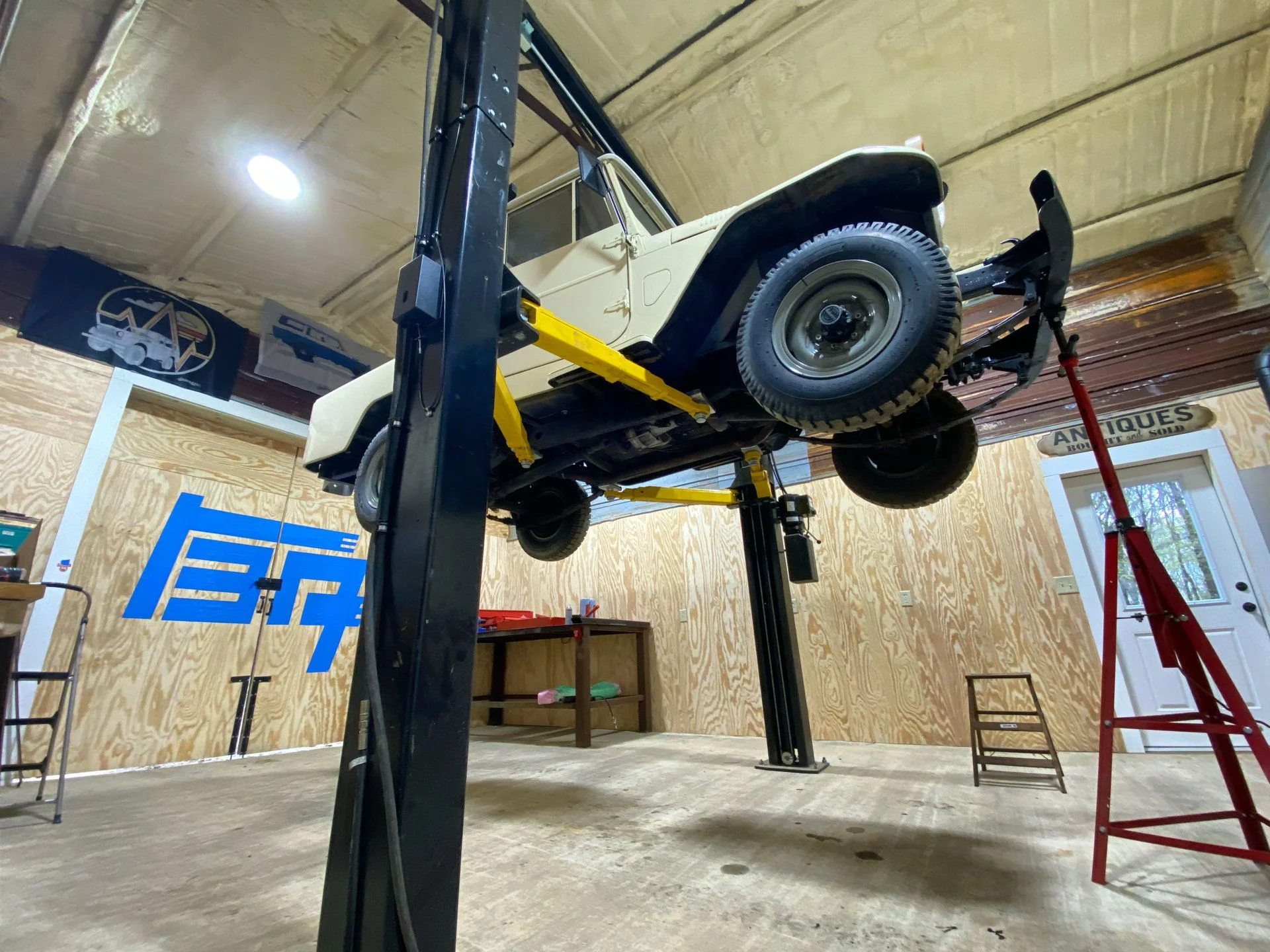

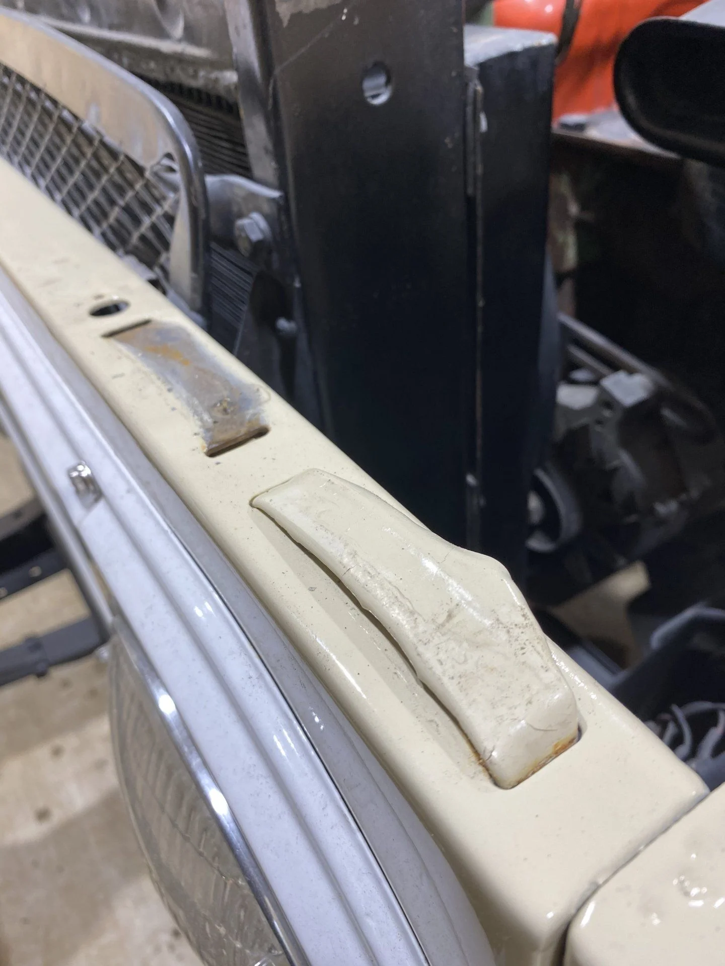

Good progress on Rotunda. This guy looks good under the bed. There is a bit of rust I’ll be addressing.
Everything is pulled. The Tcase fluid was silver. Looks like it was possibly rebuilt so that may just be the mesh mess. I never drove it fast enough to hear any noise.

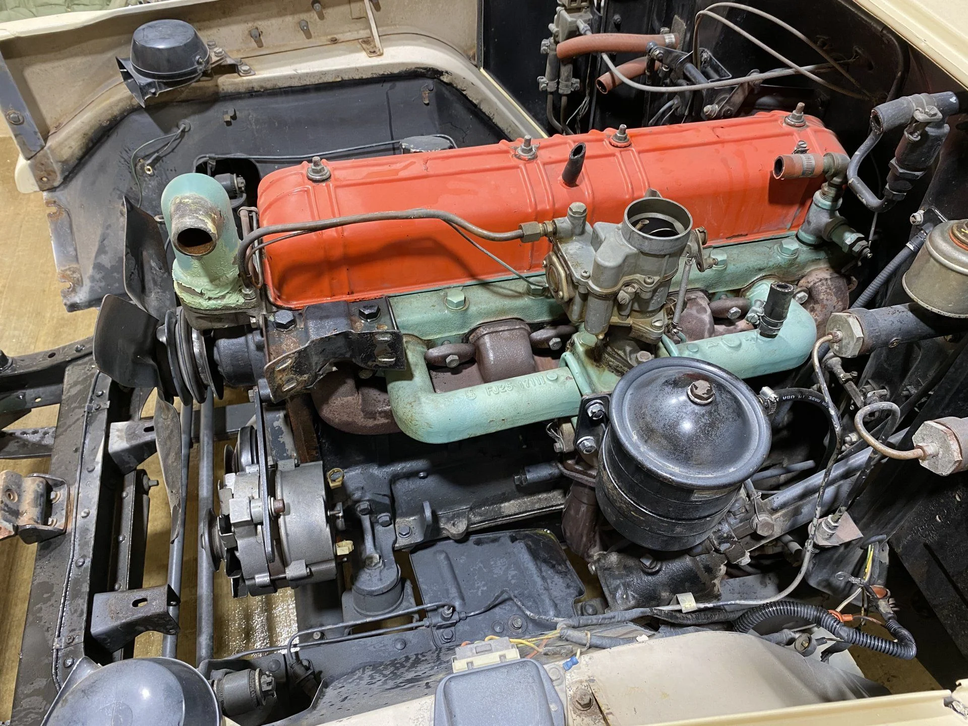

Open up. Say Ahhhhhhh....
Tomorrow this old fella comes out

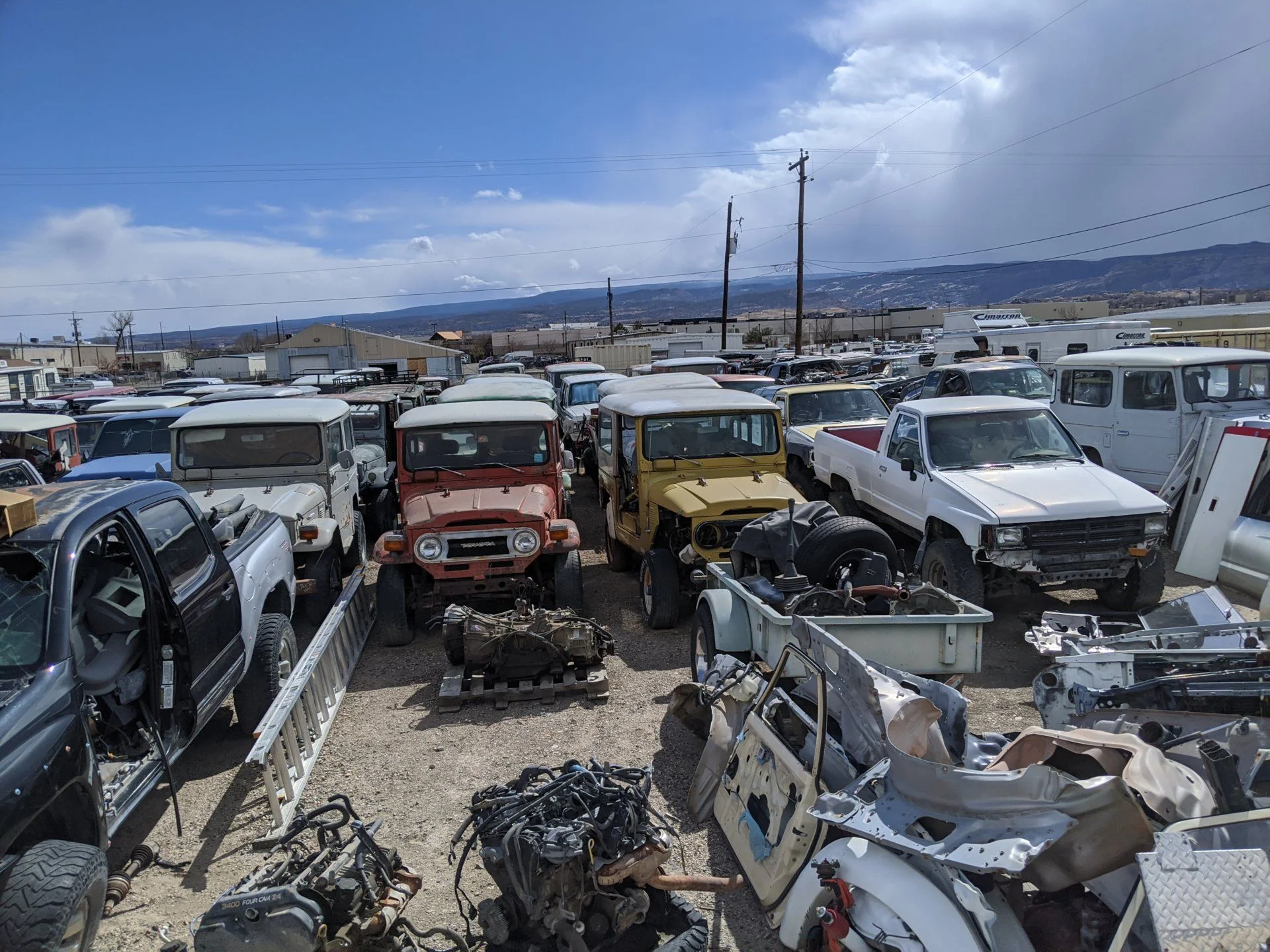

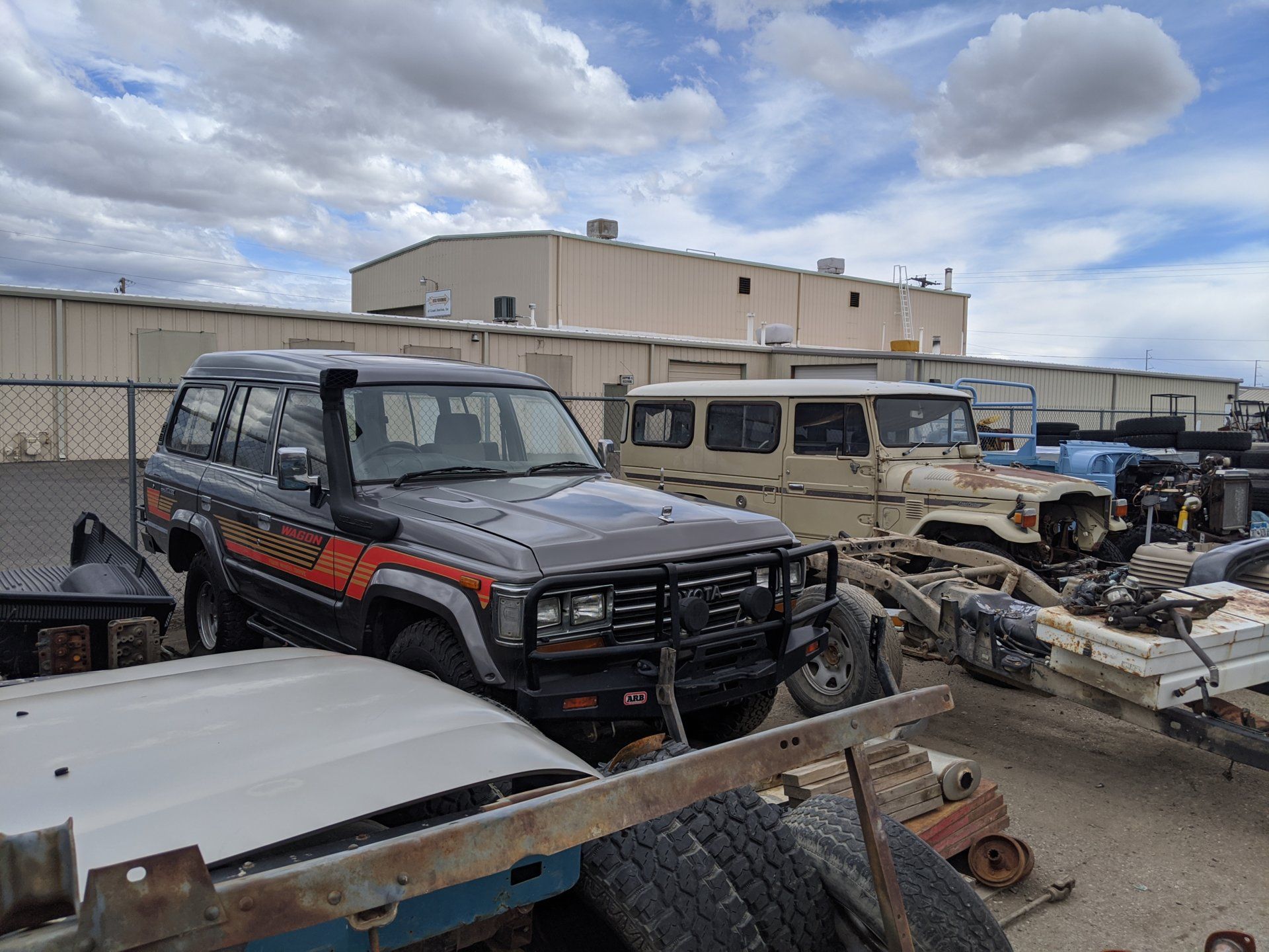

I was able to get some parts out of the Lions den last night. Donor housing from a 77 FJ40 and an FJ60 front for the knuckles and such. If you have never been to Metric in Grand Junction Co. Go walk around and scrape your jaw off the floor. I have been good friends with the owner since 2nd grade. Mike is a dam good dude, getting parts out of him is tough. But he understands what he has. If you want stuff done to your Cruiser they do too notch work.
View attachment 2243604View attachment 2243606View attachment 2243608
Truly unreal.
Is that the original motor? What’s the build number?
Haven’t heard from Mr Goodnight in many years. I bet my 65 short wheelbase removable top is out in that yard somewhere! 3b turbo, h55,4w disc brakes! Think I sold it 10 years ago. Glad to see the yard full, real good guy.
