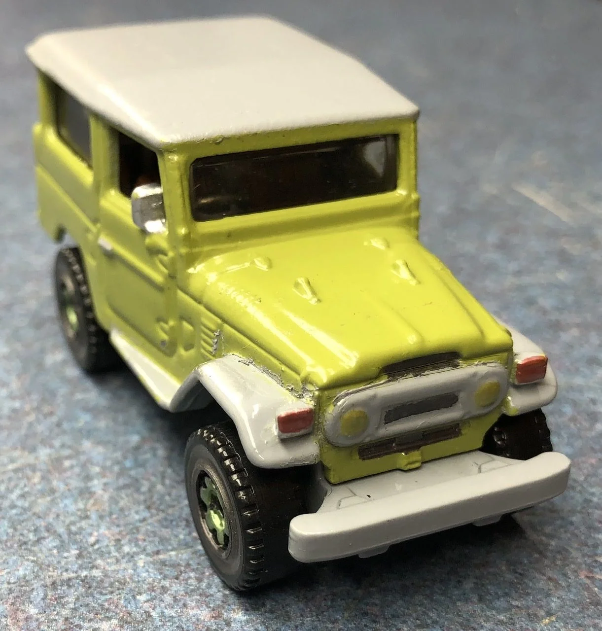

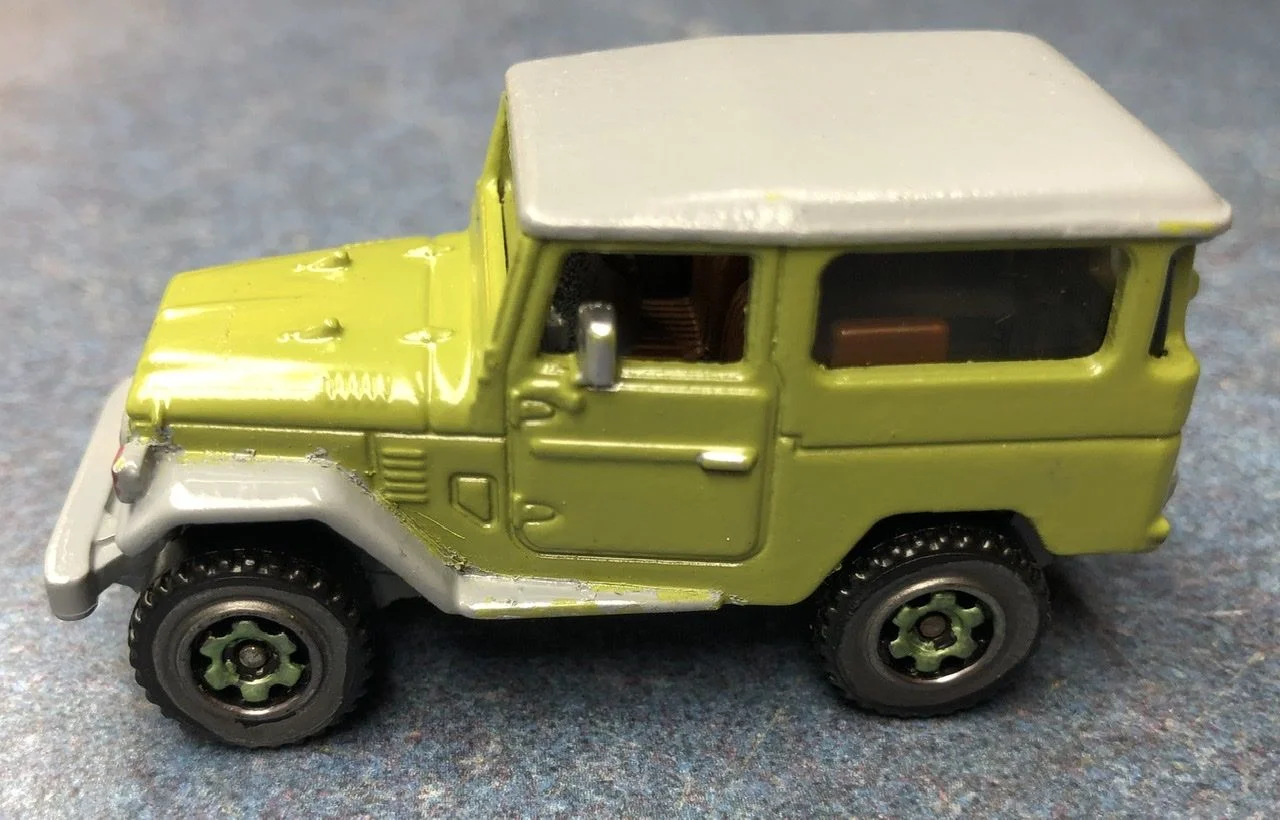

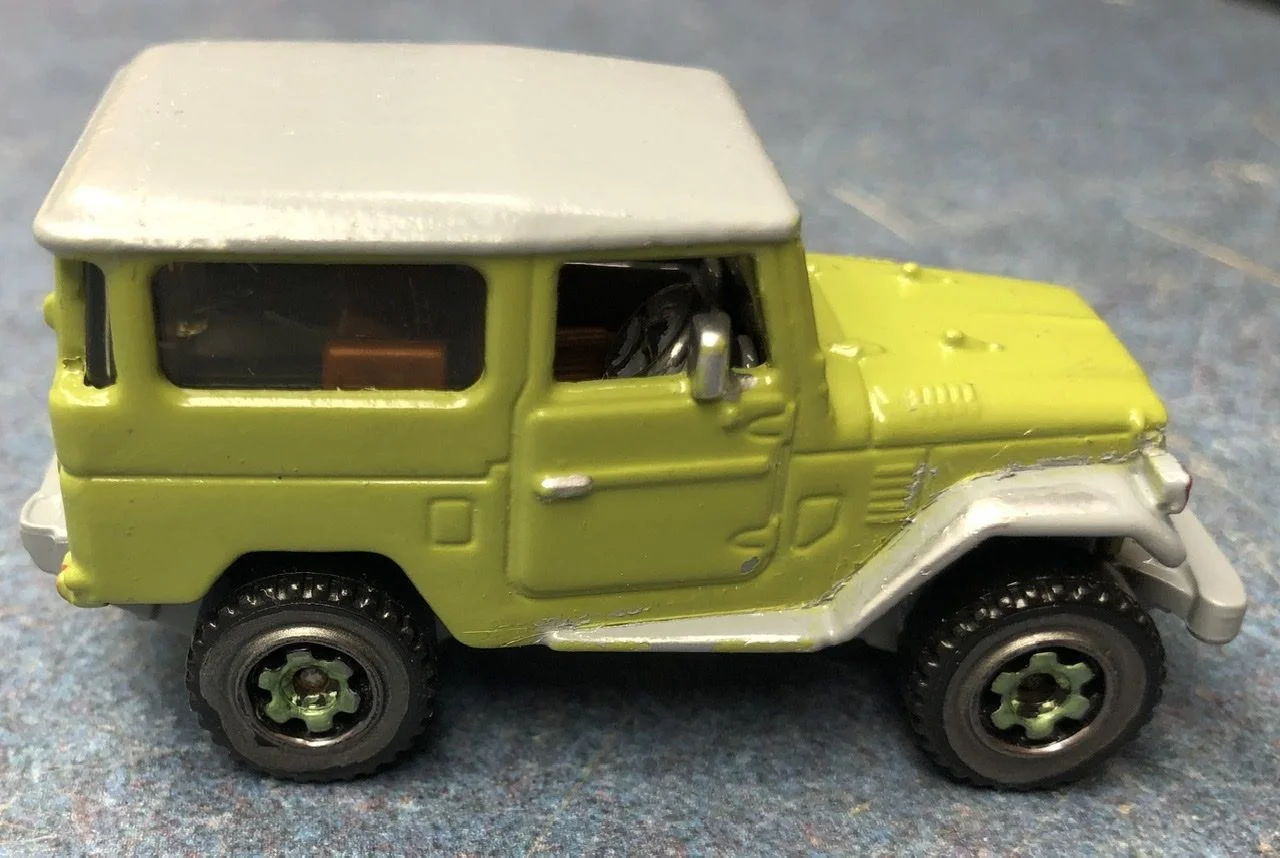

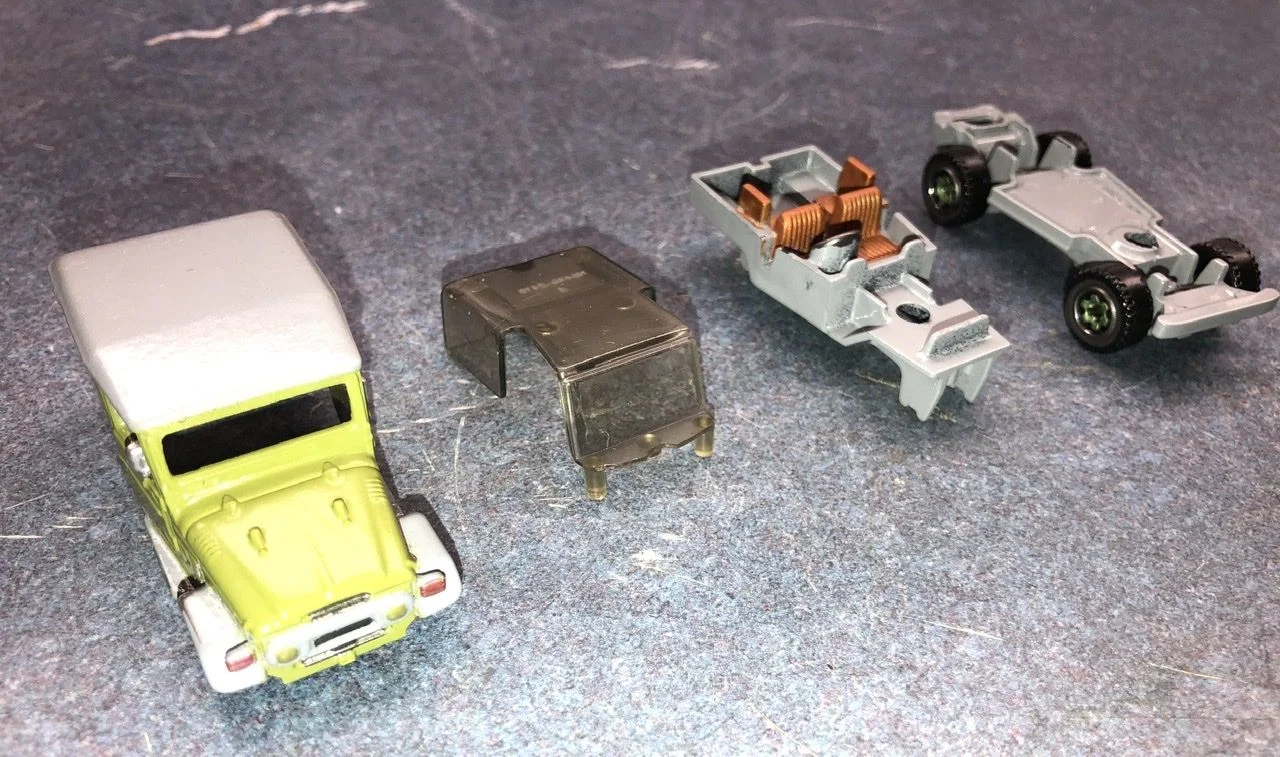

Alright, because of the FJ40 that @thecrazygreek built I had to test this paint scheme for my hard top. I definitely feel like this is v1.0 out of many, but the pewter Gray does not go great with the green in my opinion. So far mustard yellow (or some version of it) is still the favorite. Here is the result of the test case.

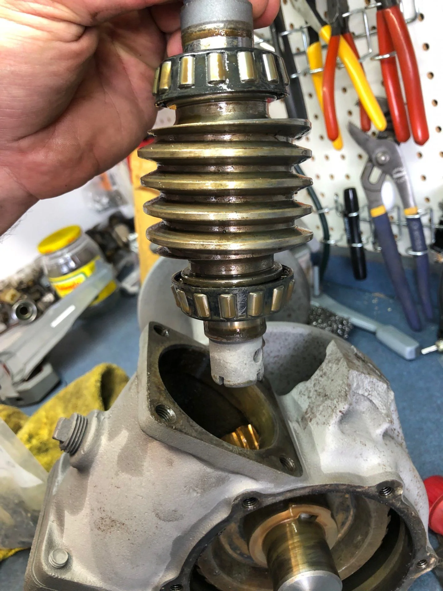

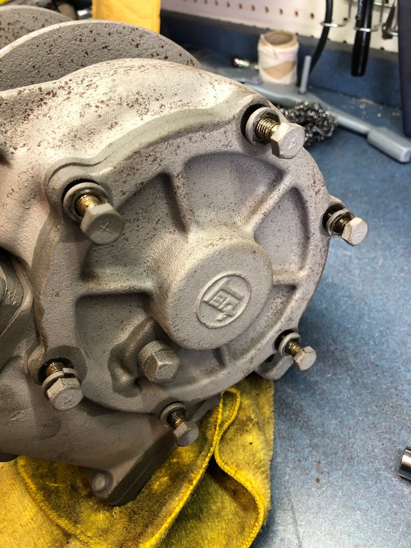

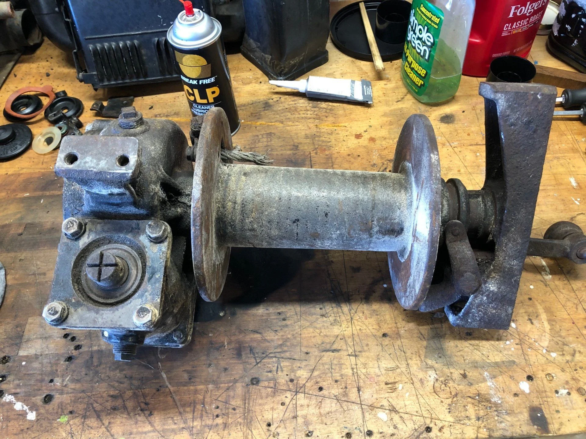

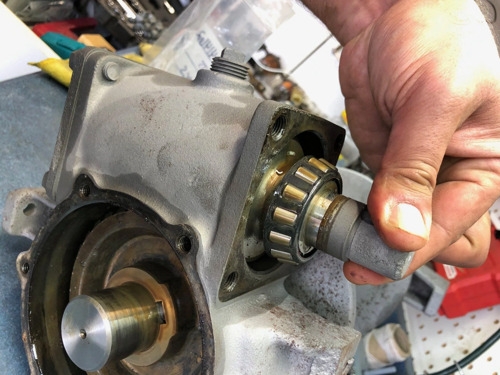

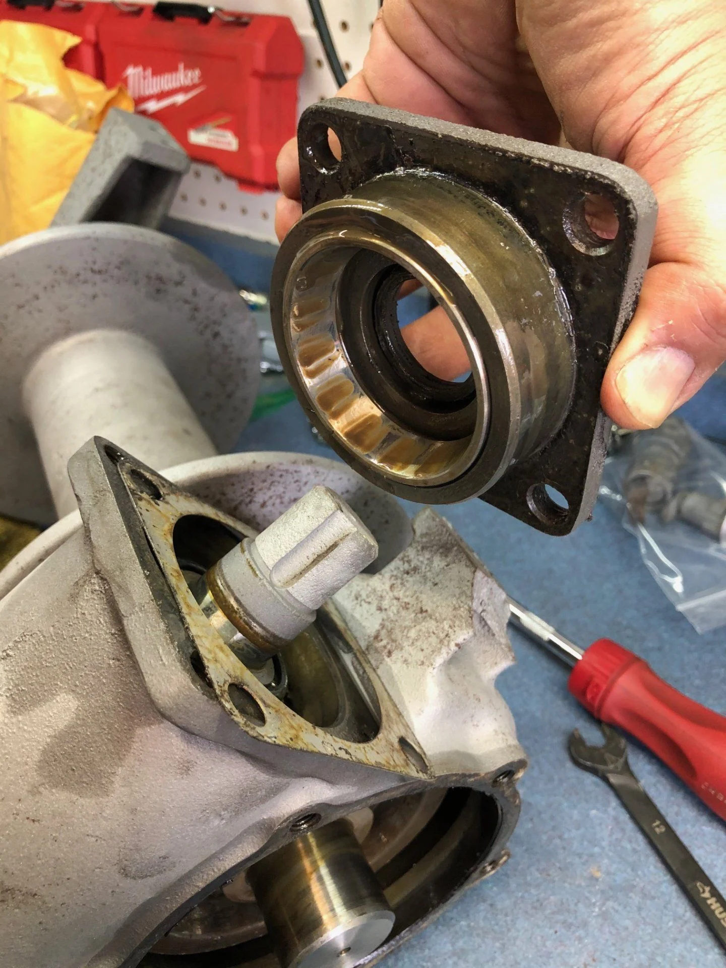

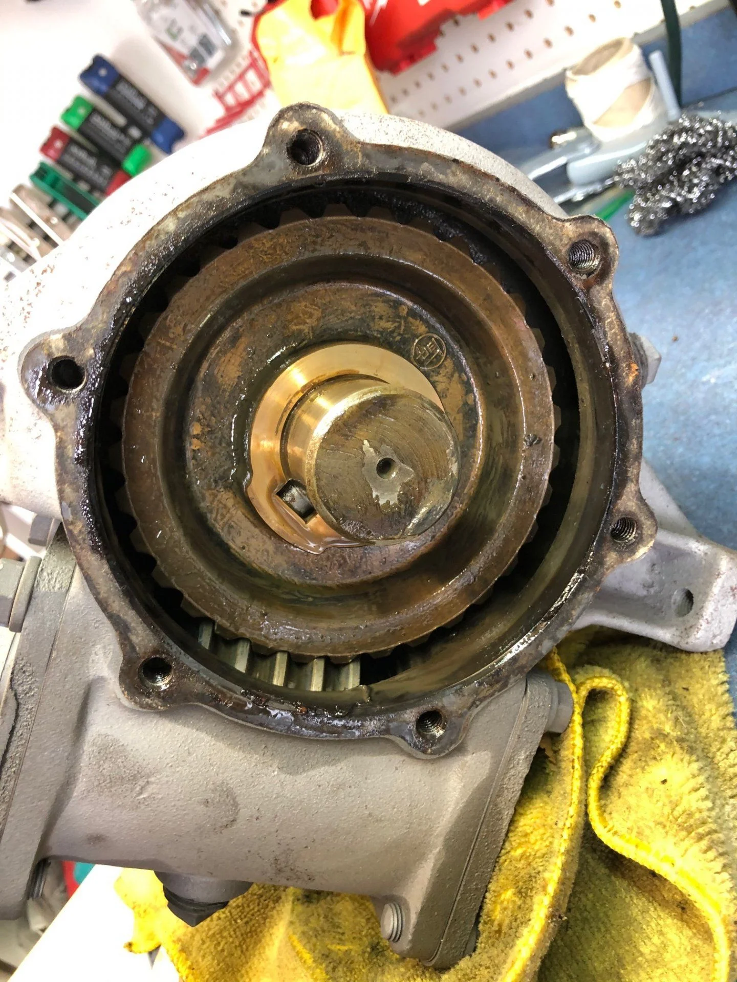

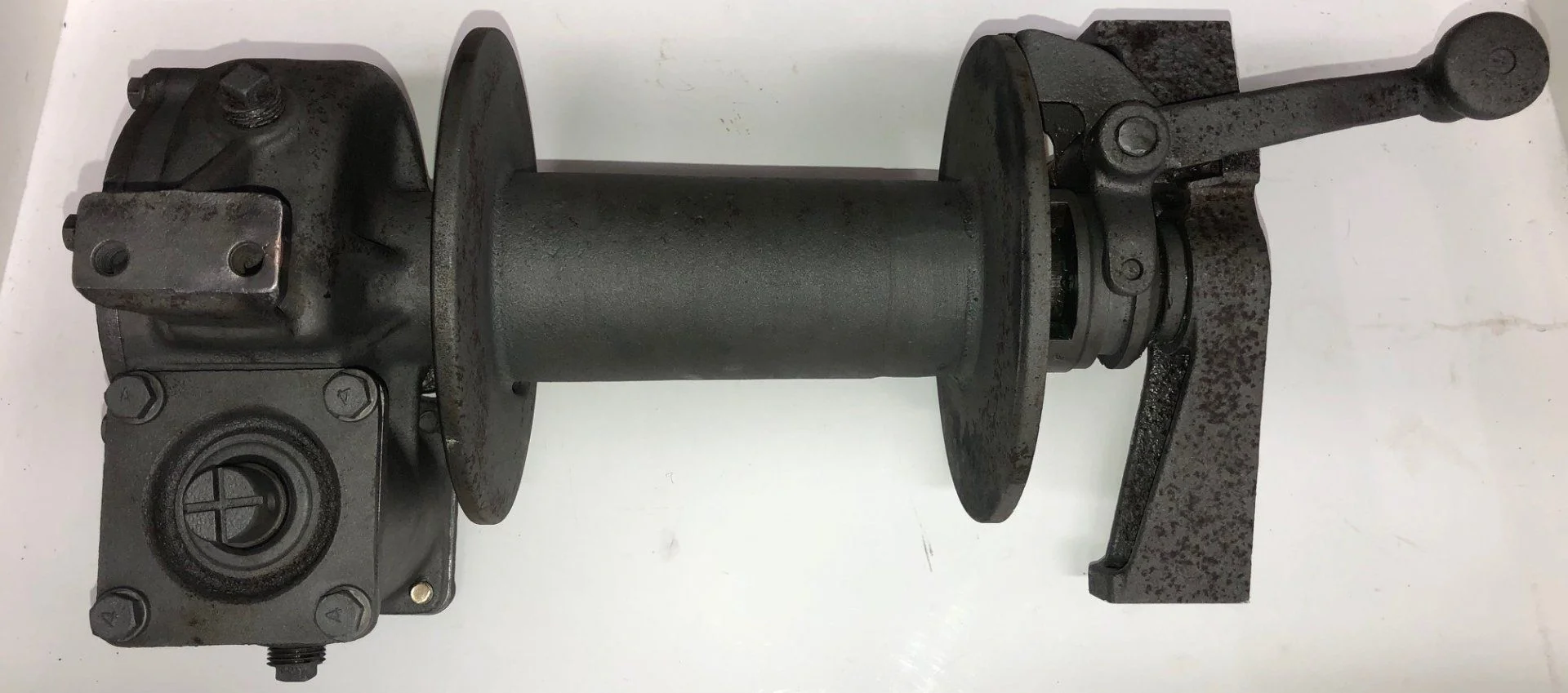

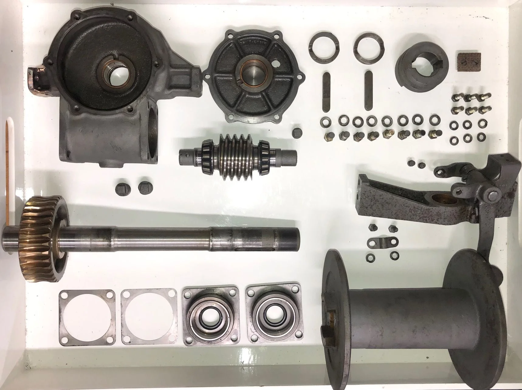

Finally completed the PTO Winch Rebuild. Took forever to find someone who felt comfortable welding the ears back on. Nobody likes welding cast parts. Thanks to @piecemeal for selling it to me. Although this was a learning experience, it looks like I am not going with a PTO setup after all, so this will make somebody @scoobiedubes happy.
Before...
Before...
Gonna look beautiful on the front of the 28! Thanks Brian!

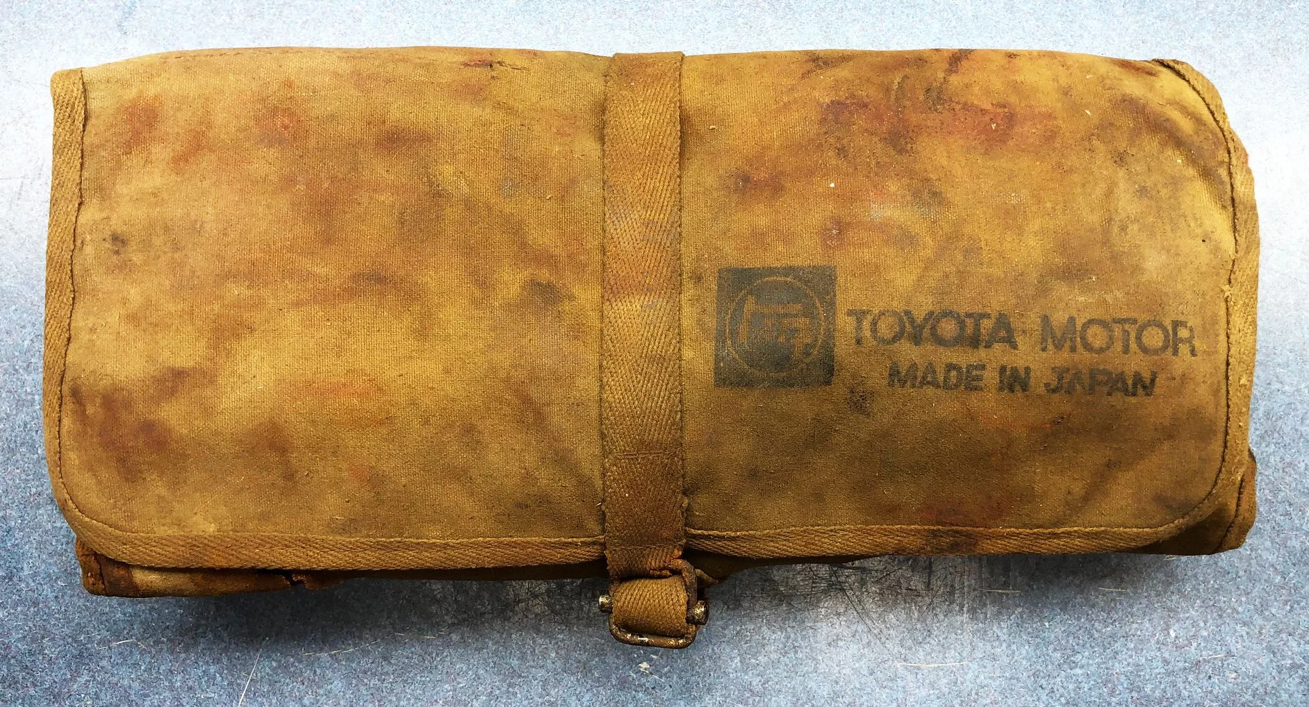

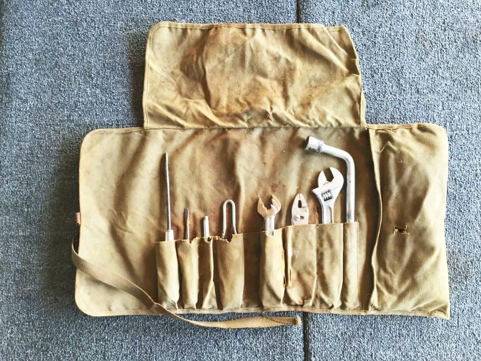

I have always planned on keeping at least one part of this build unrestored, and I am thinking this may be the piece. I have asked @dmamj to chime in on whether or not this set is complete or if any of the parts are incorrect. If he says it is complete, I think I will leave it AS-IS and put it in my FJ40 when it is complete.
