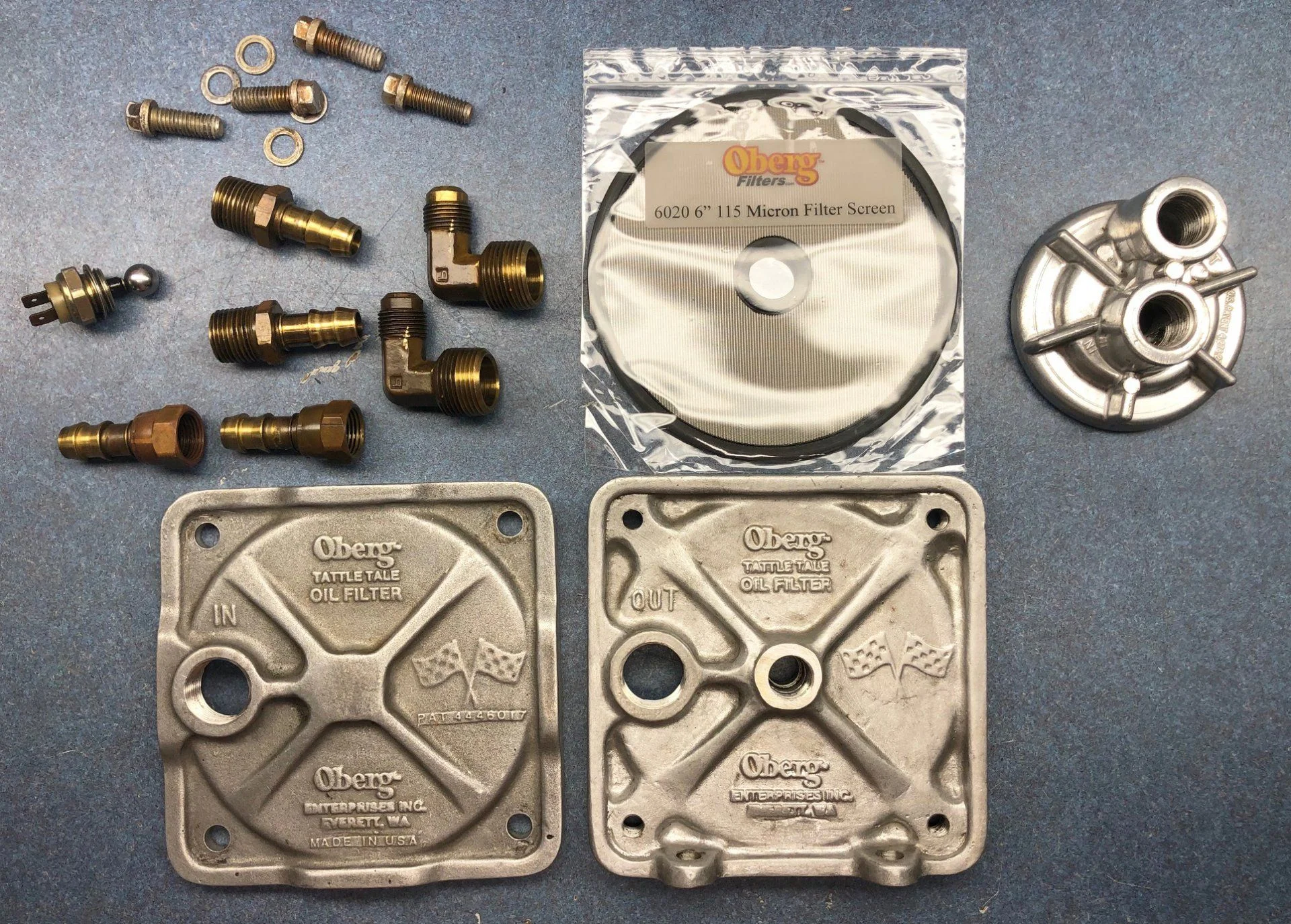

Cleaned up this Oberg Tattle Tale filter. Hoping to find a way to use it in my build. I have seen people use these for Diesel fuel systems as well. Thanks to @65swb45 for selling it to me.
Interesting and cool item. First one I have seen.
Interesting idea......following

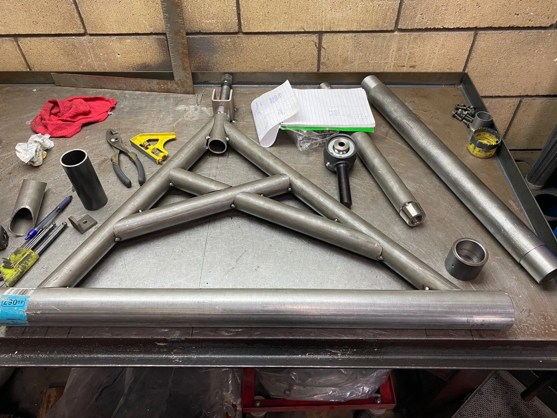

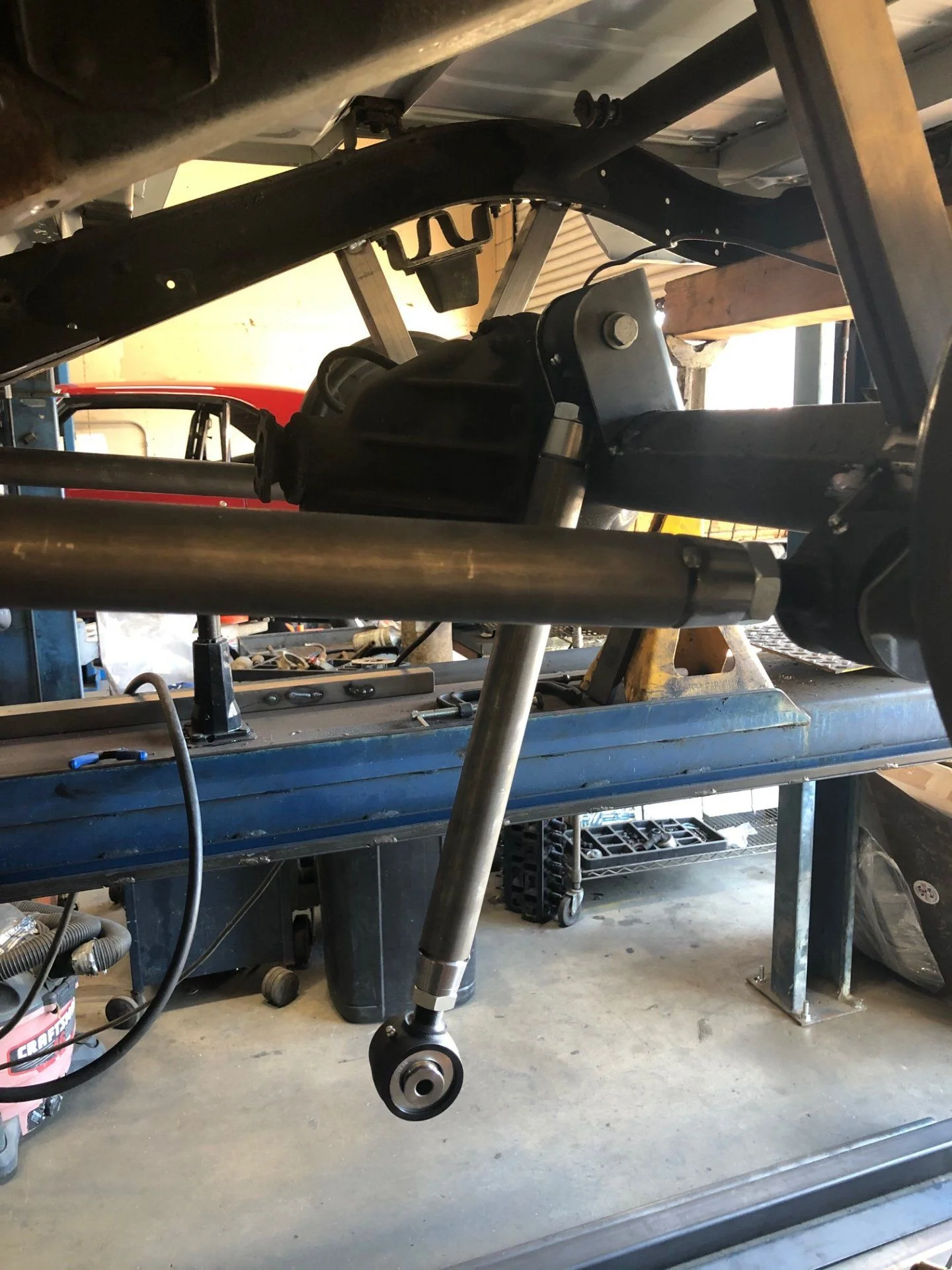

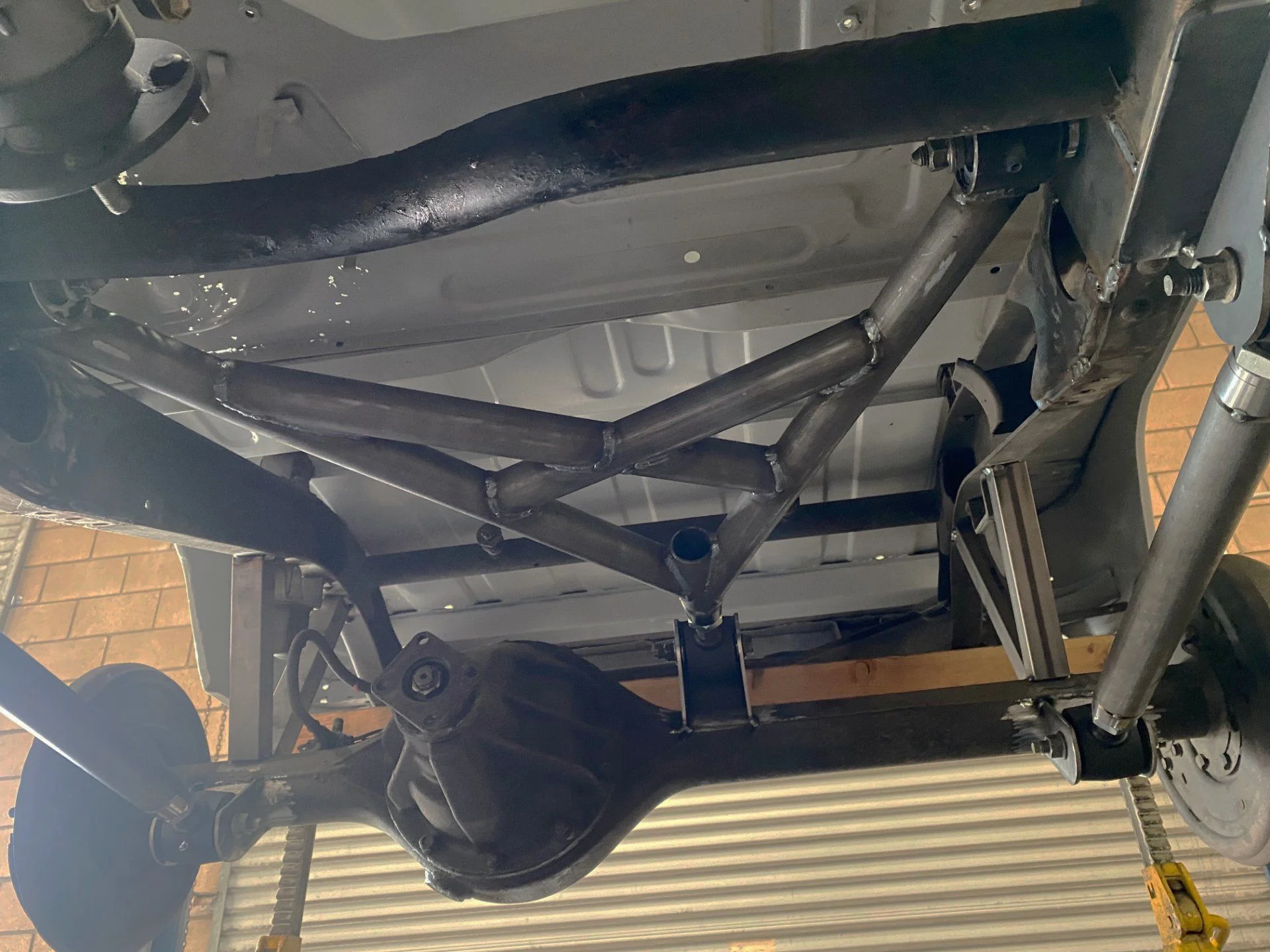

What kind of setup is that? I've never seen it before. I guess you are planning on this being a mostly street-driven vehicle with that link system?
Search 3 link wishbone. It's not as good as some other options for off-road as you noted.

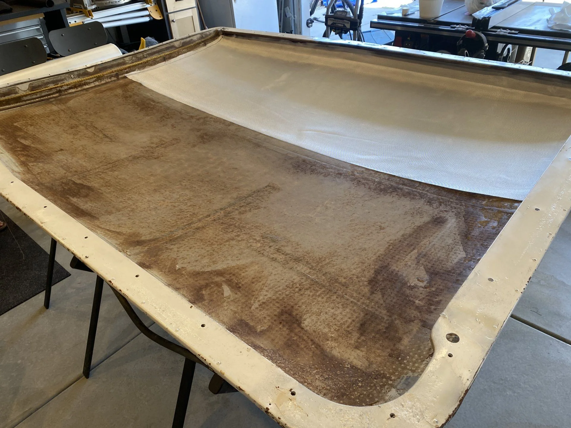

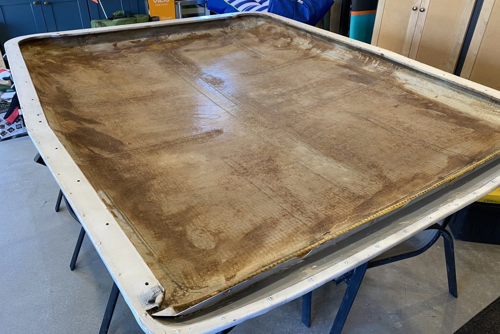

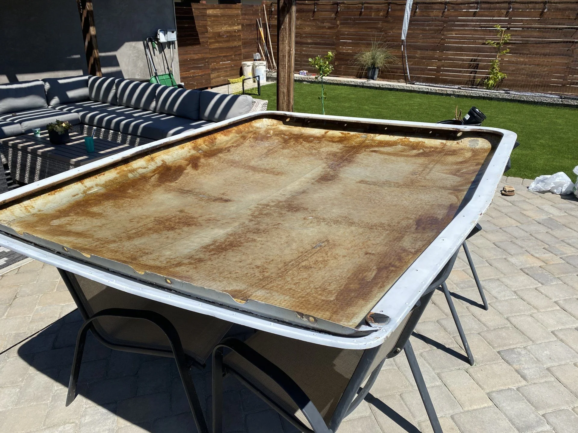

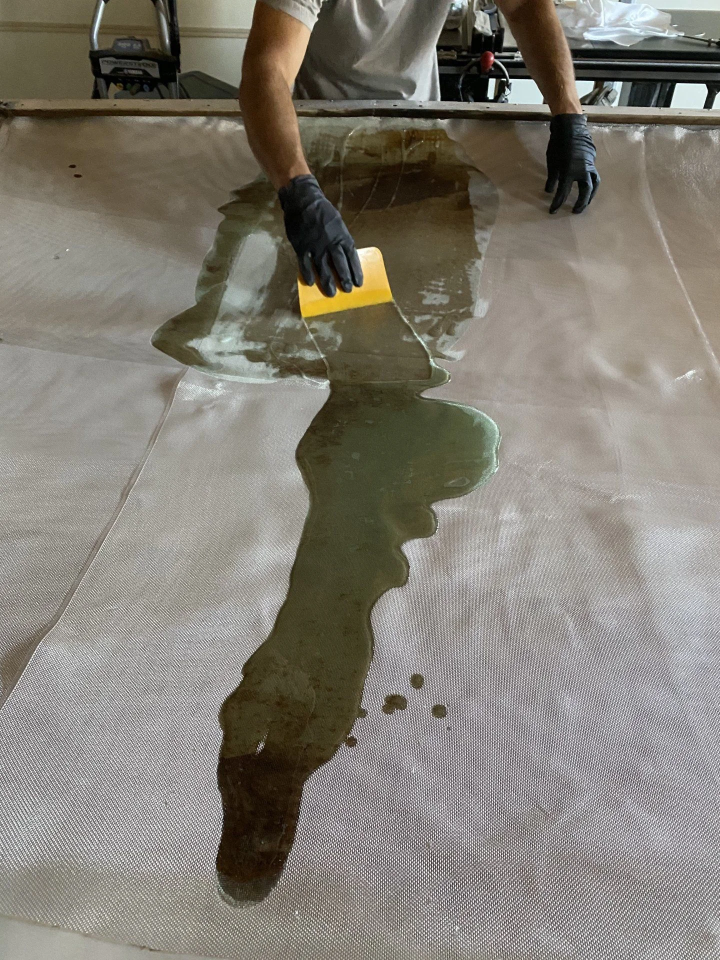

A couple of you have asked how much weight this added. The top is approximately 3.5 square yards and the fiberglass is 6oz/square yard, so I figure about 4 lbs for the fiberglass and another 4-5 lbs for the resin, although it is much lighter when cured. I would say well under 10 lbs total.
