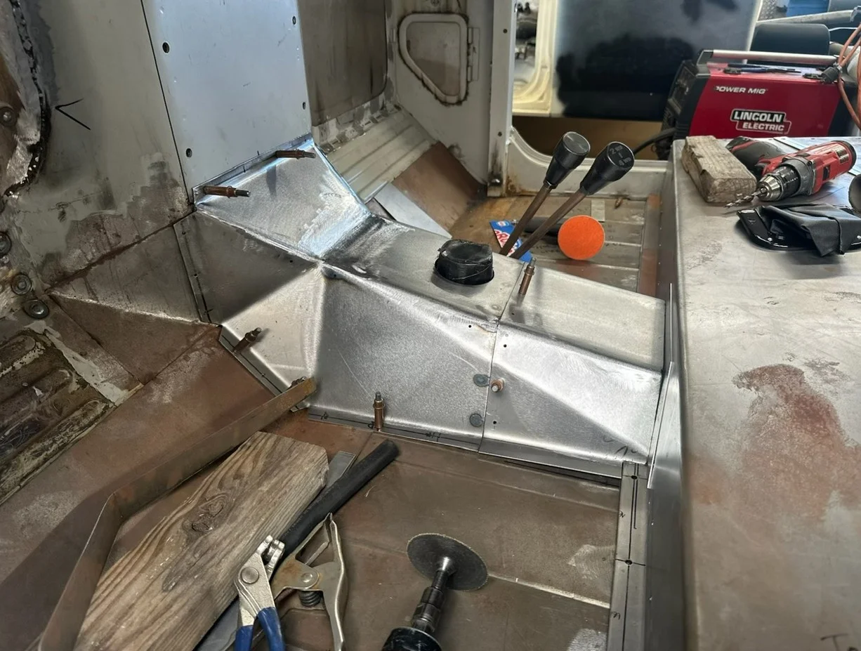

Transmission Tunnel
Got the Trans Tunnel Mocked Up

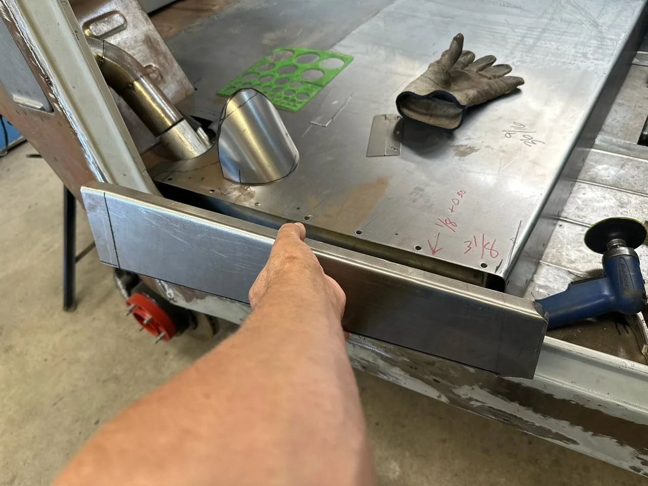

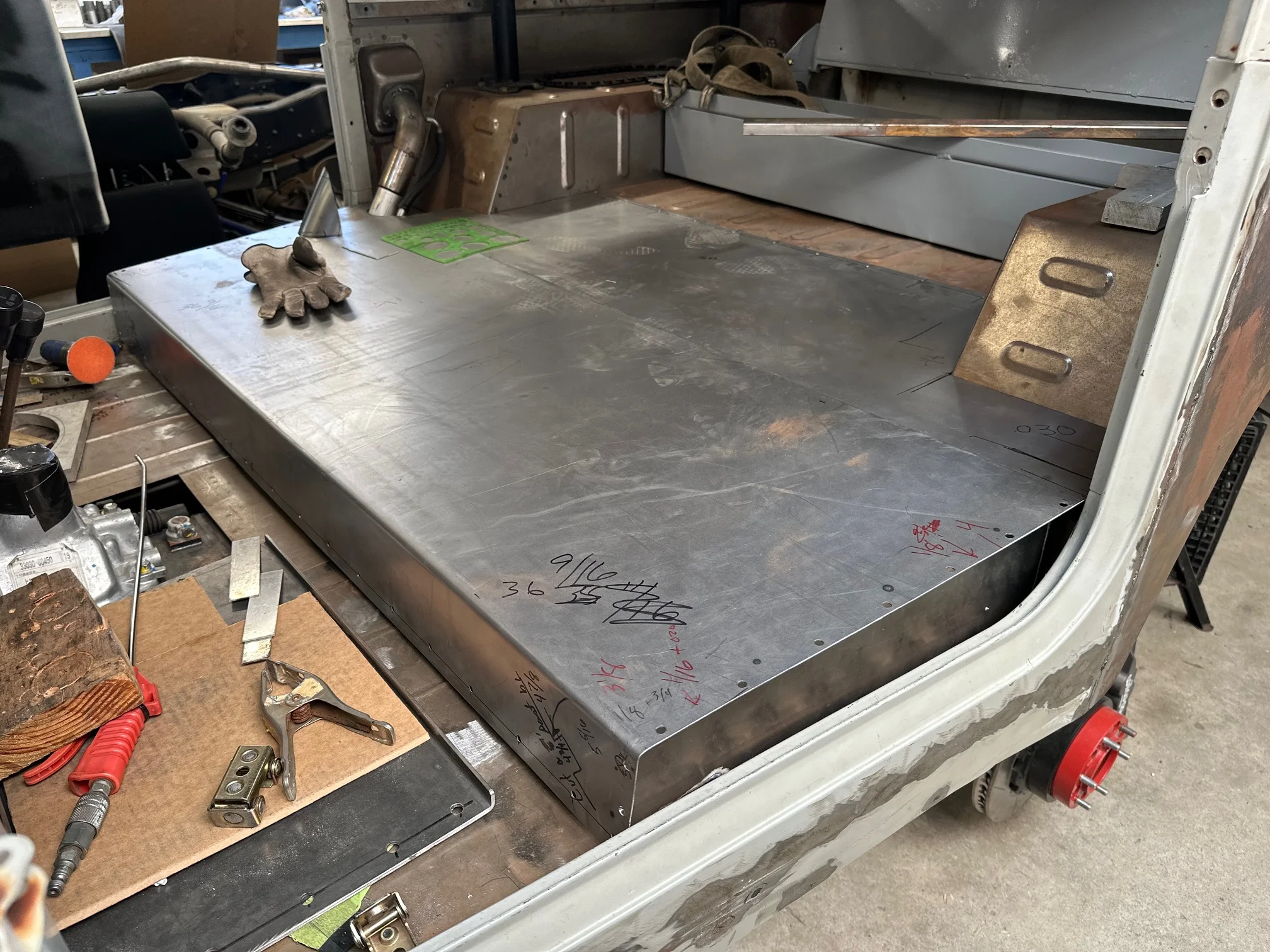

Is your fuel tank cover doubling as your seat mount?
My eyes must be playing tricks on me. How tall is that cover?

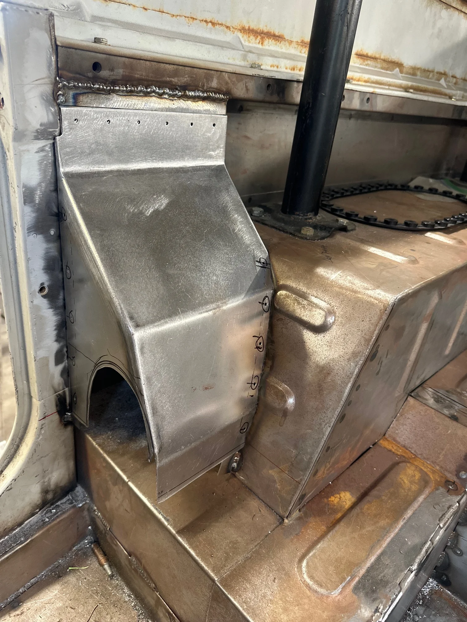

Maybe it’s just me, but I would have cut through the standing seam in your last pic so that the brace marked #5 incorporated the sheetmetal below the wheelwell. Other than that, very sano layout. And props for ‘calling a spade a spade’ and just building the framework at the wheelwell. 90% of the guys on here struggle with lack of legroom, myself included.
Good suggestion Mark. I will make that change.
