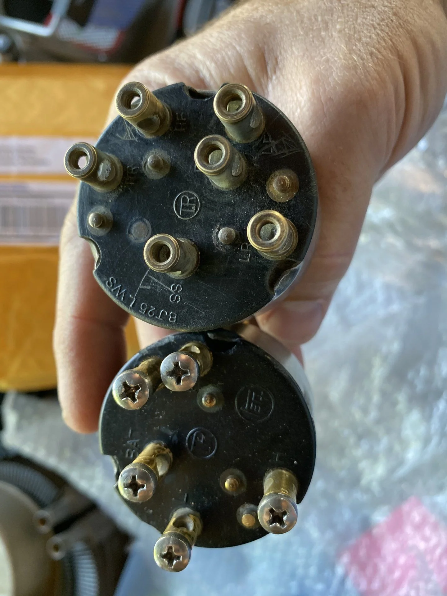

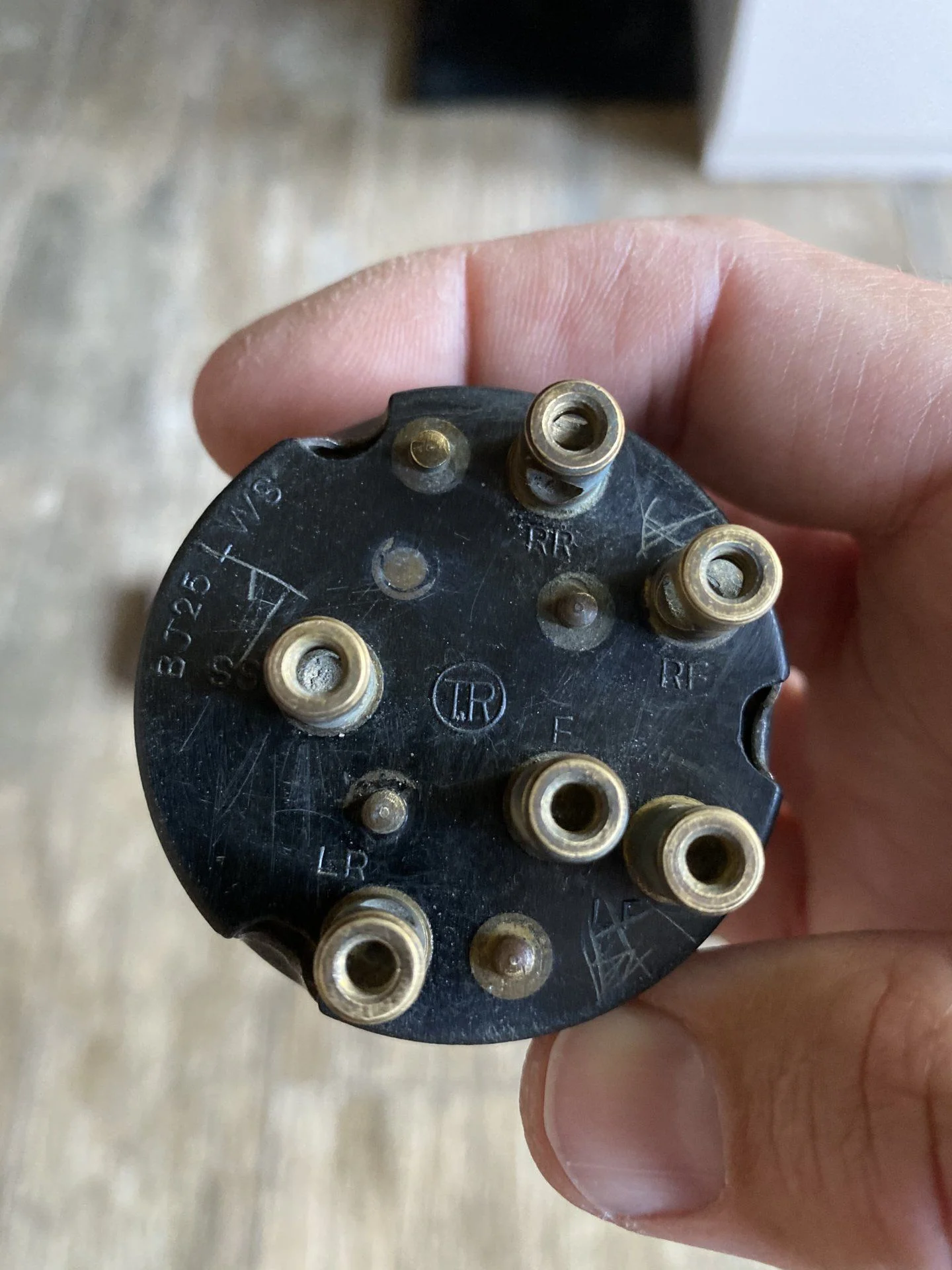

Also finally got the 6 terminal light switch. Here’s a comparison with the 5 terminal one. It’s marked “BJ25 LWS” and the terminals are RR, RF, LF, LR, F, and SS. EDIT - turns out this is the rare dash mounted turn switch with a light knob on it, see next post.
@Coolerman pointed out that this is labeled somewhat like a hazard or turn switch. Also it has only 3 positions on the switch vs the 4 on the normal 5 terminal switch. Made me scratch my head then I thought hey maybe it’s that dash mounted turn switch like @Indygbd has for his 58 - checked his thread (which has great photos, thanks Gabe!) and the back matches. So it looks like this is actually the dash turn switch with a headlight knob attached to it! Talk about dumb luck. Makes me wonder did a 6 terminal headlight switch ever exist or has this always been what the 6 terminal switch was? The terminal pattern matches the two other photos of the 6-terminal that I'd ever seen, so I suspect there never has been an early light switch with anything but 5 terminals.
now I just have to see if I can find or reproduce the knob. And give up on finding a 6 terminal headlight switch that likely never existed.
Below is a picture of NOS with its original box. These 6 post switches were labeled as “Switch Safety”, so it could be blinker / hazard related. Nathan could you please confirm how many positions it rotates?
It's only got 3 positions, I assume left/off/right blinkers? Do you have a photo of the rear of that one to see the markings? That one does appear to have the LIGHT knob on it, but I suppose that could have been swapped onto it like mine was? Odd thing to do to a NOS part though.
I don’t have any other picture of it. May be @Trollhole can provide some more information.
