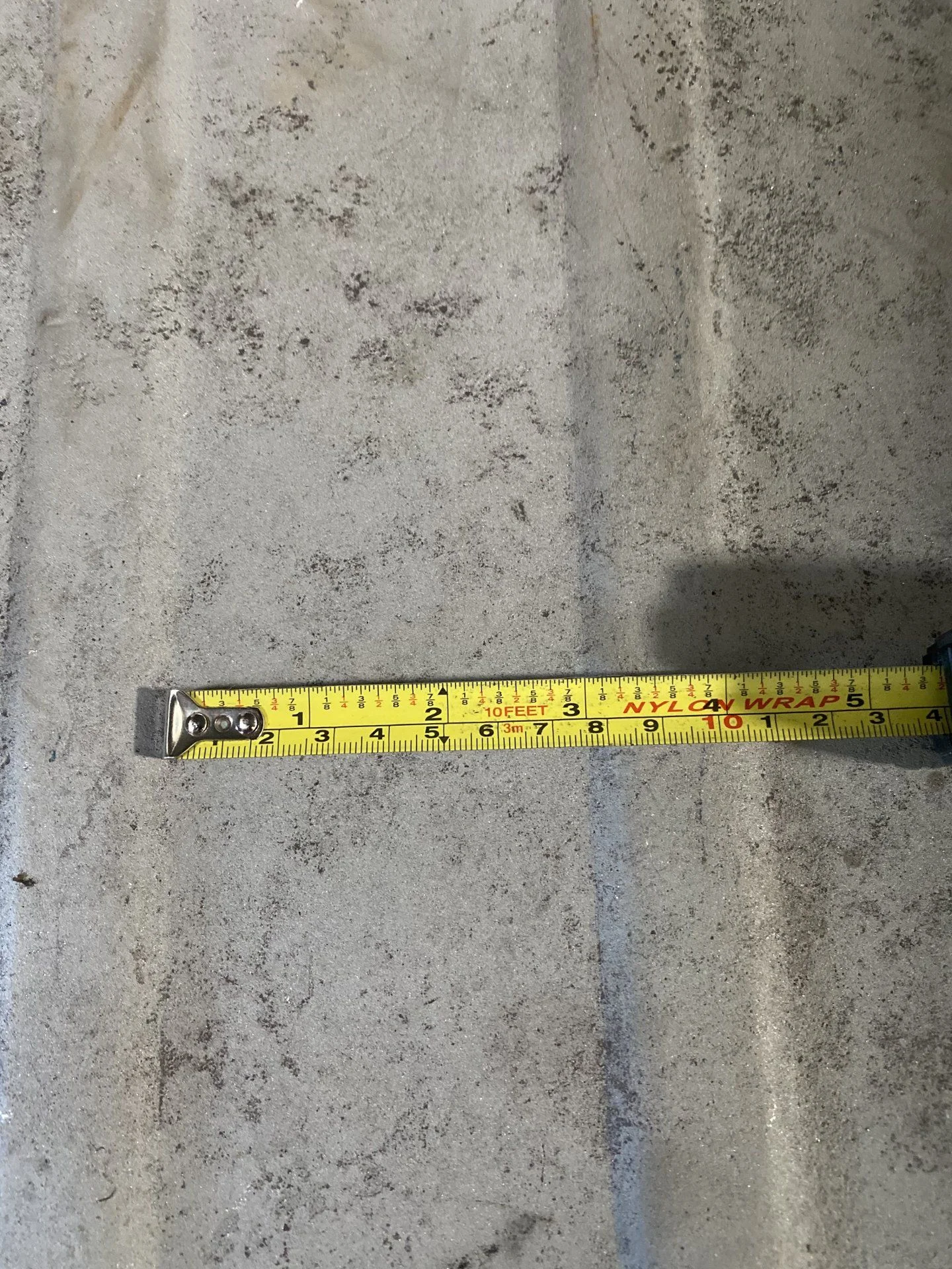

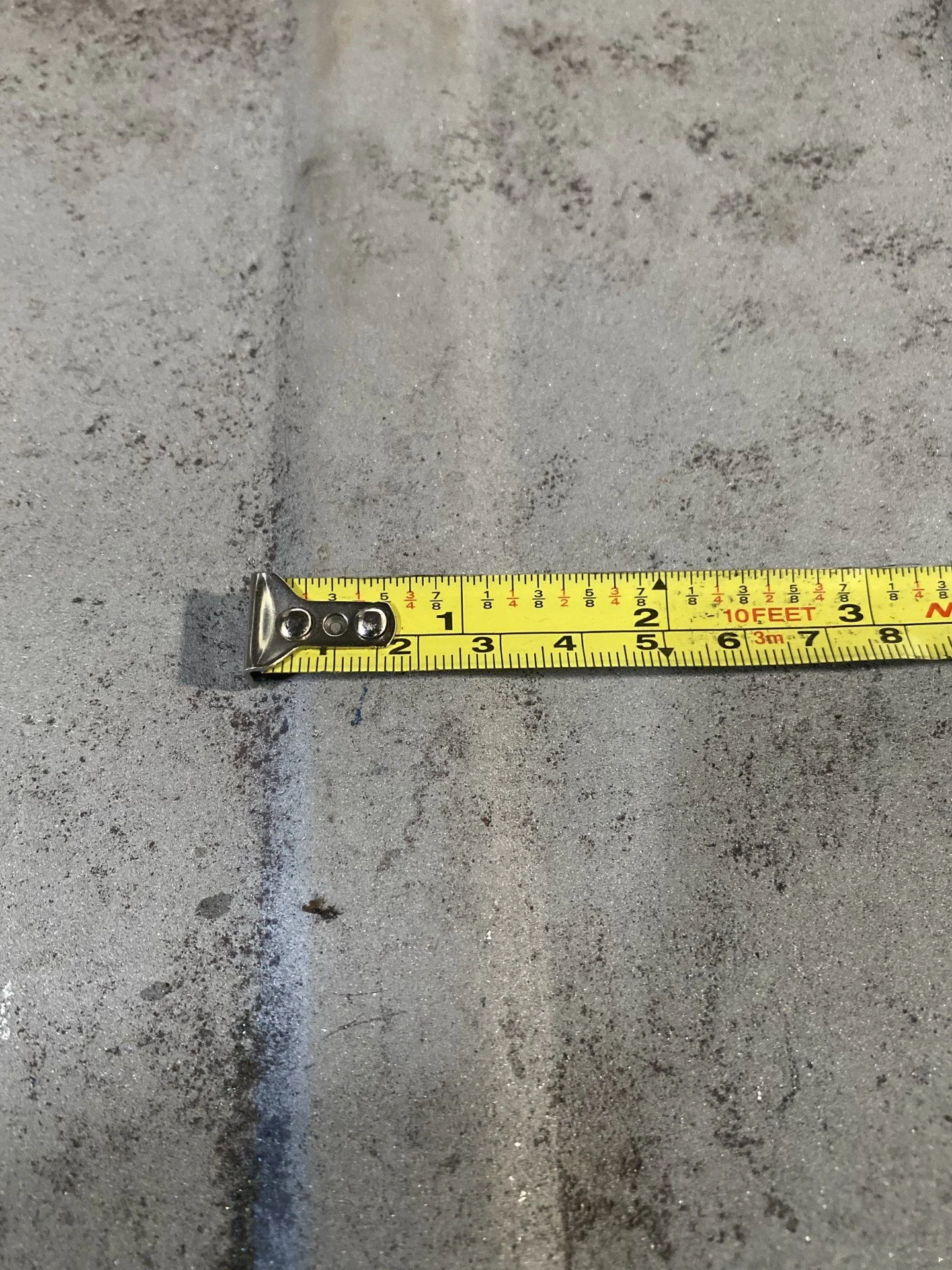

Before we go to the trouble of trying to make a patch piece for the hole in the rear floor pan from scratch, does this floor pan look like any other that we could use for a donor? I looked all over the 'net but looks like the 40 series floor pans are pretty different as well as the 25's, and the LV rear is definitely different too. The ribs are about 1.25" wide and spacing is about 3" edge to edge. Kind of looks like the pattern on the 40 wheel wells i think but i don’t have one to confirm. The problem with those patch panels is they’re too short, so we would need to cut it all up and patch it but i guess it’s one solution.

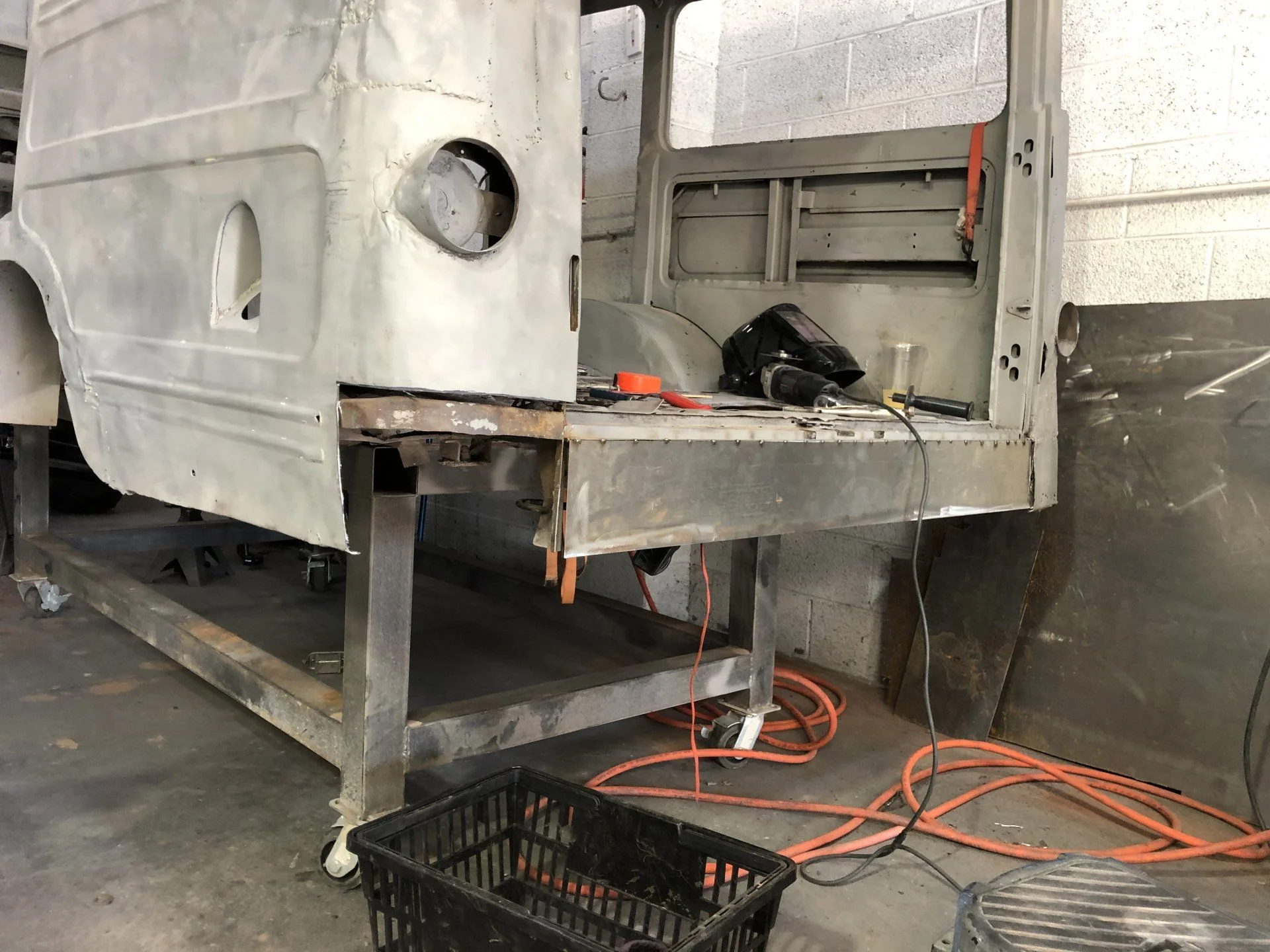

Looks like we will also need to replace the bed support cross channel in the rear of the vehicle, its in pretty rough shape. I see that CCOT sells them for $200+ for part "B". Before I order one of them - in the unlikely event that anybody has one "freed up" (thats the hard part) from their body let me know. We could make one of these, but i'm sure it'd be easy to be into it for $200+ with time and materials anyway.

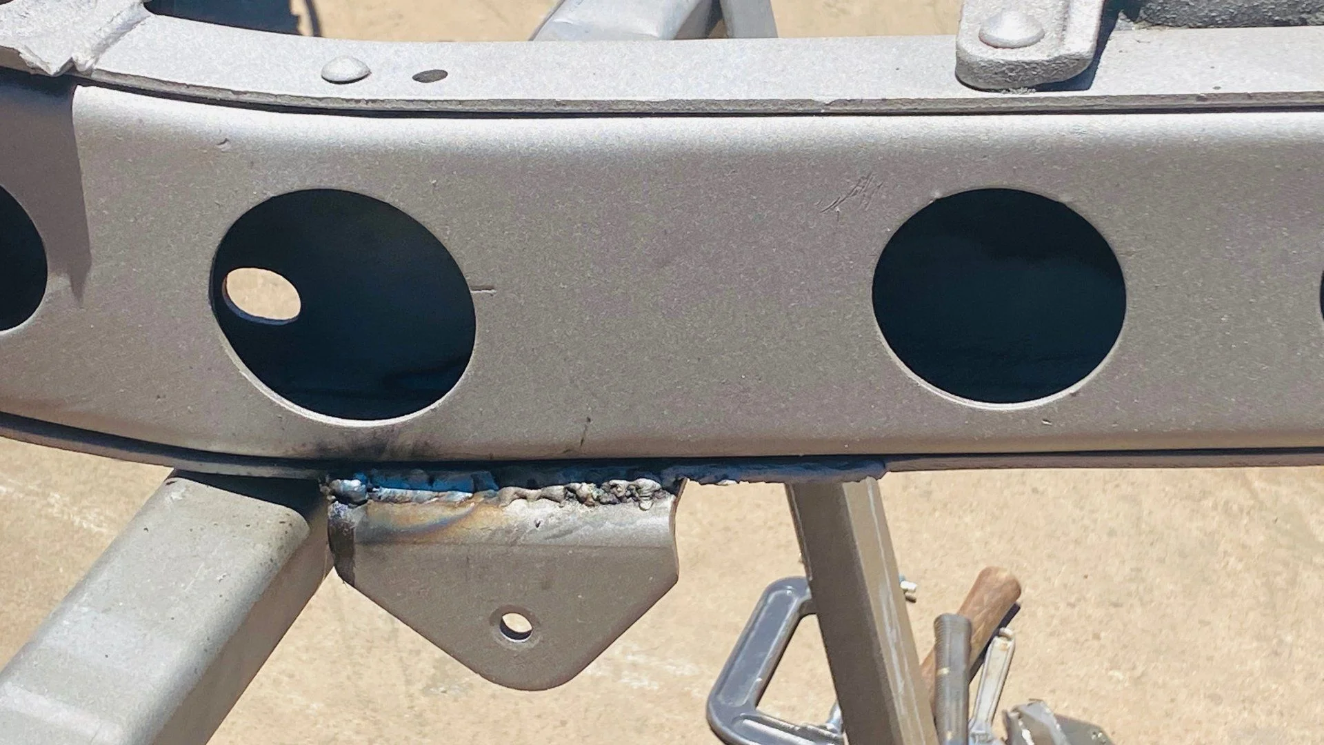

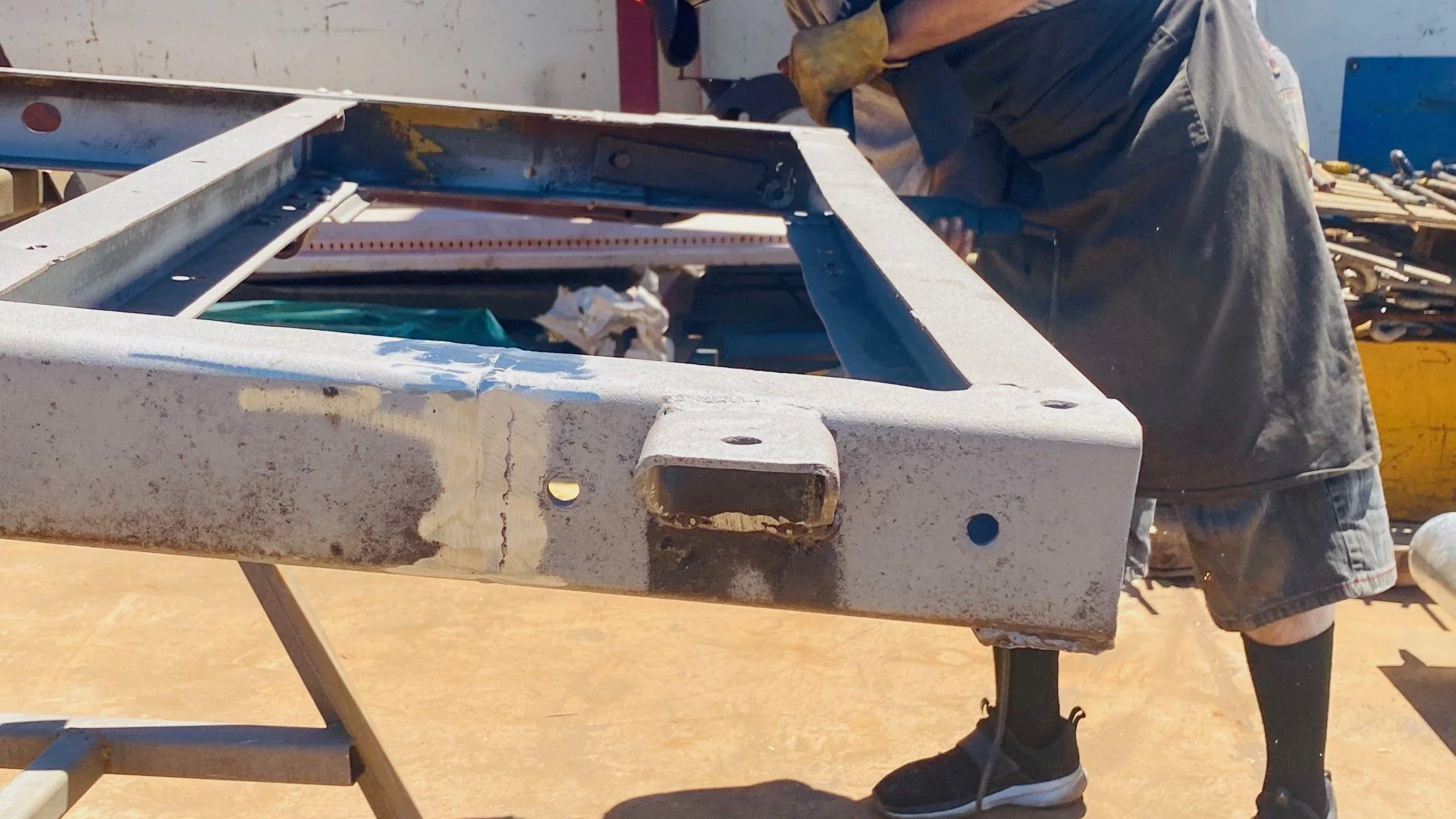

chassis is back from sandblast, no surprises that we didn't already know about here at least ;) we have some stuff that we already had to straighten out, and some engine and body mounts to clean up but this should be the "easy part". Off to powder coat shortly so at least something will look nice and shiny!

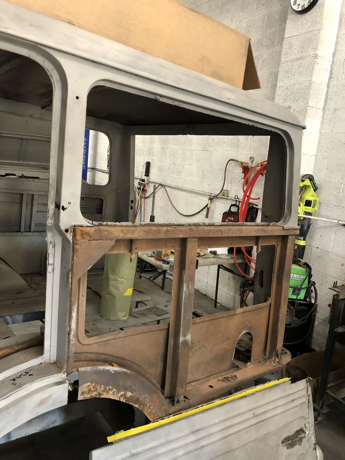

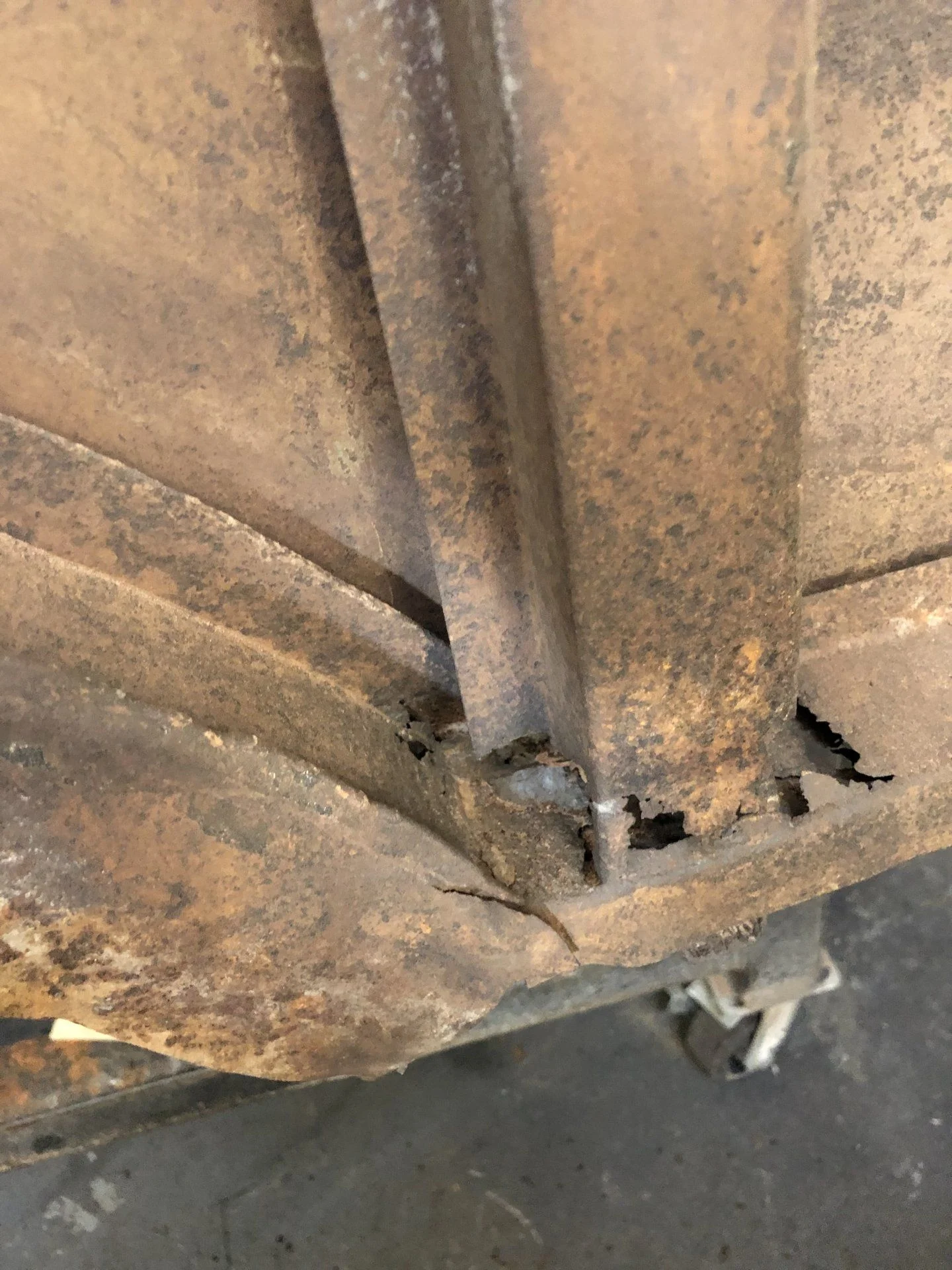

Removing the rear quarter panels to clean things up inside. Looks like the weep hole tubes have been gone for many years and rusted out the bottom of the wall braces. That explains the bowing on the side panels.m. This thing is going to have a lot of new metal. We will need to remove all this surface rust of course as well before we reassemble.

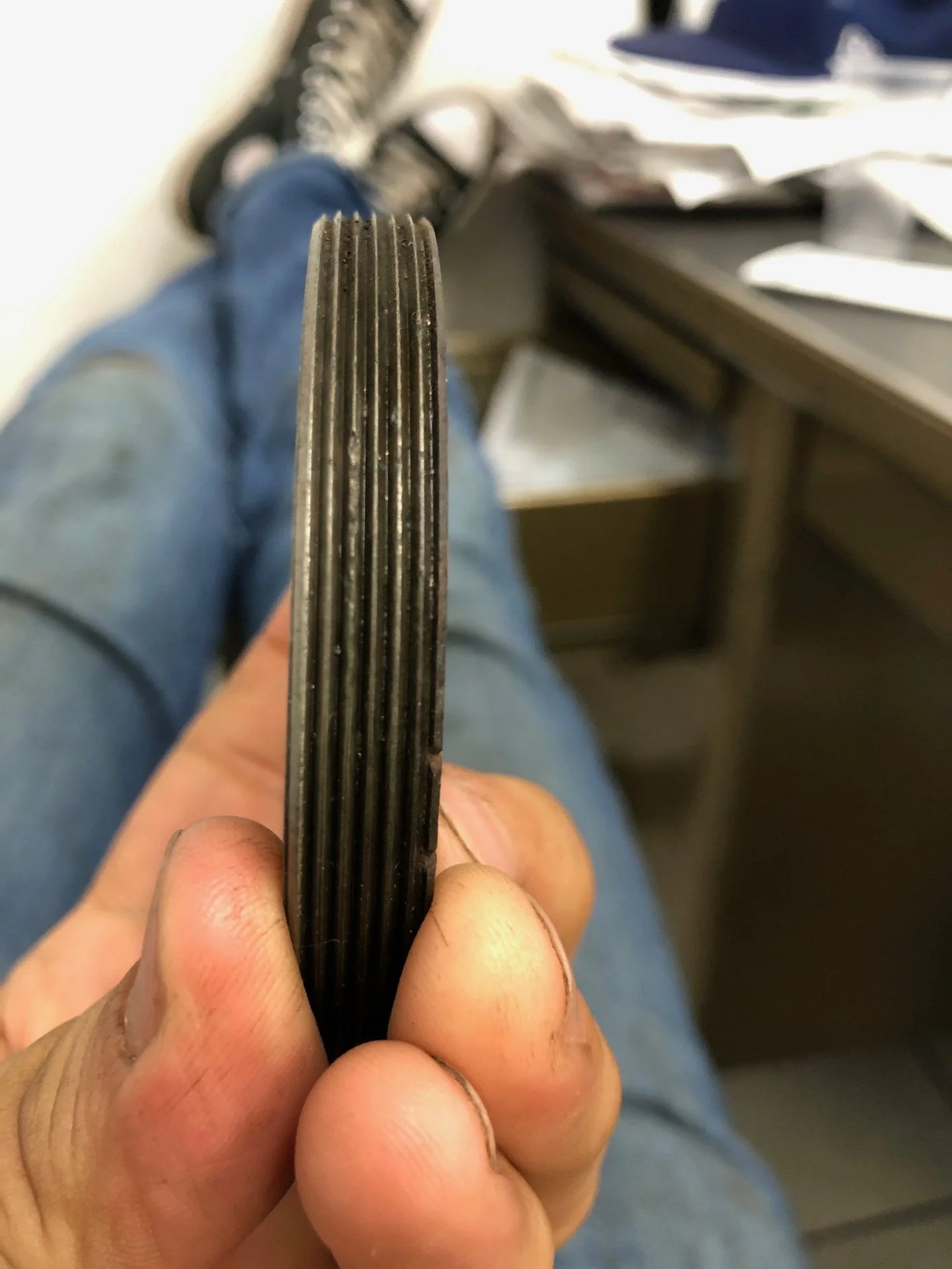

We decided to dig into the differentials ourselves this week, and found a couple of broken pieces in there. I don't see this on any of the diagrams on SOR's site, anybody know what this piece is called and does anybody happen to have a couple of them intact? It goes behind the carrier bearings. More importantly are the 40 and 25 differentials the same or are there differences? I never had to dig into any of the diffs on any of the 40 series I owned.

Hi these are the side bearing adjuster nuts they should have thread on the outside. Early 40 could possibly be the same.
Thanks. I’m hoping early 40 is the same, I’ll have better luck with those than 25 parts I think. Fingers crossed we find some. I did add another photo showing the threaded outside too, thanks for the heads up.
You do know that if you took those to a company that does Waterjet can mastercam and make some. Only thing is what material do you believe they are. Threads will require another step.
