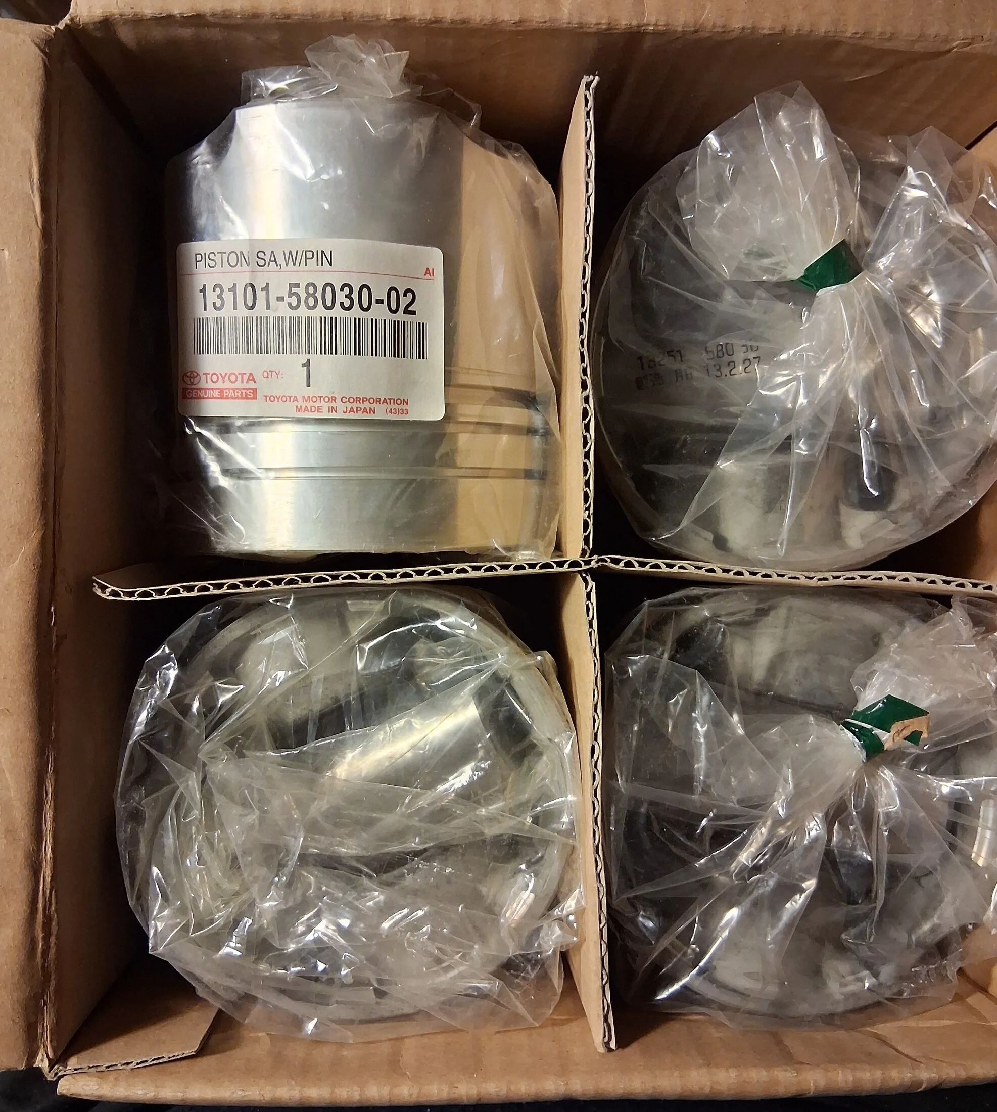

Found a place here in the USA that had a full set of Toyota NOS 13B-T Pistons 13101-58030-02. $$$$ but well worth it.

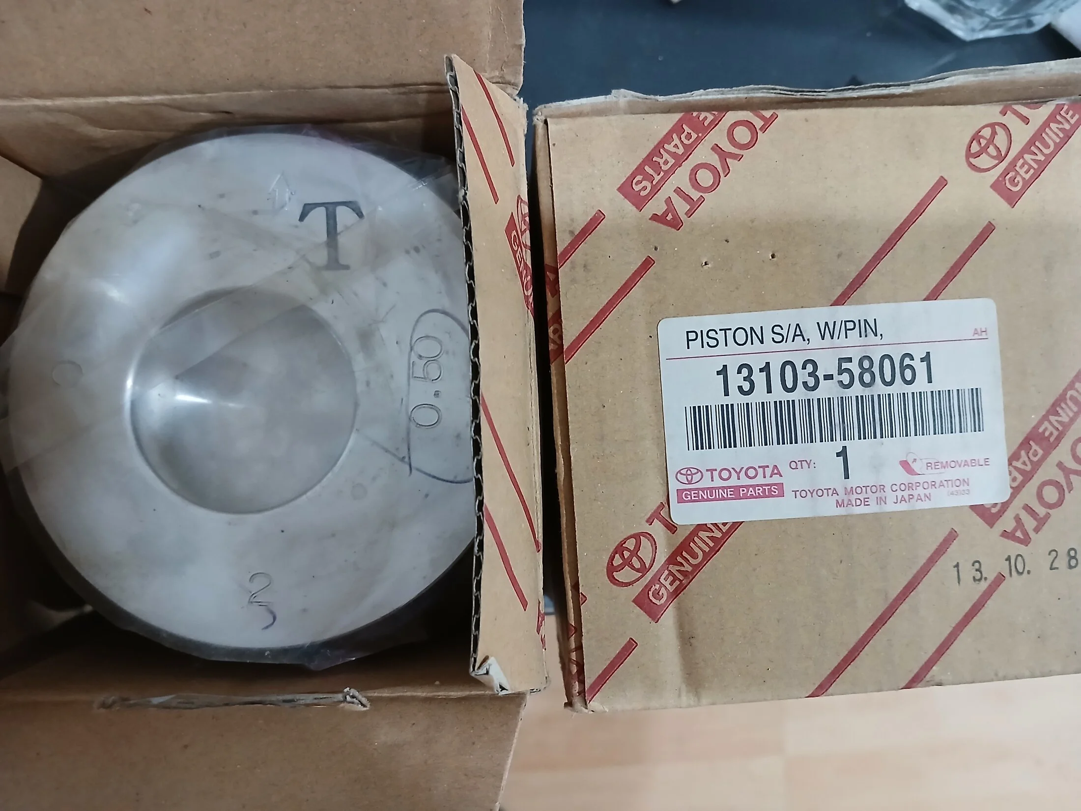

Nice score. Looks like they were made in 2013. I'm sitting on a full set of long-dead +0.50 genuine 14B-T pistons from 2013 which I found NOS.
