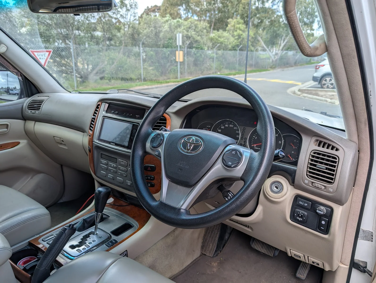

@Hulsty would you mind sharing a picture of your Camry wheel?
Here you go, at some point I would like to paint it brown or try and find a brown wheel from another latish model Toyota.
Many late model Toyota steering wheels interchange, you may need to include the clock spring and move some pins too. I have a 2017 Camry wheel on mine, no boss adapter needed. Try PVS automotive, they have kits to suit.
