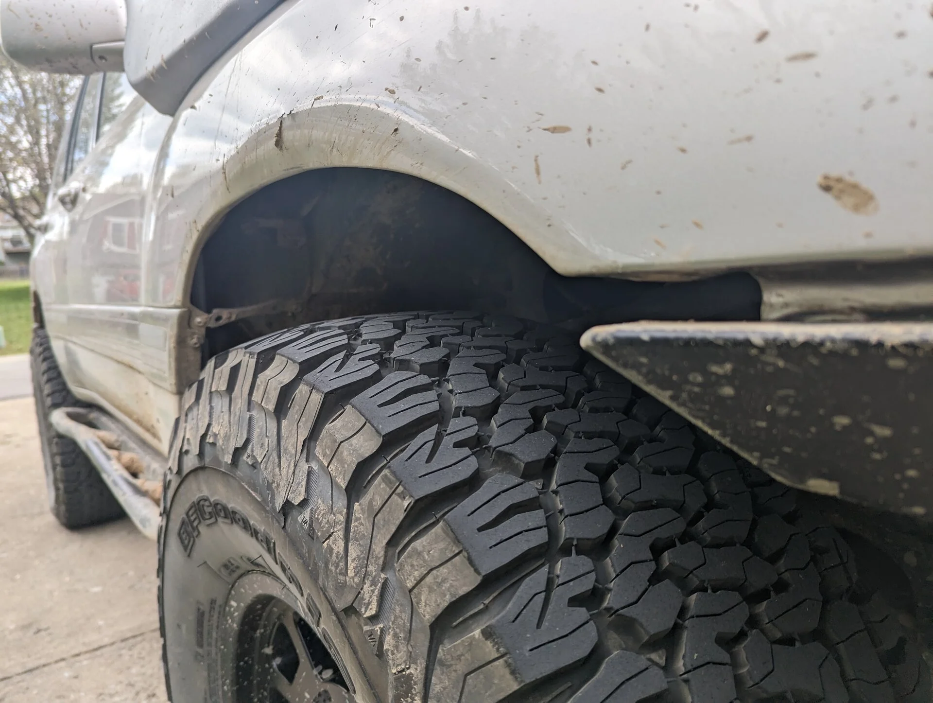

Hey everyone, I recently put 35s on my 100. Is my only option a body lift to prevent rubbing here? I hit some bumps at speed and pushed in my fenders a bit. I have a trip coming up at the end of May and I'm hoping I can get something figured out before then so I don't rear up the fenders any more.

Yes 35’s require some pinch weld trimming and plastic reform. The more the wheel offset the more trimming and what not
Yeah I managed to hammer in the pinch weld pretty good, I'm not hitting the pinch weld at all at this point, just the top of the fender.
It's a bit hard to tell in the photo I posted but you can see the black mark where the tire hit right above and also cracked my new paint job :(
What were you doing when the tire made contact with the fender on the top? I’ve only seen it a couple times and notable air under the tires was present.
I was on a dirt road traveling ~35-40mph and I'm pretty sure I just hit a a bump or a dip in the road going a bit faster than I should have been.
This looks like an offset issue. You’re going to need to seriously extend your front bumps or go with a different wheel.

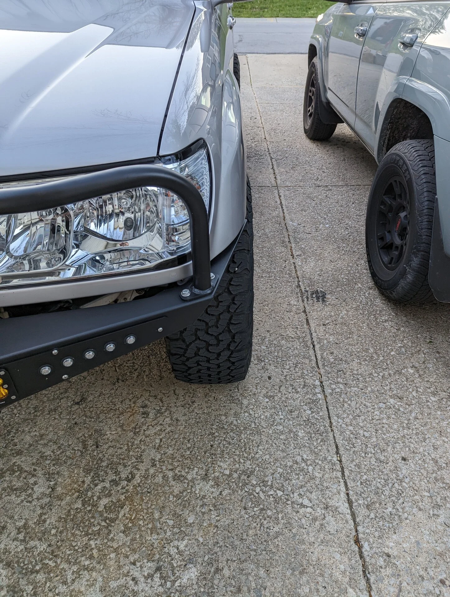

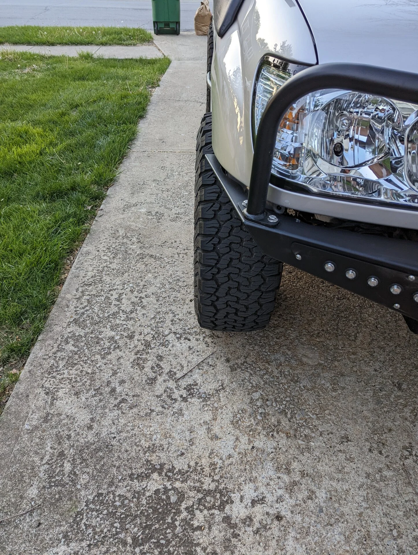

Not sure how I didn't realize it earlier but the passenger side tire and bumper is sticking out quite a bit further on the passenger side. Any ideas what's going on here?
