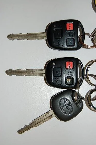

Regarding my keys, below are pictured numbers 1, 2, and 3.
#1 and #2 will work in the ignition ONLY, and will not manually unlock the doors, trunk, or golve box.
#3 will manually unlock the doors and trunk, NOT the glove box, and WILL NOT work in the ignition. (So, yes, I cannot lock the glove box at all)
(Damage to "unlock" button on #2 has been present since purchase, without consequence)
Did any of your keys ever unlock the glove box?
Did the fact that keys 1 and 2 don't manually unlock the doors or glove box ever come to your attention before?
Are you the original owner?
The reason I ask is that it sounds like the ignition cyclinder was changed in the past, and you DID NOT get the metal key blanks replaced in the remote control keys 1 and 2.
Key 3 is the valet key. It never unlocks the glove box, but it should manually unlock the doors and liftgate, and start the car. So it sounds like you still have the old one that still works in the doors.
So, if all 3 keys, or at least the 2 remote control keys, did work at one time to start the car, then they MUST have been learned at one time by the Immobilizer control circuit.
So i would bet that the Immobilizer circuit is shot/forgot your key codes, or the coil antenna around the ignition key cylinder wiggled loose or is broken. Or else, maybe somebody monkeyed around with your Toyota LC trying to learn some new keys in your truck (up to 6 can be stored) and electrically forced your keys out of memory.
If it's intermittent, I would lean toward the broken coil in the ignition cylinder.
Did any of your keys ever unlock the glove box? No.
Did the fact that keys 1 and 2 don't manually unlock the doors or glove box ever come to your attention before? Yes, but I didn't seem important as far as operating the vehicle goes.
Are you the original owner? No. Third owner.
Key 3 is the valet key. It never unlocks the glove box, but it should manually unlock the doors and liftgate, and start the car. So it sounds like you still have the old one that still works in the doors. Yes, it works in the doors, but does NOT work in the ignition.
So, if all 3 keys, or at least the 2 remote control keys, did work at one time to start the car, then they MUST have been learned at one time by the Immobilizer control circuit. #1 and #2 have worked until recently.
So i would bet that the Immobilizer circuit is shot/forgot your key codes, or the coil antenna around the ignition key cylinder wiggled loose or is broken. Or else, maybe somebody monkeyed around with your Toyota LC trying to learn some new keys in your truck (up to 6 can be stored) and electrically forced your keys out of memory. Extremely unlikely.
If this turns out to be the case, I am offering you a bottle of scotch of your choice.

I think the explanation of the keys and cyclinders is solid. Your ignition cyclinder was changed in the past, but they didn't change the door lock cylinders or the glove box cylinder to match them all up again. ( That's typical. It's a long expensive job to have to swap out all 3 door cyclinders when they are working just fine. And the remote control USUALLY works 99% of the time. If your battery ever dies when you are in the mall, you will need that Valet key to get into your car.) So the previous owner just got the new metal key blanks for the Remote Control keys so that they would mechanically turn the new ignition cylinder, and then learned those new Remote keys.
When I insert a valid key into the ignition cylinder, the red security icon on the center dashboard stops blinking. That's why I think you keys are no longer being recognized by the Immobilizer.
You should still check whether an immobilizer controller is supposed to allow you to crank the starter (even though it doesn't catch) if the key is not recognized. I would have thought that the immobilizer would cut off the starter motor AND fuel pump if they key didn't match. But I'm not sure about that one.
Scotch not necessary. Buy your wife a huge vase of flowers instead.
An unrecognized key will crank the starter but not allow the engine to fire. I know this because I have a cut key to match my LC, but it is not yet programmed into the ECU. As stated earlier, the red security light just continues to blink when it is inserted.
It definitely sounds like there is a fault with the immobilizer portion of the ignition cylinder, the signal line from that to the ECU, or the ECU itself. It is not sensing that a correct transponder key has been inserted.
Whether this is the same problem one of the previous owners had which necessitated a replacement ignition cylinder, who knows.
