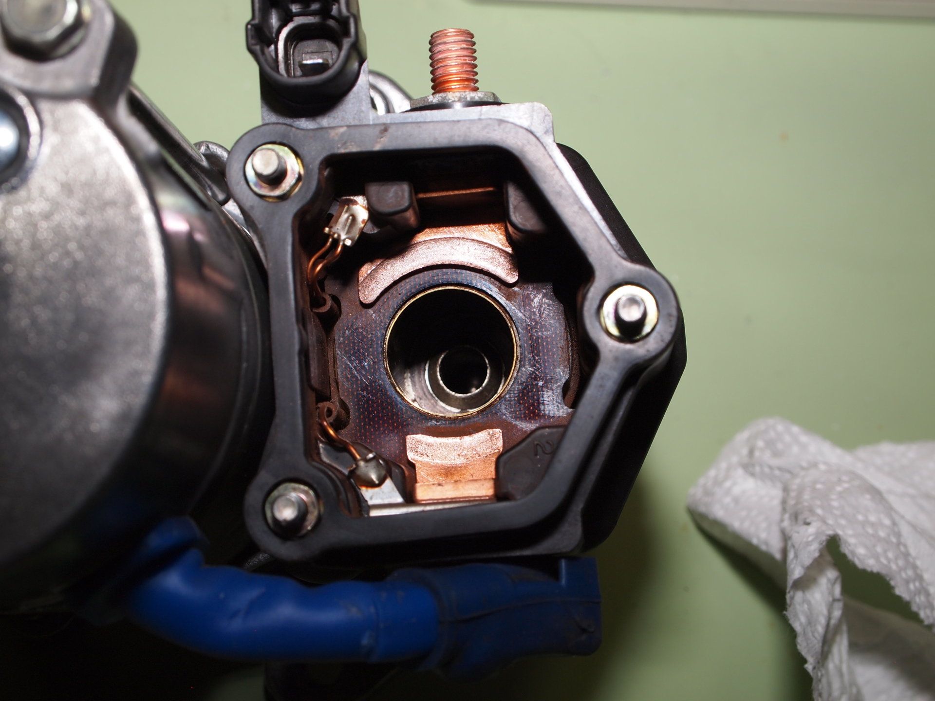

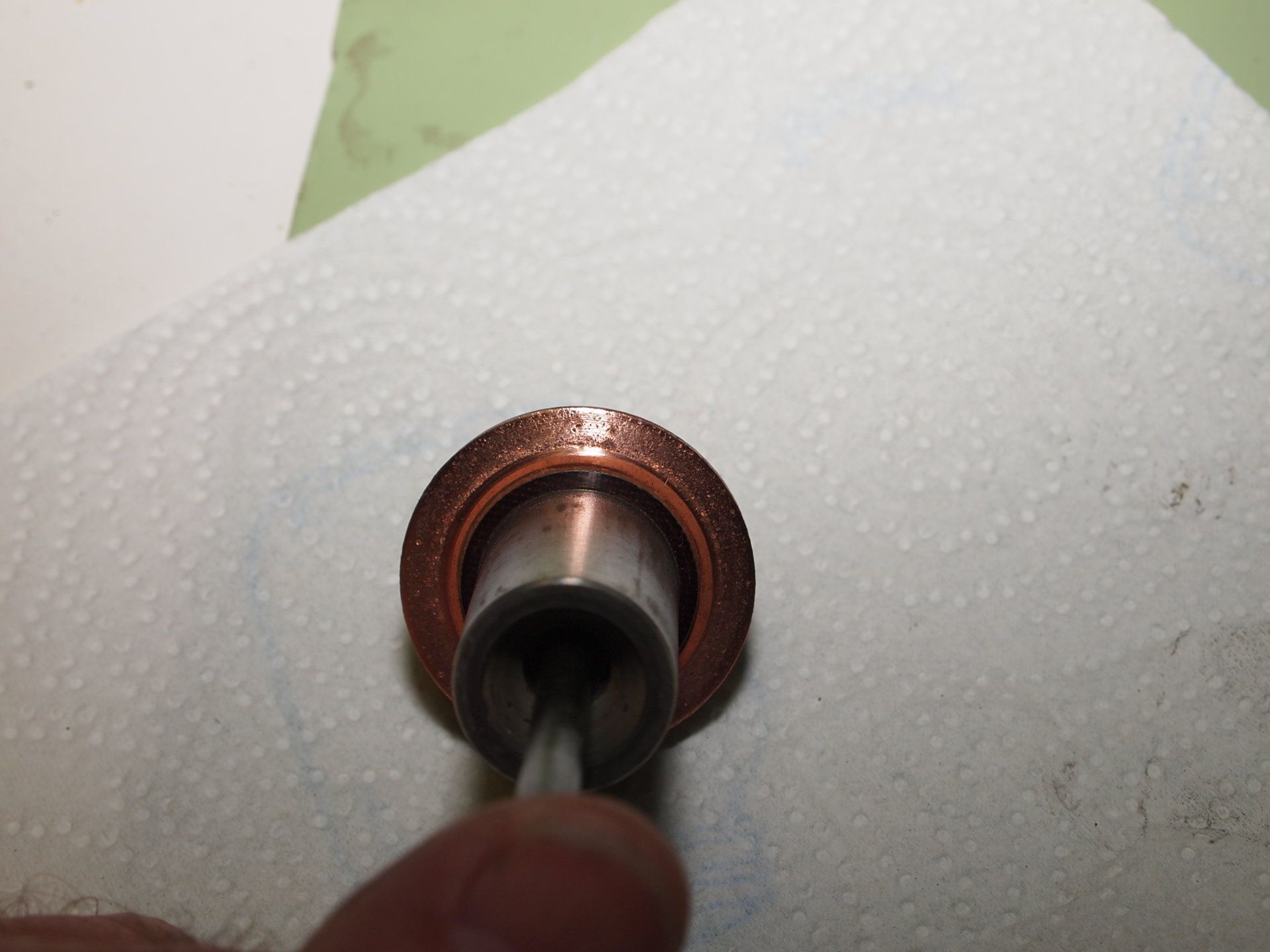

1) Battery post and clamp can build oxidation on them. This can inhibit the current input and output. It will act like bad battery or alternator. Cleaning posts and clamps then all seems good and happens again. To prevent the oxidation build up, grease the battery post and clamps after cleaning.
2) Cranking and than not cranking, cranking after tapping on starter. These are signs of start contacts and plunger going bad.
With the 98-02 rebuilding is a good option. Contact and plunger ~$30. You may also want front possible rear bearings and brushes.
