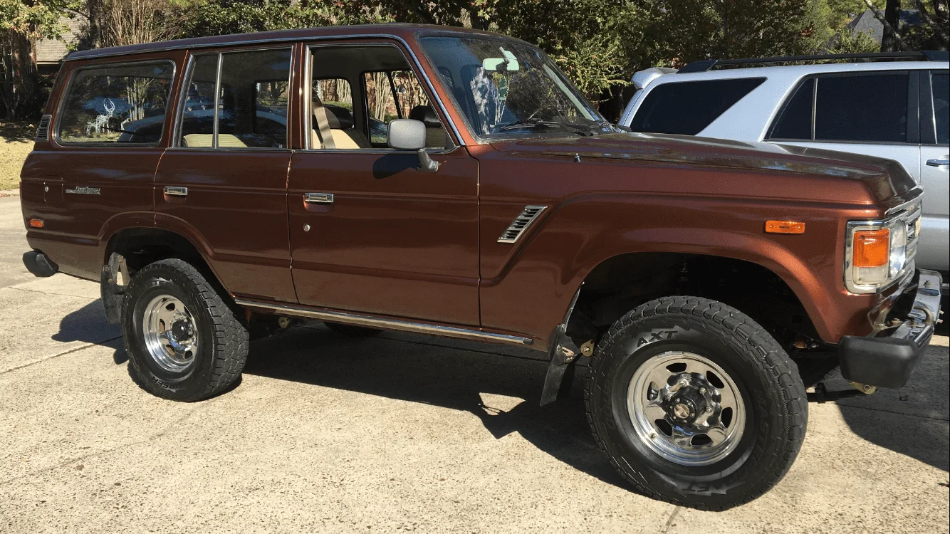

Ok, So I got my son a 4Runner my buddy was going to turn in to a dealer when buying a new car...high miles but got a good deal on it and it was well maintained. The AC started blowing hot air and my son could switch it from hi to lo a few times and it would blow cold again. Now it is not coming on at all. Anyone able to tell me if there is some sort of control module or something like that I could replace to get this fixed myself. I like to spend our car money on my weekend cruiser and not his 4Runner so any advice would be greatly appreciated. 4Runner in the background

Good luck. Awesome Cruiser BTW.
