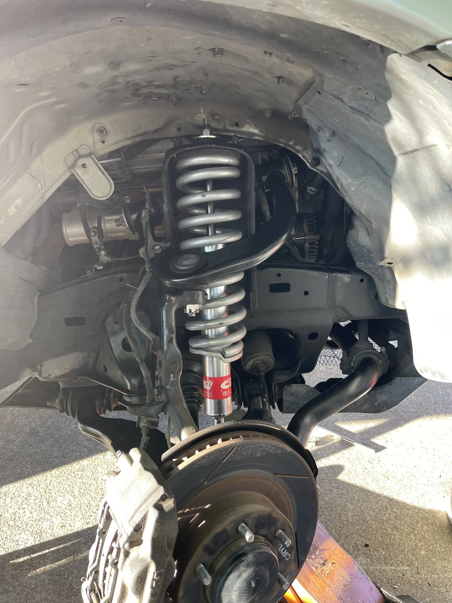

Eibach pro truck kit and upper control arms should be here later today. Already replaced the KDSS bushings.

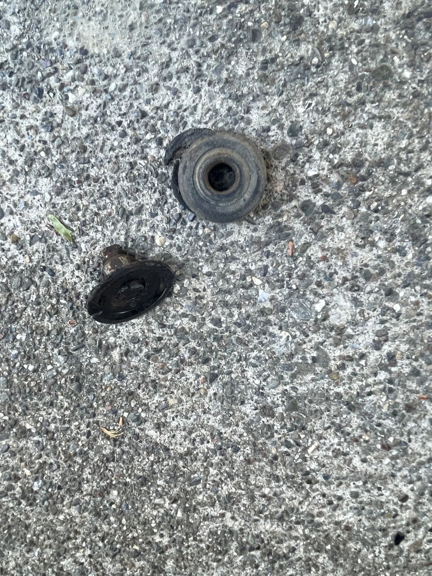

I replaced the rear shocks and stopped there. I inspected my airbags and I thought they were leaking but I was wrong. I took it off road and it’s a little squirrelly with the front coil over and the airbags in the rear. So I’ll probably do the airbag delete in the next few days. Ditched the running boards also.
