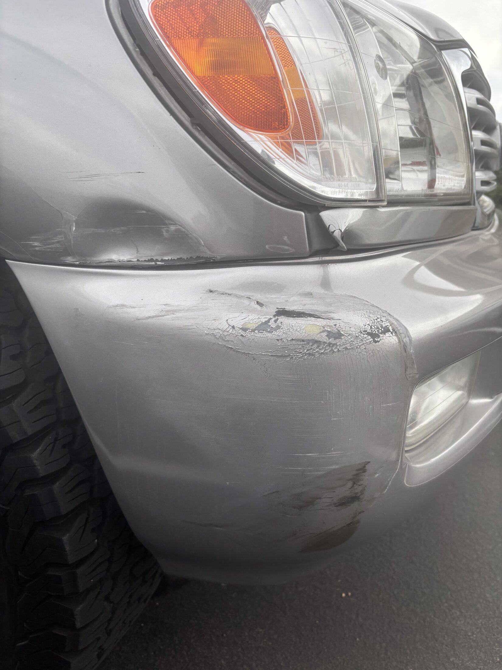

New to cruiser family and didn’t want something like this to be my first post…:/ I was involved in a hit and run and I’m so beat about it bc this paint was pretty nice :(

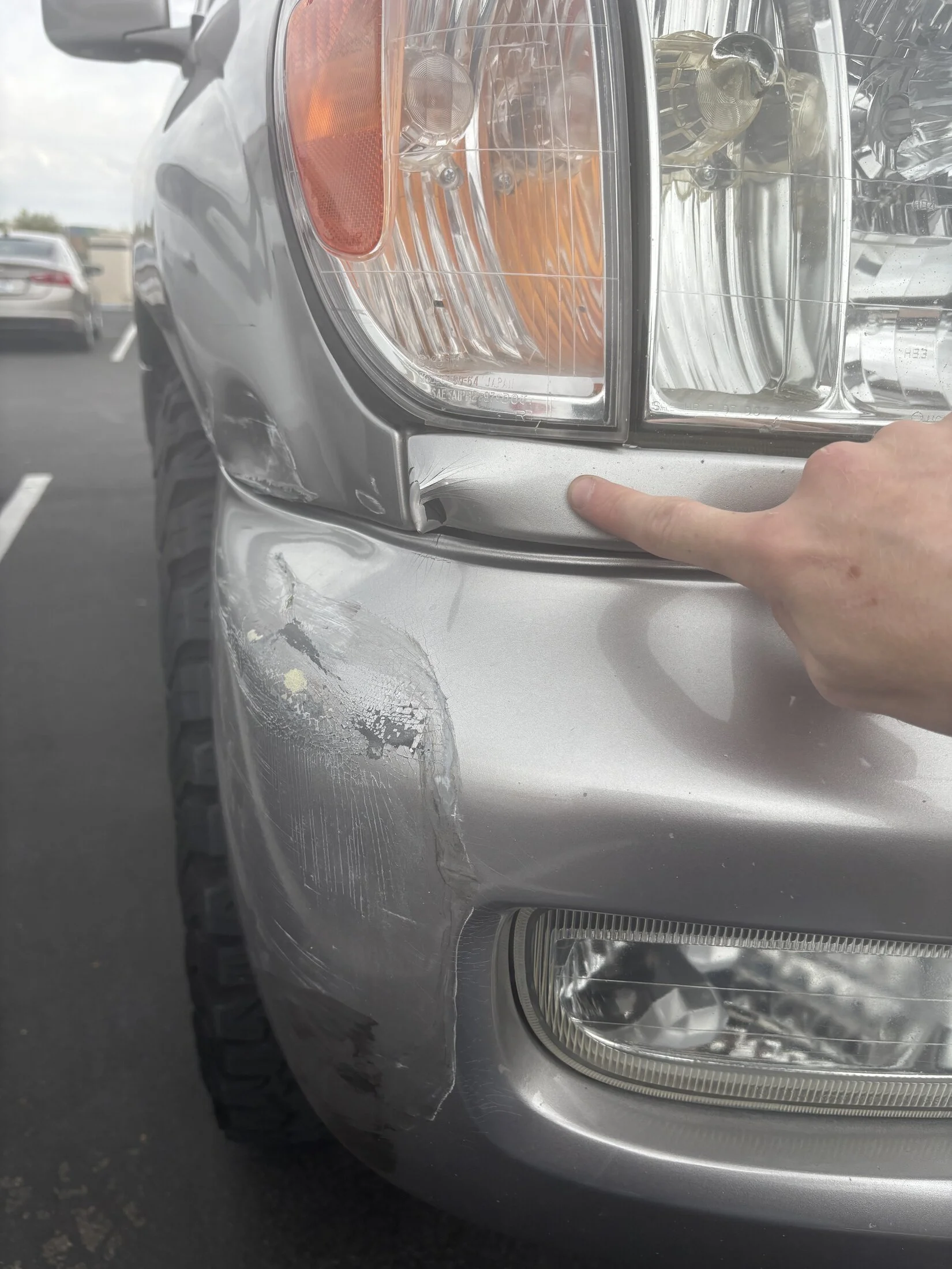

So as for repair work, is this small thin vent panel underneath the headlights seem replaceable but I’m having a hard time finding some available. I seemed to find out the 98-02, 03-04, and 05-07 all have their own “infill panel”. I have pretty good hopes that I can have a dent removal shop pull the bubble dent out of the fender as it doesn’t look terrible and then just repaint and I’ll be happy happy :). Please lmk suggestions for the panel replacement, I would like oem!
I’ve also heard they are spot welded in, if that is the case that is totally fine with me I just need someone able to recover a nice set! (or just Passenger LHD)
You will need to use the complete front panel sub assembly for 03-05 model LC. Part number: 53903-60070. For 06-07, the filler panel available separately. But you will not be able to use the filler panel from 06+ model on pre 06 as shape a bit different. Hope that helps.
