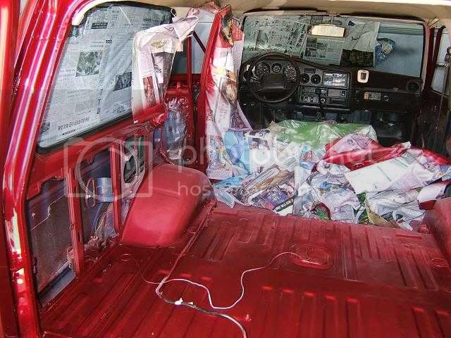

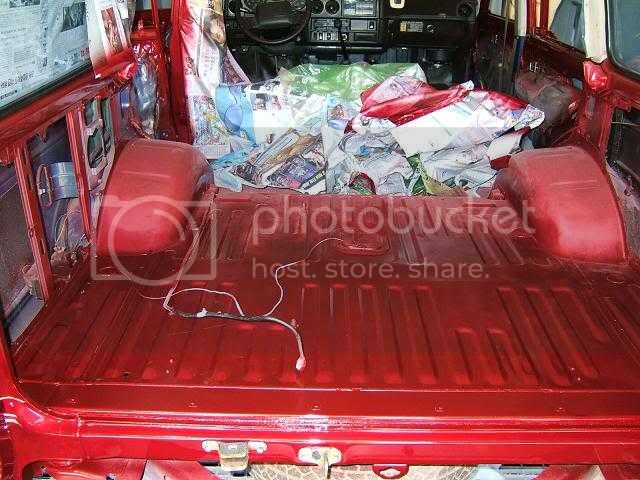

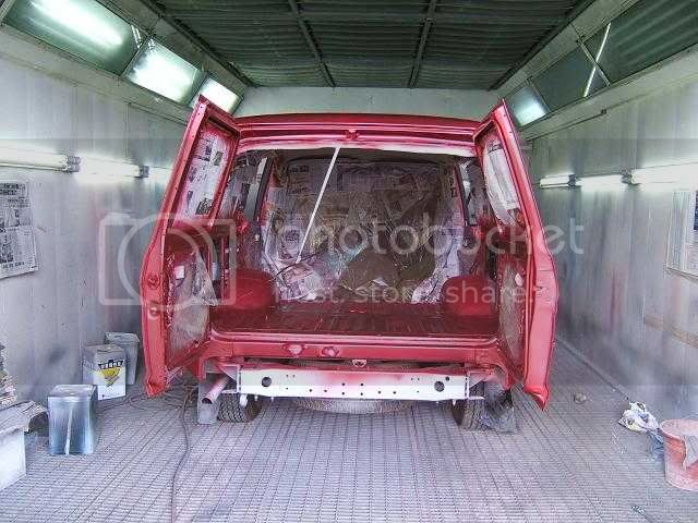

I painted whole inside as well :)
inside working pics,,,,
