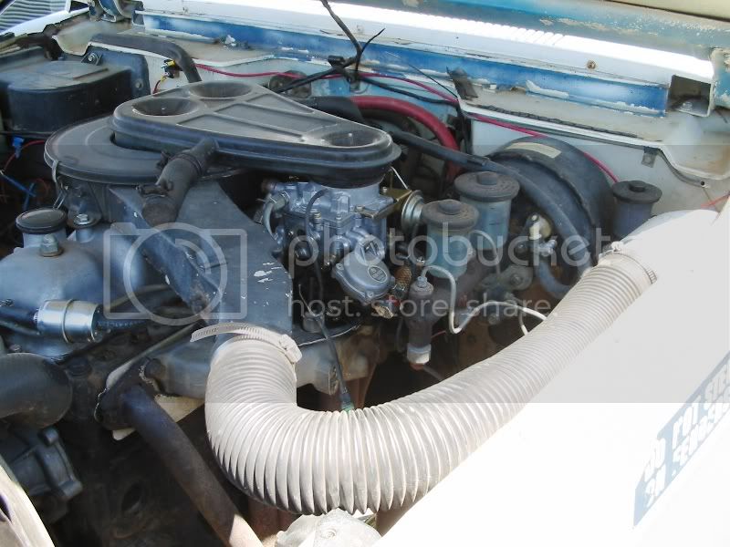

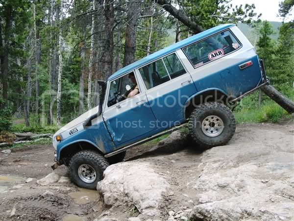

I got "Pig" almost 2 years ago from Ken in Idaho, (who has the kick ass troopie) and he got it from Dan Kunz in Georgia who got if from someone in Montanna. It was originally a 76 FJ55 blue & white, then painted all metallic blue, then rattle-can white, then rattle-can two tone by me. "0 to 60 in five miles" sticker. ;p
78 2F
Marks Off-road Carb
4" Alcan Lift, 200lbs over stock weight up front, 300lbs over stock weight rear
Longer shackles
35" BFG M/T's KM's
15 X 8 Eagle 589 Aluminum Wheels
Warn 5687 currnetly no cable, :rolleyes: the old one turned into spaghetti
Custom Bumpers front and rear
Sliders attached to frame, made out of 2X2" tube
Snorkle, "The Home Depot" special
ARB Compressor
Front and Rear ARB's
4 Wheel Disc Brakes on 1978 Axles
Greasable Pins
Optima Red Top battery
Painless waterproof 7 fuse addition
6" KC HighLighters
Doestch Tech Shocks DT8000 rear shock, DT3000 fronts
Hi-Lift Jack
Autometer Tach
Aqualu Double Arm
Old Man Emu stabilizer
Stainless Brake Lines
D shackle tow points
6 to 1 header
FUTURE MODS: new tranny, got a line on an H55F/split at the moment...if that falls through most likey H41/Orion combo.
Needs powersteering :) but then my wife will drive it too much. hmmm...
Needs a new compressor for the factory A/C. Will retrofit a whole R-134a unit in.
SOA, already gathering parts for the SOA...then move to 4 Link rear.

any chance you can post some more pics of the snorkle.

Man that is fawking bad a$$. Damn, it's just a damn good lookin rig. WOW :eek:
Ya the 55 is a cool cruiser. That's what kicks ass about Cruisers, you got so many model options. The first 55 I ever saw was before I owned a Cruiser but was interested. Saw the emblem and had to go back and check it out. I was like WTF is this thing it's a beast, kind of ugly too. Wow did it ever grow on me. They kick ass.
I'll definitely have one someday. Nice job man :cheers:
great pics! Pigs are one of the sweetest lookin rigs around, I gotta admit!!
