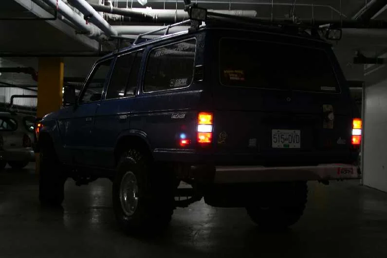

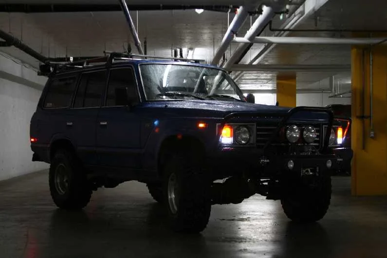

So I re-did all of the lights with LEDs, even changed the turn signal flasher relay to one that will work for LEDs. The only thing I have not changes is the dome lights. The company I got them from is http://www.superbrightleds.com/

The M1 markers are good but the hole spacing is just about 1/8th smaller then the stock toyota stuff, also it does not come with any rubber or gasket so you'd have to find your own.
The flasher unit has the proper pin positions for the toyota but the spacing of them is not correct, what I did was remove the old flasher relay, unsolder the old pins, installed them onto the new relay board (after removing theirs). This way it also fits into the stock relay housing and looks stock.

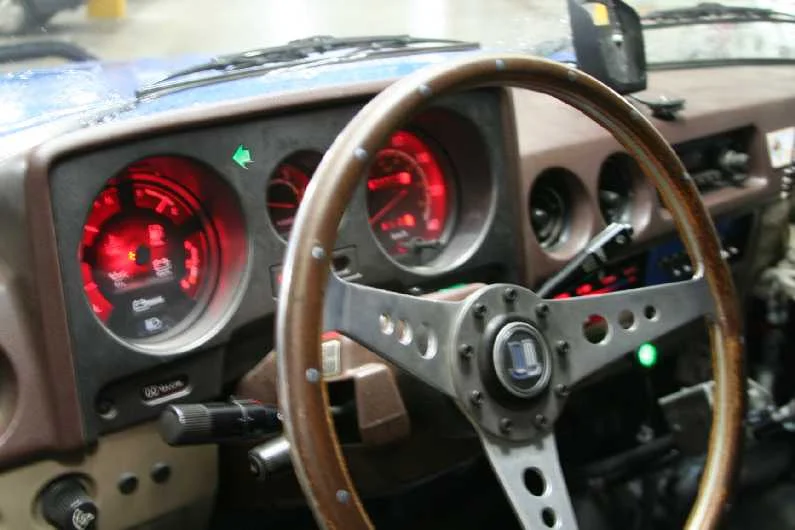

The dash lights were a little too big, I recommend going for the model down unless you feel like taking everything apart (like I did) to fit them in from the inside.
As a side add on I used aluminum tape (the stuff for ducting) on all of the surfaces in the turn/parking light housings and even in the dashboard. This allows for better reflection. 1 thing I learned was to plug in and test the lights in the dash before putting it all back in, to see if you like the lighting (or need reflective tape) and to see if you got the polarity right.
