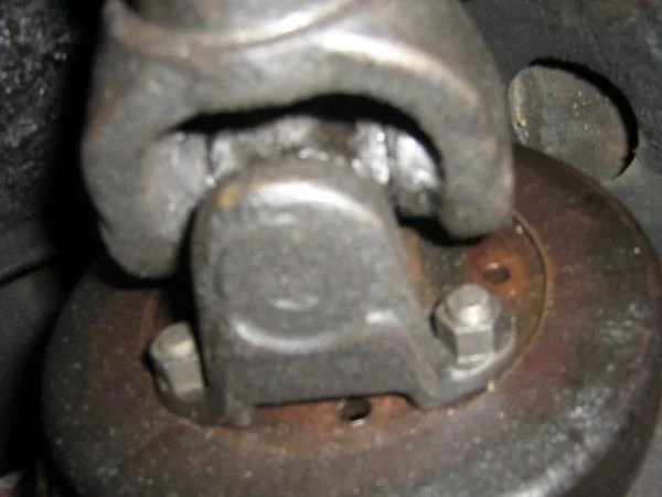

Are there no lock washers under those nuts Albert? (There should be!)
I hope the PO at least used blue loctite on those nuts or you could have the driveshaft coming off while on the move which causes ;lots of damage!
