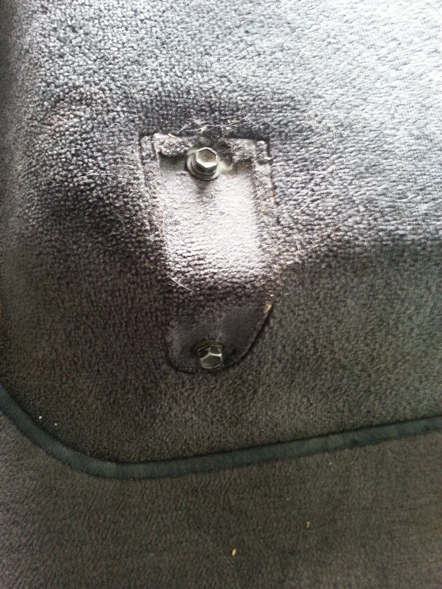

When you remove the seats and other things bolted in. put the bolts back in the holes. When you are puting in the new carpet you just feel for the bumps where the bolts are, make an incision and whala...easy peazy.
