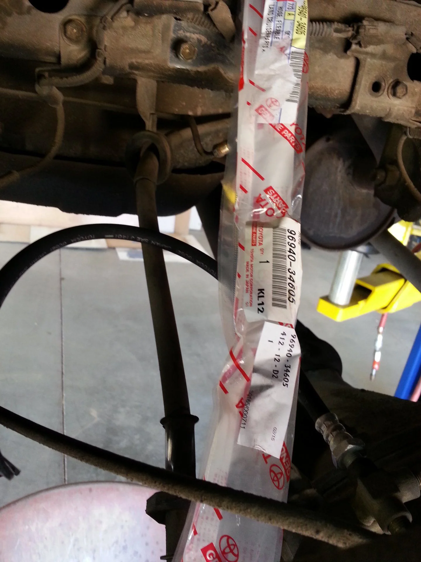

Rear axle to chassis extended flex line. From 1993-1995 T100. The chassis side mounting bracket has to be modified as the hole is different from the FZJ80 to the T100.
