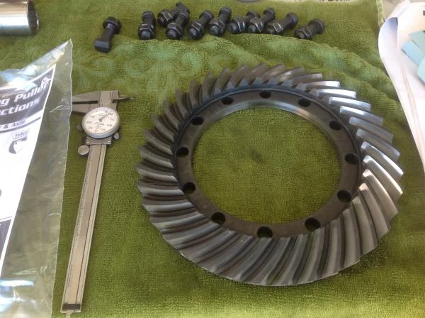

De-burred entire ring gear. getting ready to bake it in the oven 175-200 for easy install to ARB diff.
