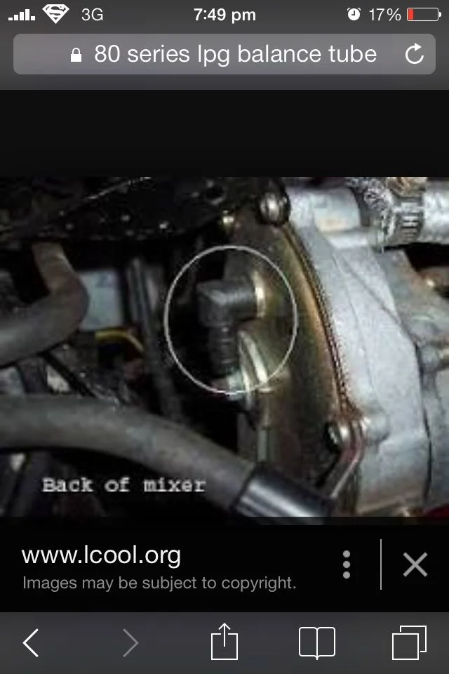

After fitting snorkel, she wouldn't run on gas. Would just stall.. Unless I ran my ram head backwards. Worked out the mixer was missing the balance tube, so ran a hose from back of mixer through side of air cleaner. Problem solved.
