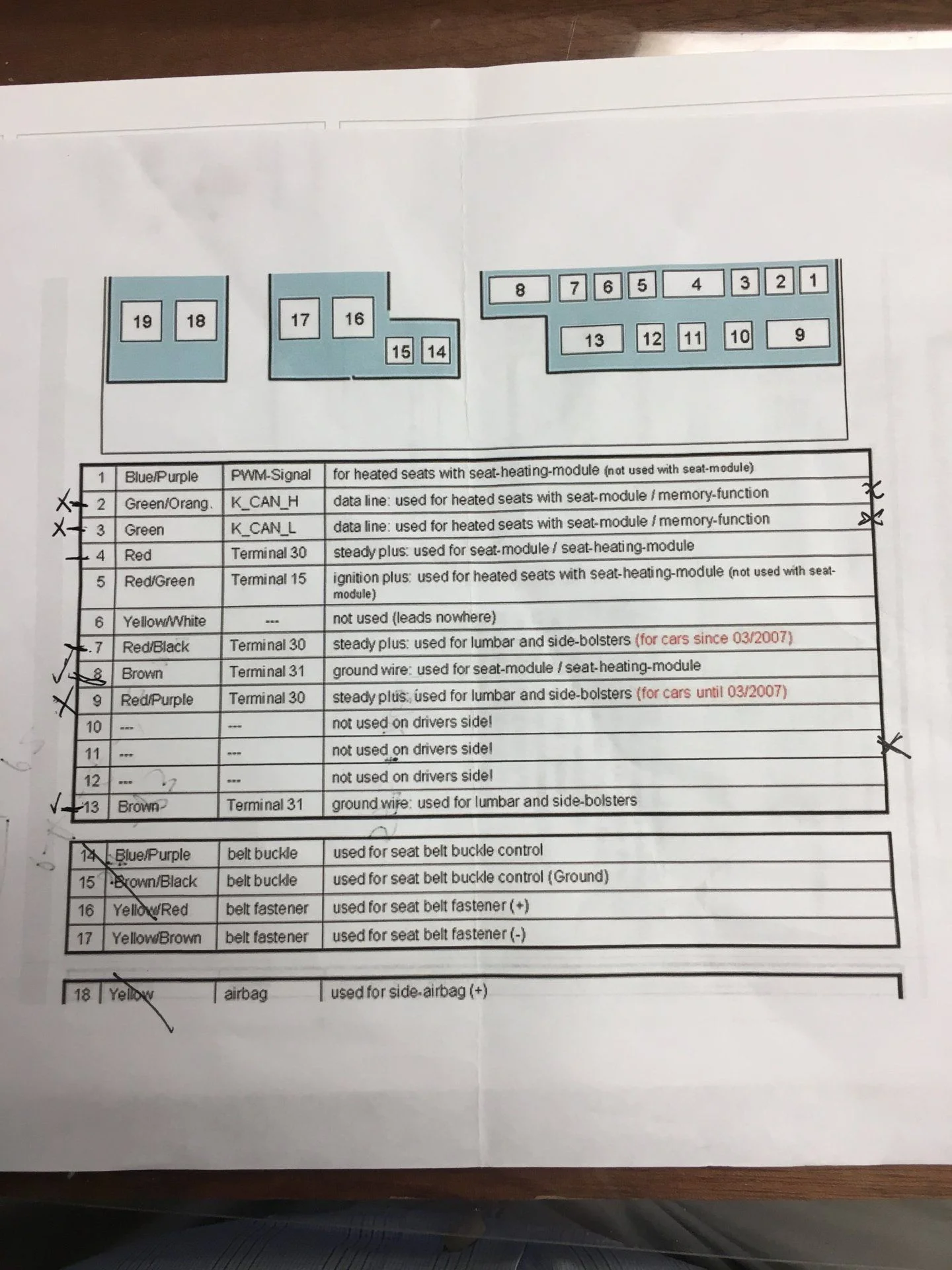

Driver, I just have 2,3,4, 7,8 and 13 that I need to use
Passenger, 4, 5, 8, 9, 12 and 13
I will have to come off of the module for each seat to connect the heater wiring. I can't go thru the pigtail.
