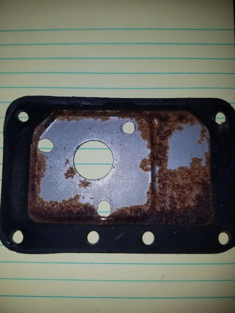

This shows the stock mounting plate. I needed to move the holes about a 1/16". You want to move them so when the motor is mounted it is moved towards the driver side. The metal nipple on the end of the new motor housing barely hit the stock cover.
